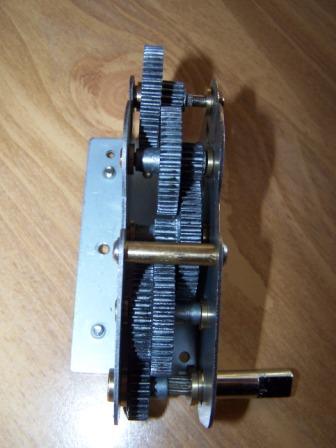

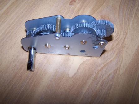

See the pics below, I used the tap tap method for the gears. The splines come off really easy when you set the gear portion between the jaws of an open vice. Surprising how softly you have to hit it to make this work.
I am a hair off though to be quite honest as I would like the gears to mesh a tad more than they do but I had no metric drills ( lol too anxious to wait ) but this was just a practice run anyway and I learned what I need to do the steel gears this weekend after my metric drills get here.
27 revolutions of gear 1 to equal 1 complete rev of the drive shaft. This will indeed be a scale speed tiger.
- steel gears1 002.jpg (23.07 KiB) Viewed 1625 times
- steel gears1 001.jpg (23.88 KiB) Viewed 1625 times
