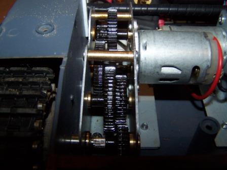

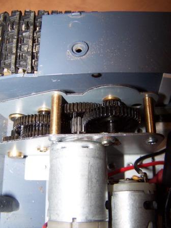

- FreakyDude
- Corporal
- Posts: 391
- Joined: Thu Aug 04, 2011 8:31 pm
- Location: Canada
Re: Mato steel gears
Dietrich
they are in fact the same as the standard HL gear box. I paid like $30.00 ( shipping included ) for mine. You can clearly see some sand grains in the one pic, as I said these are the gears in my driver tank which i beat up pretty good.
let me know how to do the 3 to 1 as well, I'd love to fix the speed on my driver. seems to be the only thing i am missing now.
- steel gears 002.jpg (25.65 KiB) Viewed 1663 times
- steel gears 001.jpg (24.54 KiB) Viewed 1663 times

- Dietrich
- Staff Sergeant
- Posts: 973
- Joined: Thu Aug 13, 2009 10:29 am
- Location: England and Aquitaine,France
Hi Nige,
I think this is a bit clearer on how to change the gears, no need for any additional side plates and the guide hole is already drilled at the factory....it just needs to be enlarged and only the top gear is plastic so it is virtually under no torque, just revs so it works very well.
http://www.rctankwarfare.co.uk/forums/v ... =38&t=4981" onclick="window.open(this.href);return false;
The steel gears are identical to the white metal Heng long ones BUT removing the final drive sprocket from its shaft and turning it around may be difficult
....I think that it will either be a 'put it in a vice and with a suitable collar wind up the force till something gives!!' which is a bit risky on a new gearbox.........BUT this is a very iffy and risky solution as the gear may break... SO a better idea is to cut the shaft off just short of the gear, drill out the remains of the shaft from the centre of the gear, using a small drill at first and then getting larger, as you go . A couple of pieces of wood can be used to clamp the gear while it is being drilled and then use an old shaft to mount it on. I always drill through the gear and shaft and put a 'metal pin' in just to stop it turning so the only dangerous part is the drilling.........this could easily be mucked up with it either not being a straight through hole or the hole being too big.....either mistake is difficult to correct..so a slow increase in the size of drill used has to be the best way. Once the shaft gets really thin it may just slide out or 'peal' out from inside the gear.
If the gears are really tight I guess that they are heat shrunk on at the factory..
By the way if you use plastic gears in the whole gear-train you will strip the teeth off the middle gears in no time.....my test box lasted about 8 feet on a slight incline
Alb.
Alb.
