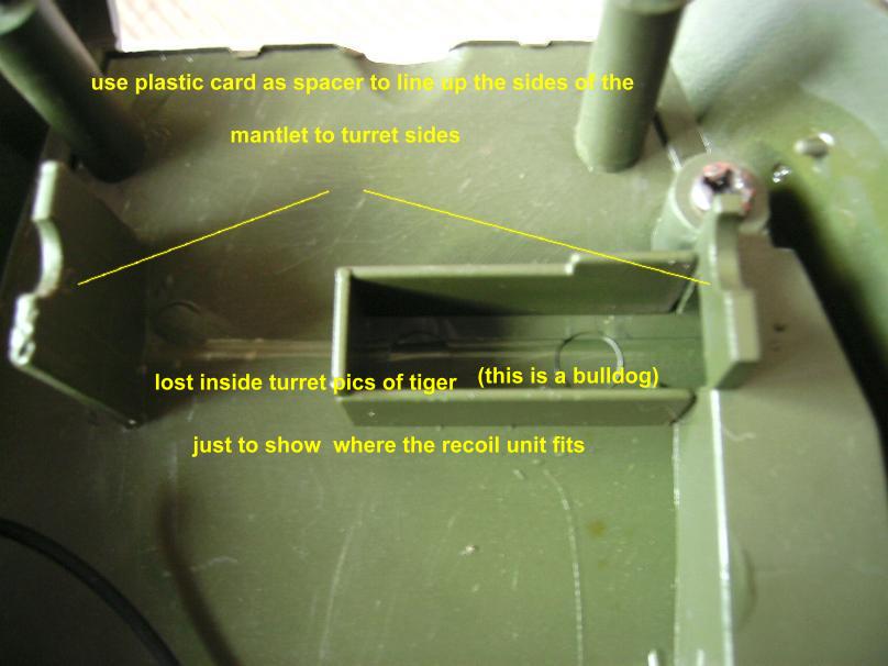

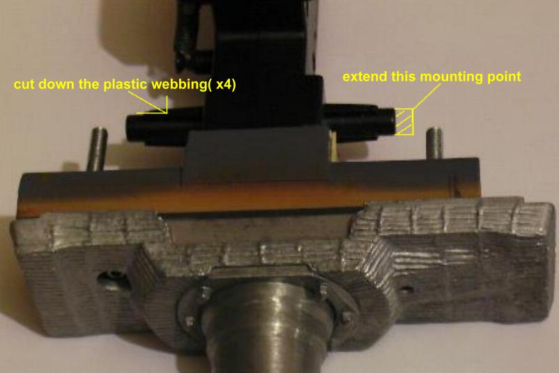

fitting to turret top.
cut back the plastic webbing on recoil unit (x4) then extend the other side of recoil unit with plastic /brass tube. the unit should now fit in the turret mountings,
i used plastic card as spacers to center up the mantlet with the turret sides.then a bit of sanding to fit
done 50p for metal mantlet/recoil unit from spares box .

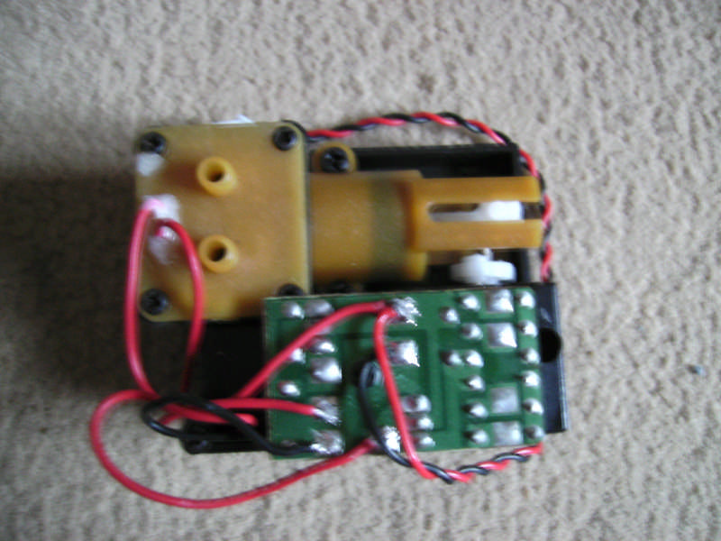

Hi all, slight modification to the noisey smoke unit
mt 1
Posts: 882
Re: rebuild
Post by mt 1 »
used old hull mountings from pantiger to fit the smoke unit in place.

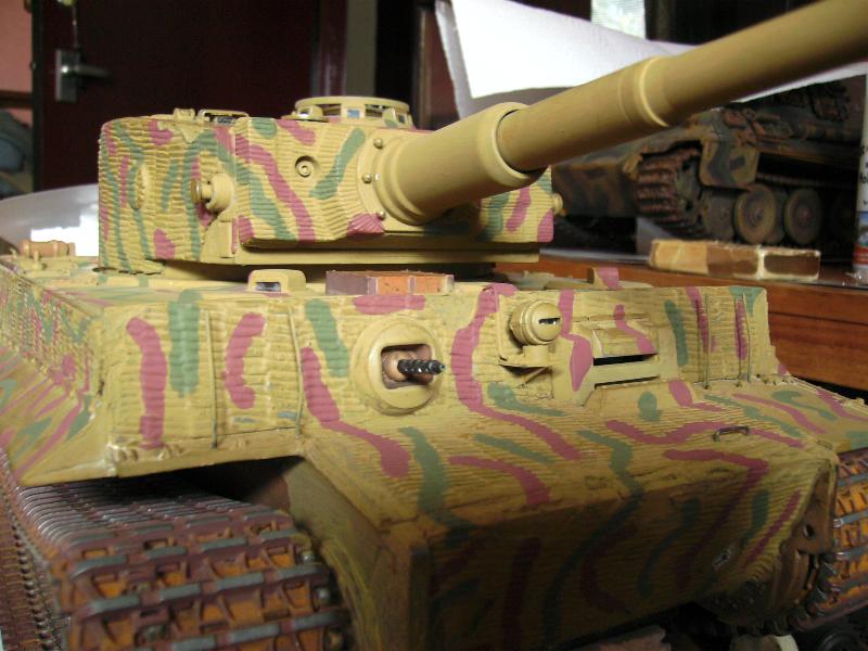

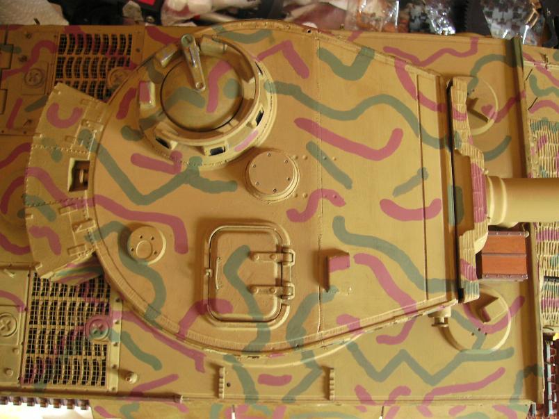

started the painting.
