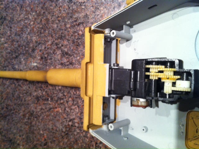

hey guys heres how ive made a strong platform for the turret to sit on buy useing resin on my heng long upper hull. i had some easyflow resin left over and i thought what if i could pour it in a sertin place on my hull to make it super strong! heres how i did it

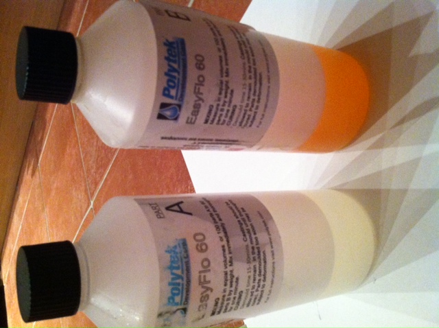

heres the resin its a 50/50 mix and it will dry in around 2mins

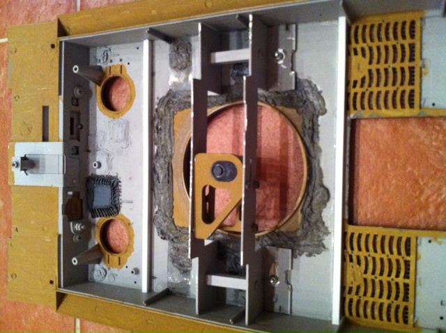

heres the hull with some plasticard strips ive glued in place so when i pour the resin it will set inbetween the two strips. and dont forget to plug any holes or it will come through them!!
heres another pic of the strips in place you can see here were ive moved the turret ring 10 mm back and i had a spare hull so i cut the turret ring out of that and plastic welded it on the back as well to make an even stronger base!!!
heres a mod ive been working on you can see the alloy frame ive made in the middle of the frame ive put part of an old carpet racer cars gear box side houseings these have bearings in them and a carbon shaft that will rotate the turret !
heres another pic of the mod ive had to fix it in now as im planing to pour the resin over it!! ive allso bolted it down here
rite now here you can see the resin ive poured in the hull its about 6mm thick!! and once set it is solid!!!!
heres a closeup i allso filled in some spaces at the back with resin just to help strenthen up the rear
heres a pic of the top of the hull you can see were ive cut out the ring here and moved it back just needs filling to finishheres the turret underside ive got to move this back as well but heres a pic of the part that fixes to the carbon shaft ive fitted in the hullwell thats it for now guys more to come!!!my hull is now super strong with no flex
