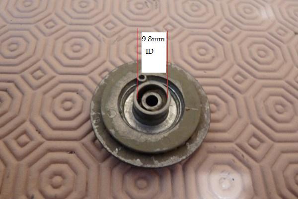

now its time to modify the wheels, the id of the ideler is 9.84mm,the centre of the wheel needs to be drilled out to a depth of 5.2mm this is measured from the top edge . i used a drlling jig a pice of wood with a hole so the ideler is a snug fit to aid drilling

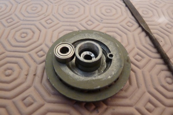

i found a cordless drill seemed to work well, drill the centre in stages measuring with a digital caliper to insure correct depth.
after  drilling
after drilling
the ID of the idler was 9.84 mm i needed to make this closer to 10mm to fit the bearing , i used the cordless drill with a small sanding drum to remove material checking the size the digital caliper and test fitting bearing, when the bearing is almost seated with 2 mm above surface, place idler in a vice with 2pieces of wood and press bearing gently untill level with the surface.

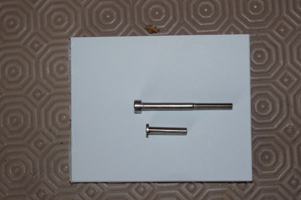

making a new axle, i used a m4 x50 caphead and ground the head , and cut to 20m long .
m4x50
m4x50

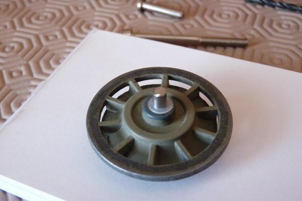

i finely added an m4x 0.5 nylon washer to prevent wear.
nylon washer
nylon washer

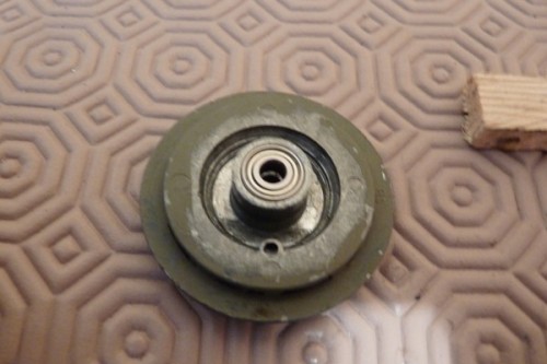

Thanks ice, hears a pic of the bearing pressed in place i fogot to add
bearing pressed in
bearing pressed in

This is a brilliant idea o have copied this on my tank and I used two bearings on each wheel I used hub bearings from a kyosho optima! Work fine you still have to grind the inside to fit them ! :thumbup:
