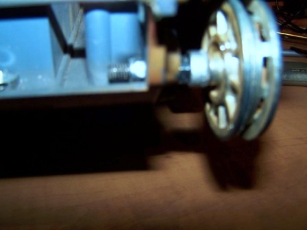

I had the same problem, I found some 5mm x 45 shoulder bolts washers and nuts, cut-off the protruding nub on the tank body, drilled a 4.5mm hole through the tank body. then i made a washer the width of the distance i moved my idlers out from the body with the old plastic idlers I had.put a screw through the metal idler then my homemade washer, nut then another nut on the inside of the tank. problem solved and the idler runs in the correct spot between the track teeth and not on top of the inside of the track tooth.
I know bad instructions but look at the pic below. that should explain it all. I can do speed spins on grass and not lose a track now by the way.
