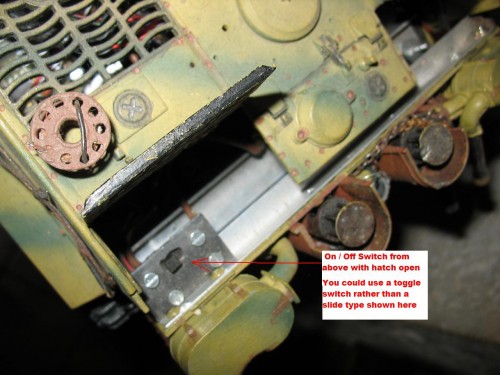

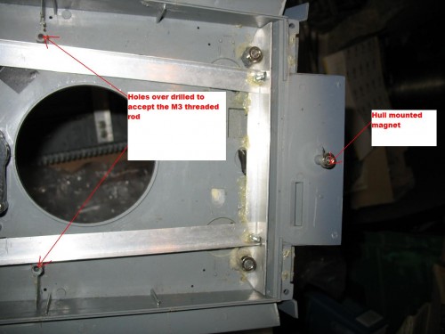

That is a long list of alterations to make, but rather than 'Overloading' the turret with so many switches and battery chargers, why not make it easier to split the hull top and bottom ? The screws can simply be dispensed with and magnets used instead to hold the two halves together. I realise that the effort of pulling the two pieces apart may be a lot so you could experiment with smaller or weaker magnets. I used the two 'Centre' screw holes located over the tracks as a pair of 'rod and sockets ' which locate the hull in place and stop it from sliding about and the magnets hold it all in place.

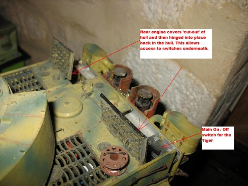

You can also make use of the hatches on the Tiger, cut them free of the deck and hinge them in place so that they can easily be lifted to access switches and a recharging port.

Dietrich - Magnets! What a fantastic idea, I'm just ordered some off fleabay :thumbup: That's such a simple but effective idea that I think it's single-handedly made me want to convert this - conversion - in to a "remove the upper hull" as opposed to "remove the upper turret". Having said that though, I would still like quick an easy access to the turret interior for different reasons as - realism permitting - I'm sketching out an idea for a "shell eject" mechanism in which 5.56mm casings would be forcibly ejected from the turret.
Thank you, the photos were really helpful - they've given me a lot of food for thought!
