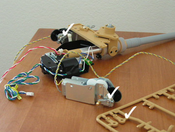

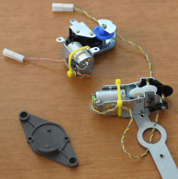

All the WWII tank Tamiya turret rotation units and the main gun elevation units are well understood weak links and seldom work well without some tweaking. If you inspect both units you will see each uses the same black "clutch gear". Remove that gear and glue it sold with CA glue and then put the parts back in place in exact reverse order. The elevation unit uses a plastic arm, which will break after a little wear and tear. Replace it with a metal arm. I like ETO, but Axels and Impact also sell similar parts. Perhaps these build photos will help. These are the fixes I use to get these parts to work correctly. I used a Tamiya solid blue gear in one photo, not available in the UK, but gluing the black clutch gear solid offers the same result.
1 recoil assem.jpg (143.24 KiB) Viewed 2100 times
