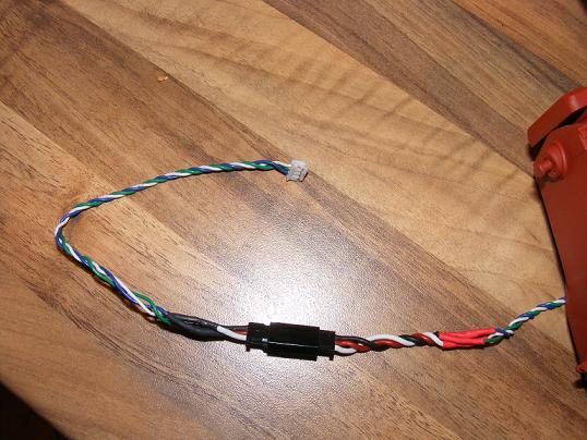

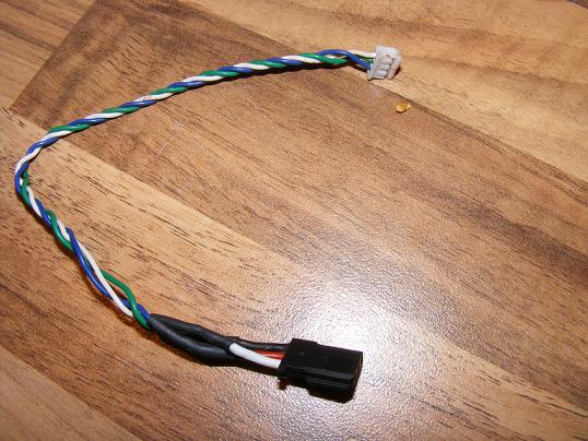

Hi Pete I know the problem with Tamiya connections so I did this with my Tamiya recoil wires so it's now plug and play. That is why I needed the wiring info on Tamiya MFU'S and recoil units as I want to swap my Tamiya control stuff between diffrent tanks.
Alan
Connected to Tiger 1 turret recoil
Tamiya connector seperated from recoil wiring ready to be moved from tank to tank simples yes ?
