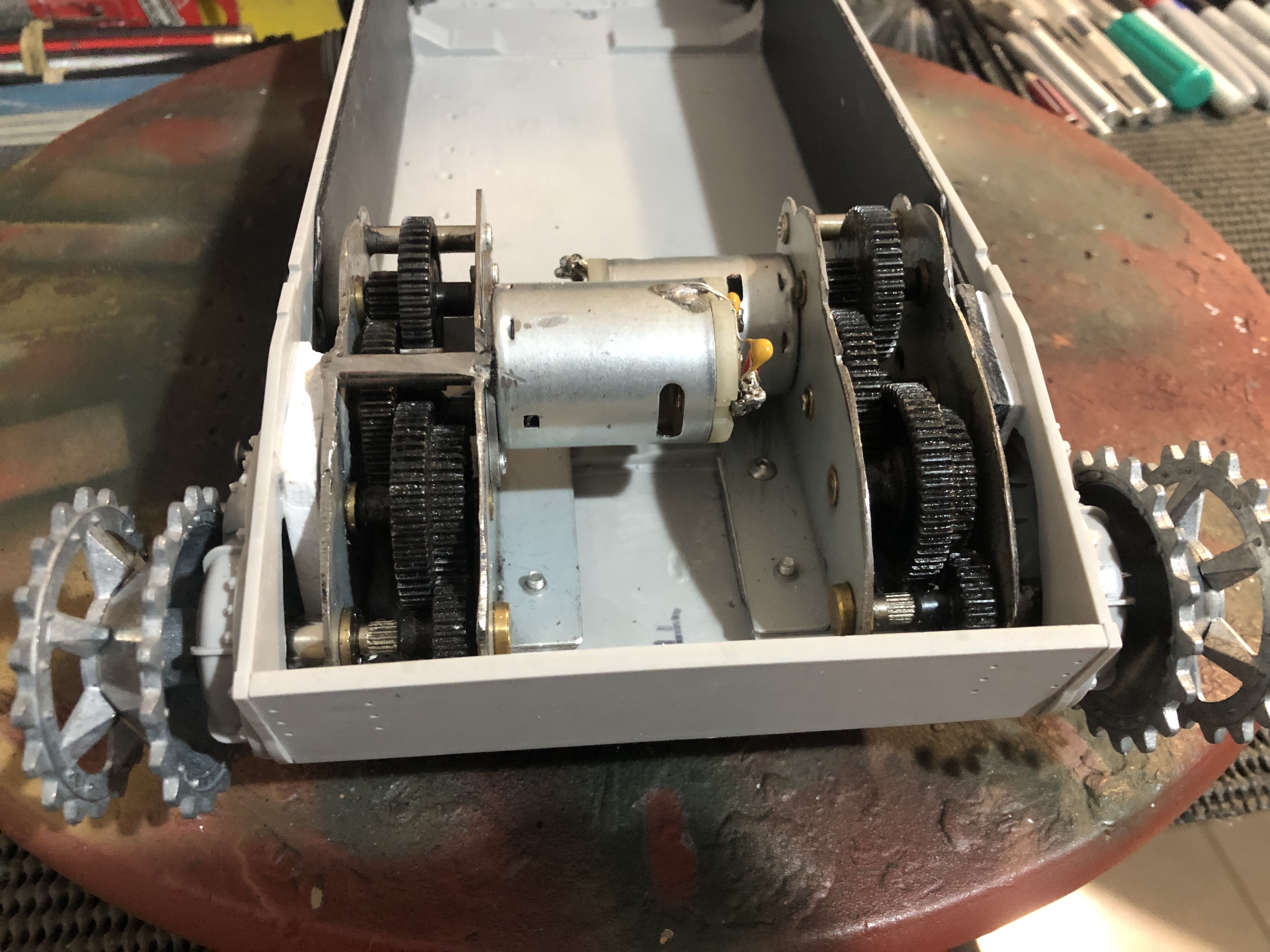

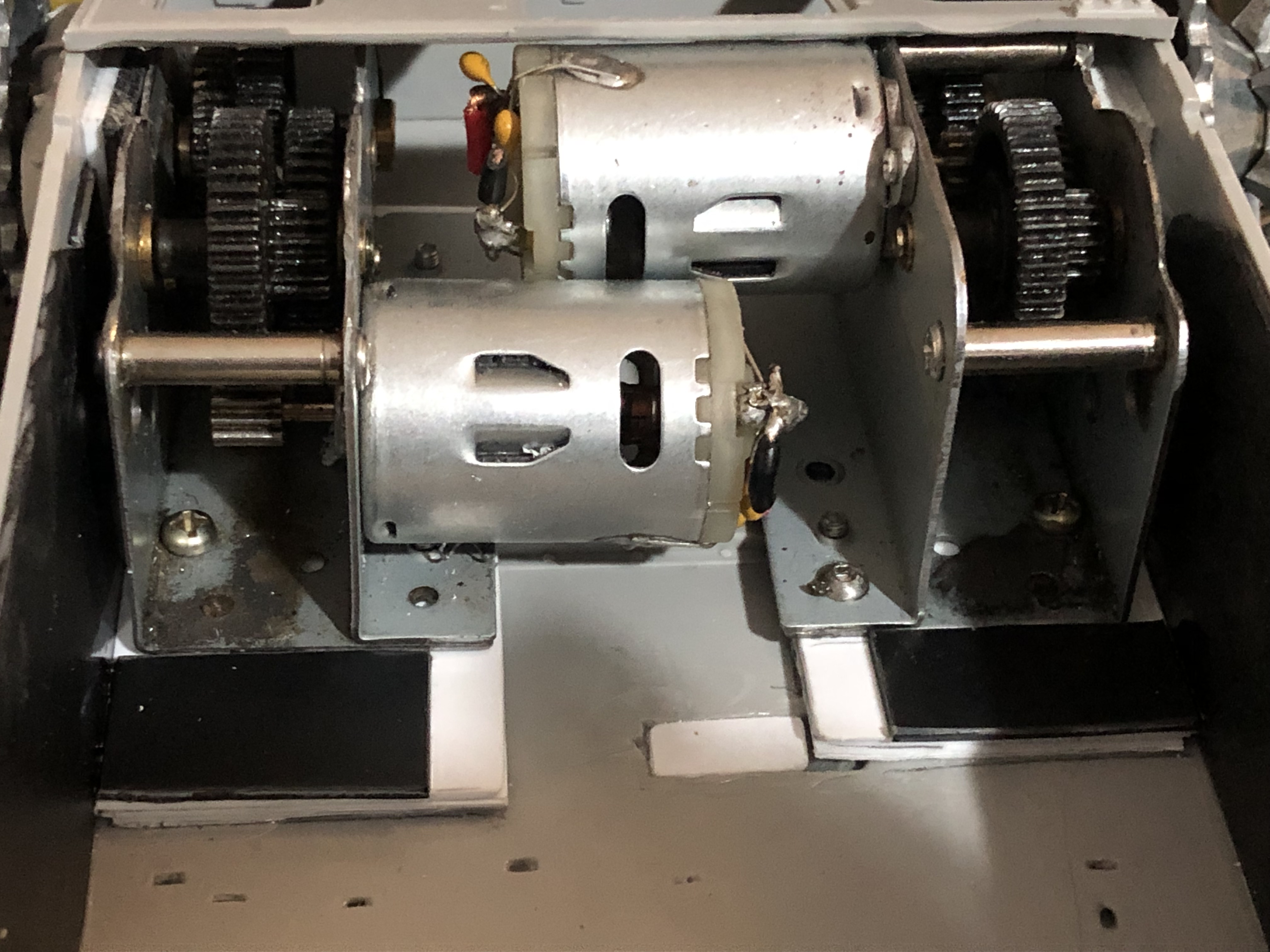

Im calling the gearboxes IN.
Aligned with a steel ruler along the length of the hull from the side of the drive sprocket and its within 1 mm along the entire length both sides.
That'll do Pig...........That'll do
I used some scrap styrene to make stop-blocks for each side of the hull to the gearbox side plates to assist in maintaining the alignment, and also glued a stop plate on the rear of the gearbox frames just to assist in maintaining the forward/backward forces that the tracks will exert on the fasteners.
I still need to get the new motor cables soldered on but there is enough room for me to do that in place.
The fasteners on each gear set do need to be replaced with nylok nuts & washers, but at least until I get those I can get the thing to run under its own power soon enough.
Hindsight being 20/20 it is a must-do for anyone wanting a relatively easy run on one of these to use a set of genuine low profile gearboxes.
You gain space to align, to raise for sprocket height and not have to touch the underside of the Trumpeter transmission plate.
There is not a lot in it, but the right side motor is half a poofteenth (see the appendix- 1) of a mm below the kit transmission plate & thats had a close shave of plastic removed.
