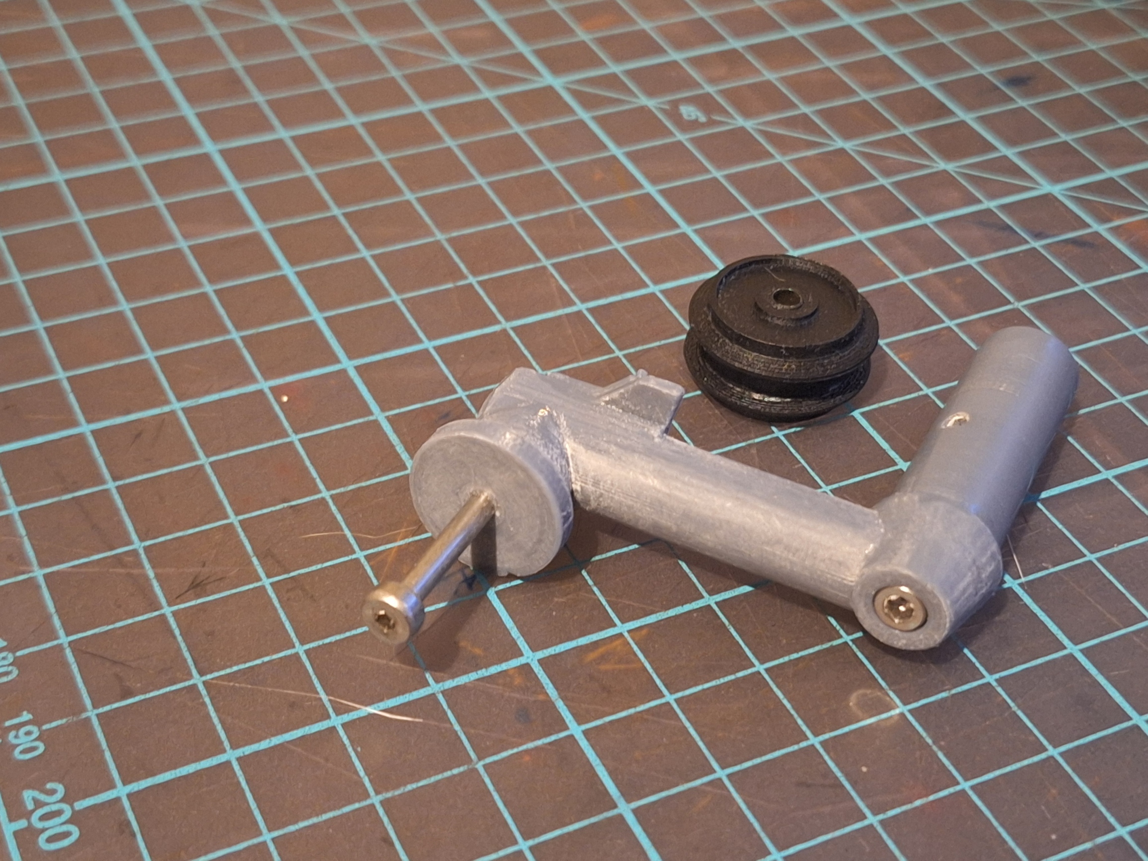

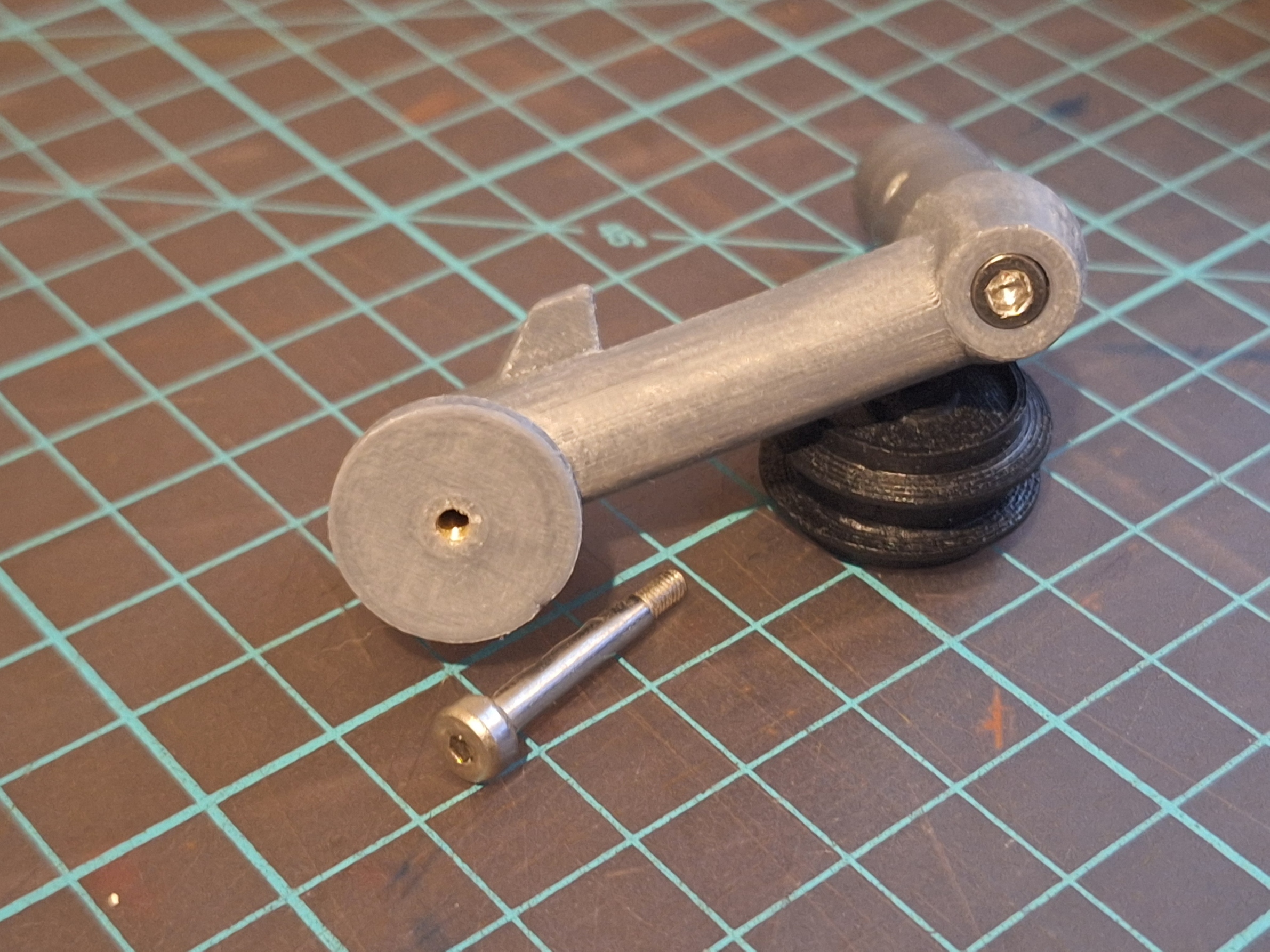

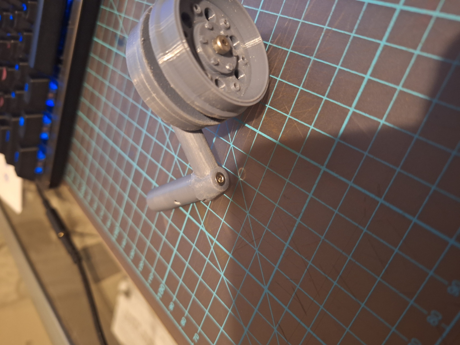

I use roller bearing shoulder screws with heat inserts, like this - https://www.aliexpress.com/item/1005007 ... 1802etjgQ4Gillaspy2005 wrote: ↑Sat Dec 27, 2025 11:57 pm The question i have is about the running gear. The roadwheels are to be attached with screws and separating washers lubricated, how well does this work? Is there a lot of resistance? Has anyone modified and used bearings etc? Any advice here before i spend days printing them?
PETG plastic is smooth enough to work as the bearing itself, but you can use brass bushings too. For a 1/16 scale, it's more than enough.
