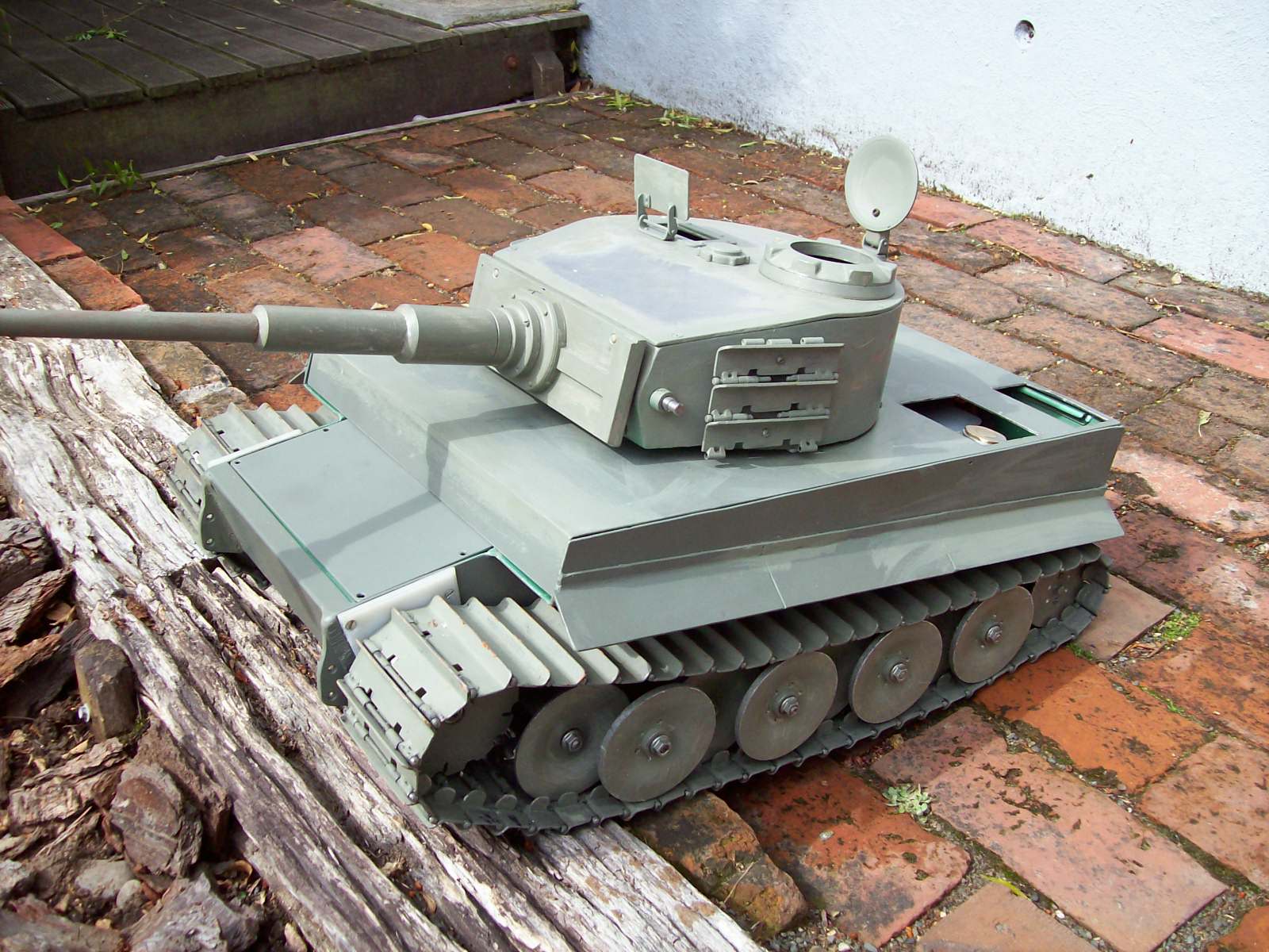

Have had to change the motors/generators , they would not deliver enough power . Have fitted a 24v /5amp Mig Welder Wire feed motor and machine is now able to " Wheelspin " climbing a step dirt bank as in one of the photos . I don't need full revs to achieve this either so very pleased with It. Now need to change the steering switch gear to DC variable voltage controllers , servo driven with a third servo for switching forward/ reverse . Then get on to finishing details . I have in mind a LPG gas firing gun like the bird scarers farmers use but think the small bore involved may defeat the explosion . Still thinking about this .

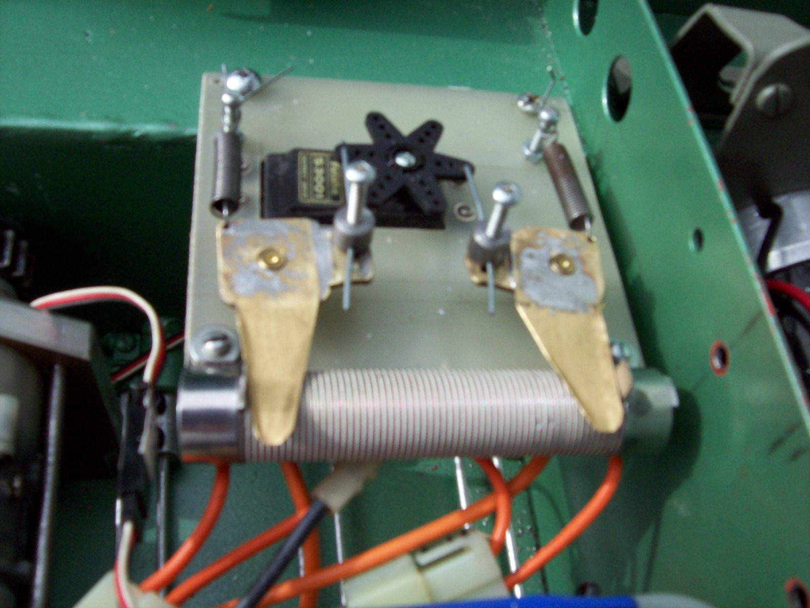

Back on It again ......Made a speed controller, resistant type to see how It would work . As I have power to burn.! So to speak! Works Ok but my motor is still not idling any good .Not happy with the carburetor and suspect the ign timing may be wrong as I want lower speed control rather than weed eater high revs . Turrent is on rollers and have made a couple of hatches .
