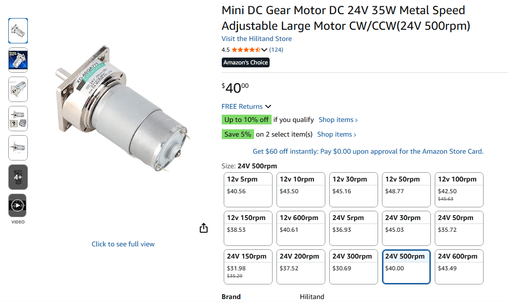

I think as you mention you will need more torque - I would recommend 400-500 rpm motor output and maybe 24V if you can find them. Your model will be heavy with metal tracks. 12V will get hot as they are working hard with that weight.
I cannot seem to post a link for the motors, but you can search on AMZN or Aliexpress. These are a planetary reduction with decent torque and speed for bigger model.
