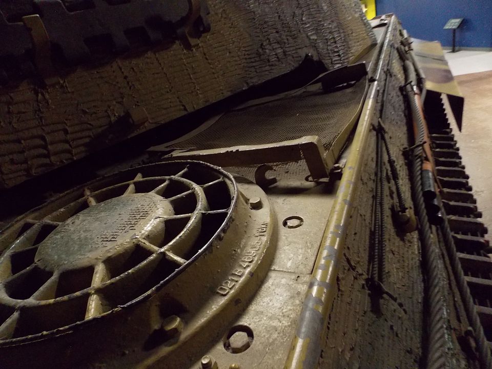

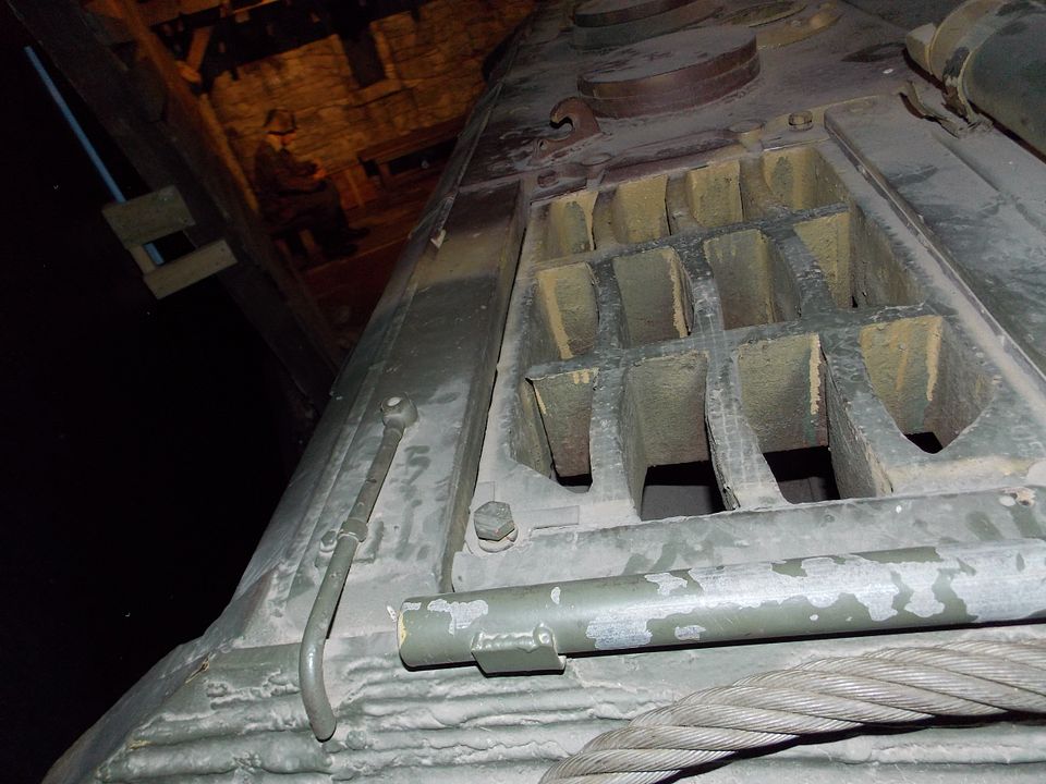

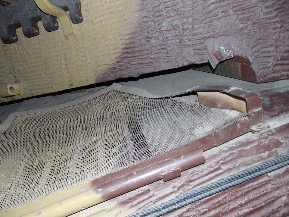

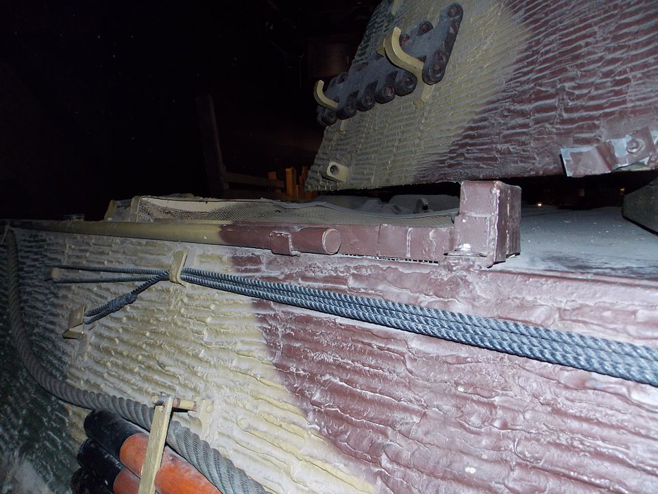

Would any one have a photo of the brackets that held the aerial tube on a KT to the hull .Tamiya has this part glued to out side of the upper deck with no gap in between which is not correct. There was a gap and the brackets may have or may not have made the tube have a slight outwards offset away from the body like Ronnie 42 did in his KT build. Any help appreciated .Cheers

Thanks Jarndice.There are good photos of Tiger 131 aerial tube and mounting brackets but when it comes to a KT , I have found nothing for detail.. Trying to create some thing more correct with brass tube It would be nice to find a member who would not mind to take some photos if they were taking a visit to Bovington. Cheers.

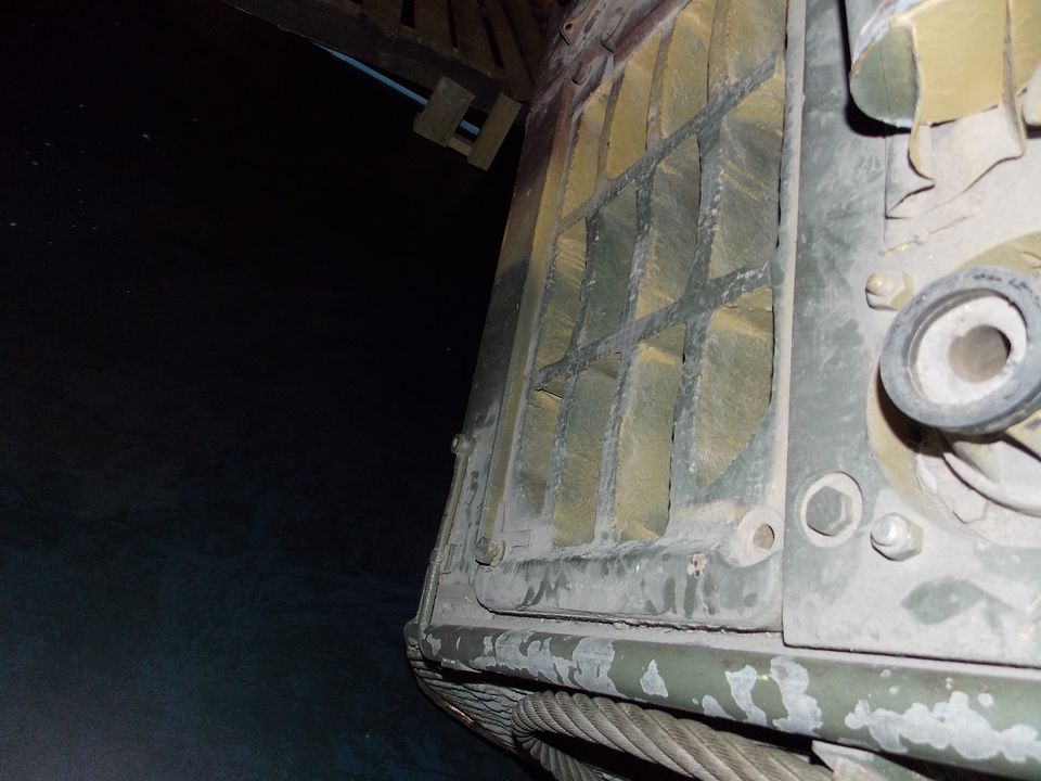

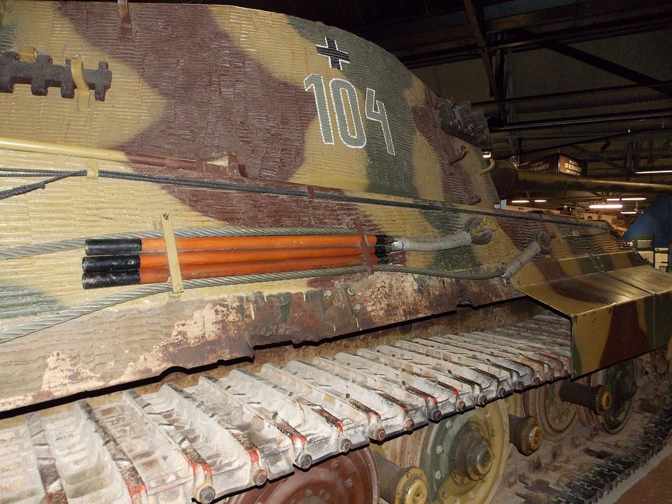

I thank you Jofaur86 and Barthez for the help.Jofaur86 ,you ares always trying to help a fellow tanker if asking for help and Barthez,your photos are fantastic. They show me what I wanted to know plus more.They show perfectly the rear petrol vent pipe ,how it is constructed and the correct placement.
