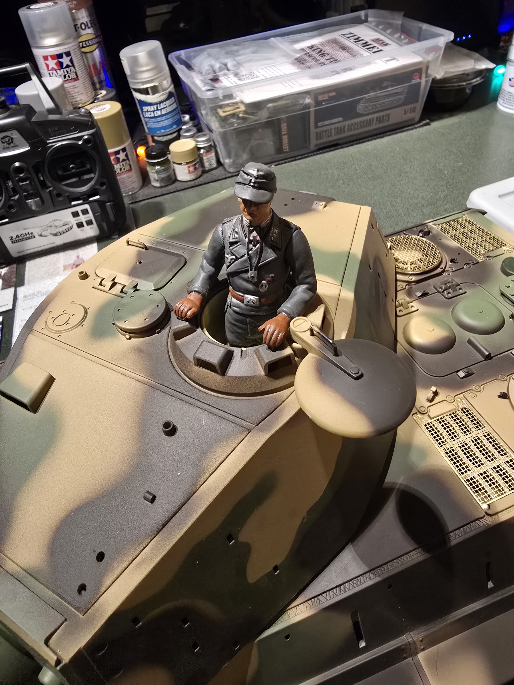

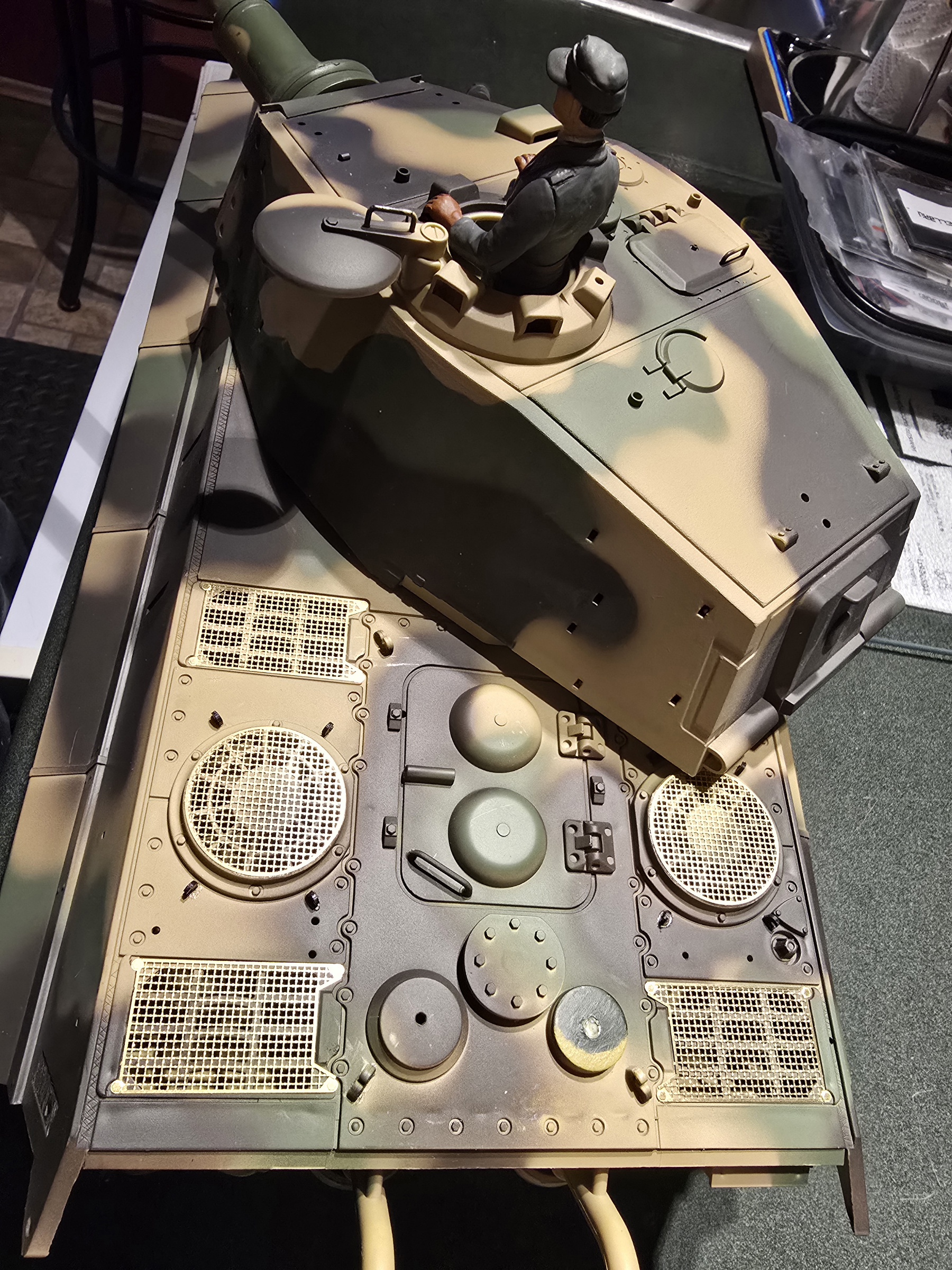

Good Afternoon!
First Post of Part Two of the once 'Winter' Dual Build. The Prototype Production Turret King Tiger has had the Battery taken out and is posing in the Spot where the new King Tiger was sitting in the Tank Room. I put a charged 7.4 L-ion battery in the new Tank and tested it again after a year + wait. Everything worked perfectly, Sound, Recoil, BB Fire, Smoker, it all worked. Here are a few pics of both Tanks side by side to start out the new Build Thread.

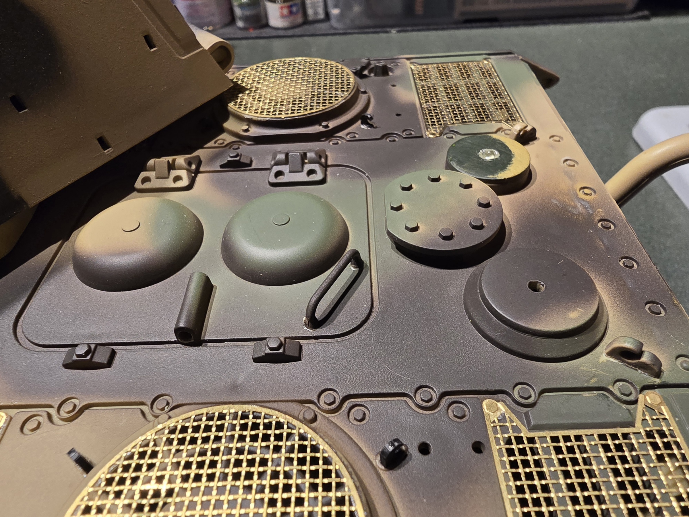

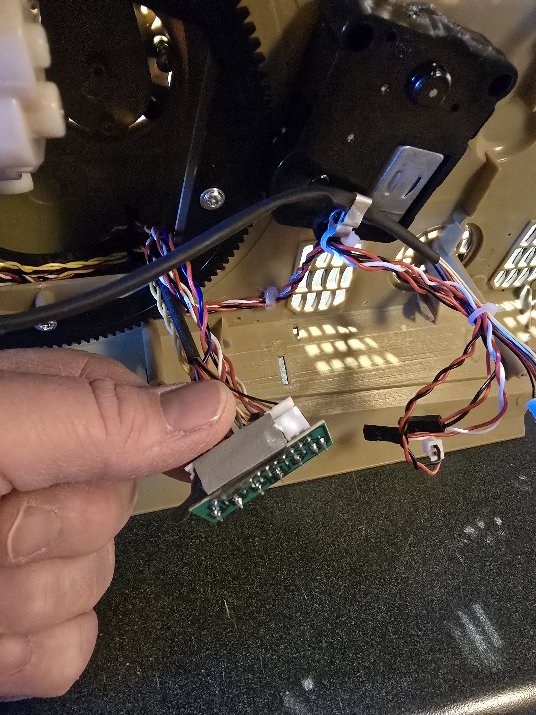

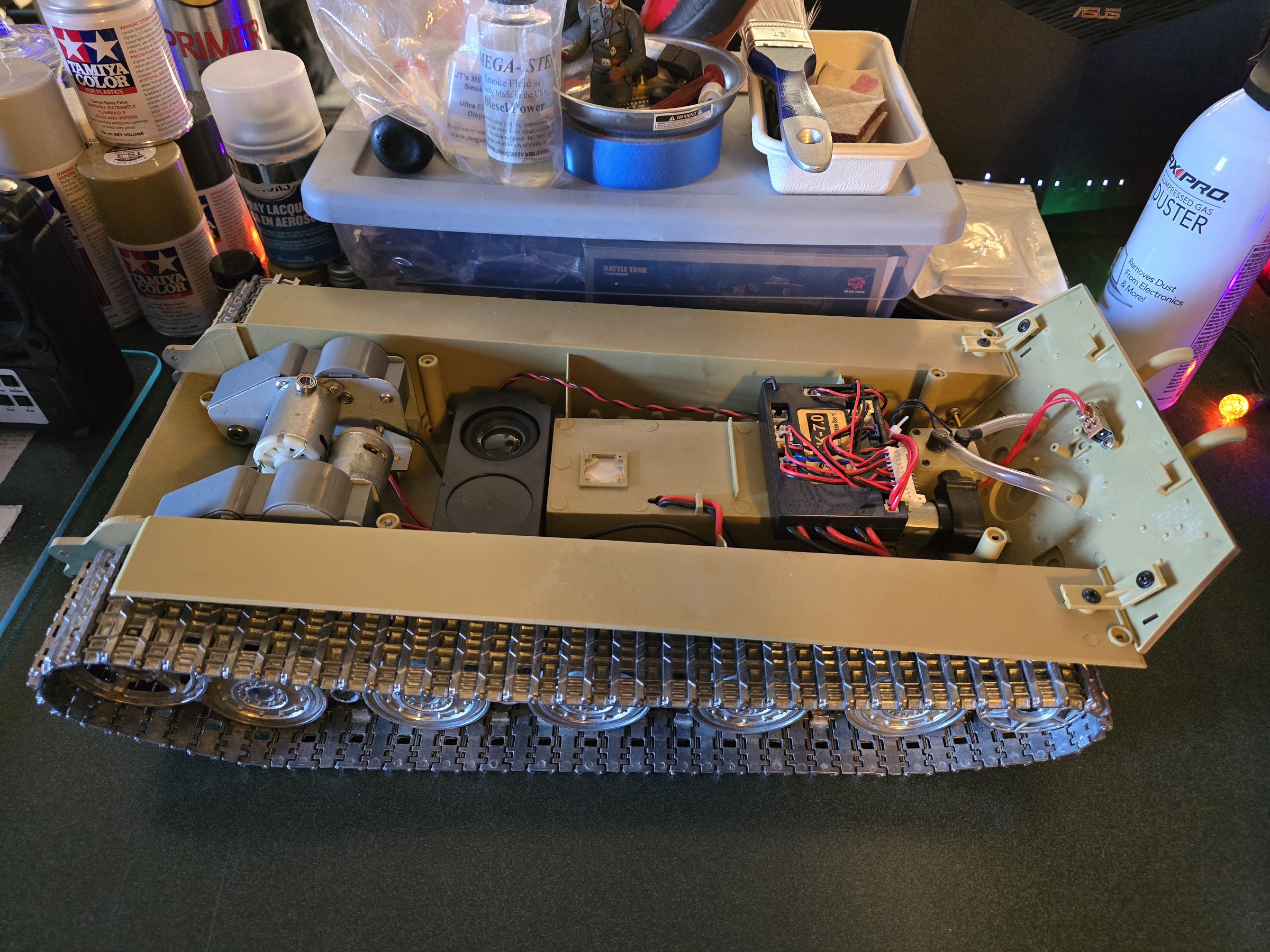

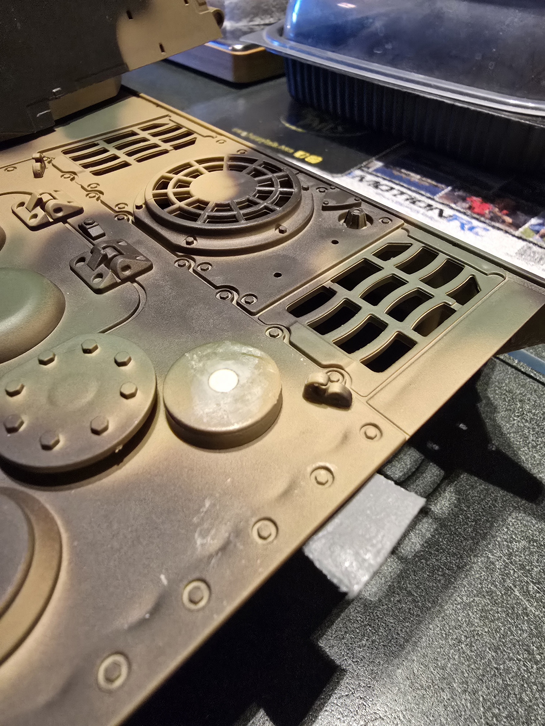

Good Afternoon!
Tank taken apart and the electronics neatened up for use. I began work on the Rear Engine Deck and removed the Aerial Stub ( interesting that they no long tap those for a screw ). I filled the hole that this left with Putty and let it dry overnight. Coming back to it today, I removed the lift hooks via Tamiya plastic Saw and reattached them in the right orientation. After this, I added the small lift hooks from Tank Modelbau. Eight of them spaced around two Engine Fan Covers. I added the Brass Covers from Forgebear then drilled out the handle for the big Engine Deck Hatch. ( always 'Fun' ). I took a Hex Key and warmed it using a lighter and made the hex indentation/hole in the right cover. I had painted the cover where the Aerial Stub was and now tried the same trick there with the heated Hex Key. *Laughs* The putty slid right down the Stub shaft. I filled the shaft back up with Gel Superglue which should dry hard and allow me to make the lock aperture on that hatch. I will come back to it tomorrow or the next day and repaint the cover again.
