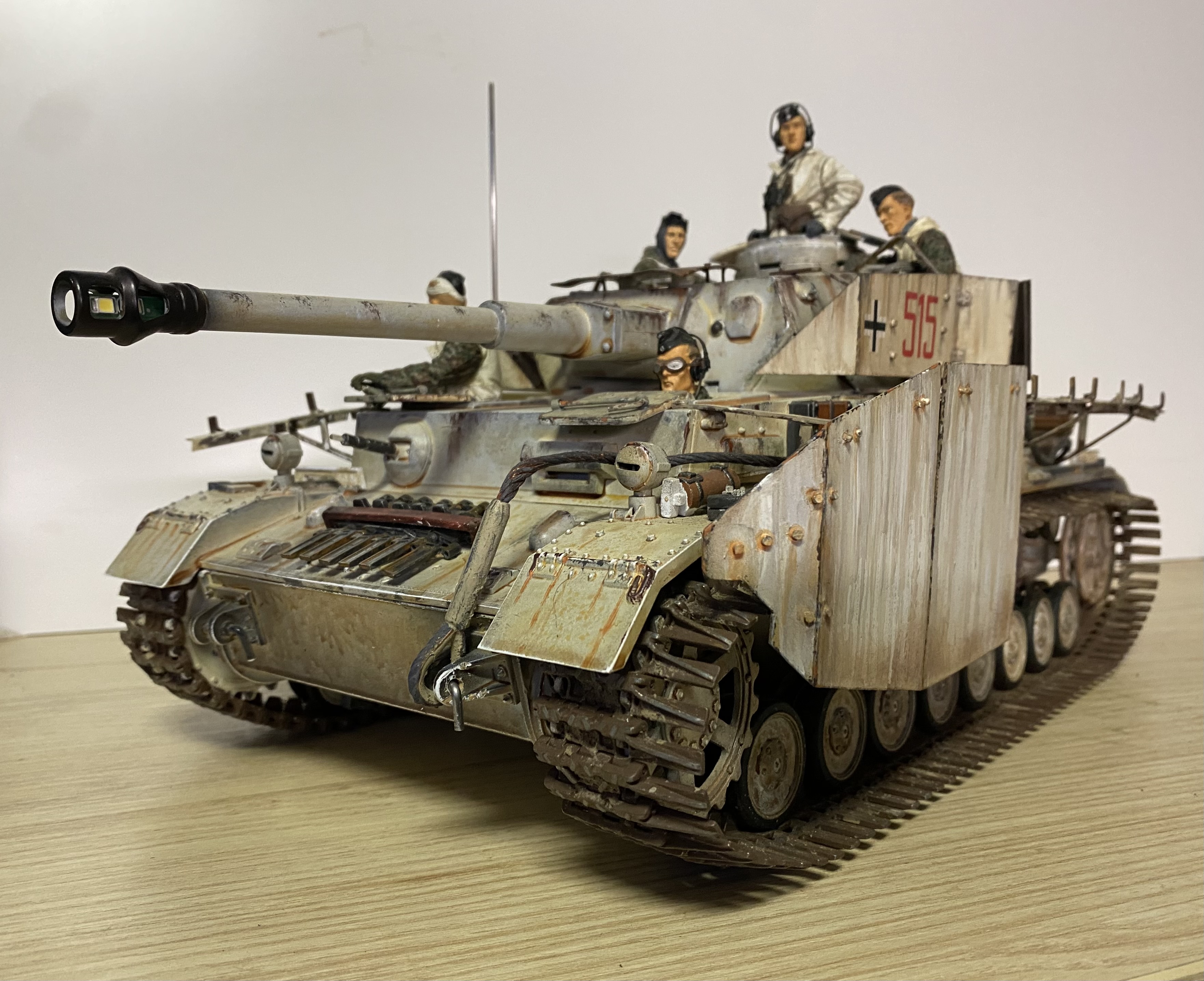

One of mine, with home made Schürzen, brackets and so.
Its a Taigen Metal Version btw.

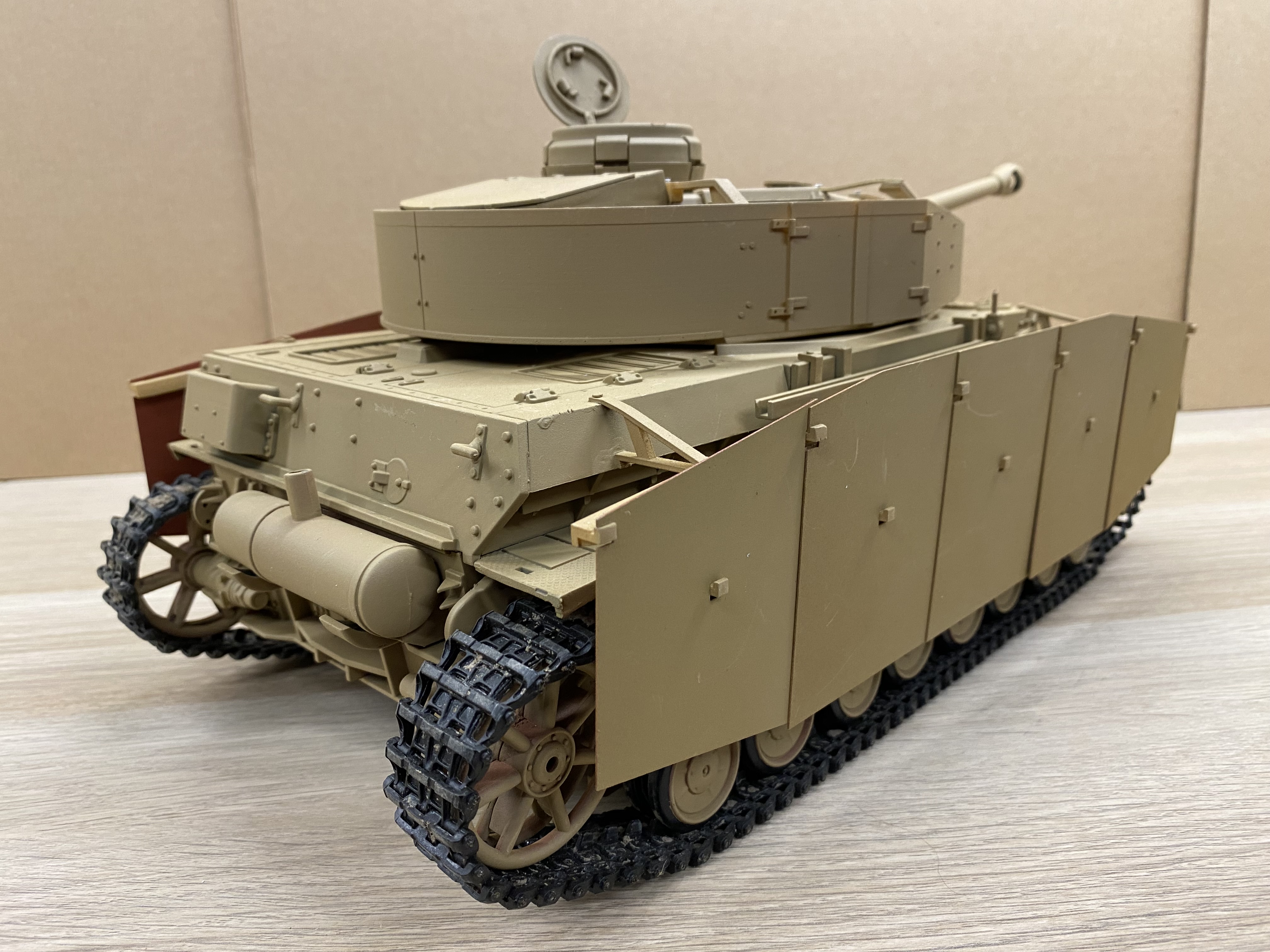

This is a HL plastic PIV, with the entire Schürzen set from Ali…
Still in its base color, DG, not decided which camo to ad yet…
