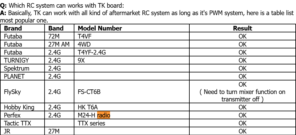

The issue you will run into is getting whatever new radio configured to use the functions of the Clark board. The Gepard is using a Clark TK50 board. I'm not sure what you Centurion has in for a control board. It may also be a Clark TK50 or it could be a Haya (re)branded board. The real issue about going with a transmitter that no one else is using with their Clark boards is that no one will really have any experience with that particular radio configuration. You will be basically on your own to get it to work.
Clark says the following have been tested with his boards, but some of these are really old and not SBus so I can't really comment on how well any of them will work at this point. Most of the newer TK50 boards are SBus.

So casting my mind back this has come up before, I'm pretty sure it has been done but it's a bit of a pain as the sbus control scheme has been set to use the i6s/x tx.
The problem you quickly get into is the control scheme uses 4 3 position switches. You can get this down to 3 if you're not bothered about indicators. If your tx has this then you should be ok! It's just a case of replicating the control setup from the i6 on your futaba

THanks for the info guys. I have a Futaba T14SG - should have said that originally. It does do SBus and I have some spare SBus receivers so I am fine there. The issue is the Haya controller is pretty basic and has no screen so I am not sure how it is setup in the background for each of the channels to convert that over to my Futaba. Might be a bit of trial and error.
My Centrurion has the same handset as the Flakpanzer so think it will be the same setup inside - TK50 and Sbus.
