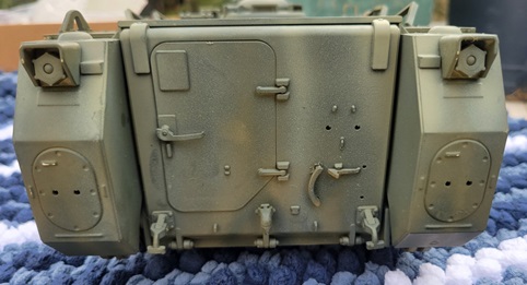

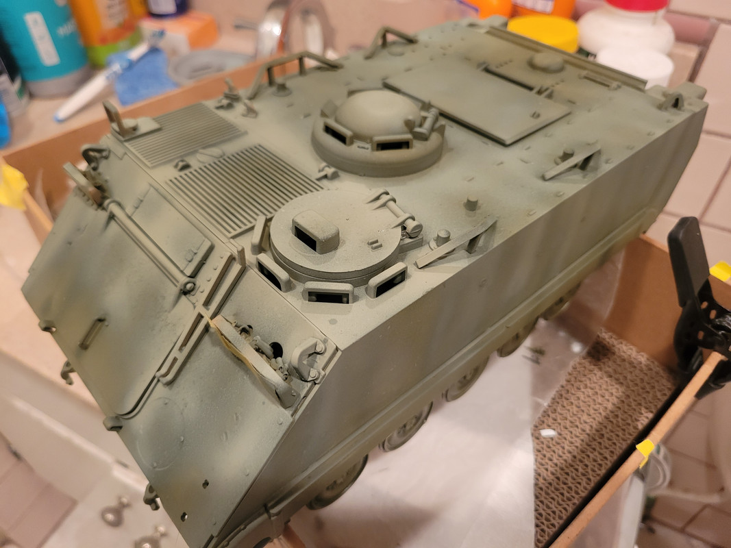

So far i've weathered the tracks some and started spraying various patches of O.D. and faded O.D. (an actual color from Mission brand paints is O.D. Fade, plus Fade 2 and Fade 3).
I used several shades of rust on the tracks. The tracks on this A.P.C. use rubber blocks in them, and those are always painted black.
I sent off for a bottle of white and two of black, the idea being to lighten and darken the olive drab and spray in patches and "clouds" over the base paint. And as used in Vietnam, every image I've ever seen of an M113 at war was painted solid Olive drab. No camouflage patterns were used on American M-113's, or at least none I've ever seen. But our erstwhile allies the ARVN ("Army of the Republic of Vietnam") also used the M-113 and some of those had a camouflage pattern applied - but there was no standard or "official" camo pattern to go by, most were apparently created on the spot immediately when the guy who had the paint showed up.
Anyway I figure the only way to weather a solid color is to vary the shades of it, so that's what I'm doing. I paint in small subdued streaks, mostly vertically, to match how the real thing would wear especially when exposed to a tropical climate like Vietnam. The important thing is to do just a little then stop and inspect how it came out (before laying on more)!
I decided to not add the side gear accessories that come with the model and just filled in those holes. In the images of the M113 at war, like I said there's usually nothing hanging off the sides of the track (probably because of dense brush they often operated in would tend to squeegee off anything sticking out). Since American G.I.s tended not to hang things on the sides, I won't do it on mine, either.

It's amazing to me how bad a company can make a product look by painting it and then how good a modeler can do painting it. :) I would say if you are trying to make it a Vietnam era M113, you might want to ditch the external fuel tanks on the back. The M113A2 first introduced those and the A2 was developed after Vietnam ended. If it matters that is.

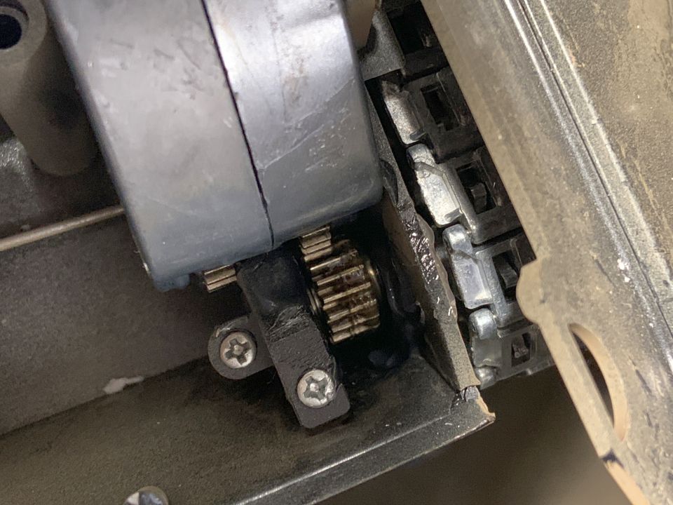

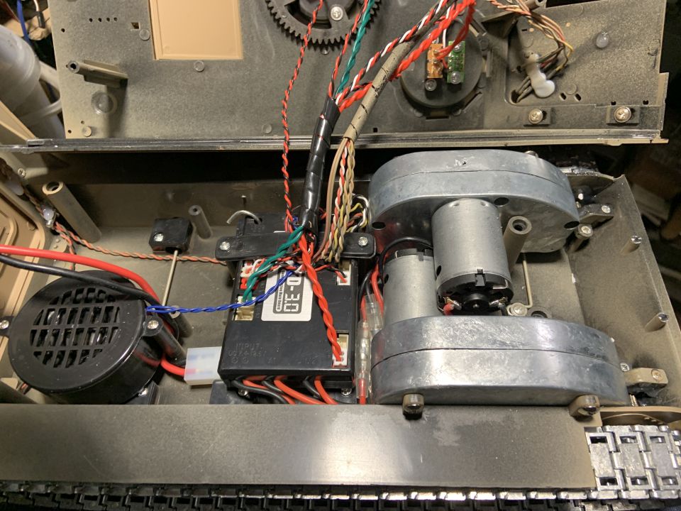

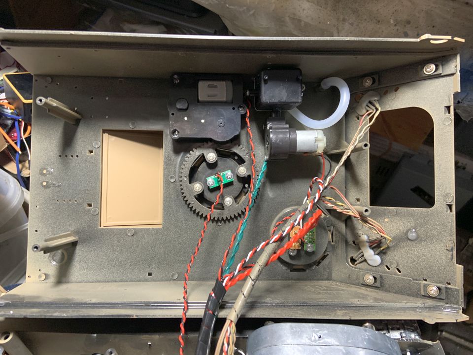

Hello,
pictures from inside:
