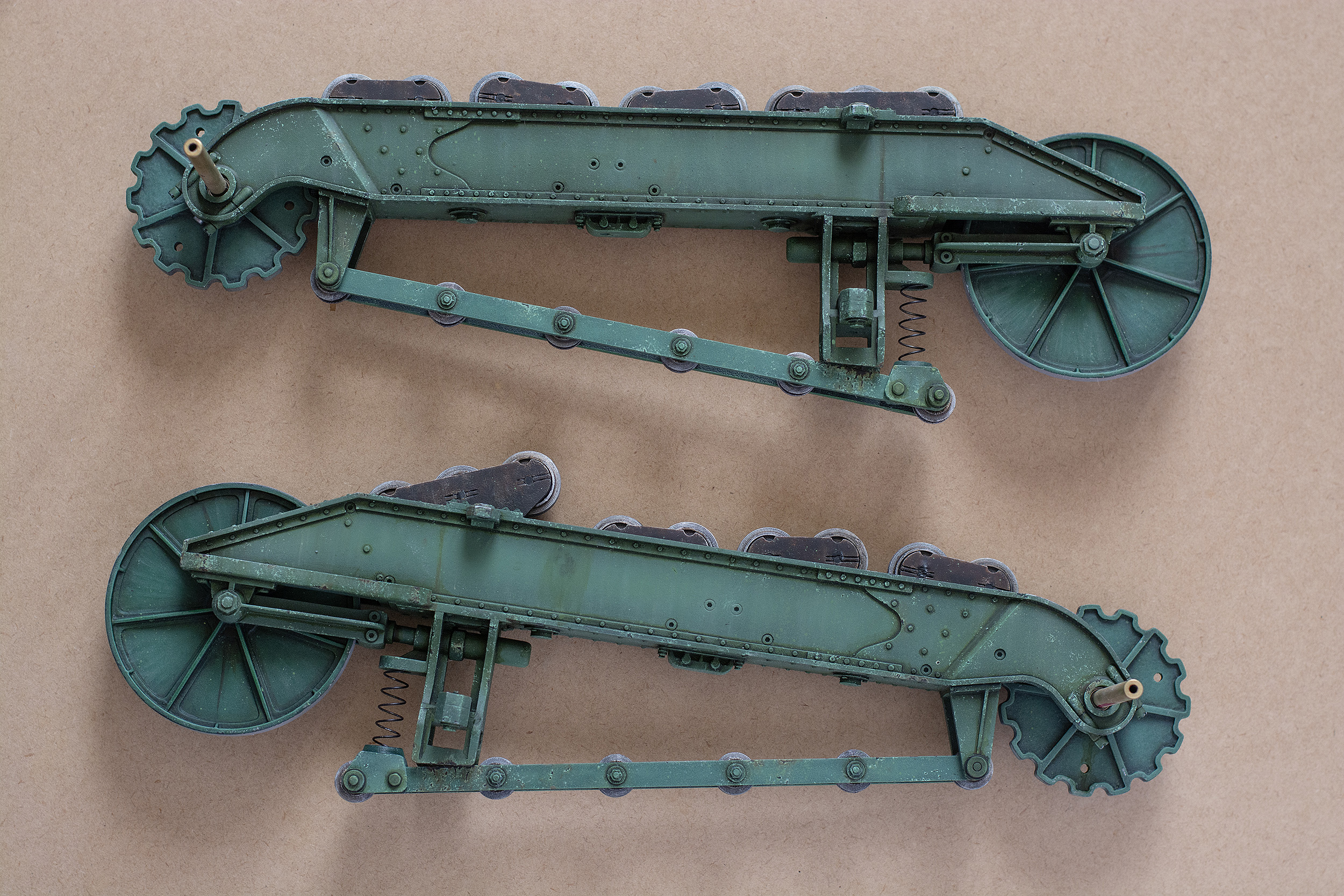

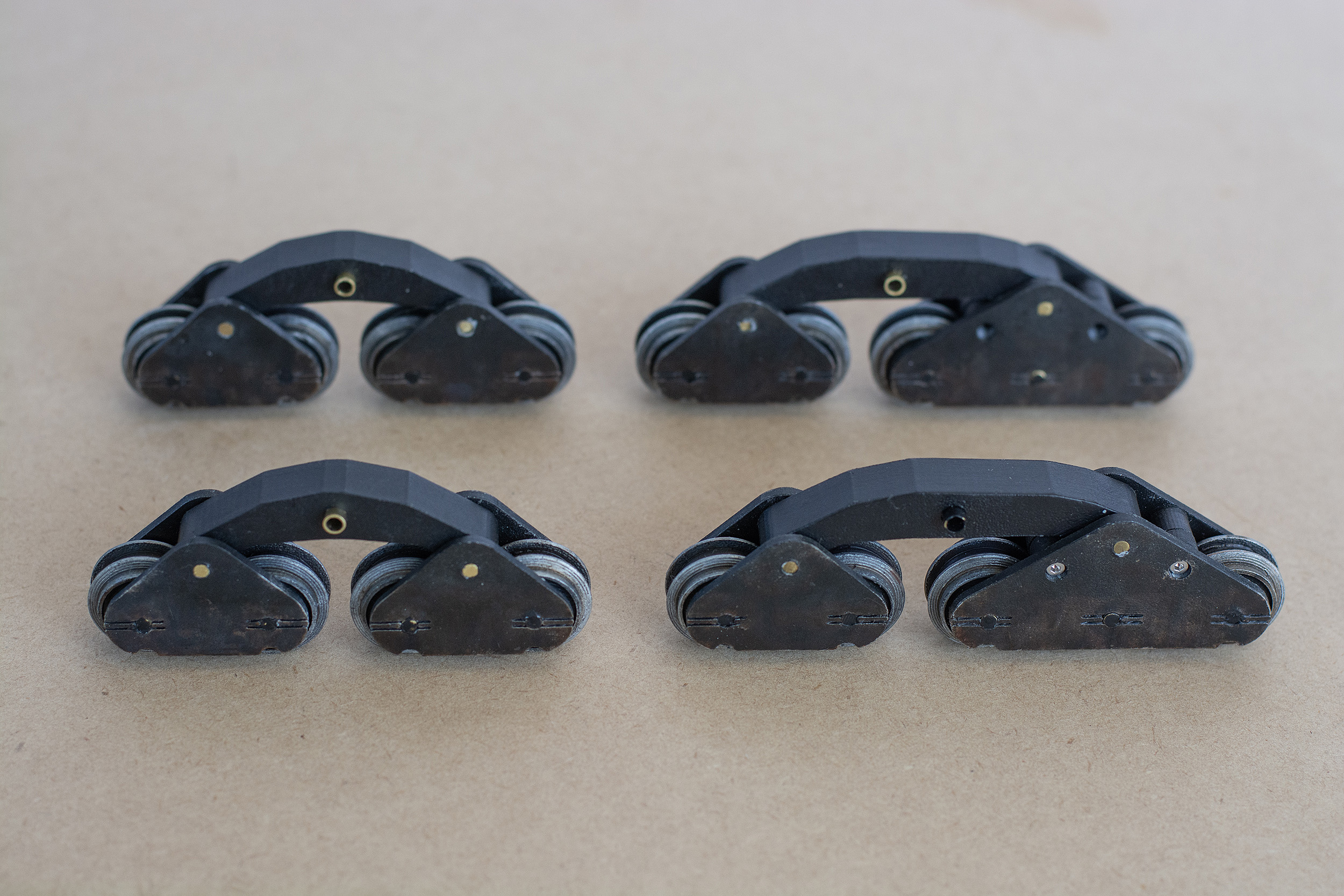

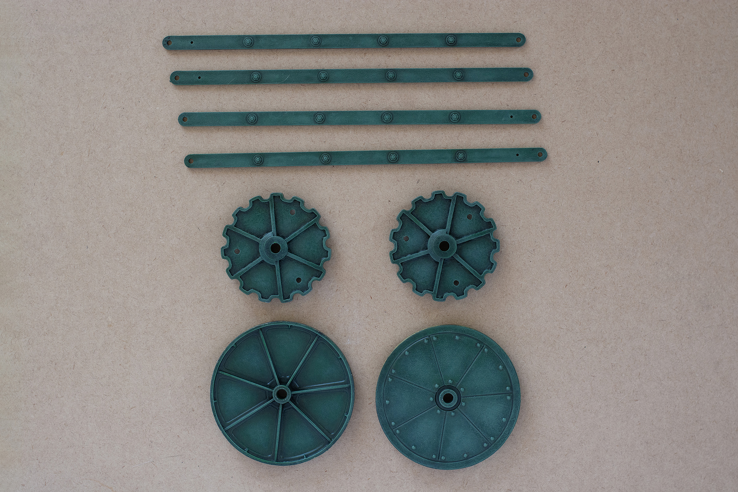

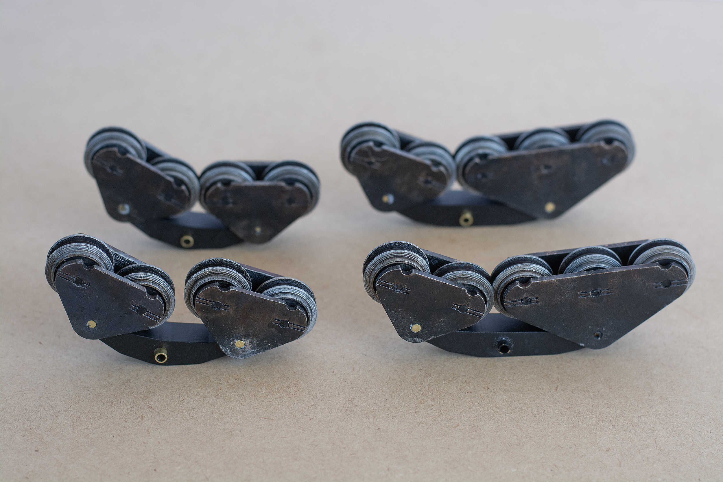

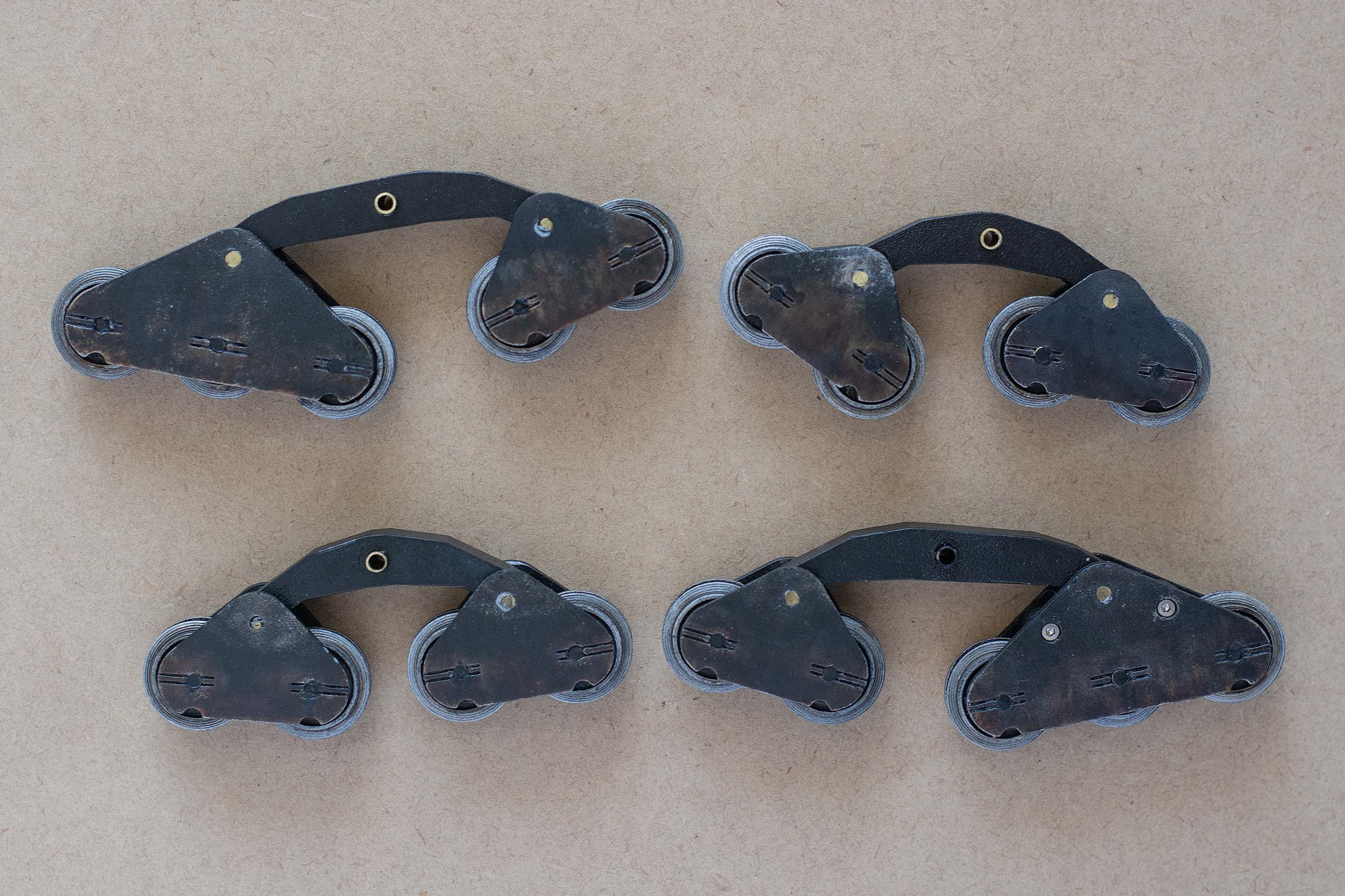

Update on the progress on the FT17 over the last few weeks: Some work has been done on the tank drivetrains, including painting the sprockets and idler wheels in verde osucre, and assembling the bogie units.
I don't think the colour is correct, even if it's called verde osucre.

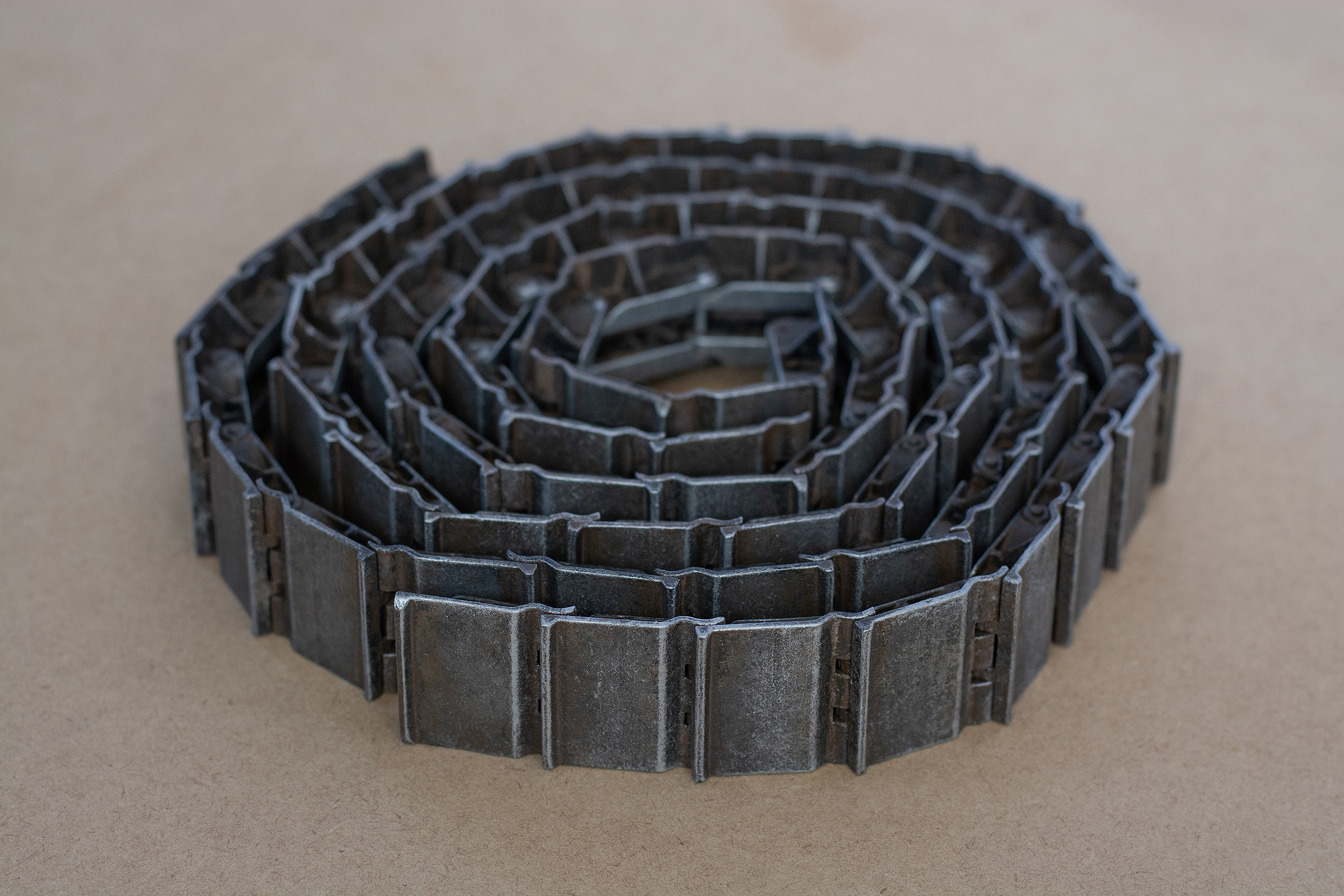

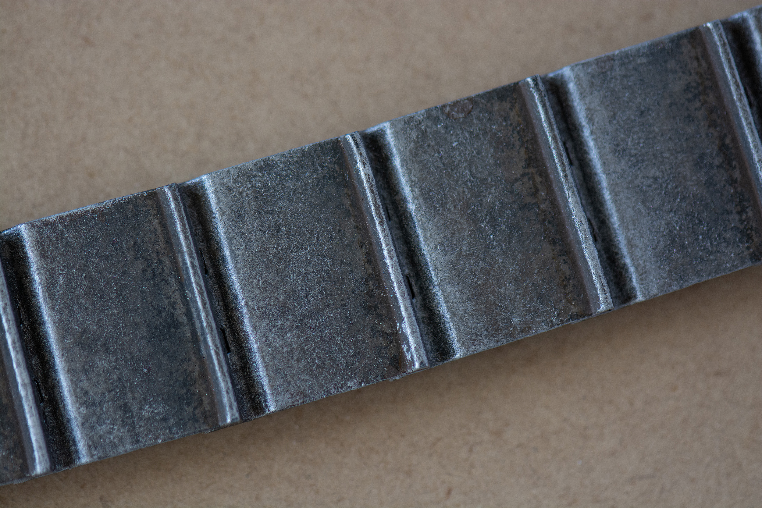

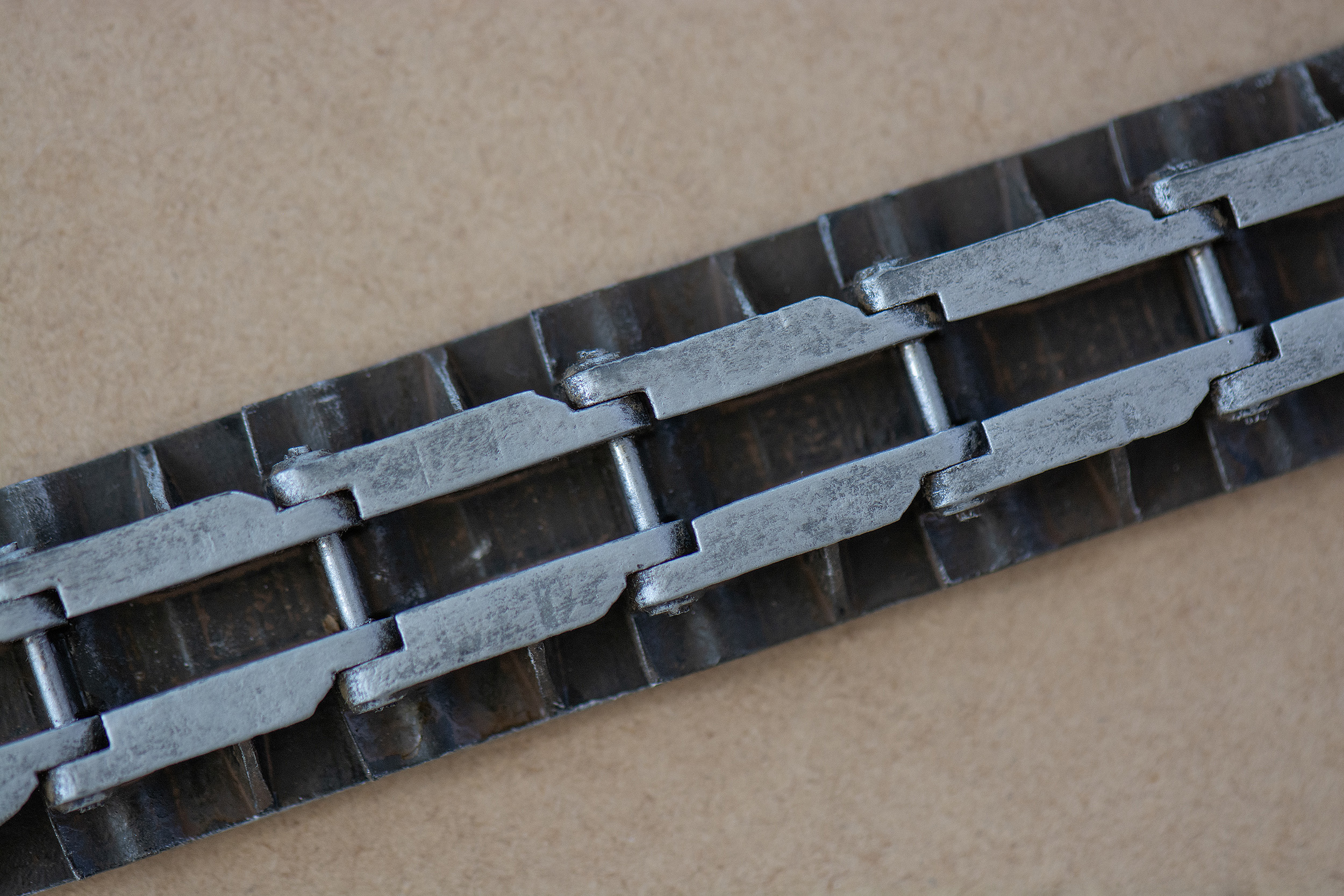

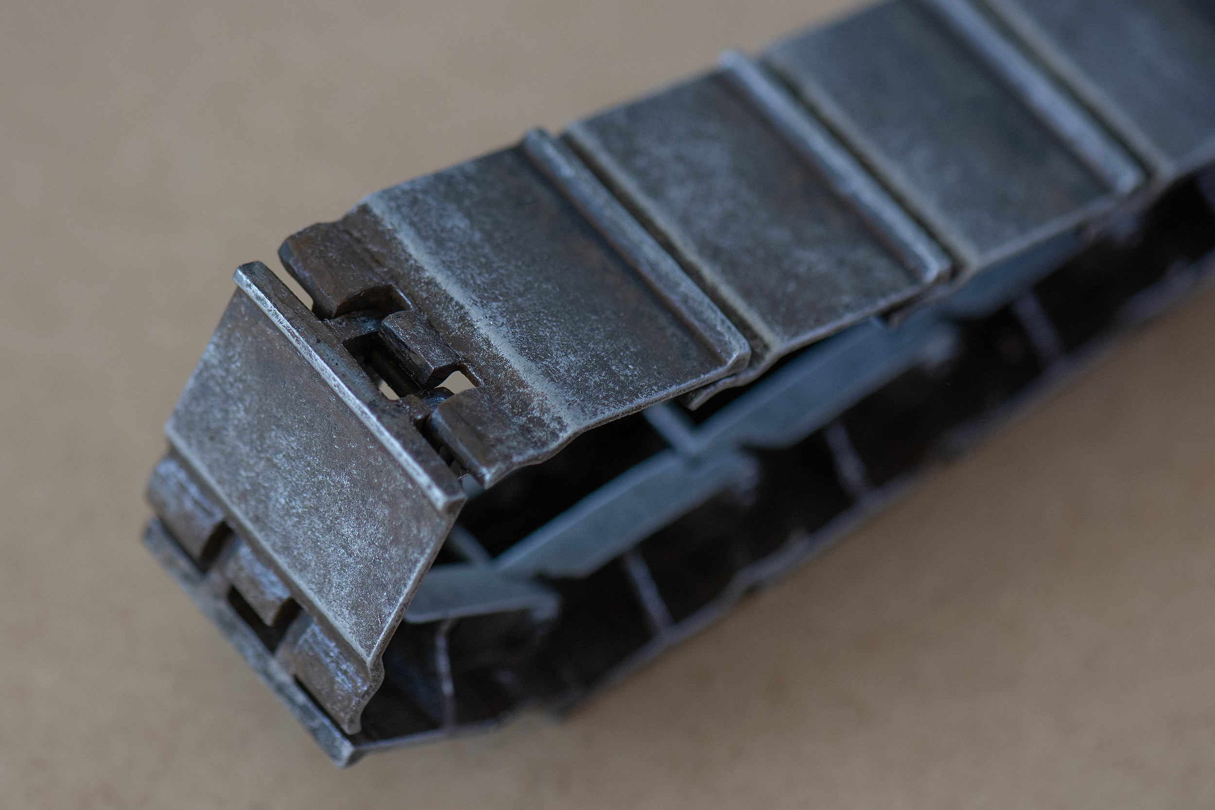

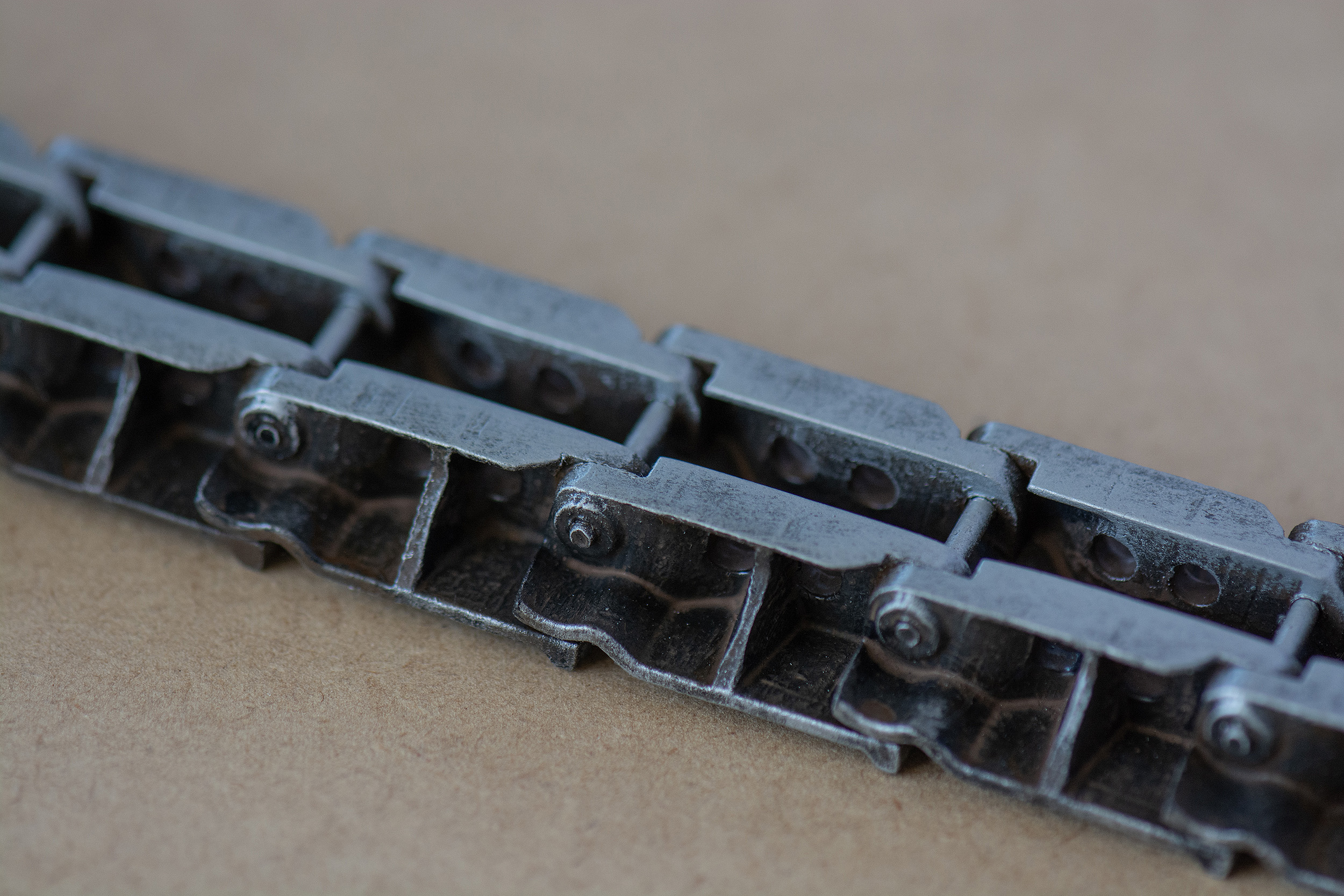

Tracks fully post-processed, assembled, and painted. You wouldn't say that it is 3D printed :D

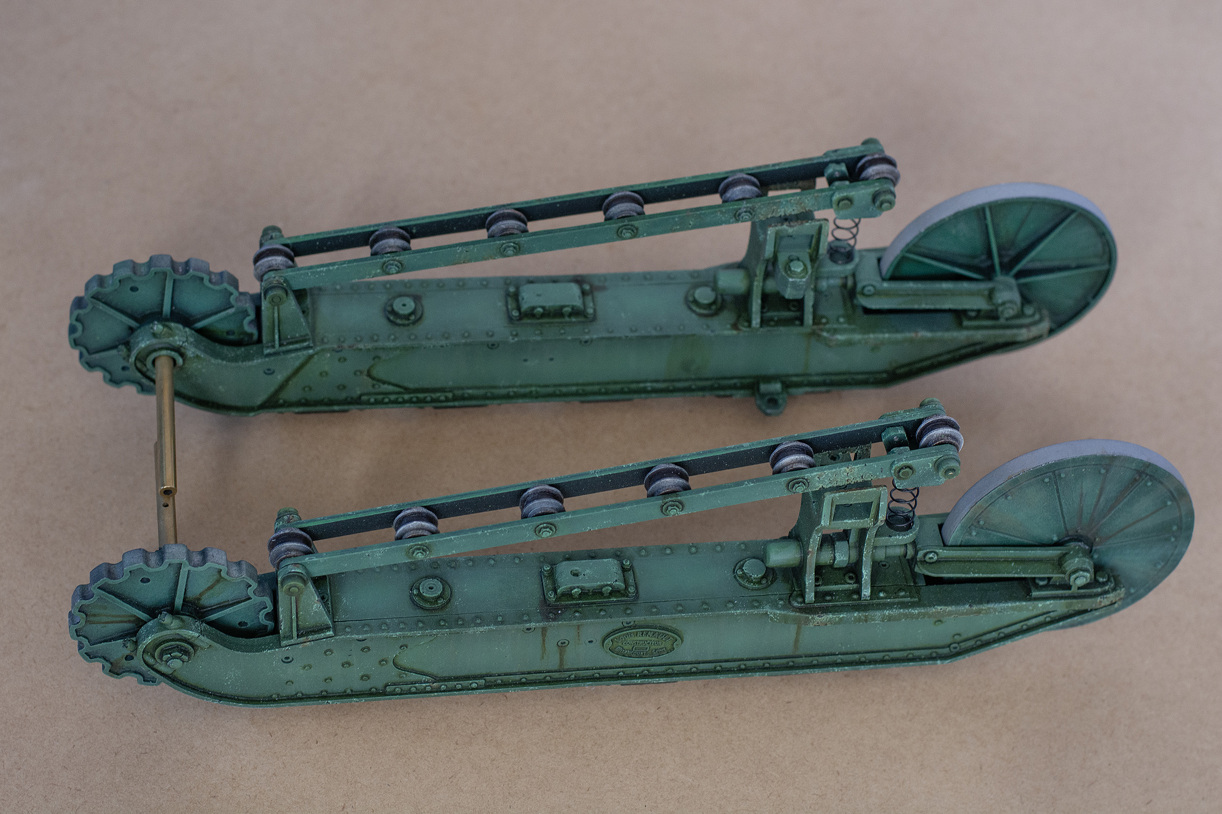

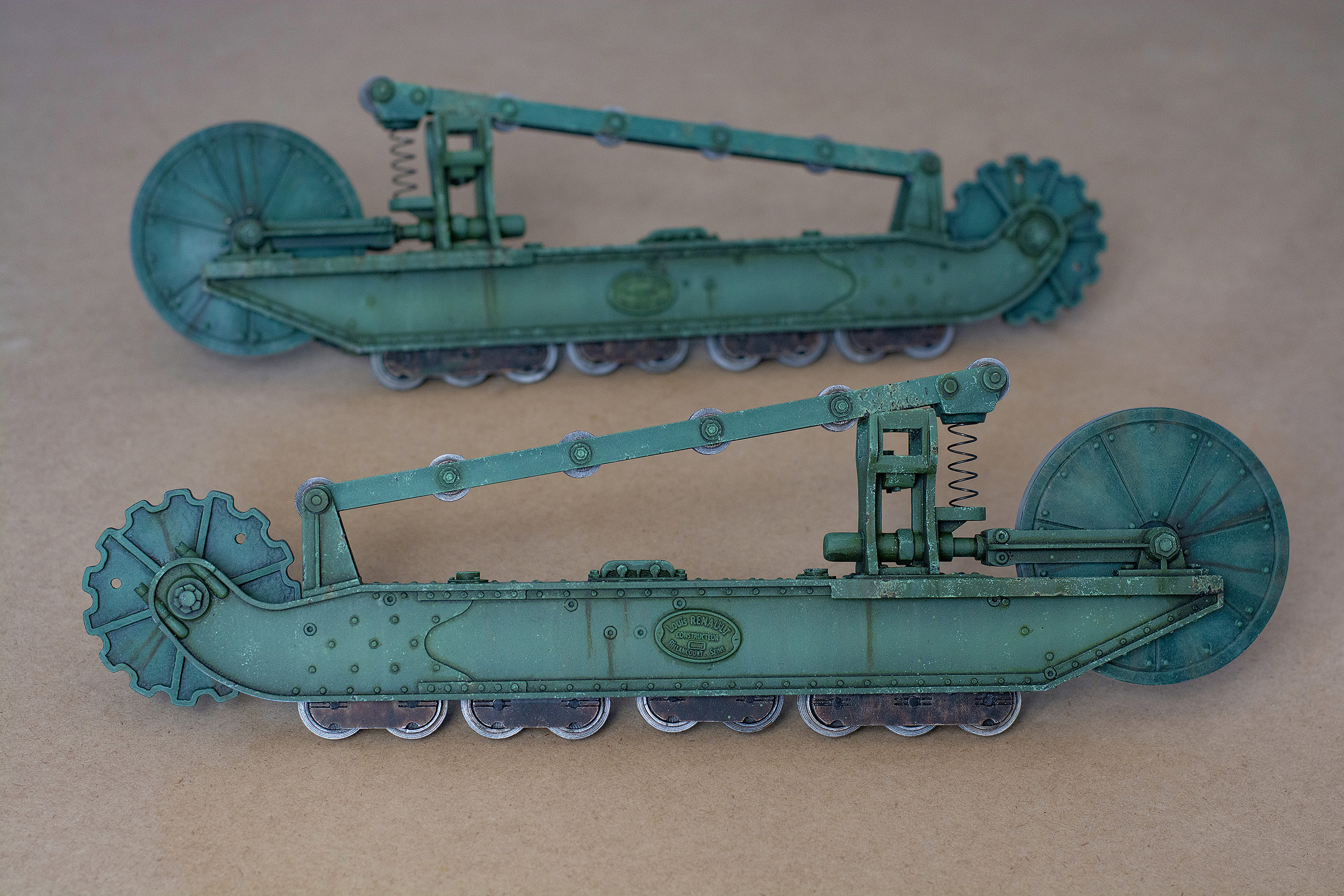

Drivetrains have been partially assembled before painting. After painting and weathering are done, it is time for full assembly.
I corrected the colour a bit too.

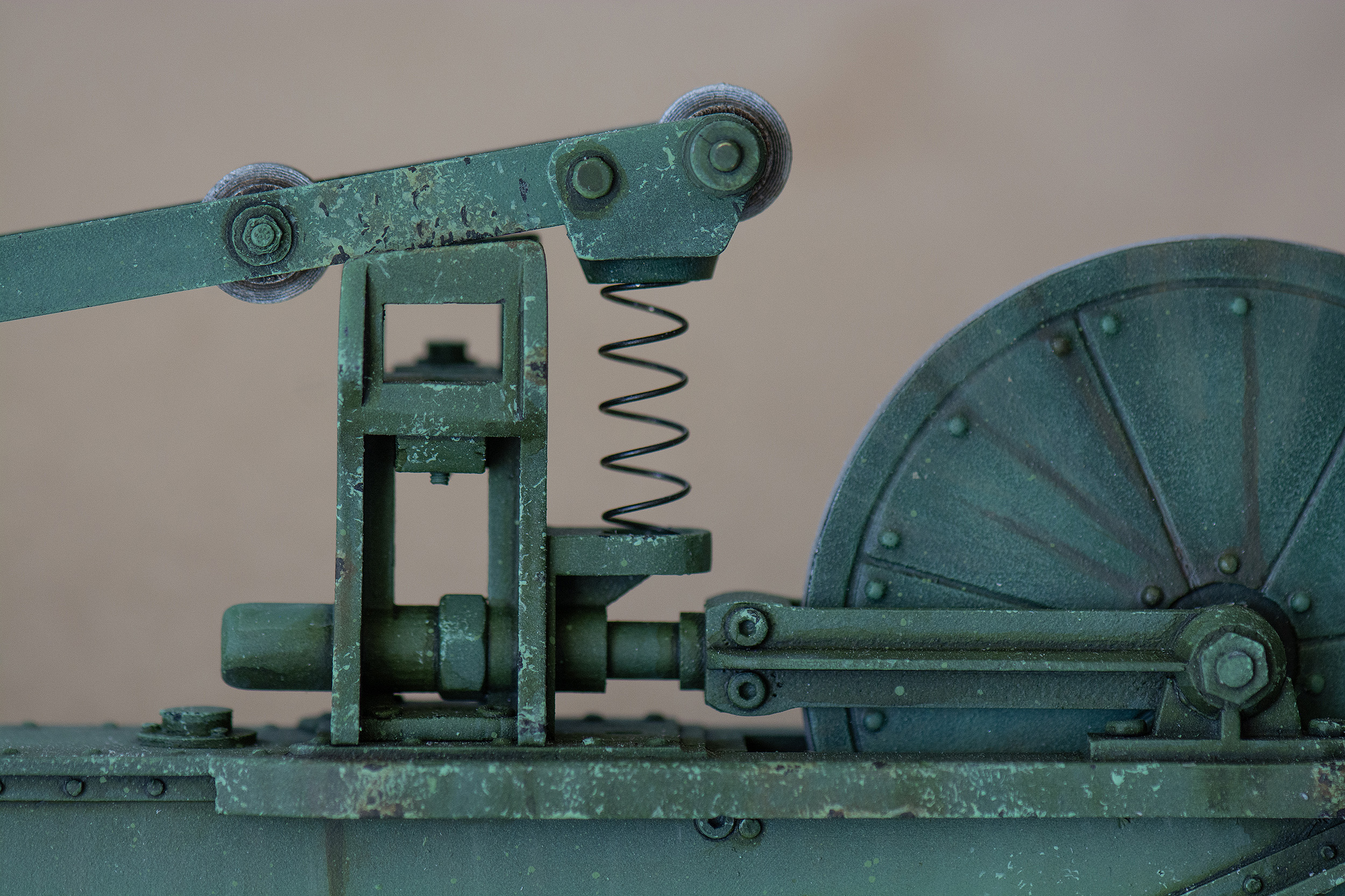

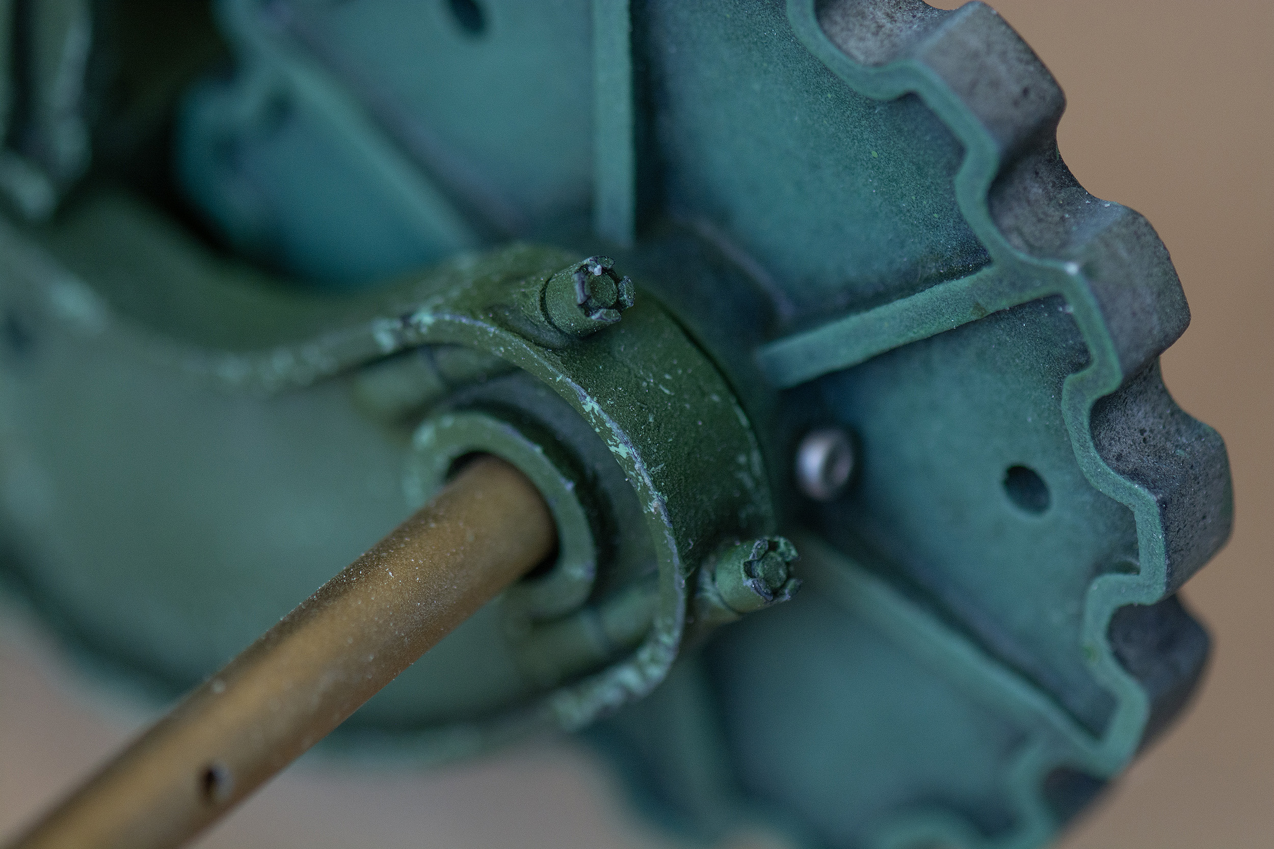

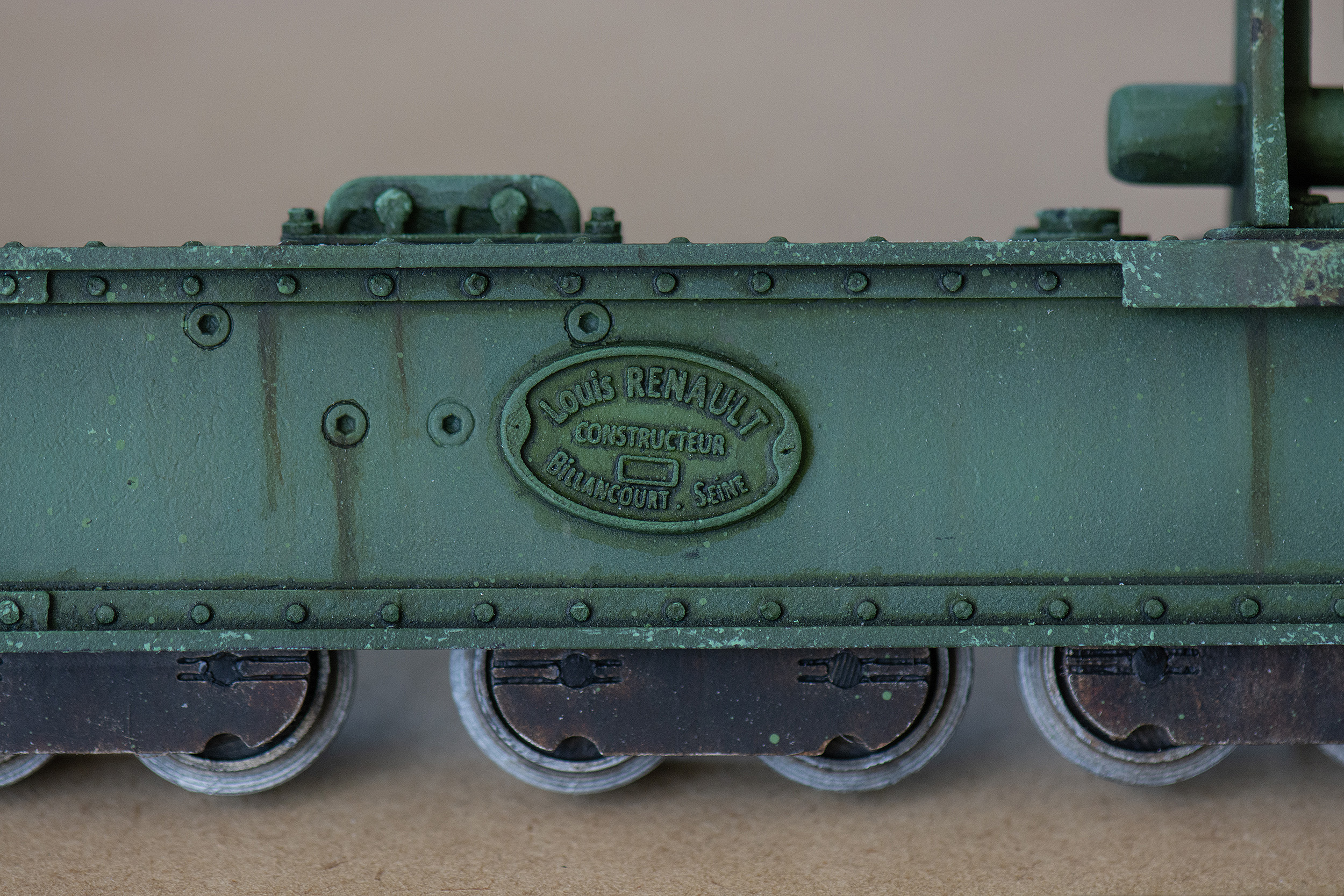

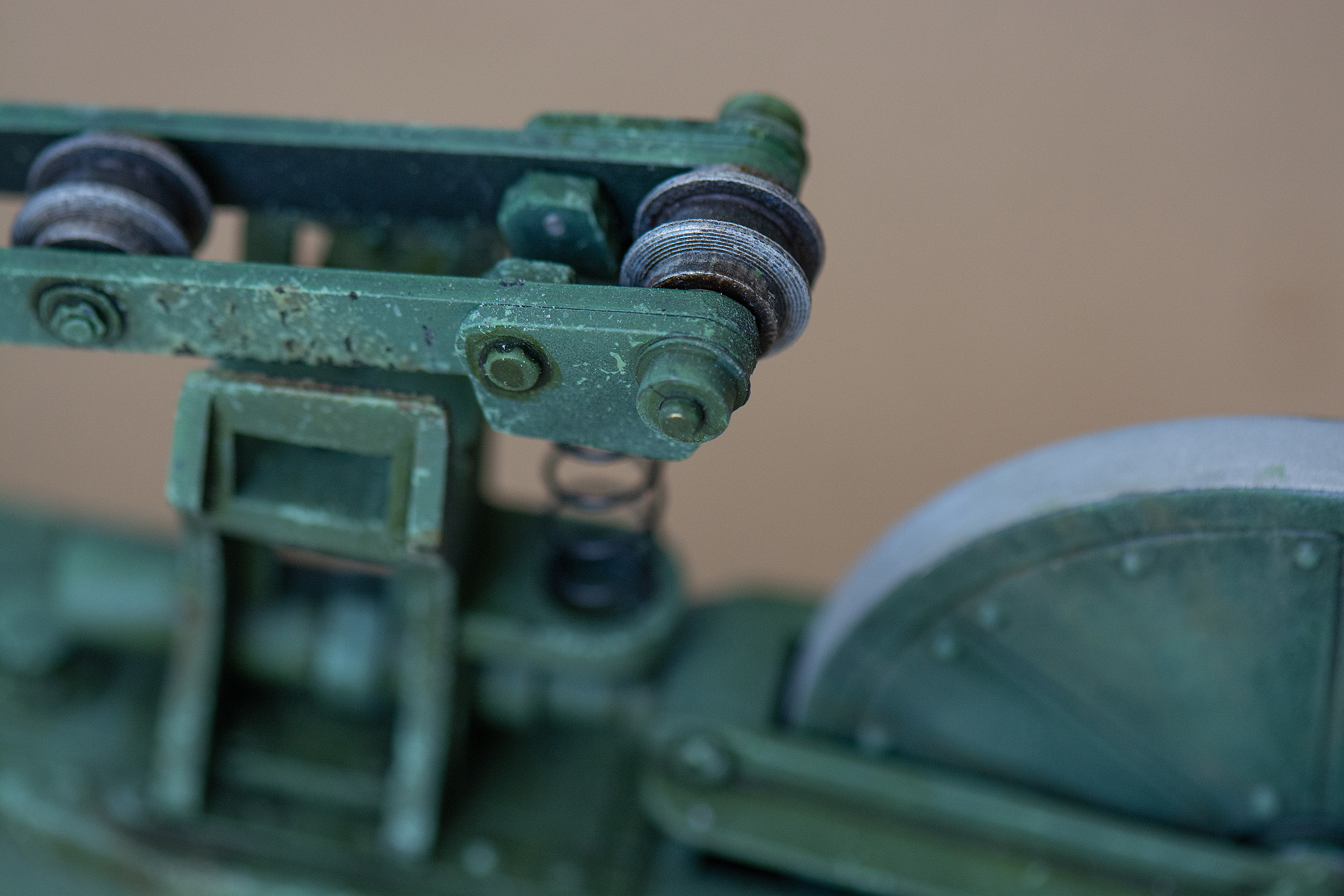

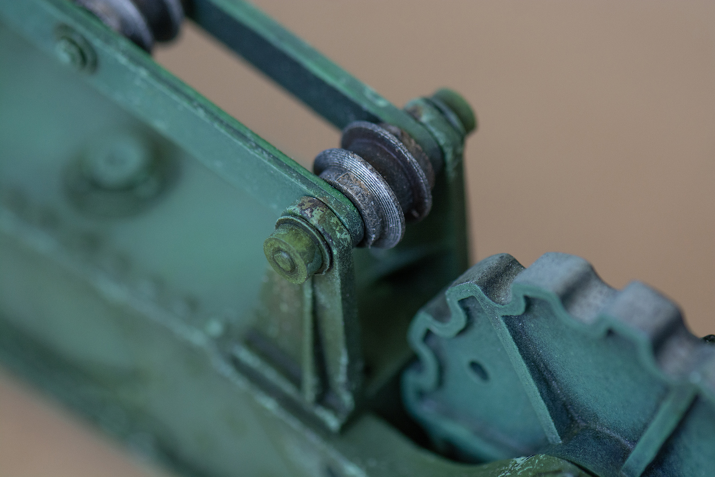

And as the last images for today (it is 11 pm here), some close-up details.

Those tracks look so metally mate :clap:

Stormbringer wrote: Sun Oct 12, 2025 11:23 am Those tracks look so metally mate :clap:
Thanks, it was a bit of work for this week :D .

This is a fantastic build!
I love the way you're post processing your 3d prints, parts look so clean!
The Renault FT always has been a fav of mine, yours is going to be stellar.

Art: that compliment from MonsieurTox is noteworthy: he's a master modeler. Wow! And Alan is right: how did you accomplish the metallic look of the tracks? Double WOW!
