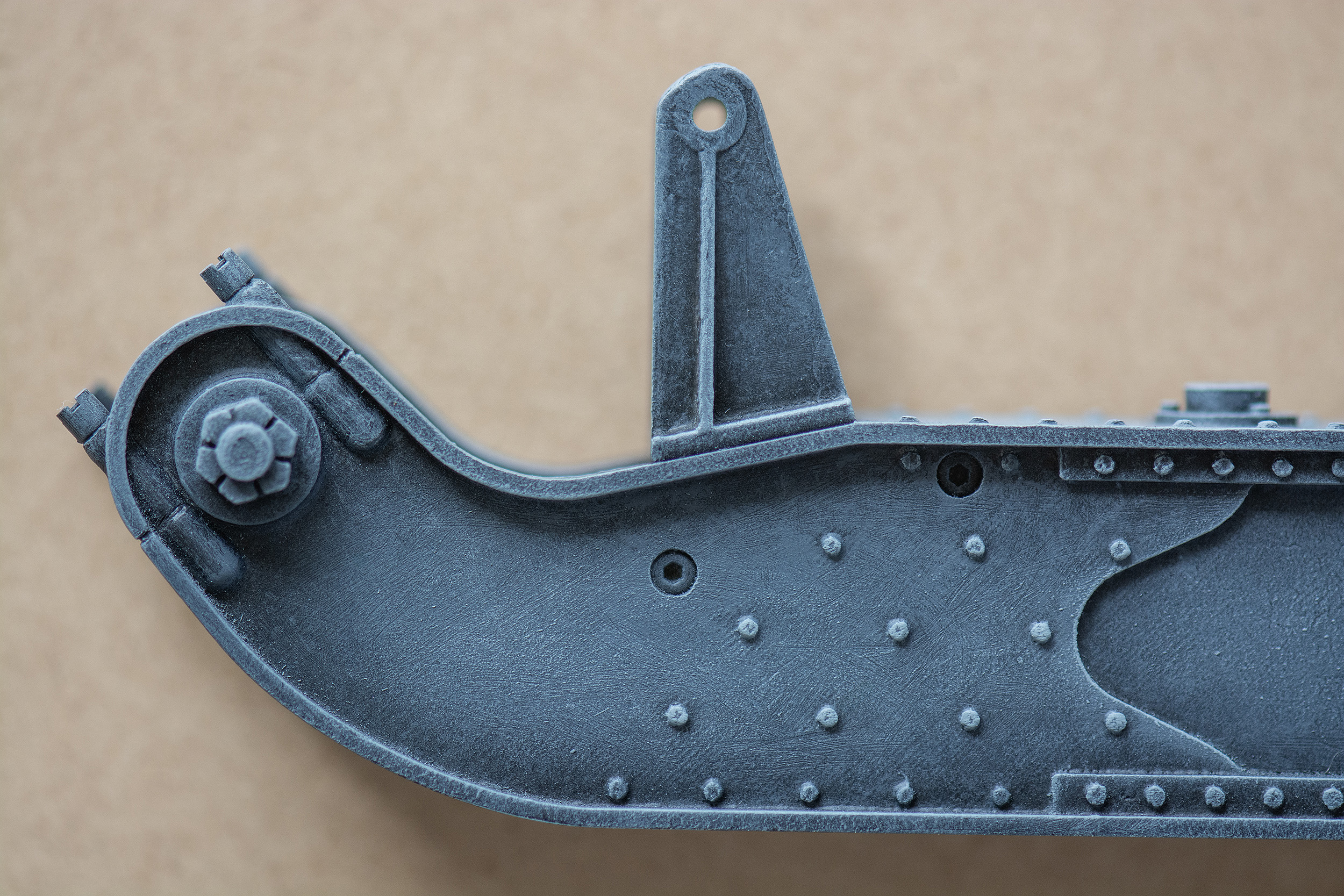

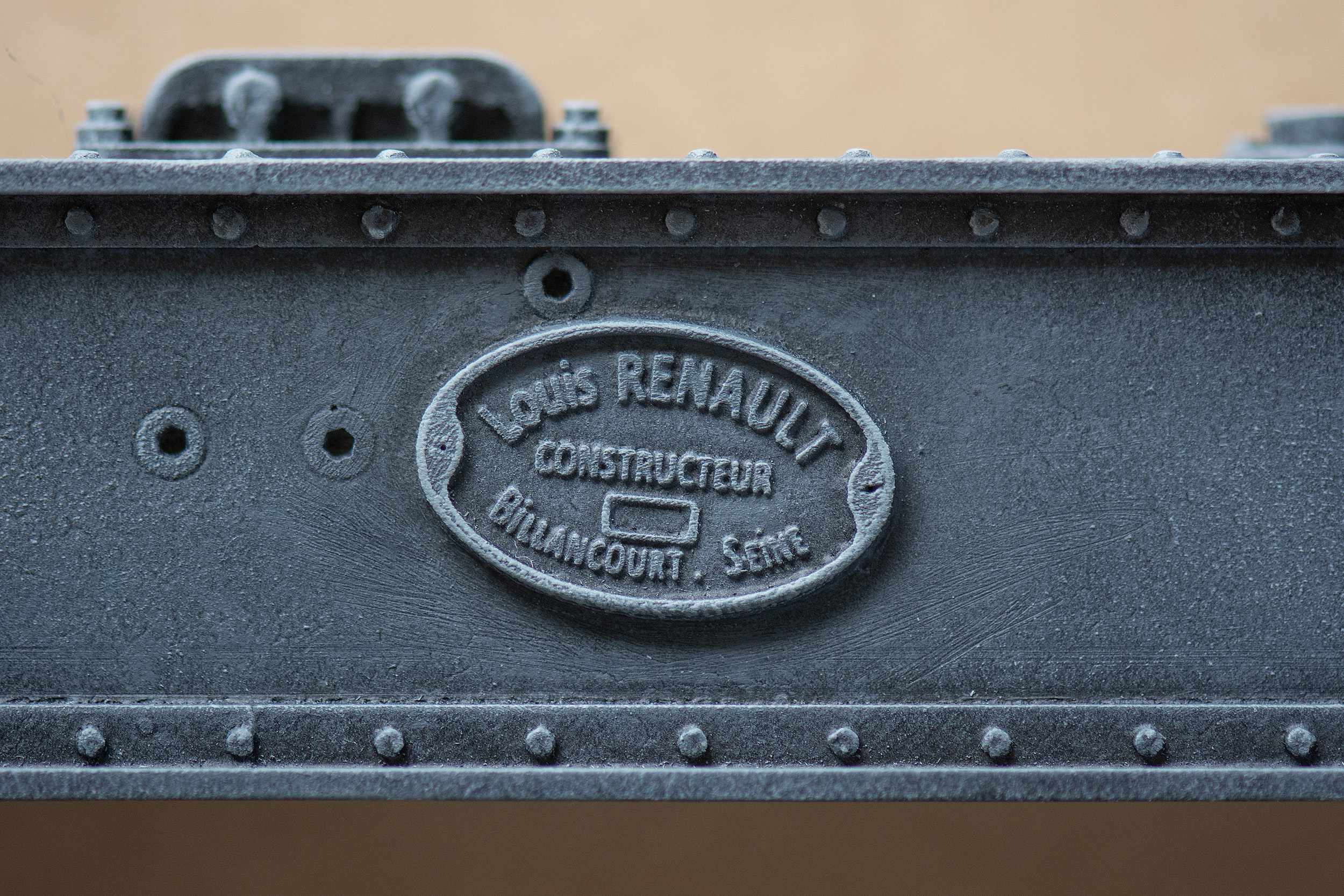

There are some close-up details. The next step before painting is to assemble wheel carts and put them in.
DSC_1611 copy 2.jpg (1.45 MiB) Viewed 1203 times
DSC_1609 copy 2.jpg (1.76 MiB) Viewed 1203 times
