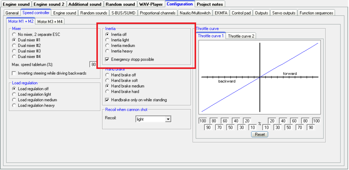

Love my Beiers but I really miss the El Mod Fusion Pro like the one in my Tiger. It allows the tank to coast to a stop when you let off the throttle. The Beier just stops dead in its tracks when the throttle is released. I prefer true realistic driving capabilities.

Beier does have the inertia option.

I thought I tried that setting without success but I’ll give it another try.
