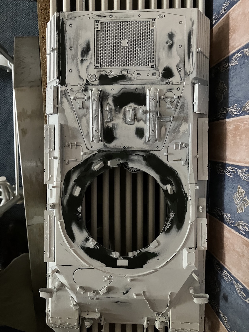

Oven cleaner but wear gloves !!

MrChef wrote: Tue Sep 02, 2025 5:33 pm Yeah a paint stripper will help you out a lot with that. I didn't notice the issue in smaller pictures on my phone.
People swear by the Testor's ELO stuff although its a bit pricey-
https://www.hobbylinc.com/testors-easy- ... ver-542143
Now lets try to figure out what happened with your paint so it doesn't happen a second time.
Whatever people say DO NOT try Brake fluid. I did, and it was the wrong thing to do and not worth it as well as cleanup.
Yeah, brake fluid eats plastic and paint. I have also heard oven cleaner works.

Welcome to the incompetent world of Meter Rat. :headbang: Went old skool. A further two hours with wet and dry, used wet got it back to good plastic, and sound paint. I am rather pleased that I made such a cock up, as it has allowed me to address a lot more issues that were highlighted.
Grey etch primer on tonight. And then try not to rush.

Really hope the priming goes smoothly for you mate as that was a lot of hard work to get it back to that stage :thumbup:
do you think maybe a lower coat hadnt dried properly before you put next coat on ?

The paint came good in the end. Much sanding and filling was required. Made up a new mantlet cover but again unhappy with it so will make a new one.

That really does look a lot better mate :thumbup:
