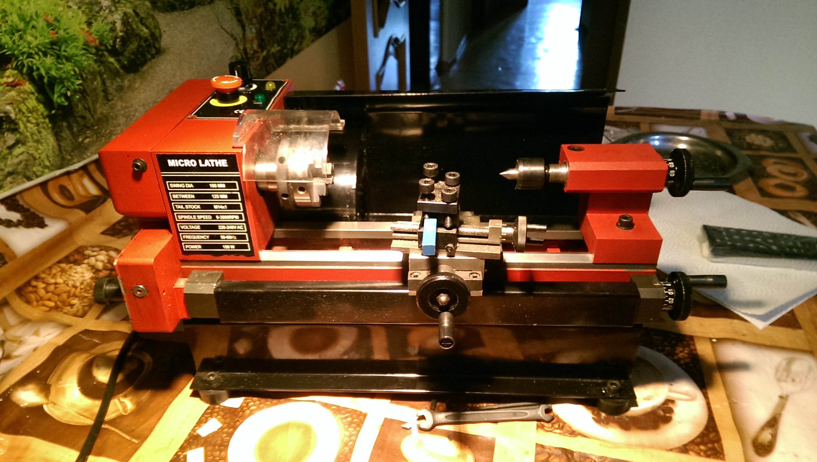

I have been using a BD-3 clone for many years....
A great little machine, I bought professional cutters for it and sharpen metal, plastic, wood...
If you have a little money, buy the original, there is no need to correct minor flaws of Chinese craftsmen...

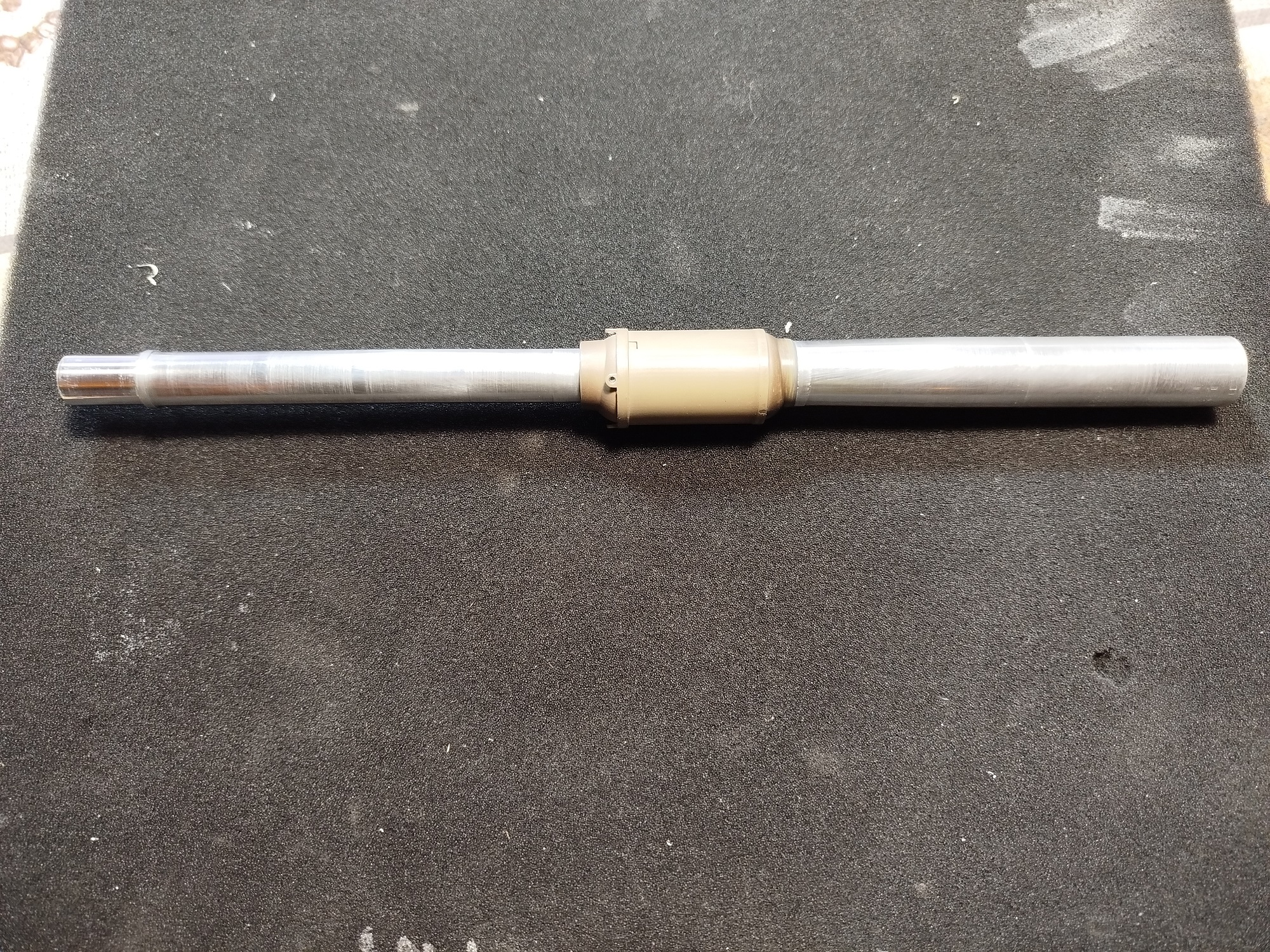

I also turned the barrel on this machine for the Merkava, all the rollers, removing the unevenness... A lathe is a necessary thing in the arsenal of a modeler!

Pavels lathe, shown in the picture above , although small is what I would call a "proper" lathe.
It has inverted "V" guide for the saddle and tailstock and what appears to be a cast iron bed (the bed of A lathe is the main body that supports everything else).
A cast iron bed bed is what you want for machining steel as this imparts rigidity. Lack of rigidity causes vibration and a poor finish.
I expect a lathe made from aluminium would be ok for plastic.
