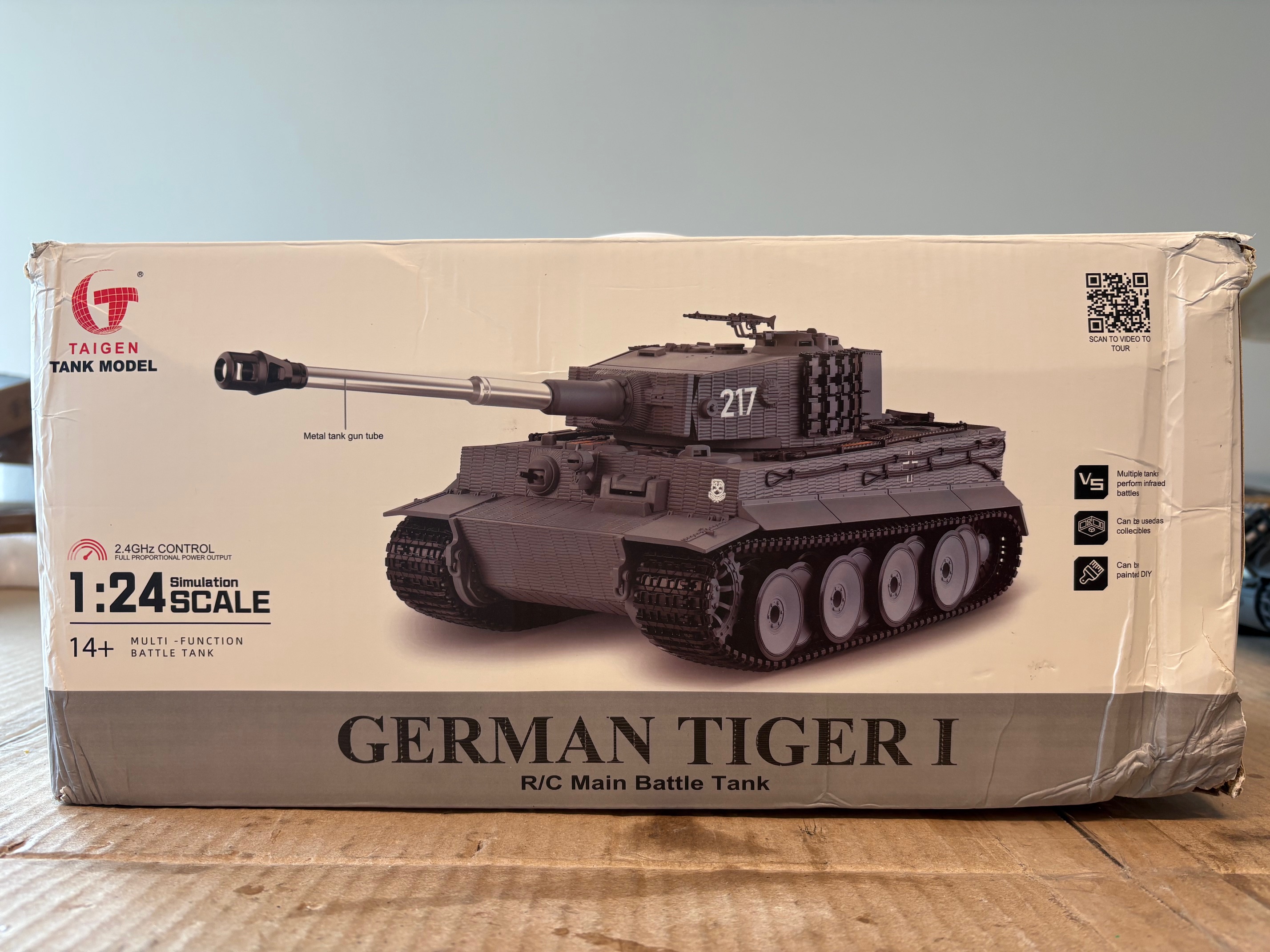

Hey !
I've received mine this morning and have been reading your thread with the utmost attention and decided to create an account to answer !
Good job on the controler ! That's quite a good idea, I'm thinking about simply crafting something in order to physically limit the joystick's amplitude.
I've been quite surprised to see you could use the VSTank tracks! Sadly there are none available in my area and the only ones I found required me to pay more than their price in shipping so that's a no go.
I wonder why no one ever thought of making some through 3D printing...
I'm wondering if there is a way to replace the main board. I already own a Forces of Valor T-34 and a VSTank KV-2 (with Clark's Electronics TK22) and this model's IR system is incompatible with them.

I watched the video and laughed so hard when you said "it does donuts" 🤣
I got mine for 100€ but it's the forest camo version, I wanted this one because it reminded me of the Tiger 1 of Vimoutiers on which I spent whole afternoons playing with my brother 😊
The paint job is indeed amazing for something out of a factory. The worker got a bit heavy handed on the "brush" weathering but from afar it looks incredible.
The only real issue I have is that by default it's far too fast, even with the default rubber tracks it feels like an RC car with tracks. It's very fun to drive but not very realistic...
The fact I can't play with my T-34 and KV2 kinda bugs me out too... Which is why I'm thinking about replacing the internal electronics with a HL TK-71. If I understand correctly it has a slow run setting and can work with FOV and Clarks IR protocole...
I'm just unsure of the amount of work required though, most connecters seem to be the same judging from your diagram...
