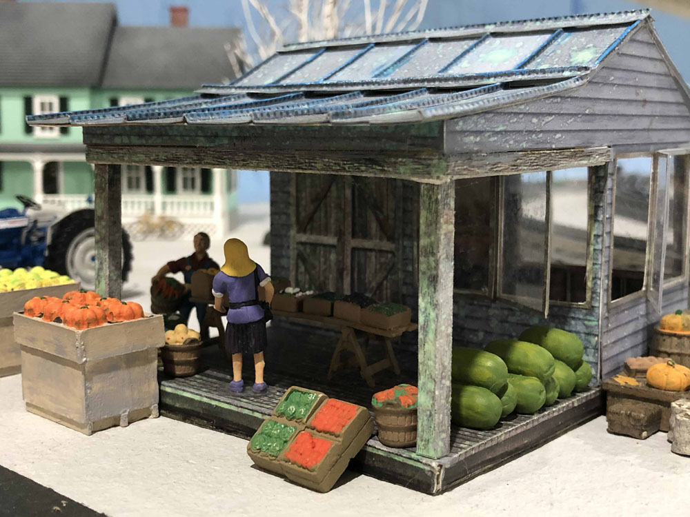

Thank you for the video links! I have them loaded up to watch after I sign out. I have done some work with photo-etch as well as some paper modeling in 1/48th. Photo etch is not so bad as many say. Paper modeling is for people who are young and don't shake.
Here's the fruit stand on my O Gauge train layout (the fruit and figures are resin):
FruitStand RCTW.jpg (194.3 KiB) Viewed 52931 times

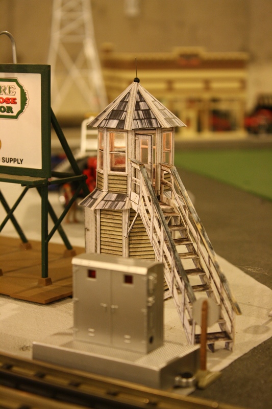

Here's the octagonal crossing tower of Milwaukee Road design, supplanted by a modern signal controls box:
Gateman's Tower.jpg (180.83 KiB) Viewed 52931 times
