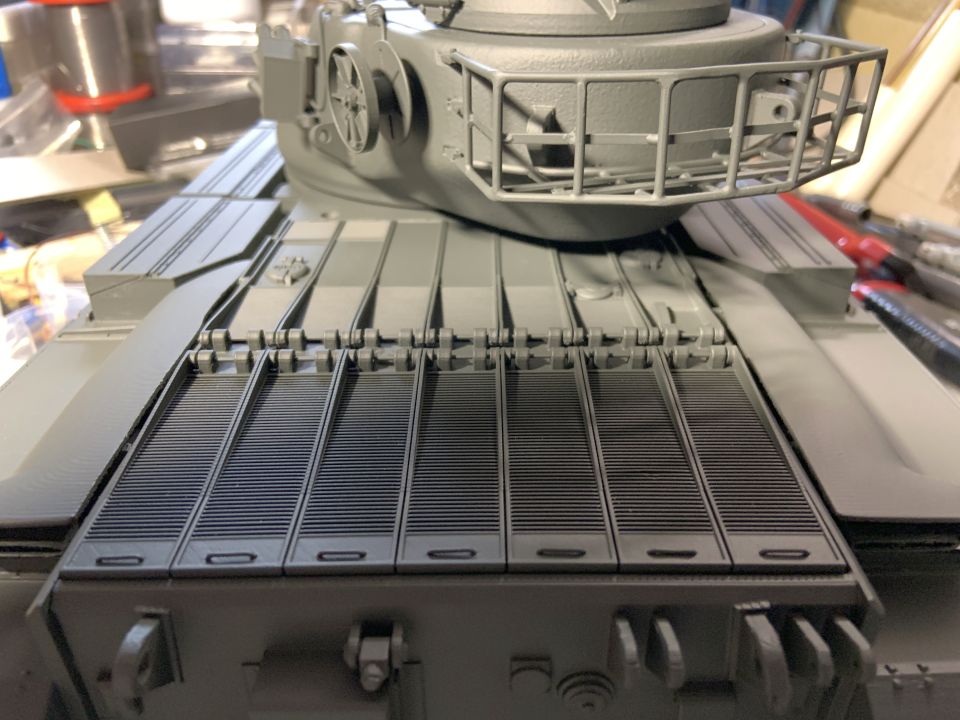

I have redrawn the headlight lens and printed from crystal-clear PETG.
Some of the parts of your Conqueror look very rough, I wouldn't use anything like that.
Here are some improvements I have made:

Re: British Cold War Conquerer Tank.
That turret bustle is a thing of beauty Mr Jhamm
The Conqueror is a mighty looking AFV thats for sure
yes it is:HERMAN BIX wrote: ↑Thu Mar 06, 2025 7:06 am That turret bustle is a thing of beauty Mr Jhamm![]()

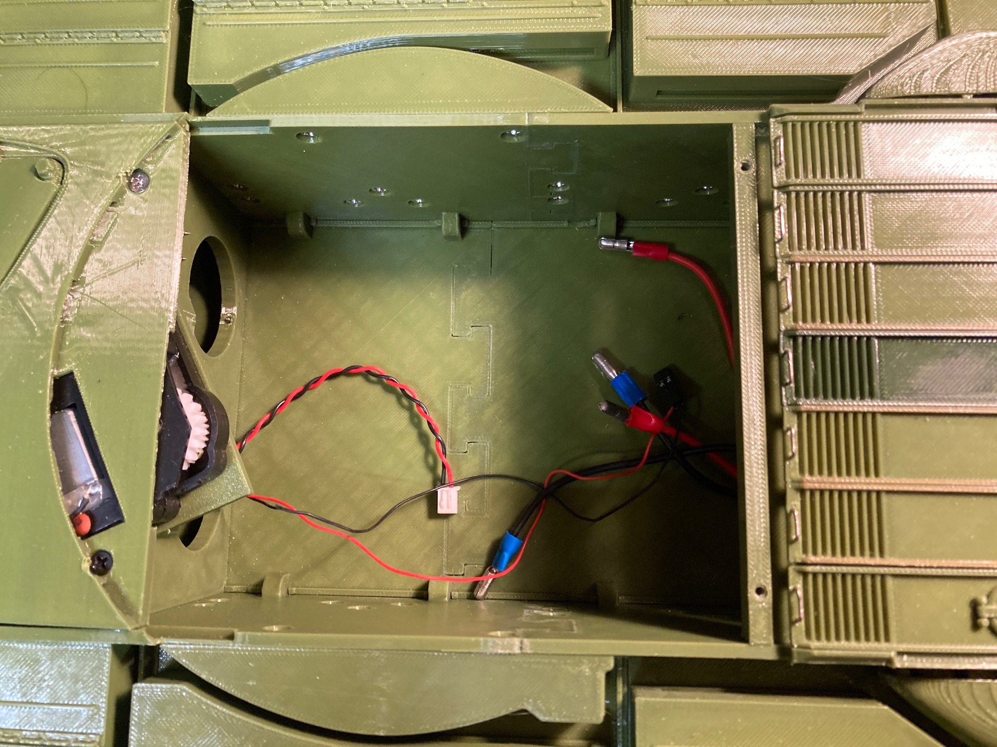

British Cold War Conquerer Tank. Well Engineered Model.
Only two screws need to be removed to allow access to the lower hull. Once these two screws are taken out the base that is under the turret ring, it can be slid backwards and lifted off with the turret attached.. This will make for very easy battery changing, and it should be even easier to achieve if magnets can be used to replace these two small screws - and this looks like it will be easy enough to do.
Unlike the Heng Long tanks that need the retaining screws to maintain the structural rigidity (by keeping the top and lower half of the hull securely aligned), this models hull strength is unaffected by the removal of the "top deck" and is remarkably stiff and twist free. Very impressive - no need to worry about making any hull reinforcement's on this model.
I also noted that the large sections of the hull are all screwed together, so it would be relatively easy to take it apart and reprint any sections that became damaged or that needed any major repair work in the future.
My knowledge of 3D printing is absolutely zero, so I have no idea how well the materiel that has been used to print the chassis and turret parts will age, but at the moment the plastic feels like it is very tough and strong and should take some hard use, so I have no concerns at all about this part of the tank.
What I do have some concerns about are the tracks and the drive sprockets as these components are also 3D printed. I have no idea how well they will stand up to regular use when being driven around, but I hope they will be strong enough to enable the tank to be driven and enjoyed. Maybe if this tank becomes popular enough, somebody will make a pair of drive sprockets in metal - or maybe something already exists that can be fitted and used (?)
I am aware that 3D printing in metal has already been achieved so there is even a future possibility of having a pair of metal drive sprockets 3D printed...and possibly track links too!
- Only two screws need to be removed to give access inside the hull.
- 89A8E4C9-F810-4423-86DE-2B14764F8493.jpeg (805.58 KiB) Viewed 1589 times
