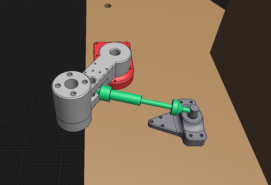

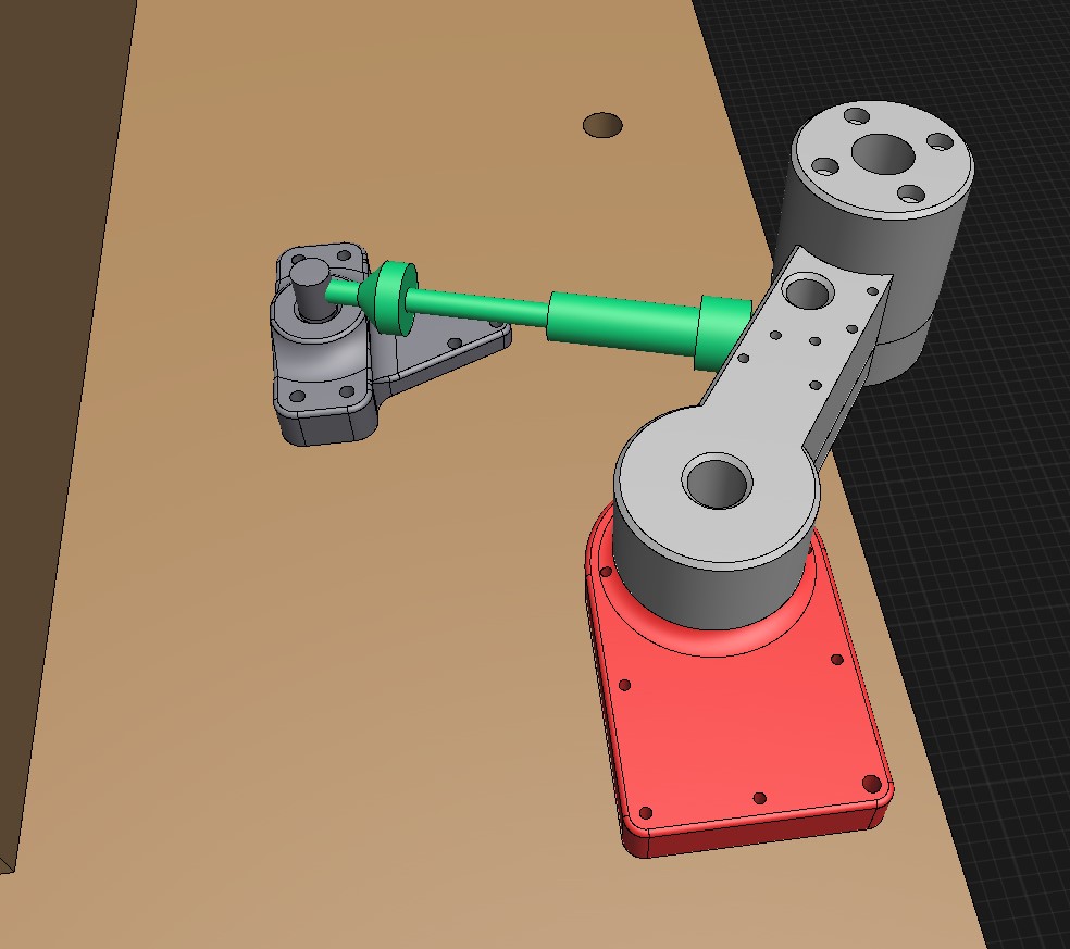

oh, sorry, my bad, i include a screenshots from my 3D modeling program. I find this as easyest way to make a suspension for it. Green part is shock absorber, made just for example.
So reather than using RC car shock absorber i should watch for ones from like scooters, minibikes or something like that? Thats interesting, i like it o-

If you can find a spring to go over that shock that should be enough, what is the diameter of the widest part of the shock where the spring would need to go over

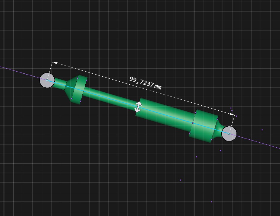

It's around 100 mm, but it's measured based on the current position of the wheels on my 3D model. Specifically, the position when the suspension is already under pressure, and it indicates the current height from the ground. I think I might need slightly longer shocks that will compress to the desired diameter once the weight is applied. Does that make sense? I'm not sure if I'm expressing myself correctly. I can speak english but you know, im new to this and i somethimes dont know how the things are said in my language :D im using ChatGPT to translate.
