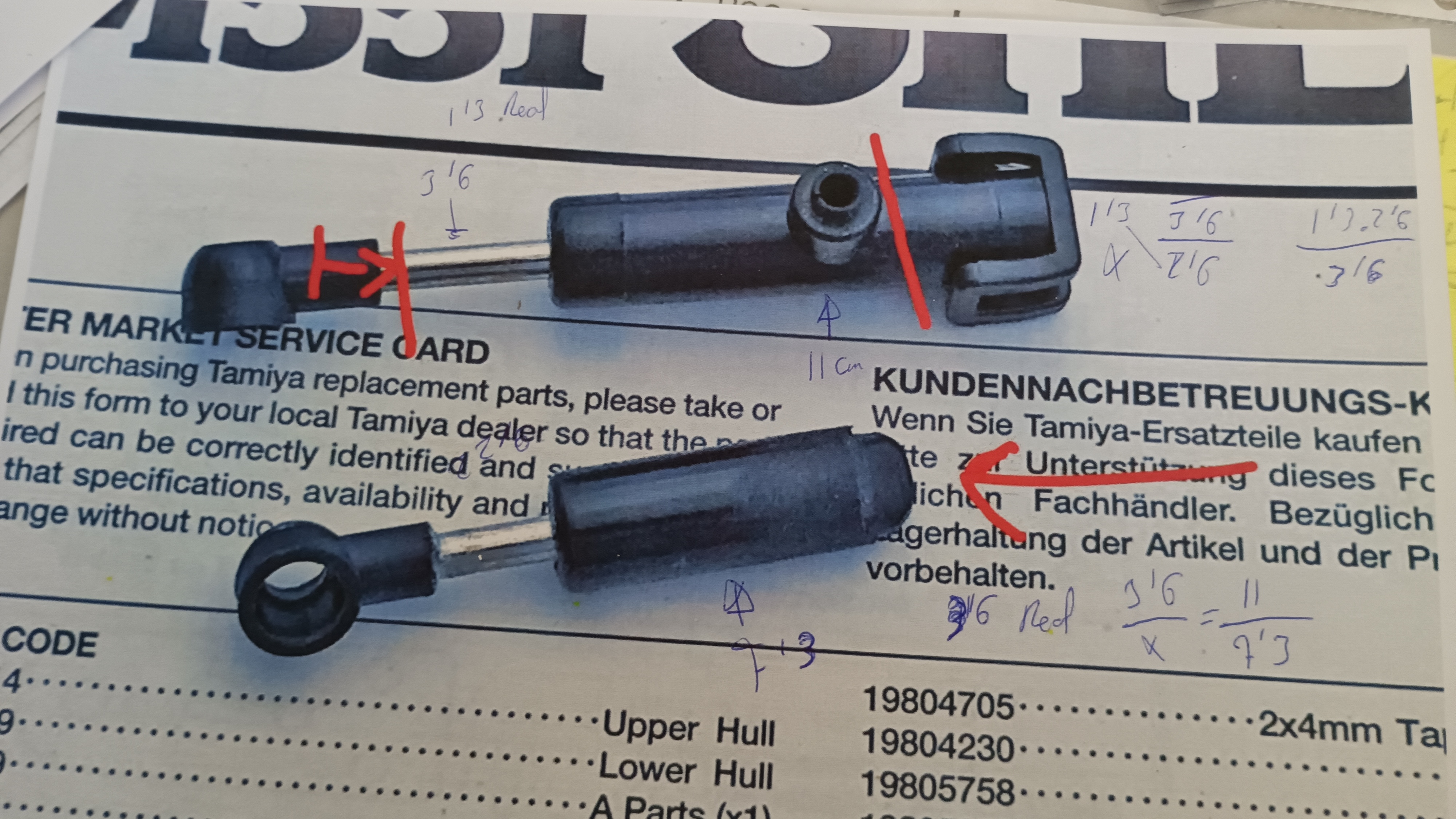

A little advance on the subject of shock absorbers. Seeing the photo of our colleague Lmcq11 (Louis) and having printed it.
I made the following rule of 3 directly with the dimensions taken from this and taking the same measurement of the real one and I got from this that the element to cut in the stem is 0'9cm to leave that size that he left.
The other size to shorten that he gave me is 2'389cm, let's say 2'4cm rounding.
This afternoon I will cut the stems and shape the bodies of the shock absorbers to leave them and test the assembly of these. I will see if I can make some modification as Louis says to leave them a little functional to adjust possible movements of these.
