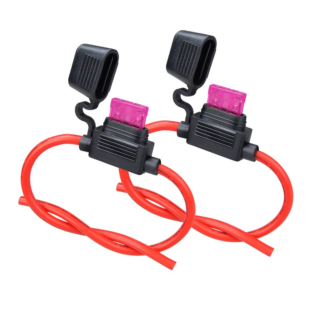

Exactly. The engine blockage caused one of the three engine windings to burn. In fact, it's even better because replacing burned an SMD MOSFETt is a nightmare if you don't have the appropriate equipment and requires more work than replacing the motor. Since replacing 8 pcs of SMD MOSFETs with weaker ones is probably out of the question (and does not make sense for the reasons given above) - it is much easier to install fuses (e.g.10A - but no more than MAX motor stall current) on each of the 4 wires coming from the MOSFET MFU - for engines.

Interesting idea with that fuses.
Definitely the best solution.
Maybe something like this, if there is enough space in the model.
