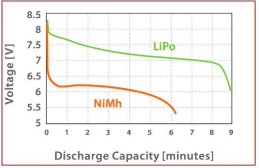

1. NiMh have lower current efficiency and a very fast voltage drop from the moment of starting with the load (driving your model).
Therefore, the MFU with your NiMh does not turn off around 7v at all, but in fact around 6-6.5v - same as LiPo ...
2. You MUST perform all voltage measurements under load (preferably in real conditions, when the model is driving - I know it is difficult but feasible). Voltage measurements after disconnecting the battery from the receiver (MFU) are distorted / unreliable (especially for NiMh) because this battery will show a higher voltage than it can give under load.
3. Use GOOGLE. Enter "NiMh vs LiPo" and select Image Search. Everything will become clear to you :)
P.s. OKAY. I will add this picture because sometimes it is worth more than 1000 words
C__Data_Users_DefApps_AppData_INTERNETEXPLORER_Temp_Saved Images_untitled(2).png
Source - Google
