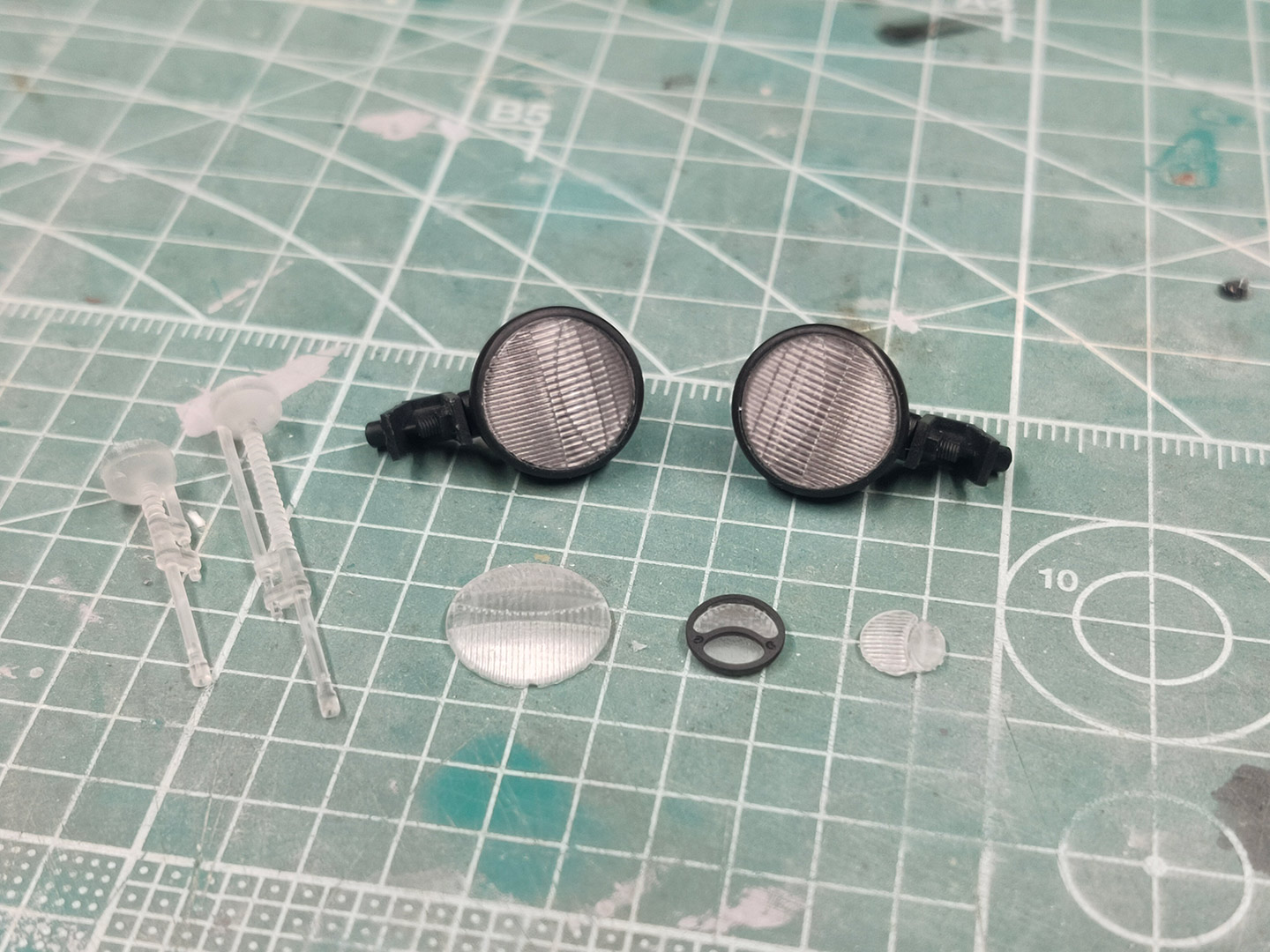

Got a bit sidetracked, I changed out the resin for some clear stuff to try the headlight and taillight lenses. While I was at it, I thought I'd try printing the hull and coaxial DT machineguns in clear resin so that they can act as their own optic fibres; I didn't like my chances of drilling out such a fine and narrow barrel for a separate one. They've got a cup shape on one side to directly mate up against an LED.
Now I just need some LEDs to test them with! :haha: I'll use SMD LEDs in the taillight so that the convoy and brake lights can be separate. It's a tight squeeze (the inside of the taillight is less than 6 millimetres in diameter), but they'll fit.

Jeez they go alright Mr Ram :thumbup:
Headlight lenses are a royal PITA to just have available when needed.
I reckon having a handful would make the getting rid of the awful H/L offering so much easier.

Whoa, those are tasty, and incredibly accurate!
Will these be available to the tanking public? Have you considered breaking into the HL factory, smashing their Russian headlight molds and leaving a giant sack of these in their place?
Mike.

Raminator: I hope you determine a price for those lenses and sell them by the bazillions so you can retire to a land of moderate climate. ;) Well, like ColemanCollector Mike, I sure would be interested in a few dozen of them.

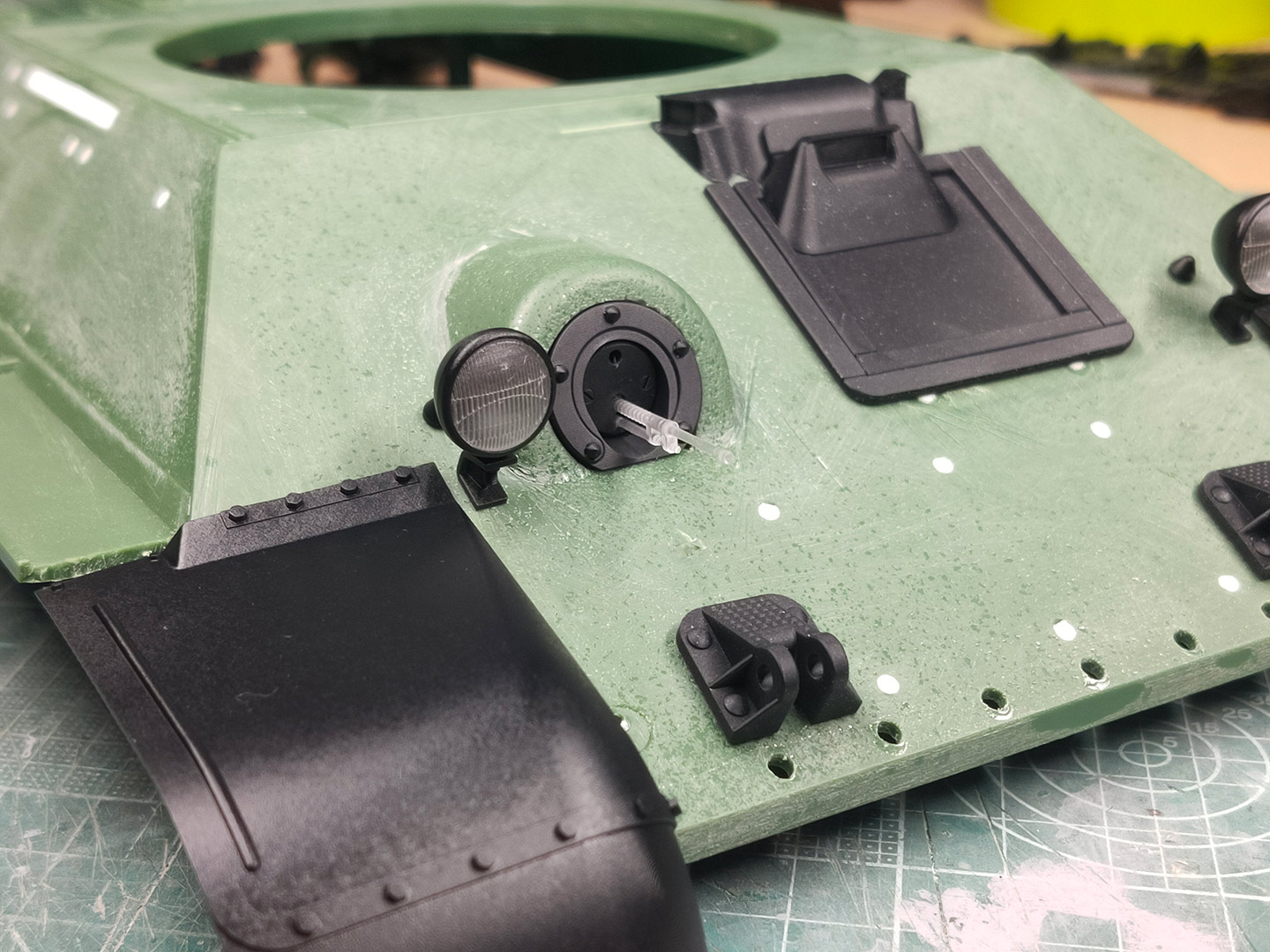

The last thing I was working on before the break was the bow DT machinegun, there's a three-part bracket to attach the ballmount and servo to the hull so it can be remotely controlled.
Fitting it all together, the front of the tank is really taking shape with lots of little details here that aren't available anywhere else.

Posts: 11879
Re: Every flavour of T-34
Great to see you back up & running Mr Ram.
You are bang on with the fact that this stuff is simply not available anywhere else.
To produce parts that can accurately backdate a new T34/85 model to a pre or entry war version is fantastic.
Cant wait to get some hardware to hand when you are ready to start punching them out !

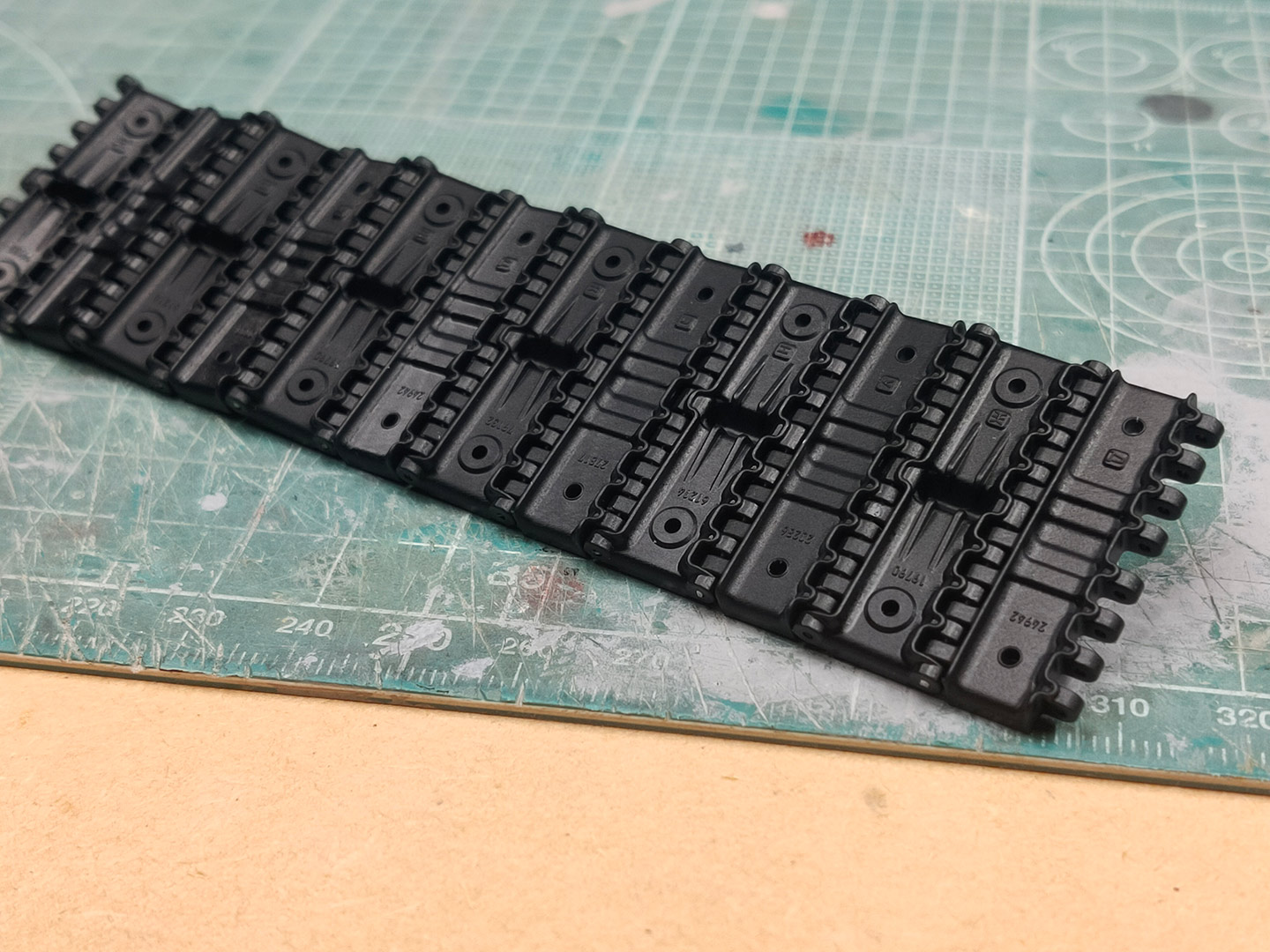

Marco Peter
Posts: 773
Location: The Netherlands
Post by Marco Peter »
Those tracks... WOW!
