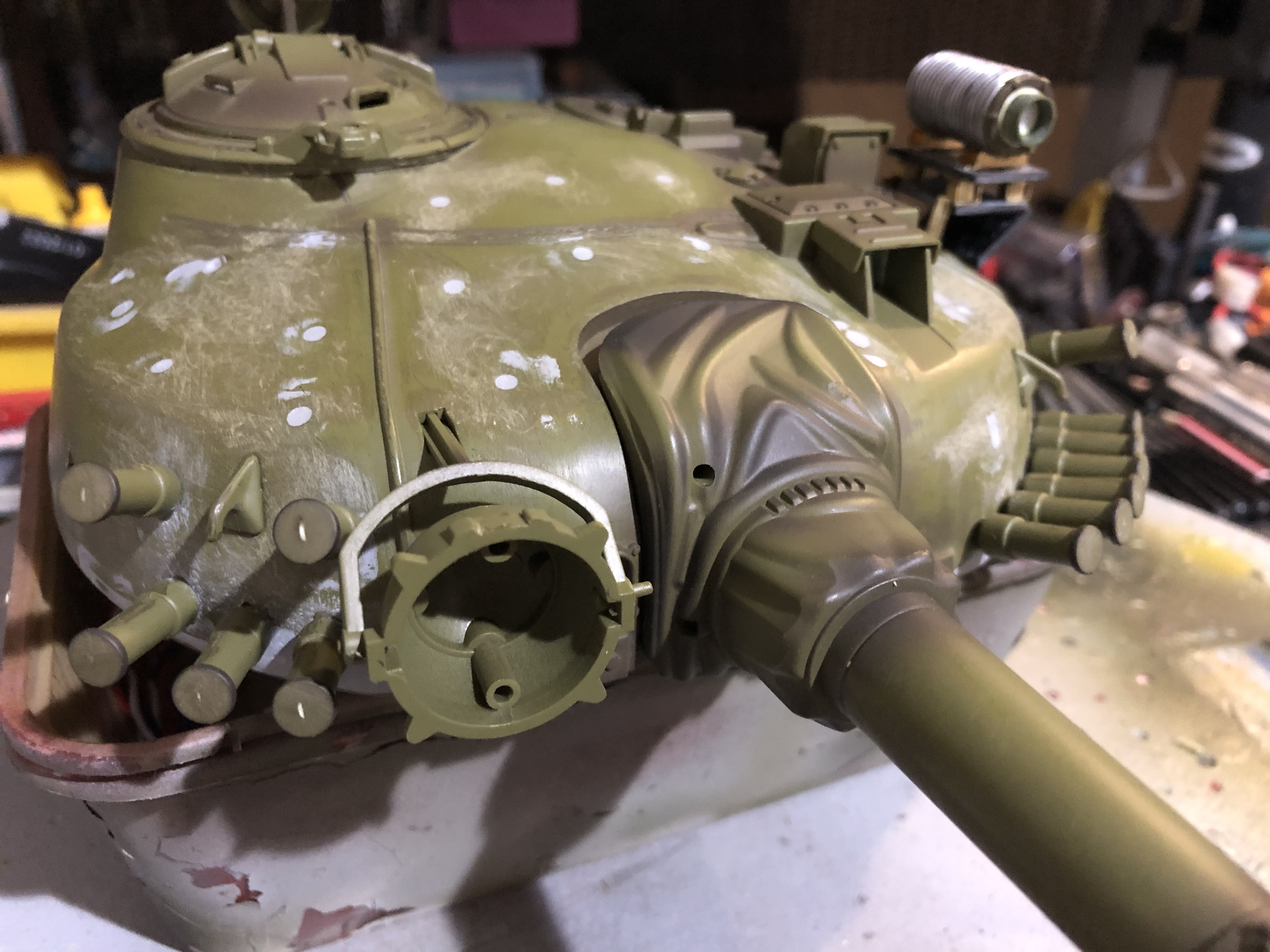

HERMAN BIX wrote: Sun Jan 07, 2024 9:15 am Im calling the dazzler almost done. Still to add a cover plate for it.
Compromising extreme accuracy for a degree of RC practicality and robustness, I wound solder wire around the body using gel super glue all the way.
While not a perfect replica of the small welds around the shell in pictures, its going to be close enough and should withstand any handling or in this case, postage brutality.
I used brass channel to carry the shell, again using gel super glue to keep it in place, and brass square & channel to represent the vibration dampers on the mount.
There is a lot of gel glue in this to try to secure this feature to the turret, & I will be devastated if it doesn't even make the delivery trip :(
The assembly will receive welds around it using Tamiya 2 part putty , but the ultimate key is to make the thing stay on the turret.
Last thing I want is a cross Pacific journey to find when the box is opened its in need of a rebuild :problem:
Next mission is the smoke candles.
This is gorgeous. I'm beyond pleased. This looks fantastic to me. Very much the image I had conjured in my head of what it might look like in scale.

Im relieved about that Mr Mithras, its one thing to promise a model, another to deliver the project that fits the minds eye of its owner.
The mission continues ;)
Posts: 11975
Re: ASAD-BABIL "LION OF BABYLON" IRAQI ARMY FEB 1991
Tonight was smoke grenade discharges .
The ERA T72 has half gaps for the old position and a bracket for the new position, both no good for me.
Marked and drilled in new holes and used the drill like a dremel to create a slot that each tube can go into.
Nice and sturdy and in the right place.
I will add angle base mounts and conduit to them next.
Not far off texture on the turret now then the race downhill to join the turret back onto the hull & make ready for paint

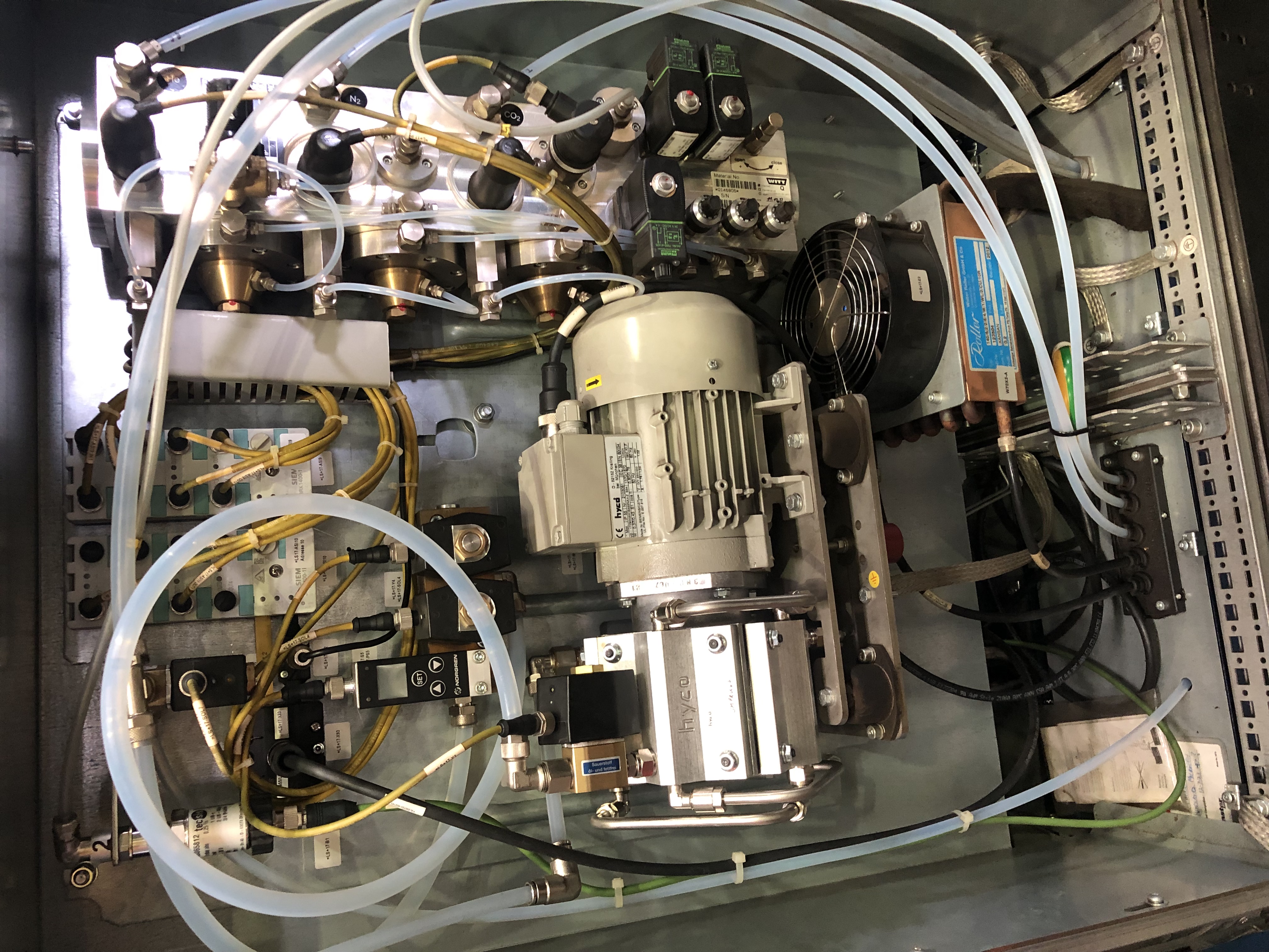

Herman, I don't know if that third picture was intended as I didn't see a mention of it in your narrative. BUT! I'm intrigued, I see pneumatics, liquid cooling, solenoids, rheostats and a big ole honking motor. What the heck is that?
Eric
