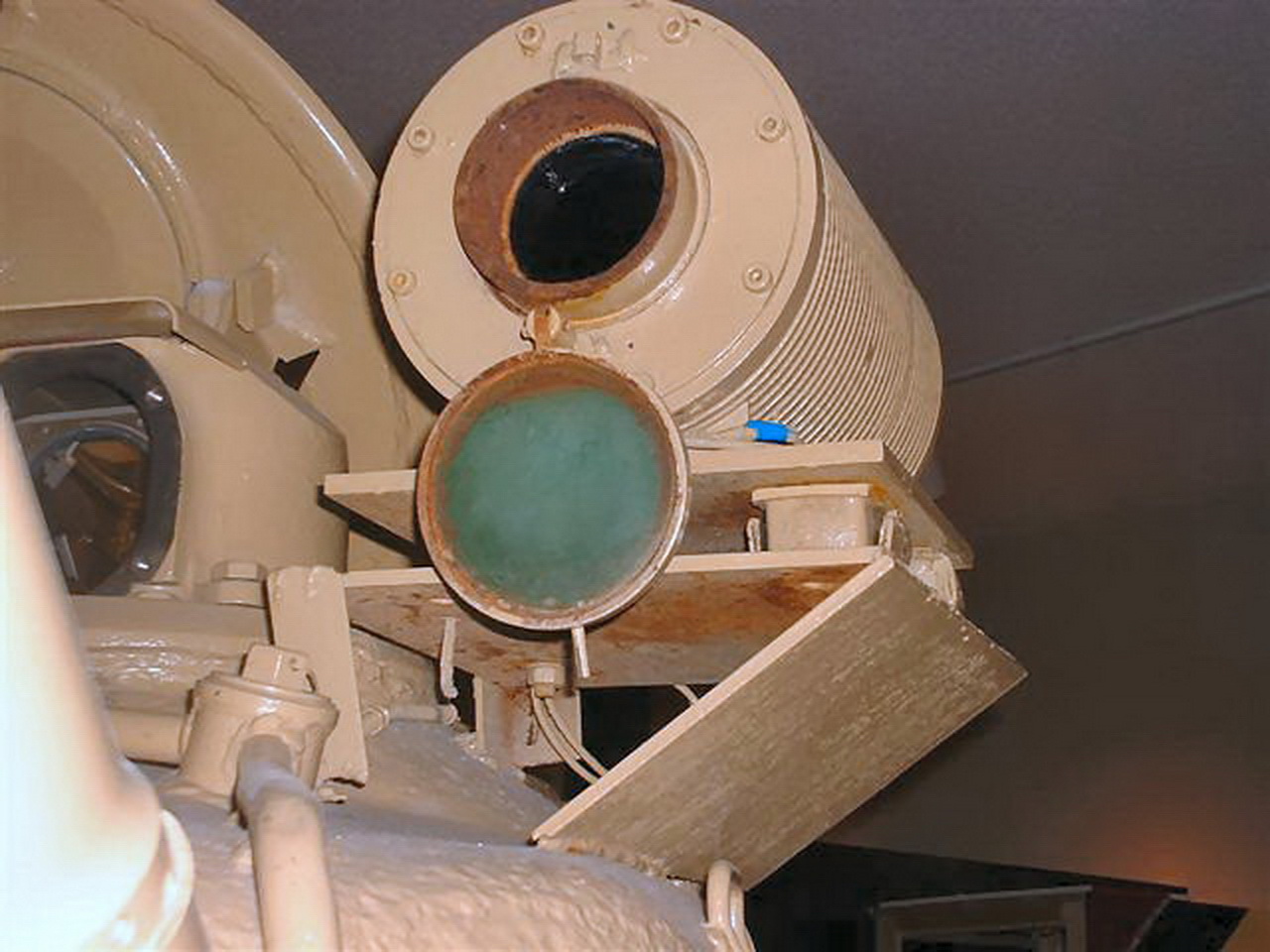

A good pic of the Chinese Dazzler
Note the untidy angle iron mounts.
I will replicate them as terribly as I can !

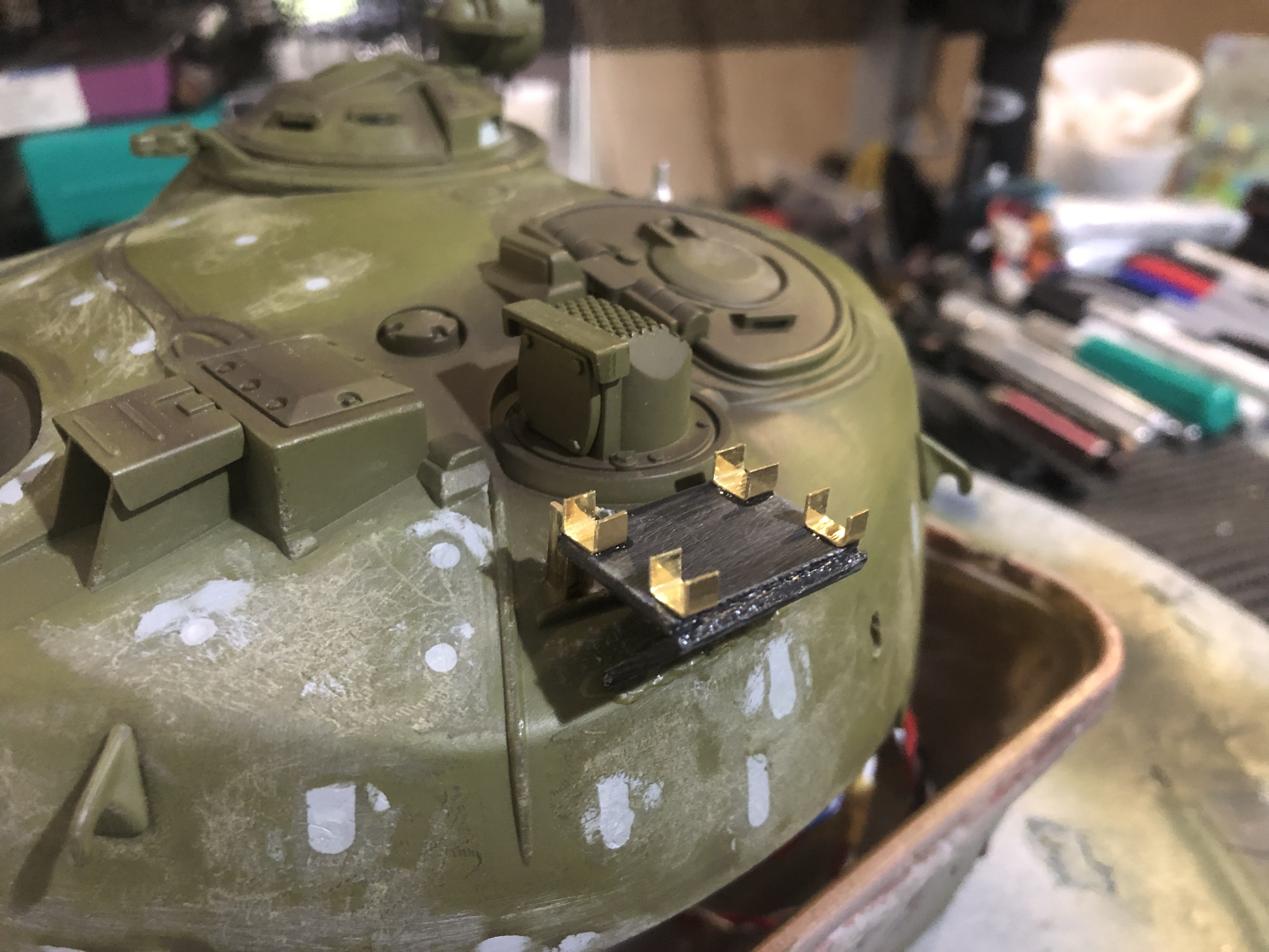

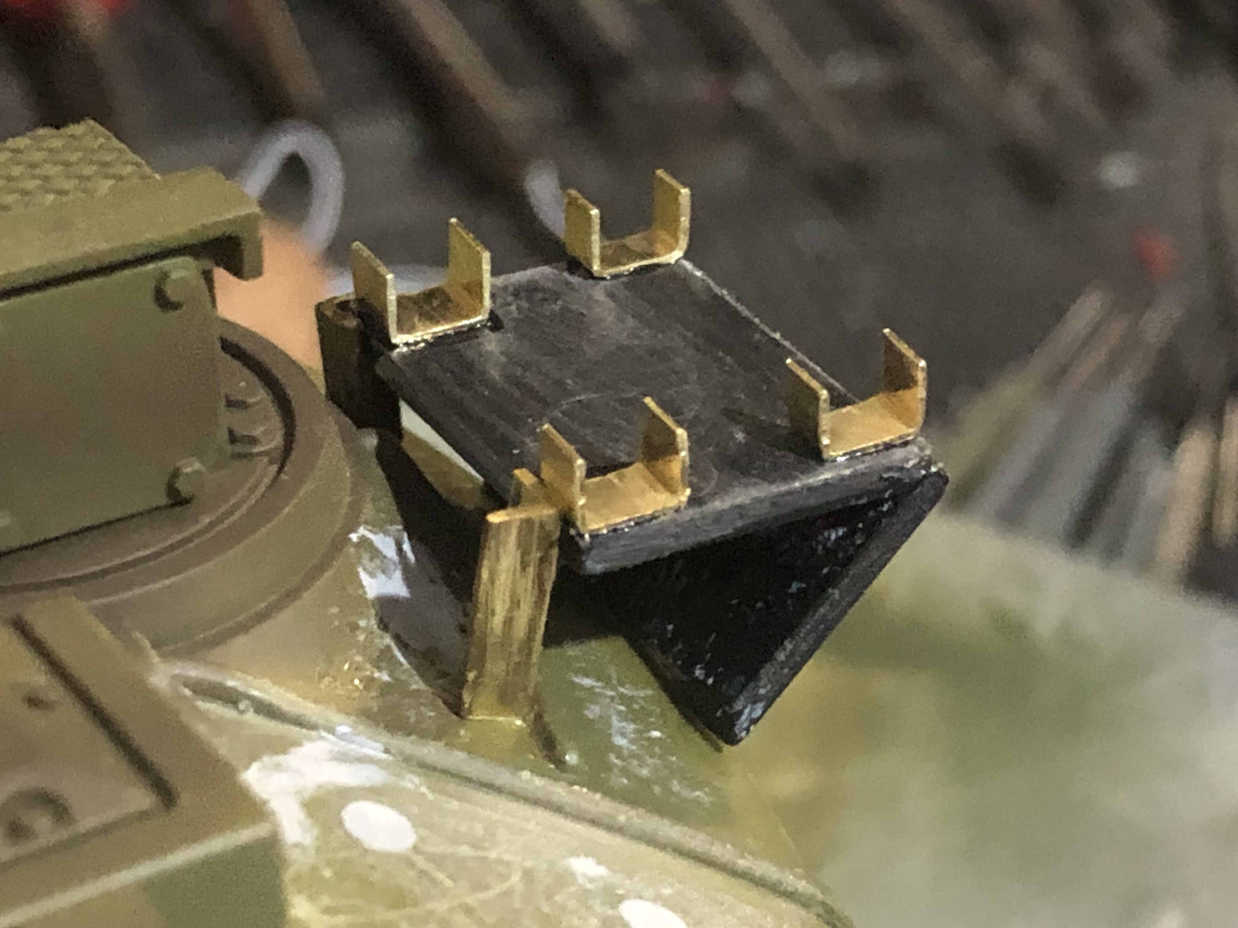

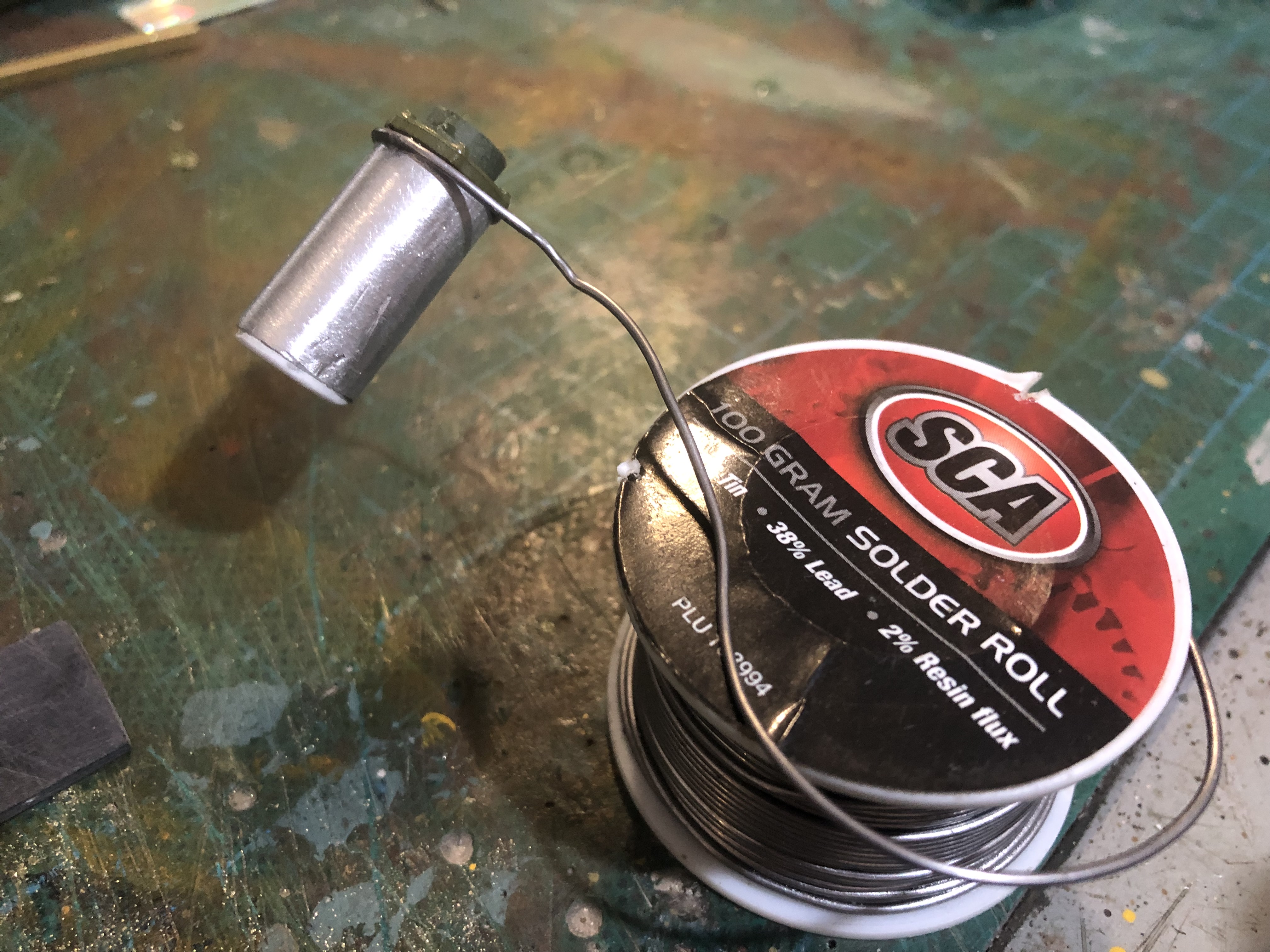

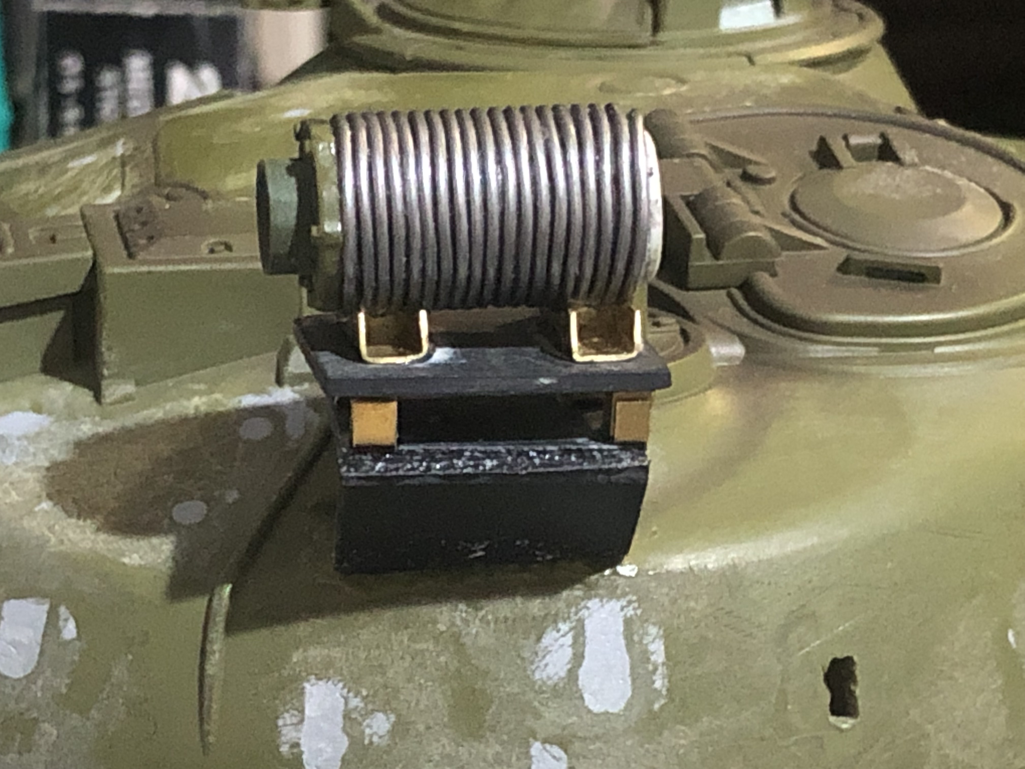

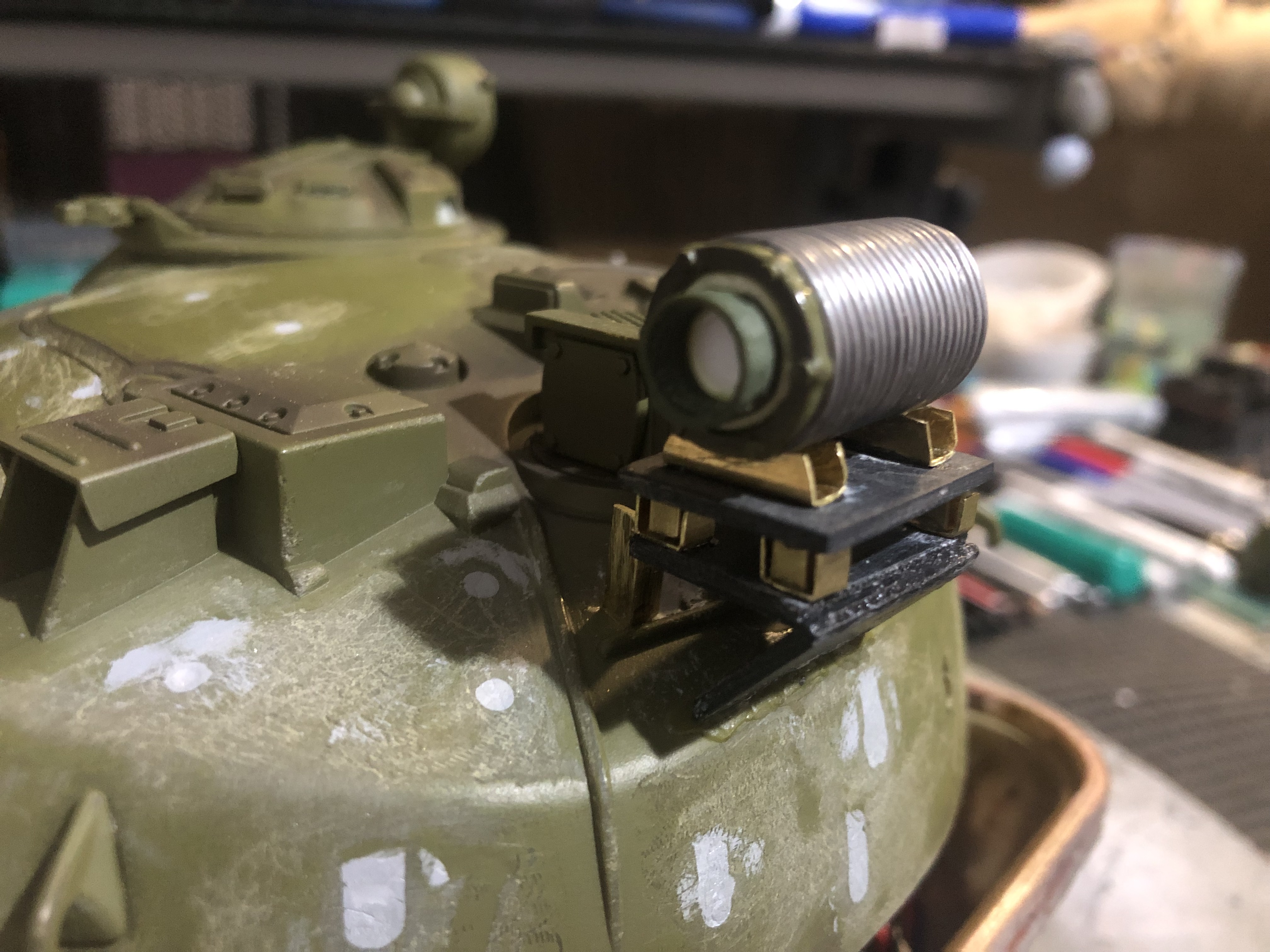

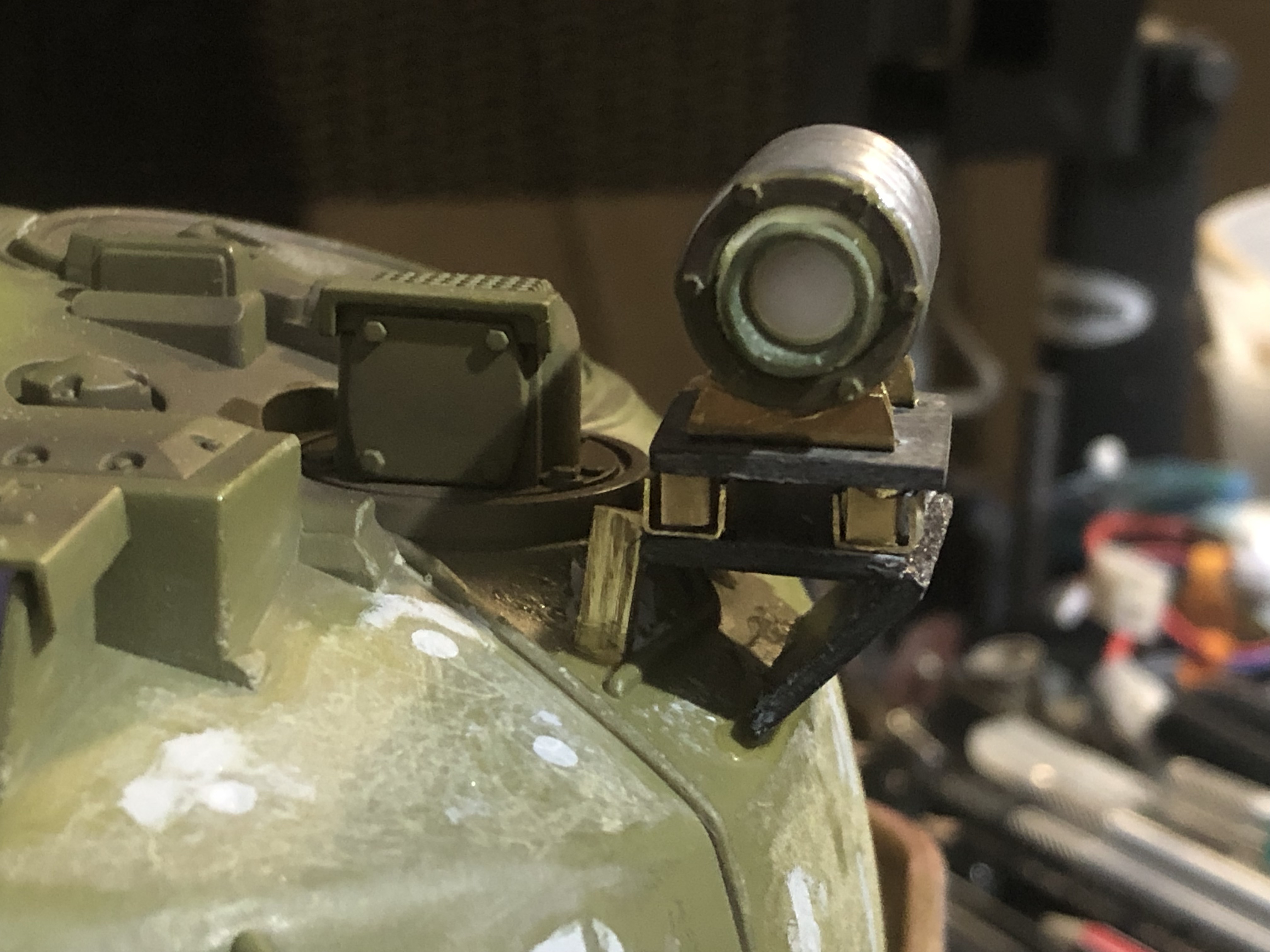

Im calling the dazzler almost done. Still to add a cover plate for it.
Compromising extreme accuracy for a degree of RC practicality and robustness, I wound solder wire around the body using gel super glue all the way.
While not a perfect replica of the small welds around the shell in pictures, its going to be close enough and should withstand any handling or in this case, postage brutality.
I used brass channel to carry the shell, again using gel super glue to keep it in place, and brass square & channel to represent the vibration dampers on the mount.
There is a lot of gel glue in this to try to secure this feature to the turret, & I will be devastated if it doesn't even make the delivery trip :(
The assembly will receive welds around it using Tamiya 2 part putty , but the ultimate key is to make the thing stay on the turret.
Last thing I want is a cross Pacific journey to find when the box is opened its in need of a rebuild :problem:
Next mission is the smoke candles.
