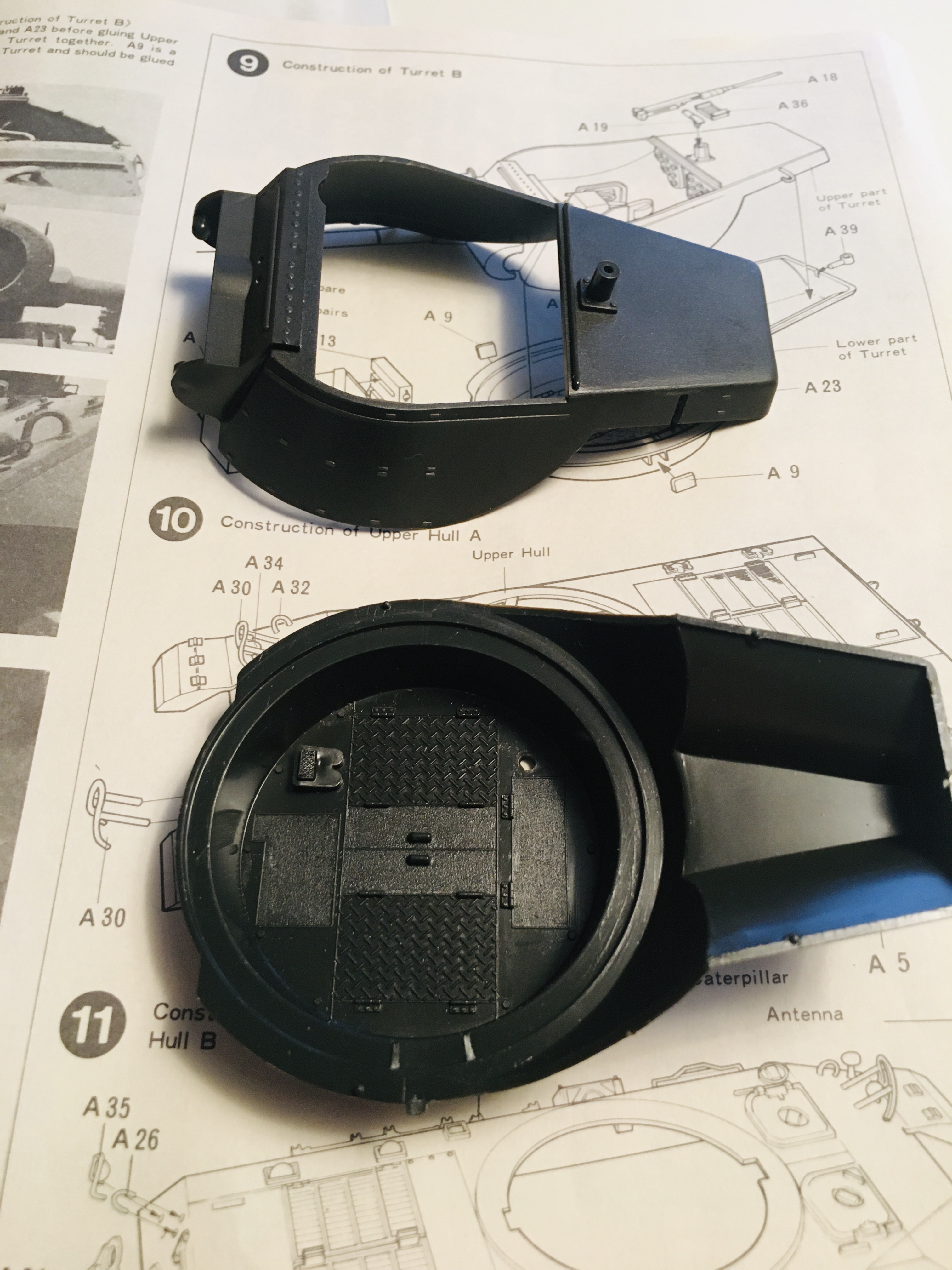

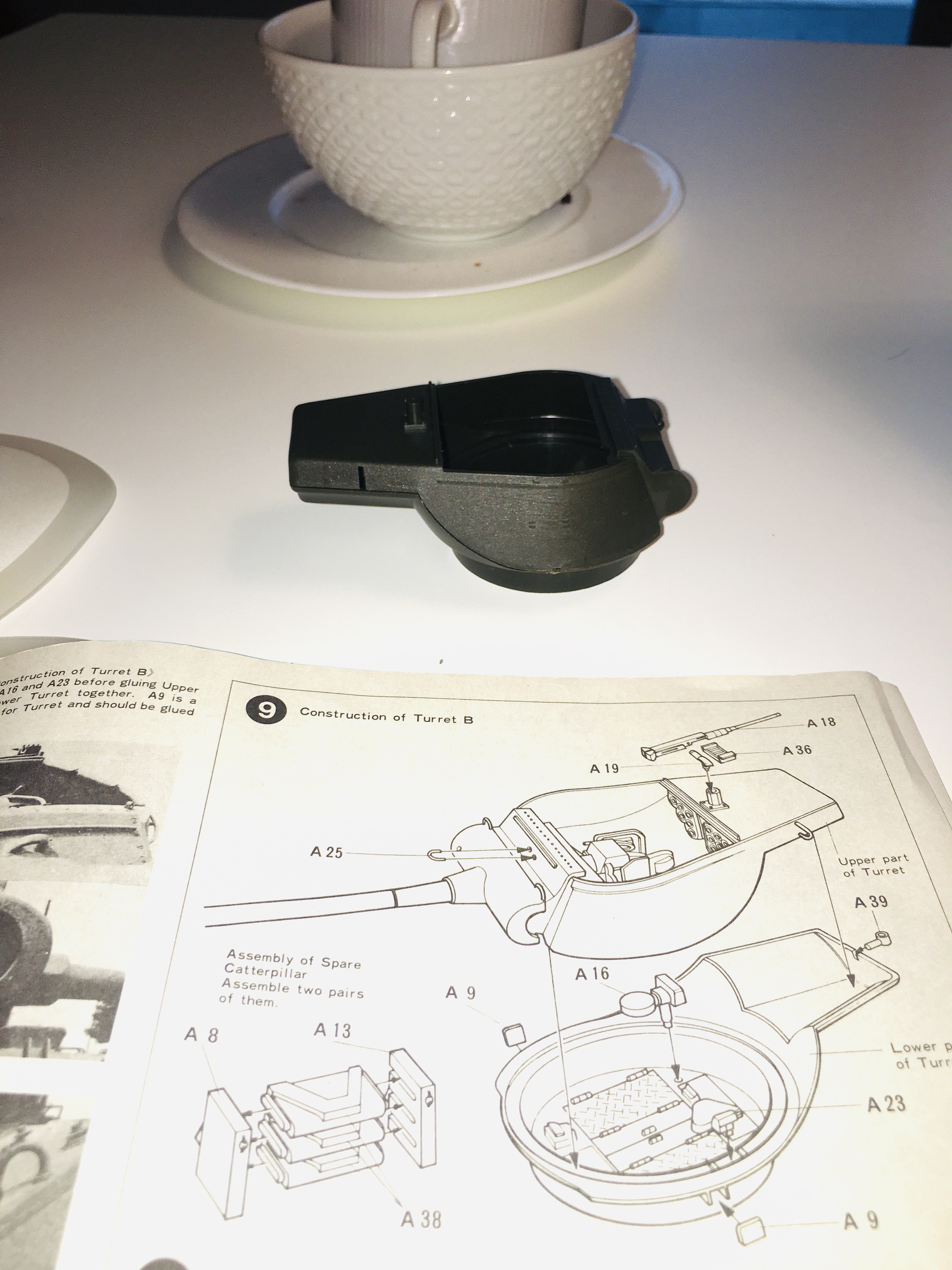

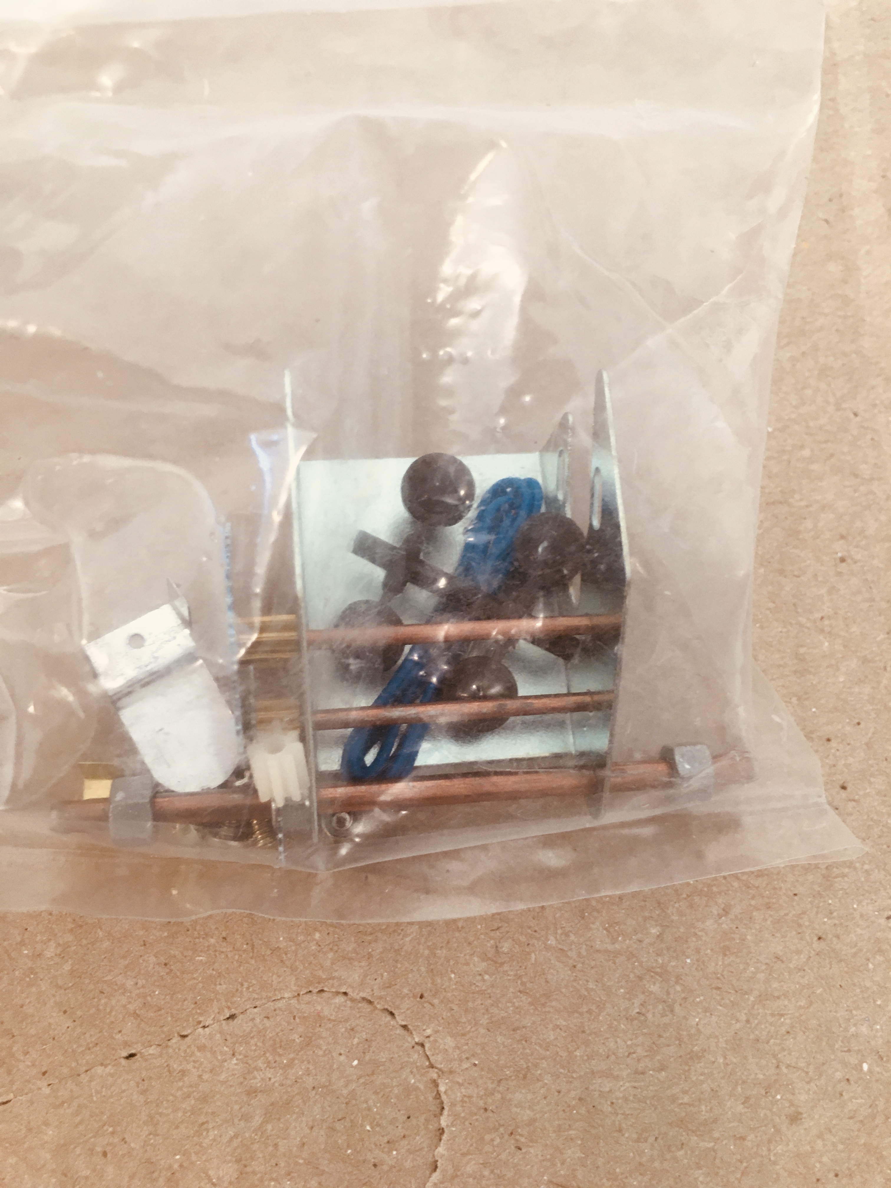

I am using parts from the No.35 M36 JACKSON "MOTORIZE SYSTEM" PRECESSION MODEL KIT as it says on the box above.
I am using the part to finish my No.35 M36 JACKSON "REMOTE CONTROL TANK" READY TO ASSEMBLE MODEL KIT.

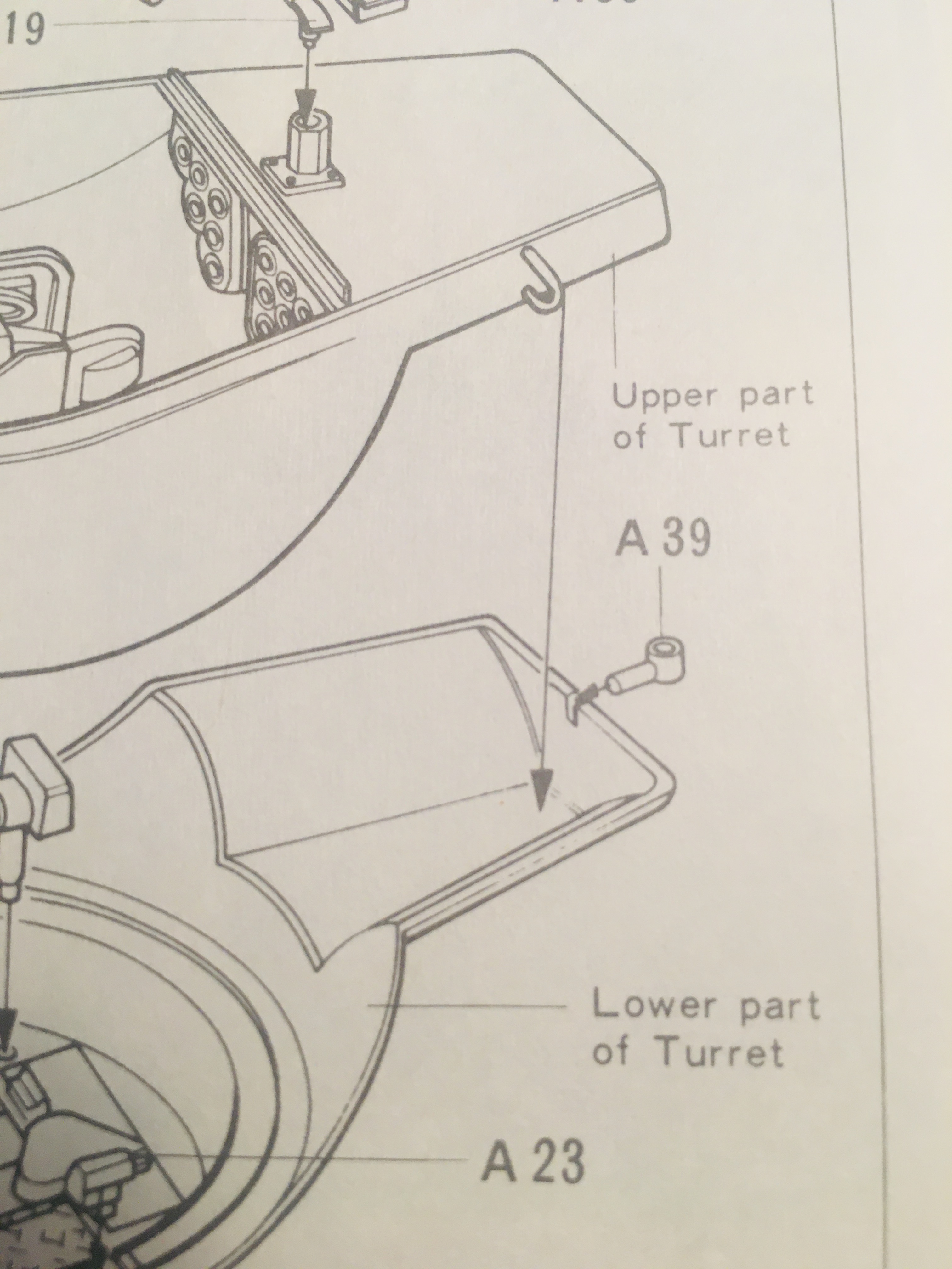

I just need 1 part from "MOTORIZE SYSTEM" kit, The "Lower part of Turret" is what it is called in the instructions.
How the heck do you lose the "lower part of the Turret" and then have to sell the kit for less money as a result? :think:
It has taken NEARLY 2 YEARS to finally get to finish the M36! I bought the M36 REMOTE CONTROL TANK kit about two years ago but was not able to build it because it was missing the lower Turret. July 2023 I picked up a complete unused M36 MOTORIZE kit for a reasonable cost on ebay so in effect, I will be using the M36 MOTORIZE KIT for parts for the M36 REMOTE CONTROL TANK kit.
Instructions for the M36
Here is that crucial missing part, Lower part of Turret

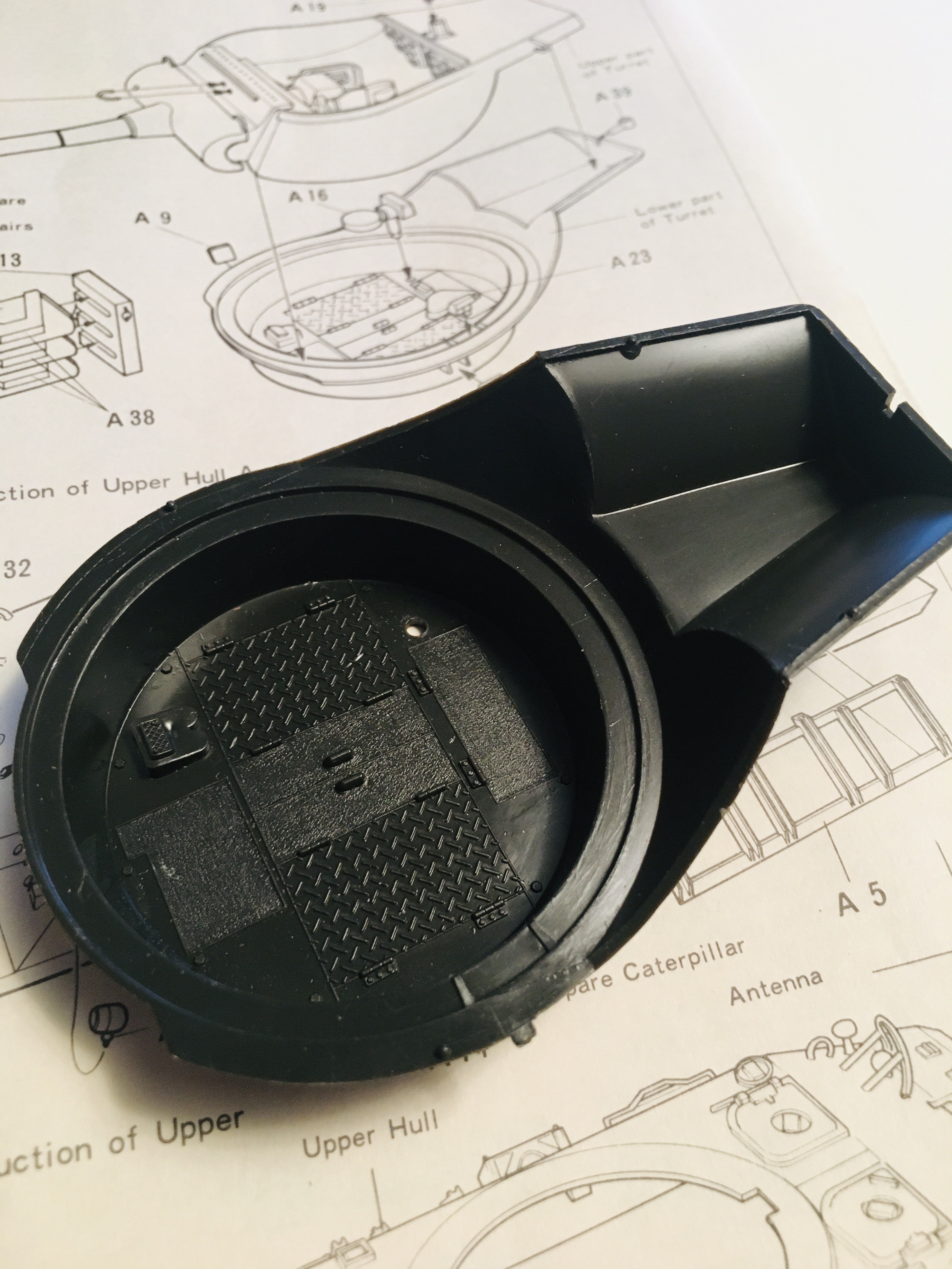

Upper and lower Turret parts ready to go
Finally have a complete M36 Turret!

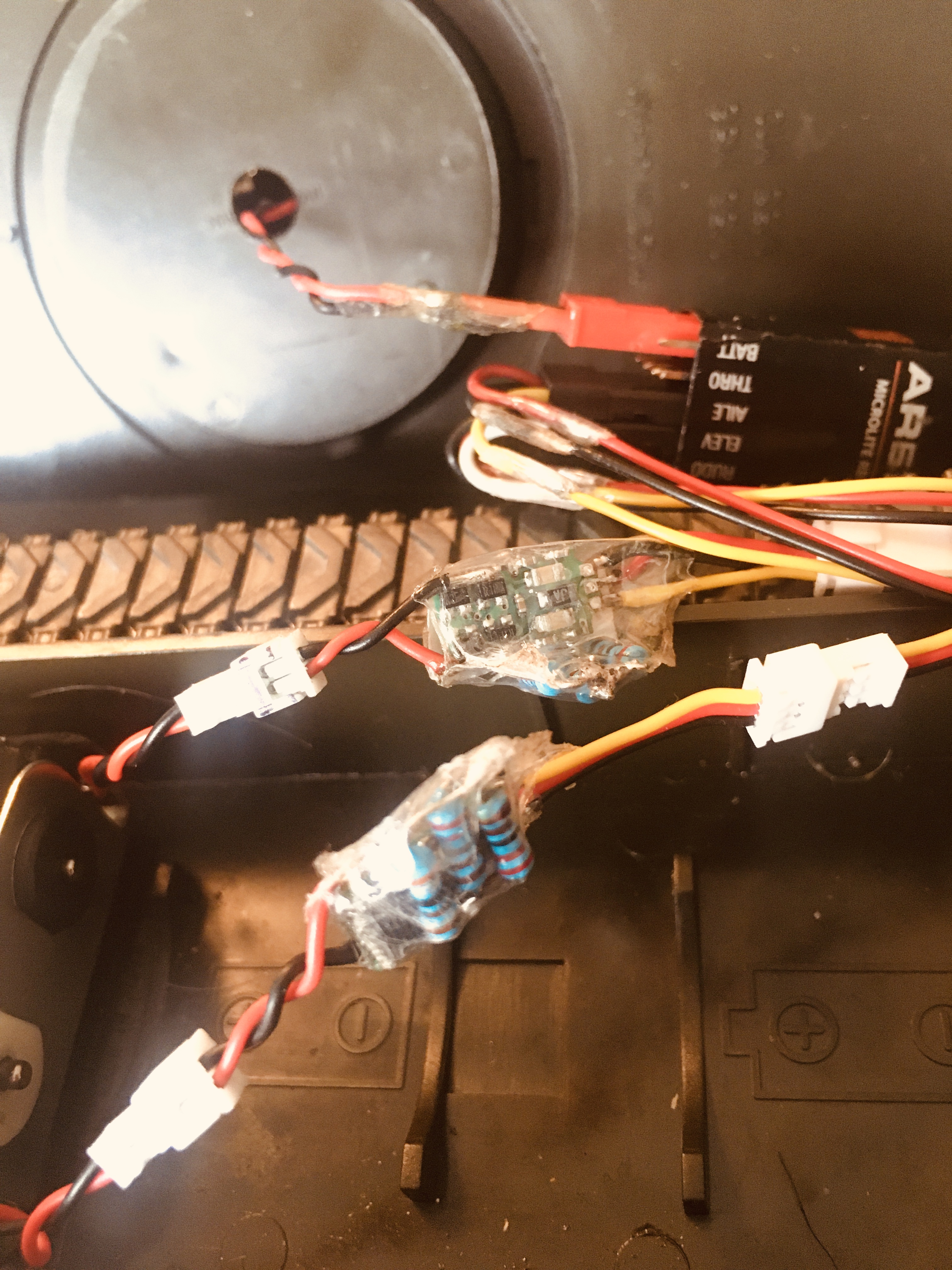

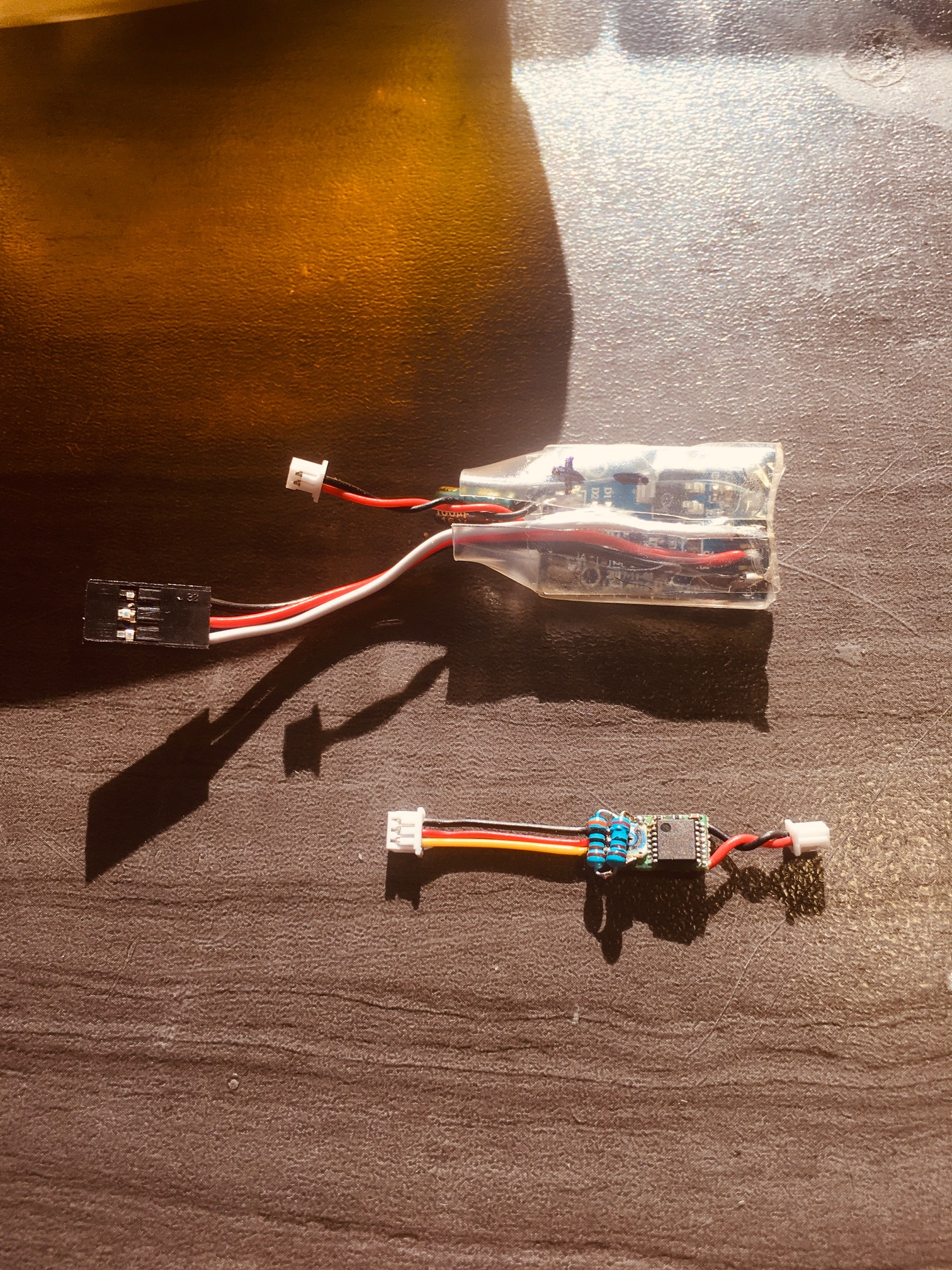

Got some time to get back on the M36 build. I am going to change the regulars ESC;s out use modified servos for ESC's in the M36.
I like them because the are way smaller than the RED ESC's I was using which are better used in 2s applications.
I have two of these M36 models but one is missing the lower half of the Turret and was that way when I bought it used on ebay.
I am changing out these big ESC's for smaller units like the one shown here that is a recovered reworked servo  circuit board now a ESC.

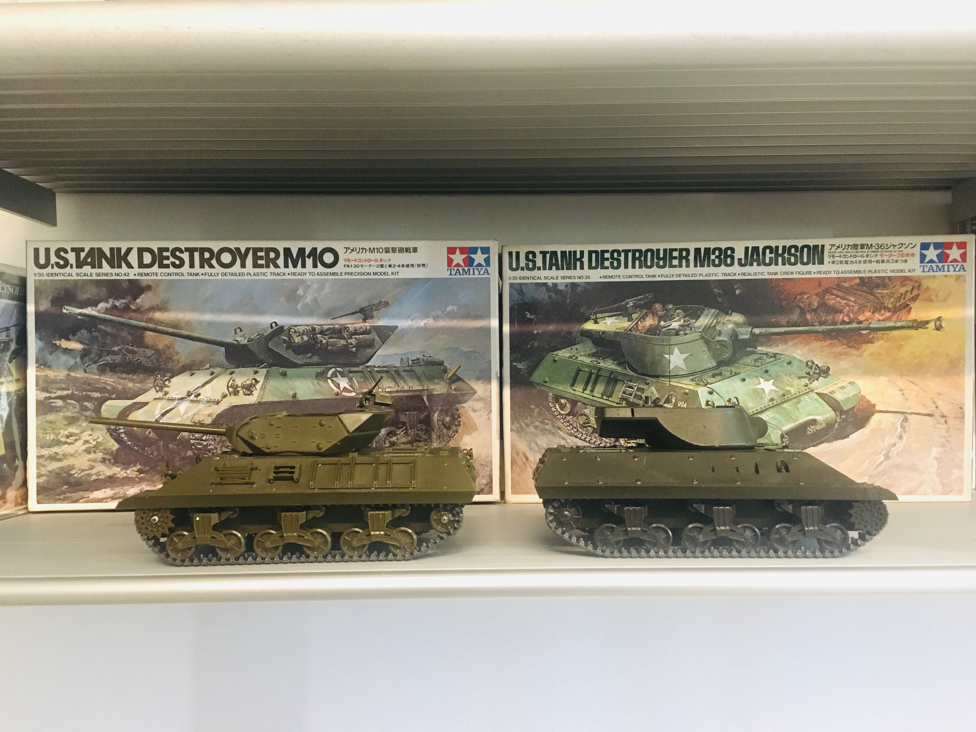

M10 vs M36
M10 vs M36

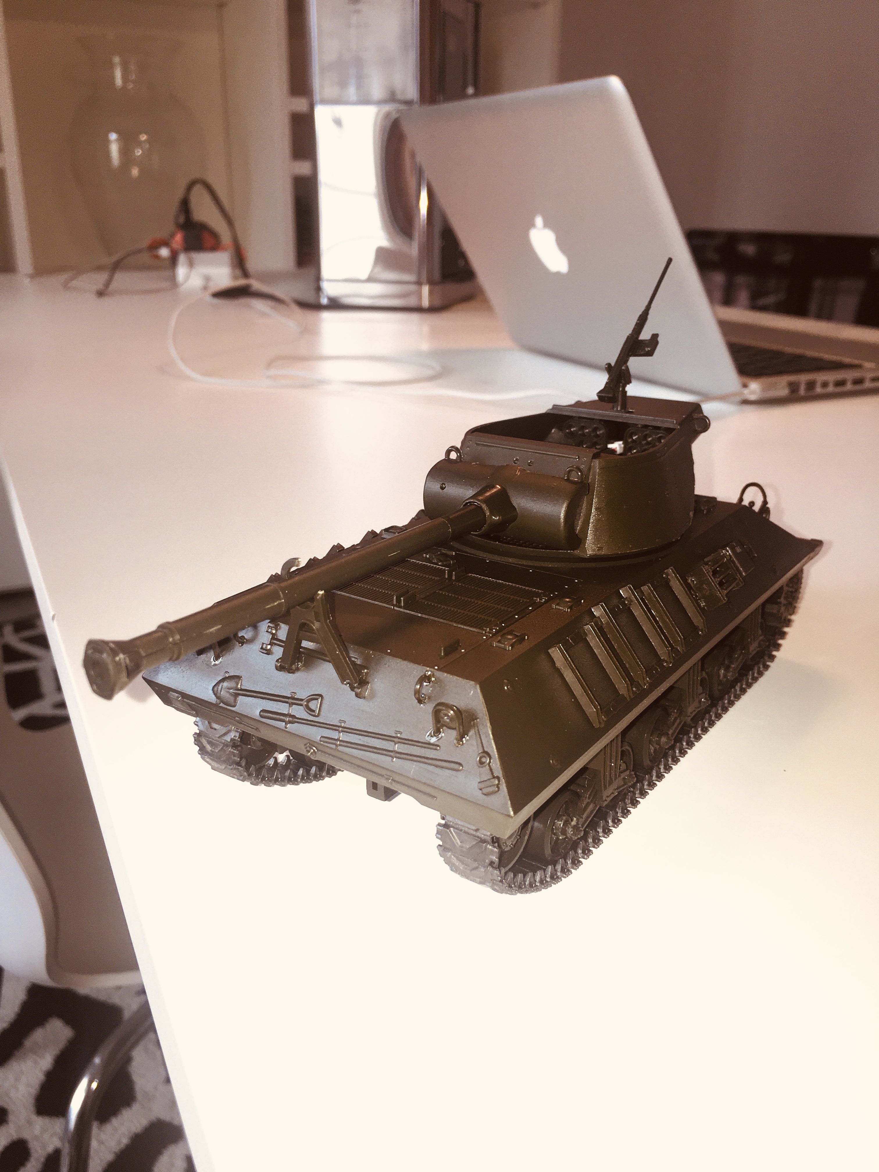

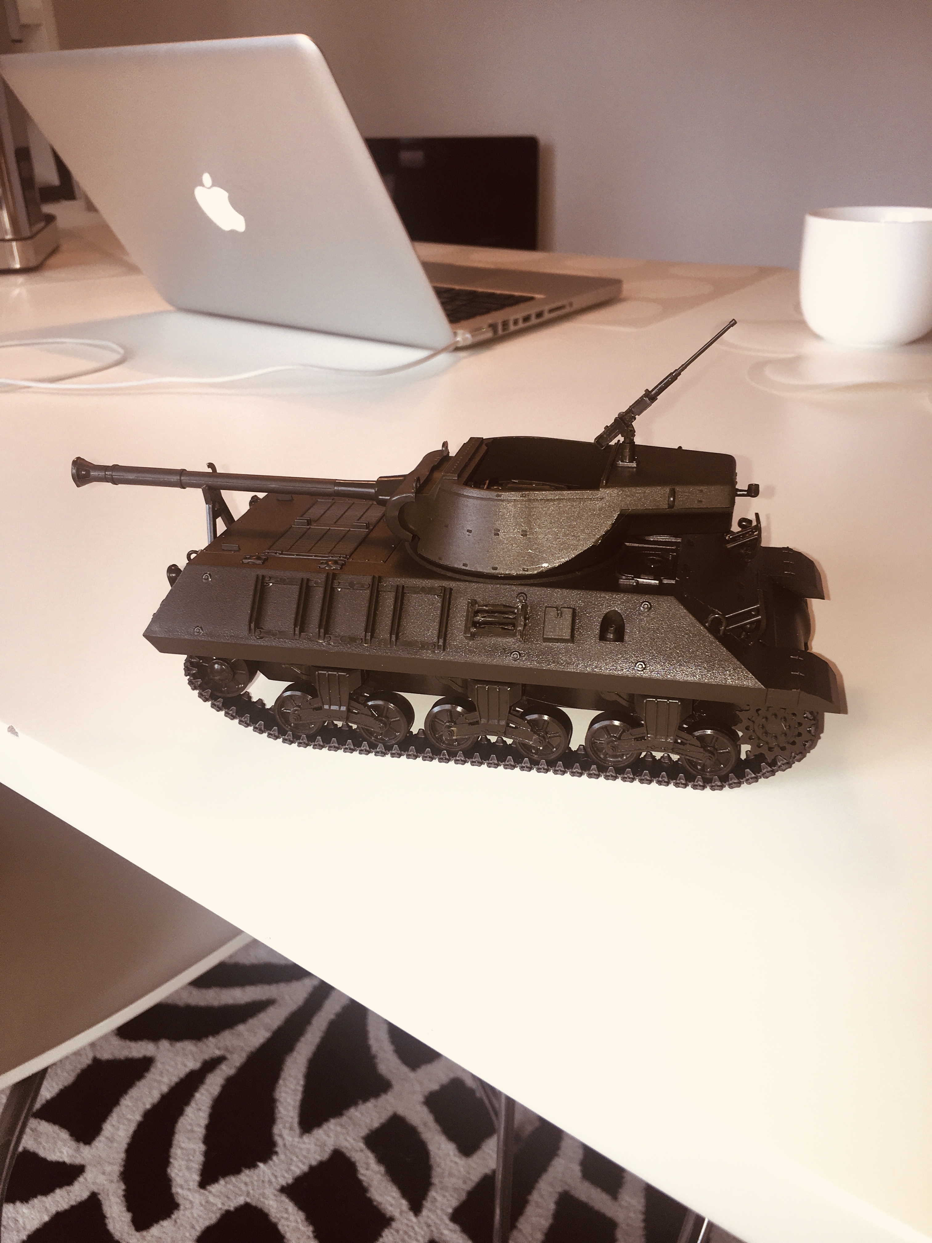

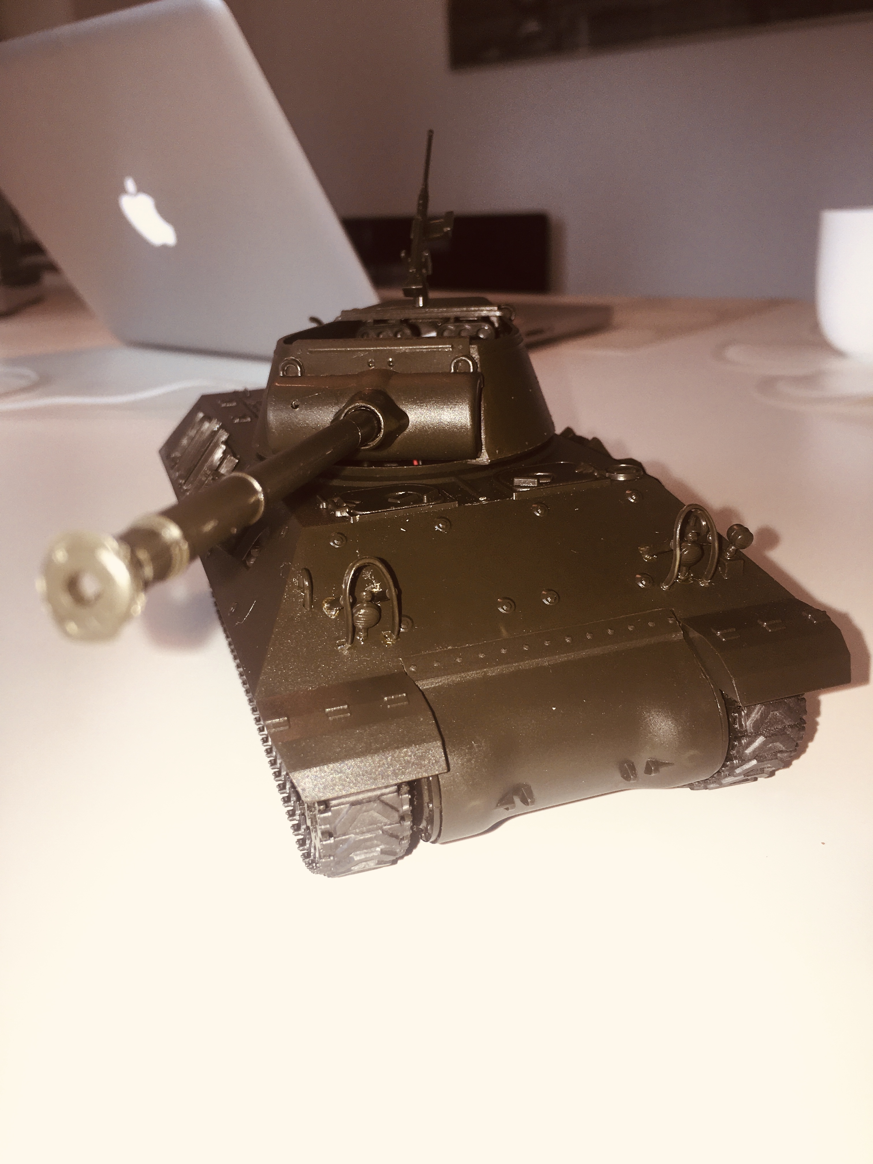

Finally the M36 is done :D
I revised the radio system to use modified Servo amplifiers for ESC's. These are very small and are perfect for the 130 brushed motors that are used in most 1/35 model Tanks. Plus they are recycled from electronics junkyard so the cost me nothing other than the time to add two resistors to convert them to fully proportional Electronic speed controls.
These Tanks with the Sherman Long chassis have excellent poly Tracks,VSS Bogies and Roller Wheel system that works very well and takes very little power to operate.
I will do a Test Track video asap
6 channel AR6100 with two servo ESC's. This M36 has its original narrow metal gearbox that comes with the "Remote Control Tank" model kit. 3.0 ohm motors replace the stock 1.7 ohm Mitsubishi motors.
shown here are the two ESC's. Very small and work very well.

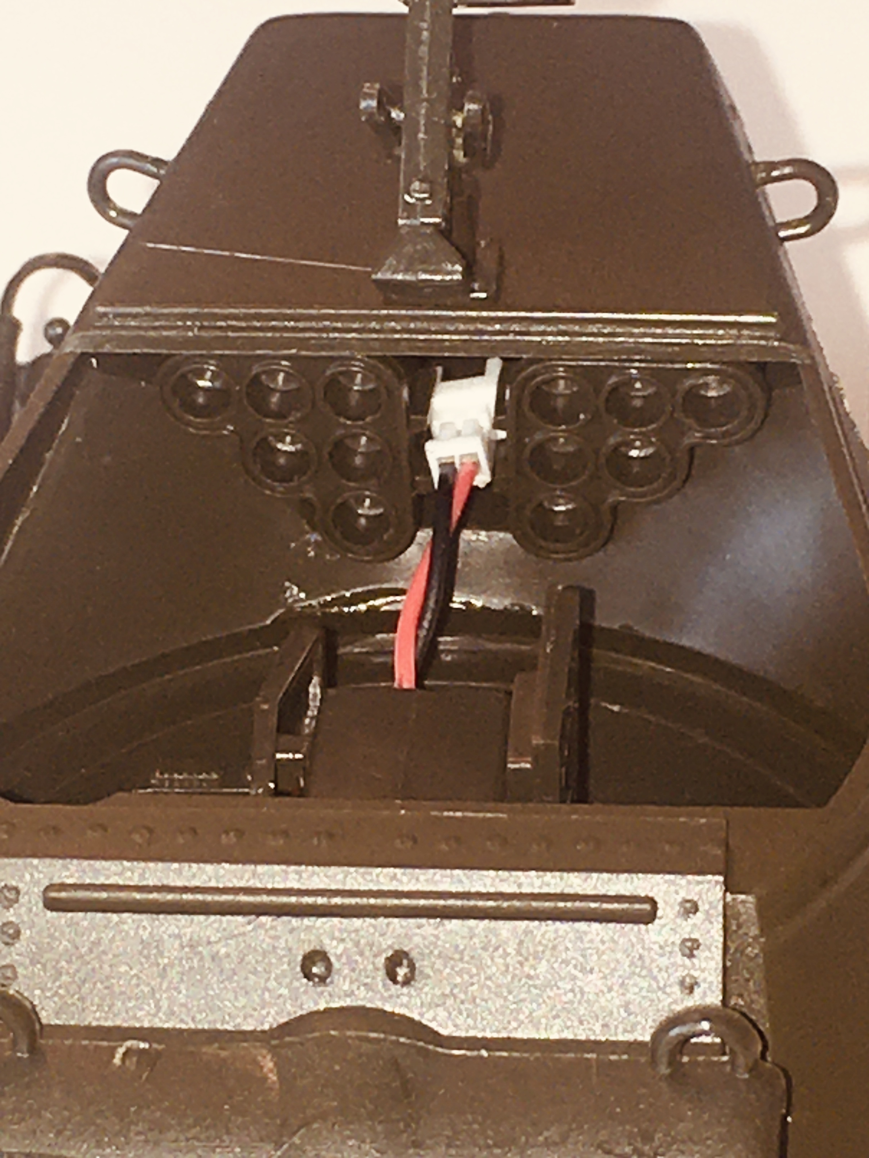

Inside the Turret. I plan on making this rotate L\R
