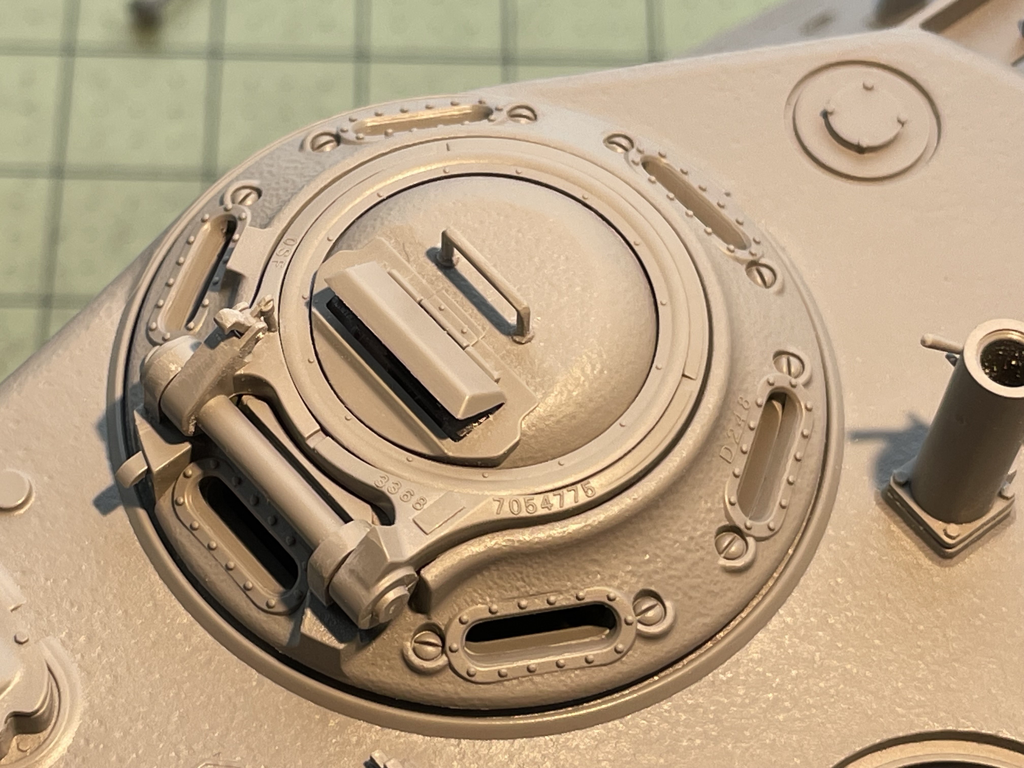

Most of us are used to a Sherman cupola with maybe 5 to 6 parts in total. This one has 25 and is extremely well detailed.
1/16 RC M4A3E8 Korean war - Restoring Tamiya M4 with Takom kit - build
Independent glass visors will be installed only after painting.
Someone could easily make this little latch functional. It’s begging for it but it has some complexity that made me skip it.

Re: 1/16 RC M4A3E8 Korean war - Restoring Tamiya M4 with Takom kit - build
Detailed cupola hatch interior, with periscope, lift and rotation handles, and cast markings.
Since I decided on how I would paint the periscopes and mask the visor glass, I recommend installing them only after painting.

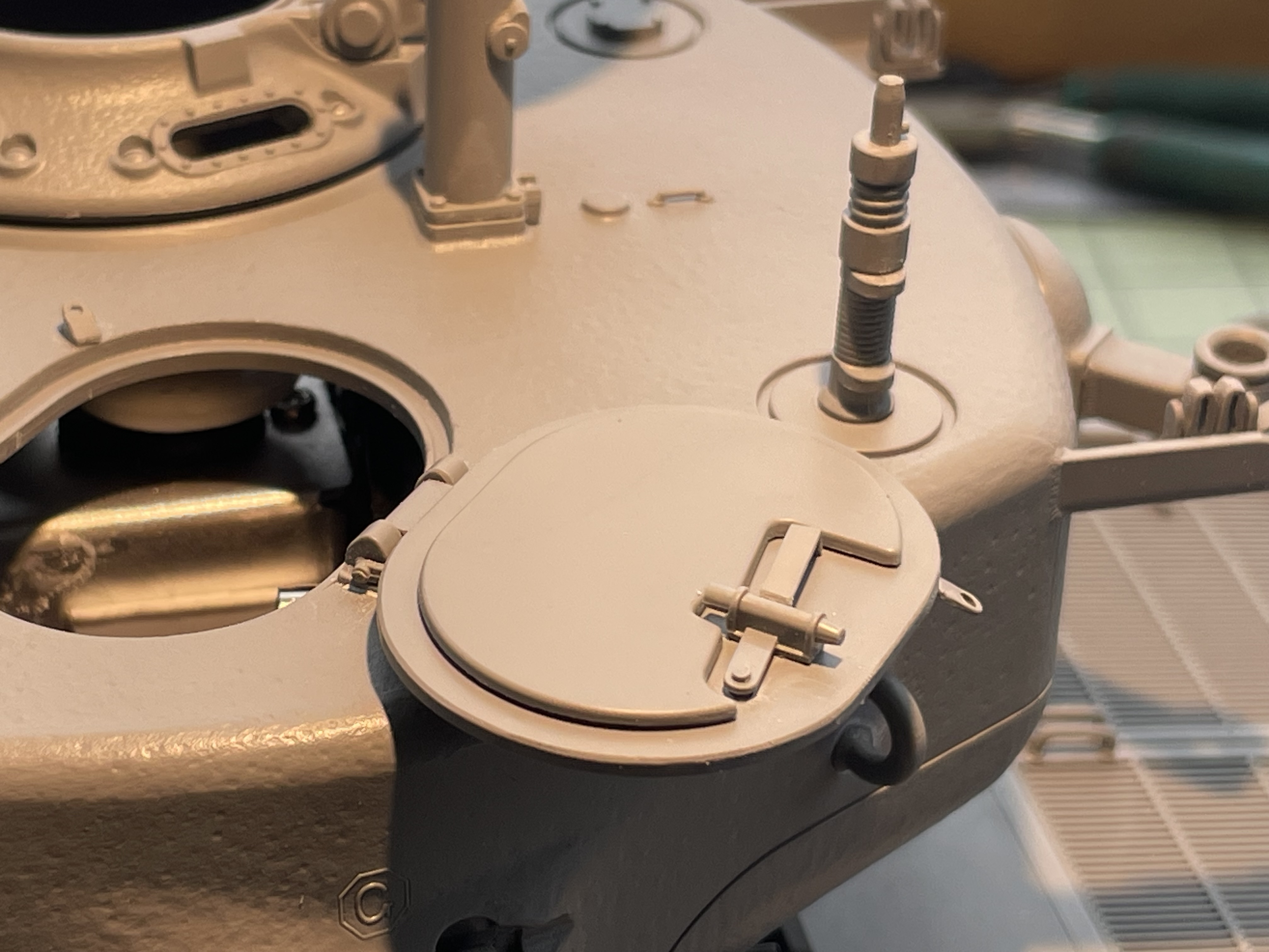

Springs for the loader's hatch, beautifully detailed but fragile. Most Sherman makers are molding them directly on the hatch.
In order for the loader's hatch to remain operable, and to secure the fragile springs, i had to glued them to the top of the hatch, and leave the tip loose at the joint with the hinge. No way around it otherwise the springs will break when opening the hatch. These are way too small and fragile to try to drill a hole and put a bolt at the joint with the hinge. Replacing the plastic springs with real ones is something i did with the 1/6 Sherman, but it would be very complicated to do in 1/16 with the proper details and a working mechanism. Certainly doable for watch makers...
Take note of the latch for the padlock.
Beautiful hatch, with cast marks on the hinge, and the subtle difference in surface casting effect.
