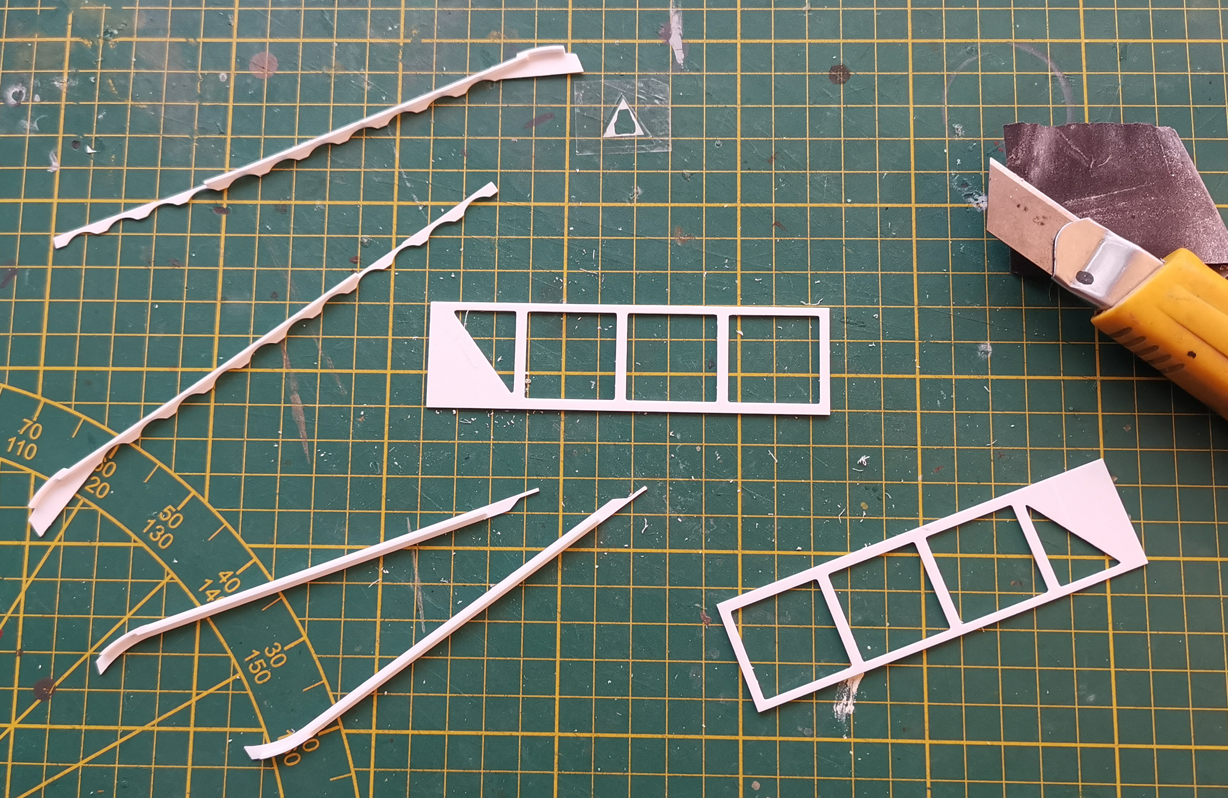

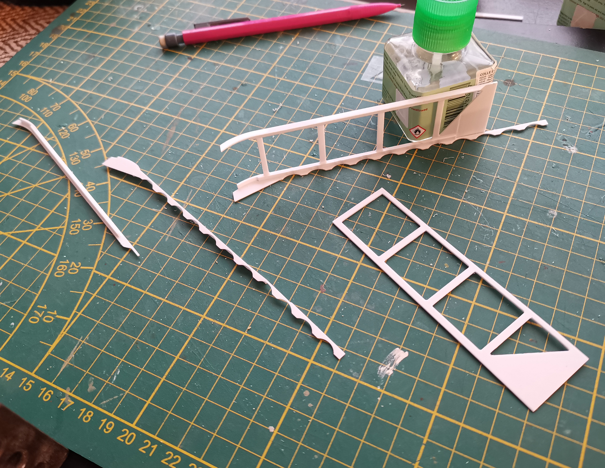

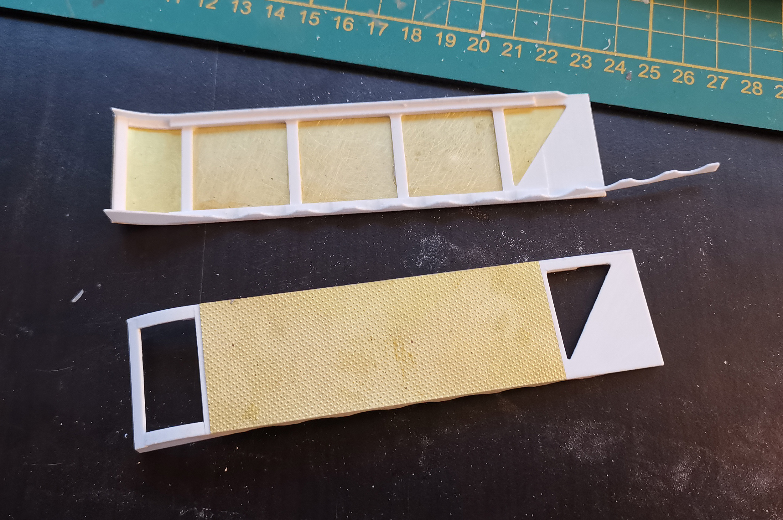

Today I worked on the trackguards.
I used Aber photoetch dot pattern antislip plate. The size is about perfect.

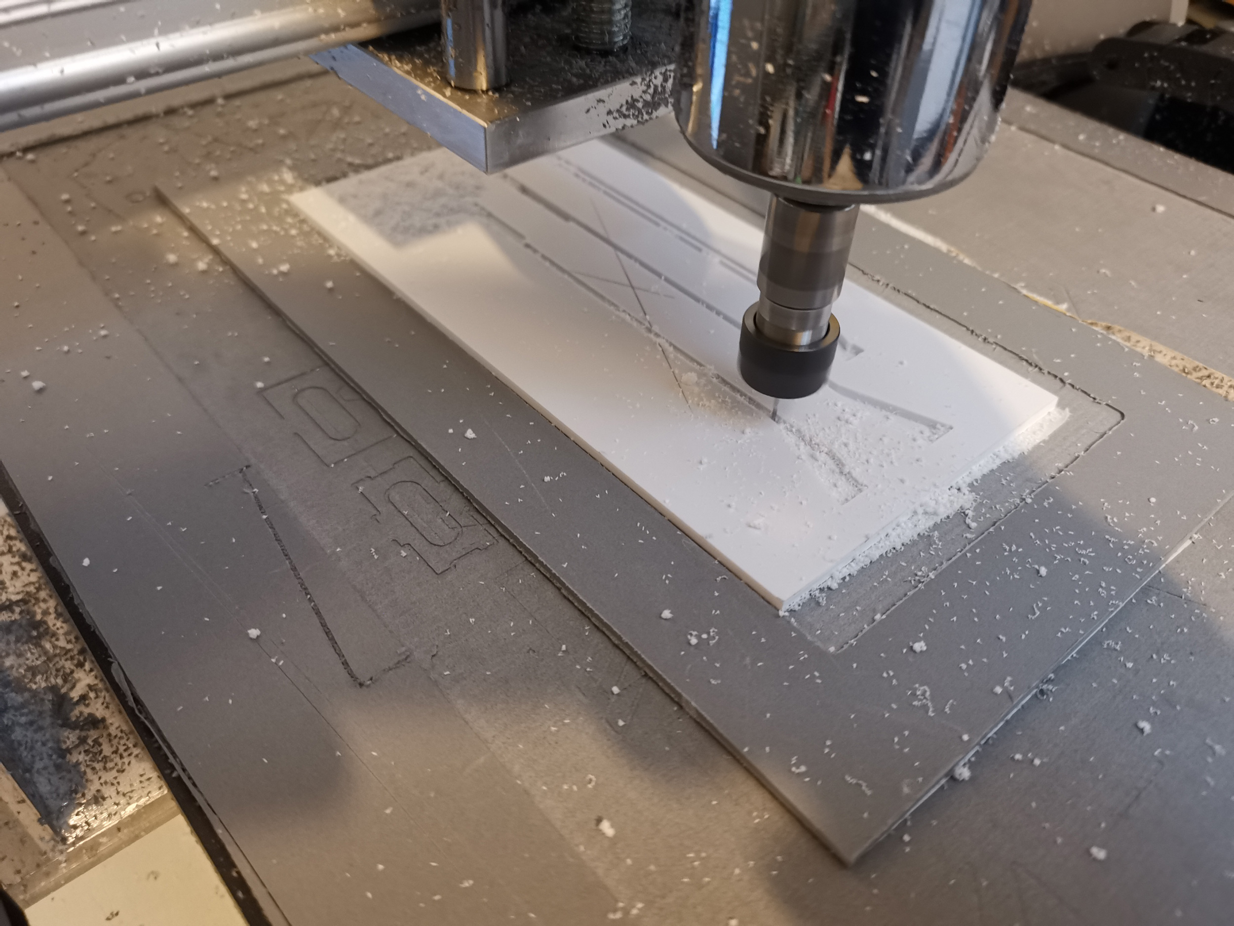

Once again, more time behind the computer and in front of the CNC than assembling the parts !

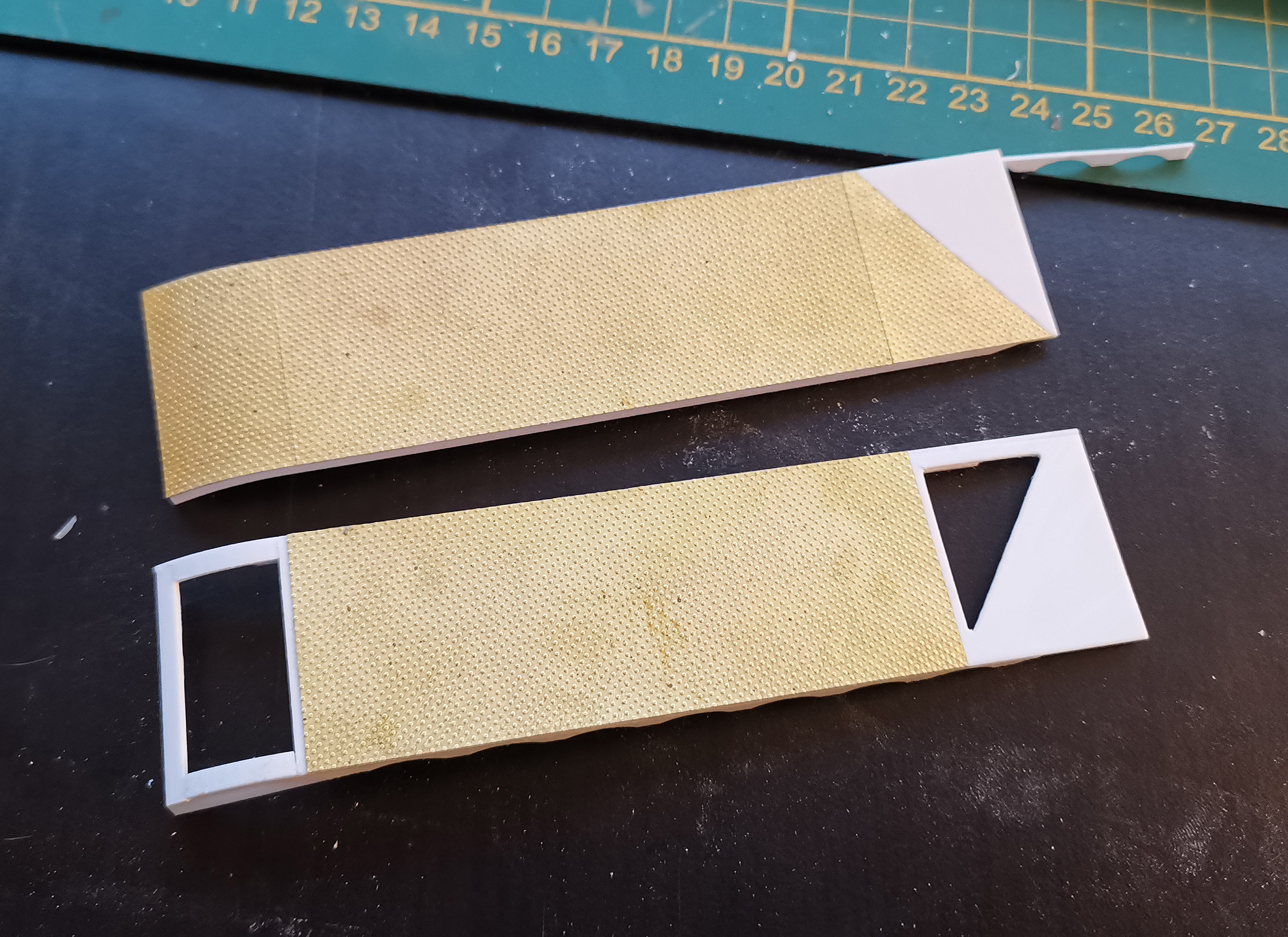

The parts, this time I reproduced the frame (a bit simplifier) of the 1:1 Hummel unlike what I did on my first model. This way I can glue the PE from the underside ! And it's easier to remove if I glue it the wrong way (learnt it the hard way on my first model, totally screwed the PE when I tried to debond it :(). So here are the parts :

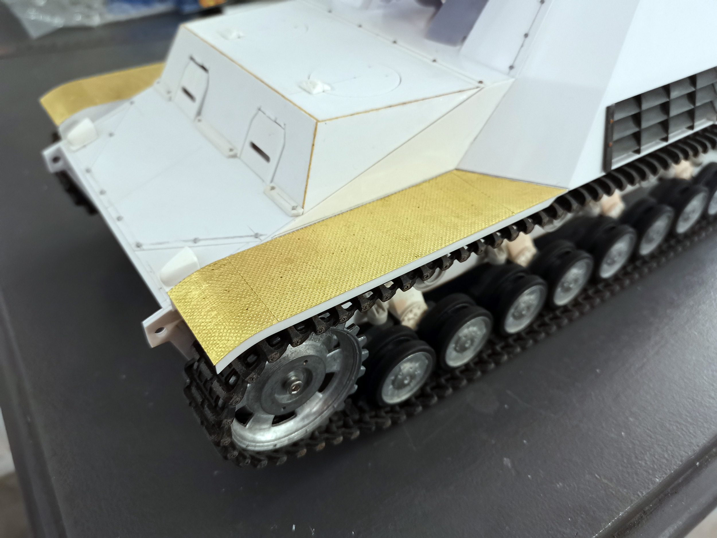

Assembling the parts :
Gluing the PE, on the 1:1 Hummel, each trackguard is made of 2 pieces, the curved one and the flat one. Unfortunatly the Aber PE was not long enough to get the flat section in one piece.
In place :
