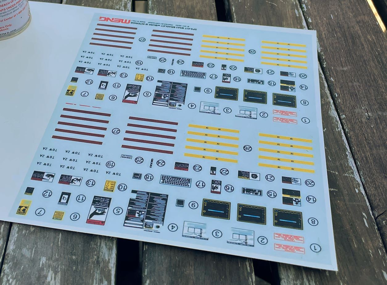

A scan of the MENG 1/35 interior decals was previously expanded to 1/16, done in double in order to offer some spares. I did a fresh inkjet printout on virgin white decal sheet and after a coat of semi gloss varnish, they are ready to be cut and used.
- M3A3 Bradley US Cavalry Fighting Vehicle - RC 1/16 Build
- Capture.JPG (216.79 KiB) Viewed 4615 times

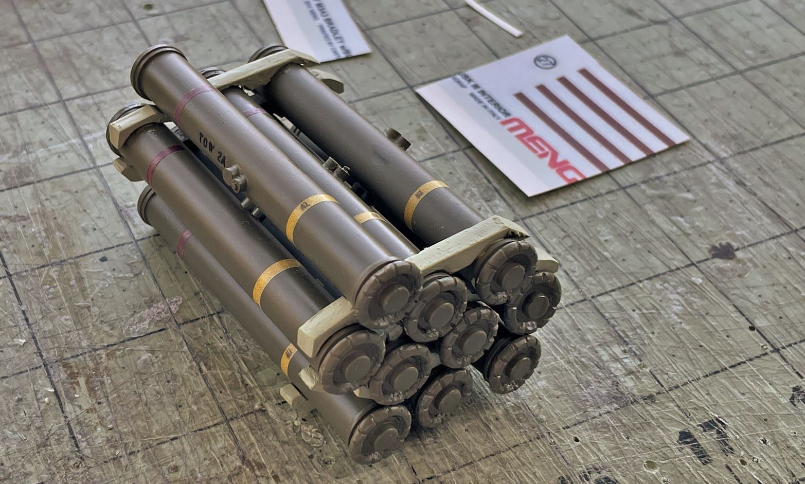

The first item to finish were the TOW missiles.
- Capture2.JPG (252.11 KiB) Viewed 4615 times

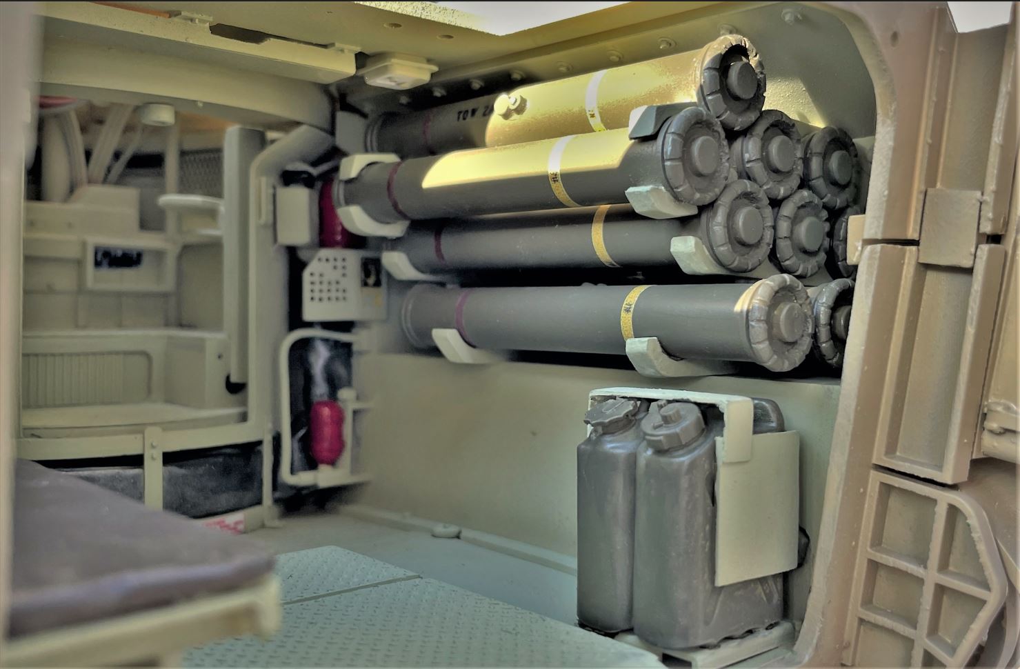

Then the interior was painted with AK 4012; APC Interior light green. The weathering and small corrections are not done yet.
- Capture3.JPG (154.91 KiB) Viewed 4615 times

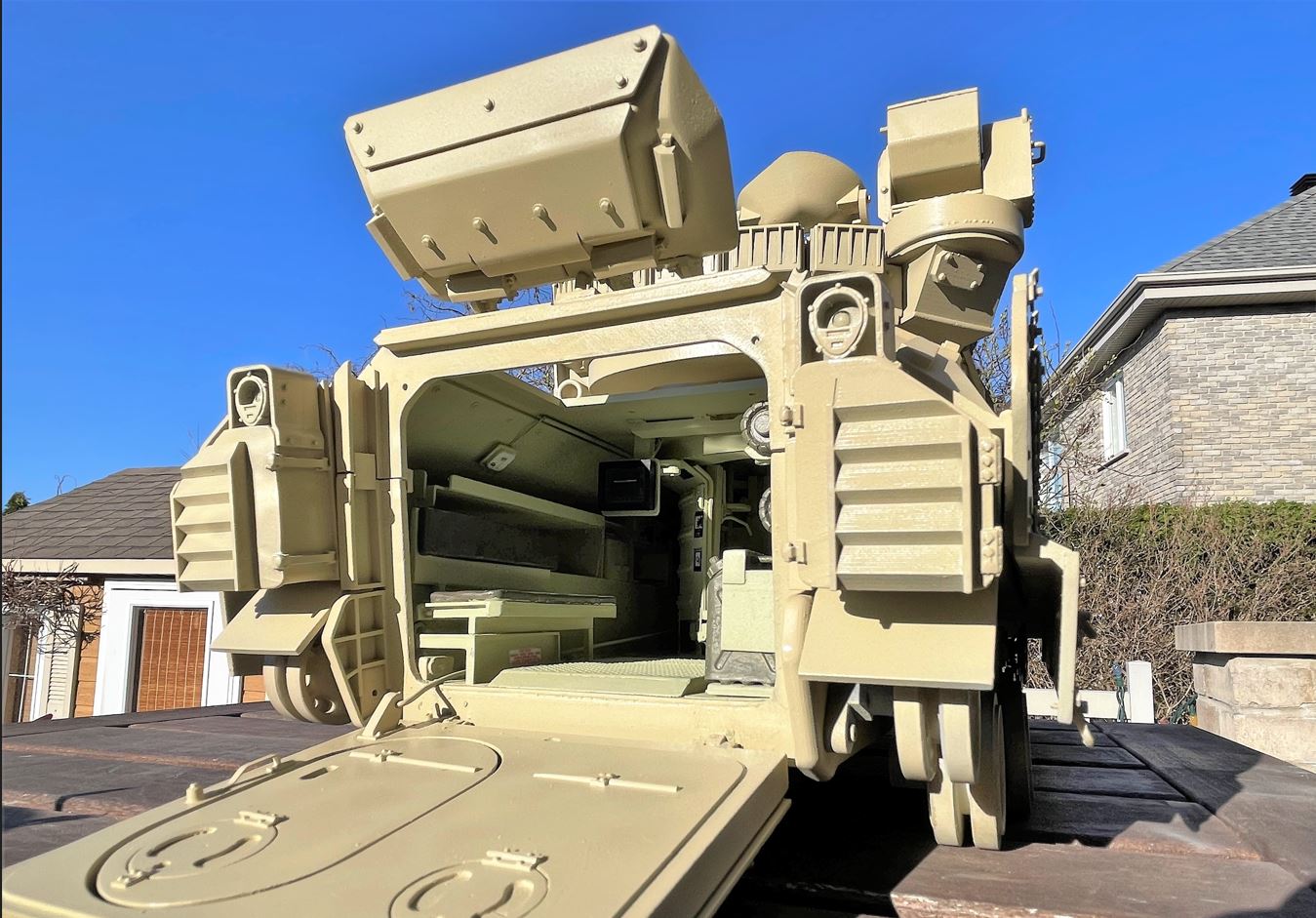

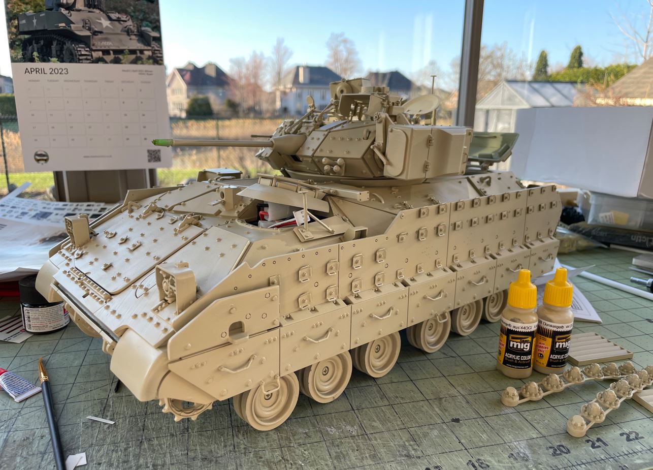

The exterior shell was given 2 coats of Tamiya enamel grey primer, then given a coat of acrylic MIG RAL7028 Dunkelgelb aus 44DGI. Forget about using readily available Dark Yellow or Desert Yellow, they do not match pictures as either too yellow, too dark or too orange. I found that RAL7028 was the closest color i had available on inventory. After seeing the model in white for months, it is nice to see some color.
- Capture4.JPG (202.96 KiB) Viewed 4615 times
- Capture5.JPG (221.03 KiB) Viewed 4615 times
