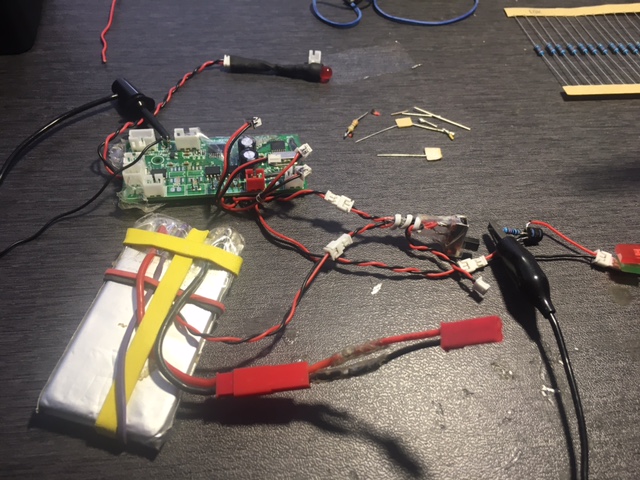

Greetings from Cleveland Ohio, Sorry for the long absence as I had a lot of work to do on a house that I rehabbed after a renter trashed it :'( Anyway, I recently got more work done to the VS Tiger 1 and VS Sherman M4A3. They can now battle each other 8) ! Just one more detail needs done on both of the VS tanks to be done. Everything thing else works very good on both tanks. The issue is the "Main Gun recoil". There is no output to drive the recoil motor on the Hen long circuit board to drive it. I am working on a work around circuit as a mod to the HL circuit board. The output needed would be a LED light that illuminate when main gun is fired, for some reason this output is not available on the HL board that I am using. To solve this problem I need to add a simple circuit mod that works off the IR LED that is used in the battle system section of the circuit board.

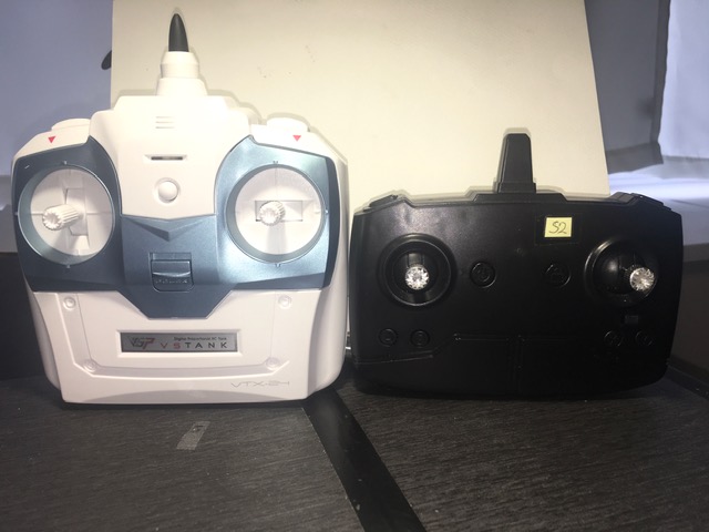

white TX to Black TX (VS-HL)

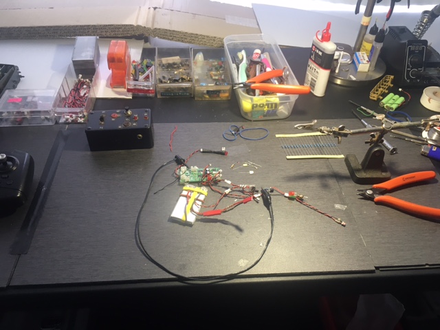

HL circuit board being revised to operate recoil gun on VS tanks.
Work station for electronic work

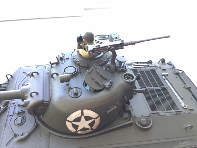

Greetings from Lakewood Ohio USA everyone. I have solved the VS Tank recoil mod with a 4 Transistor circuit. It looks at the IR output LED and converters (demodulates) the IR output pulses to a single pulse which works along side the IR pulses to run the recoil motor.
I will do a video asap. It is not as bad as it sounds and is like adding a small electronic module to the HL circuit board that adds "main gun recoil" This is the same as a LED output when the main gun is used.

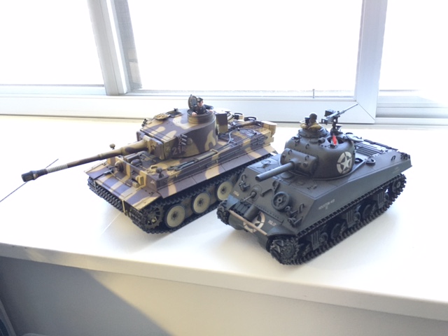

So the VS Tiger is converted now to HL battle tank with main gun recoil along with all the other features of the HL battle system.

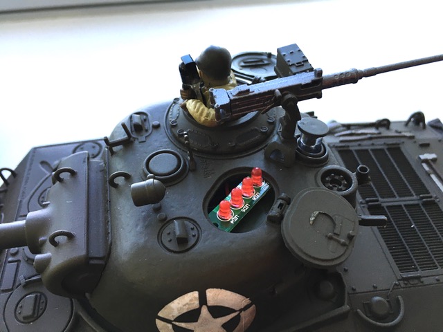

One thing left to do on the VS Tiger is to add a Battle damage indicator or Battle hits indicator which consists of 4 LEDS.
The VS Sherman has the battle damage indicator added and needs the main gun recoil mod. So still some work to go to finish but the Tanks can IR battle now as equipped.

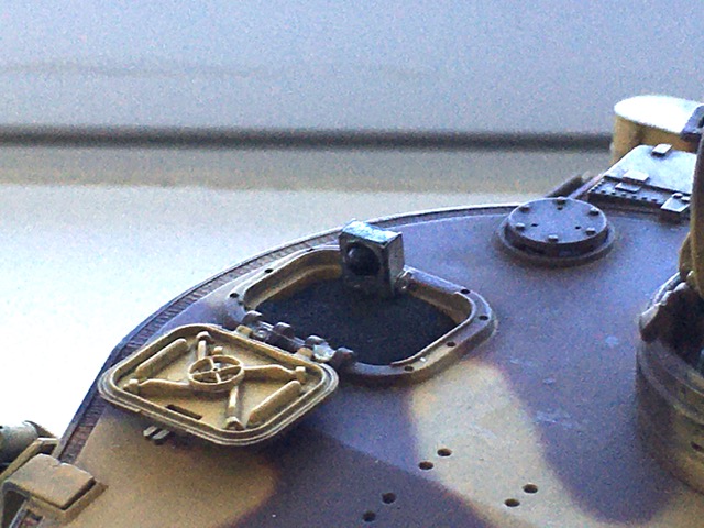

Tiger IR receiver. The battle indicator will be added to this location as well.

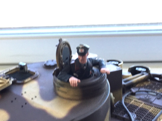

Found the Tiger Commander so now both VS tanks have thier 1/24 scale commanders on board.
Battle indicator is under the hatch and can be hidden from view for static display.
Number of hits indicator

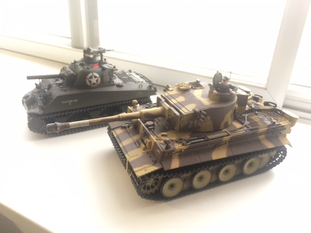

IR Battle ready
IR Battle ready

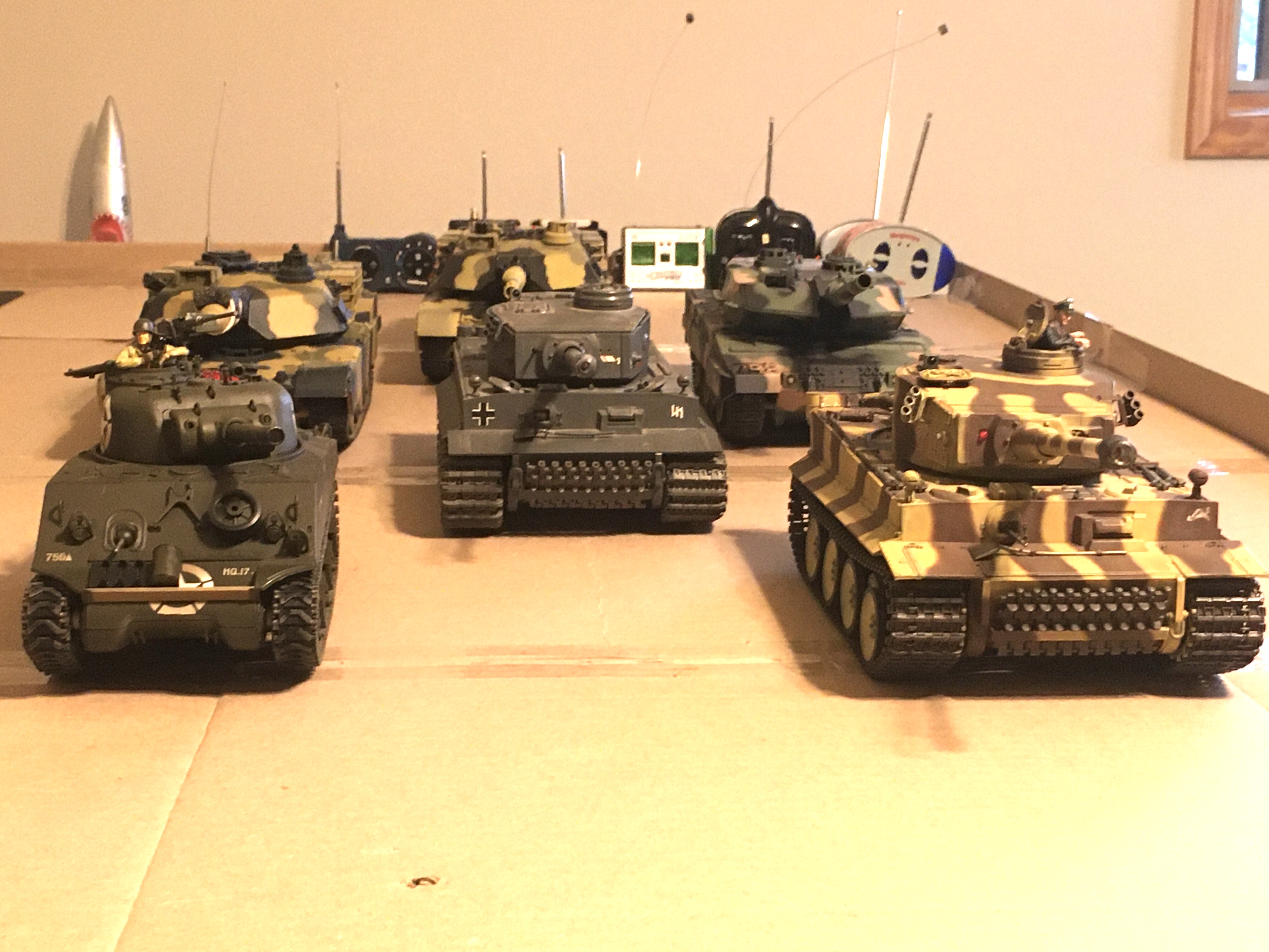

All of these are 1/24 HL compatible Battle Tanks
