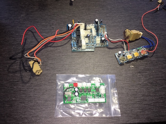

I recently got a Vs Tiger and Sherman from a member here and after evaluating these very detailed machines, decided I wanted to do a Heng Long 2.4G radio swap. I prefer the simpler control of 2 stick control with true proportional control Vs the 3 button stepped control of the Vs Tank Transmitter.
Vs Tx on the left, HL on the right.

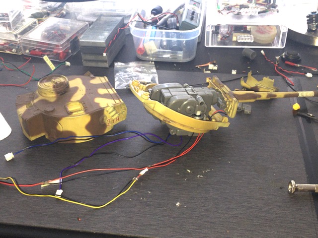

Next step is to connect the turret drive motor, IR emitter,detector and head lights.

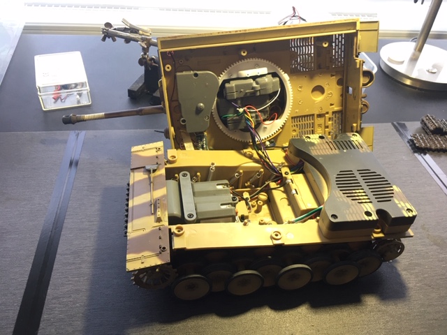

HL radio installed enough to do a mobility test. Result is good. Was not sure the main motors from the Vs tank would be compatible with the HL board. It is thank goodness.
Most of the connectors in both tanks are compatible.

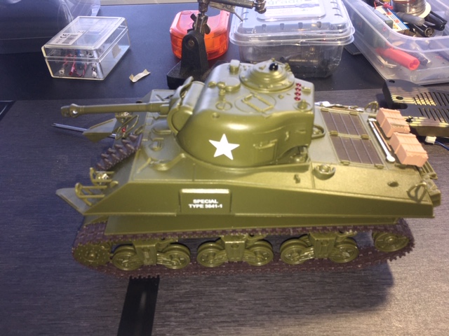

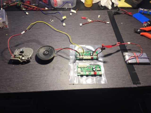

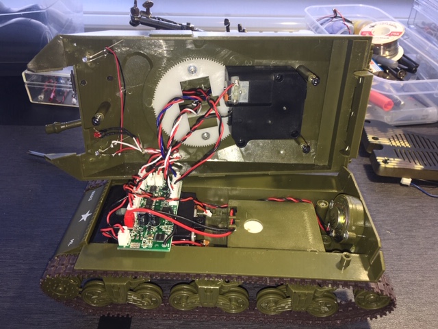

the Heng Long radio is the same as used in this 1/30 scale HL M3 Sherman.
Heng Long radio shown  in lower picture
works fine but is not compatible with any battle tank I have.

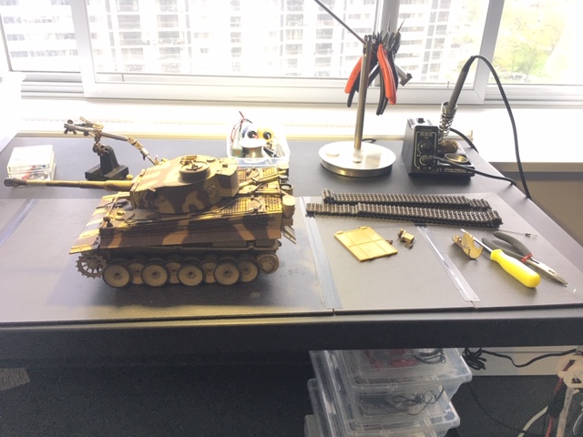

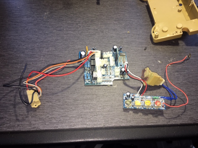

27mhz radio removed
27mhz radio removed

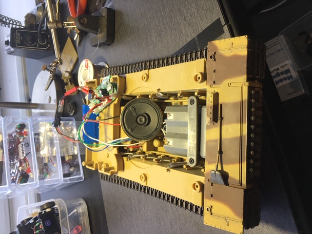

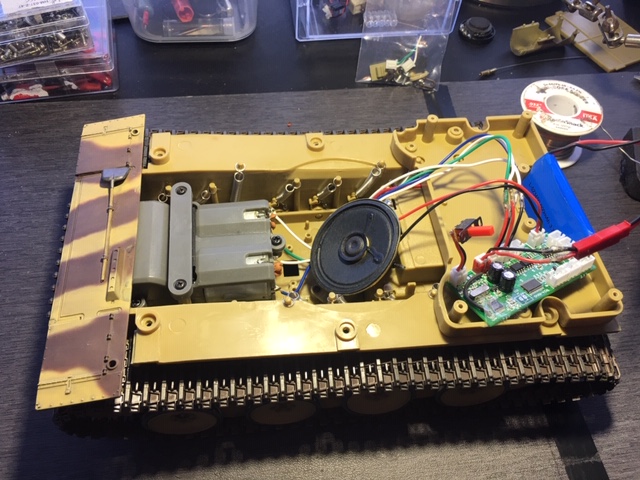

This thing has a very nice speaker and is quite loud. Unfortunately no volume control of any kind. Also when the tank stops moving the engine sound stops. I don't like that.

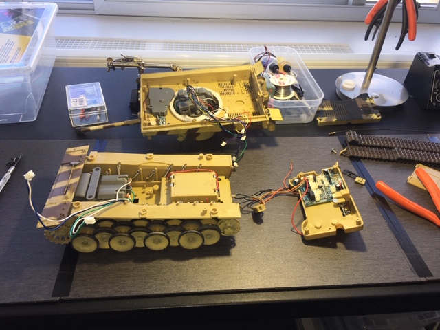

Tear down of the Vs Tank Tiger 1

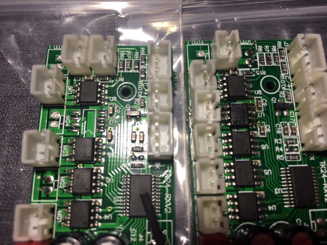

I decided to upgrade the HL board so that it has main gun up\down elevation. The HL 1/30 scale Tanks do not have gun elevation, well, they do but the left off the TC118S motor drive chip and the connector. So all that is needed to add this function to the circuit board is to solder on the motor drive chip and its associated connector. These chips are readily available from ebay. In the pictures and video below shows the work done to add this function.
Here is a video of the main gun turret drive upgrade. https://youtu.be/WtcY99epyaI
So with this mod the circuit board provides main gun up\down along with main gun left right, fully digital proportional control on both.
Note. The Tiger 1 Tank of this thread is not an IR Tank. It is a special model with bright gun flash from the barrel. It is being modified using Heng Long 2.4G IR battle tank Receiver board from a Heng Long 1/30 scale Tank. I like this HL circuit board because it ia small and easy to add to most any size tank from 1/35 scale up to 1/24 scale depending on the motors used. It is designed for 130 motors but can power bigger motors if the amp draw is 2 amps (peak) or less per motor. The Vs Tank of this thread has larger motors but they are designed to run off a higher voltage so with a 1 cell lipo they are within the current limit of the driver chips on the HL circuit board.
in this picture you can see the chip\connector upgrade that adds main gun elevation.
I have 4 of these HL battle tank boards.

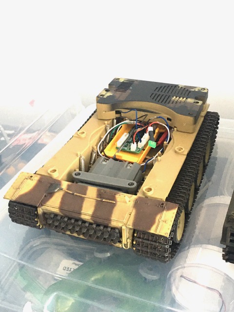

This part of the Tiger is functional. Now has true proportional throttle for the tracks with neutral turn and a remote controlled sound system with 4 step volume with mute.
Both of these 1/24 scale Vs tanks will be converted to Heng Long electronics and will be able to IR battle. This Tigere took 8 AA cells. the battery box has been cut away and now runs on 1 800 mah 1s lipo. New radio gear in the yellow tray where the AA batteries used to be.

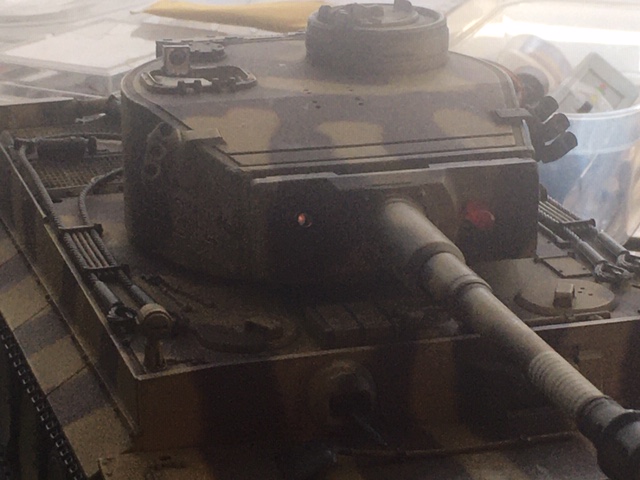

Machine gun LED added to the right side gun mantle, installed this one for now but think it is too big. IR emitter (left) turret mantle. IR receiver at top of turret right hatch. Those three items comprise the "IR battle system"
IR receiver added.
IR receiver added.
