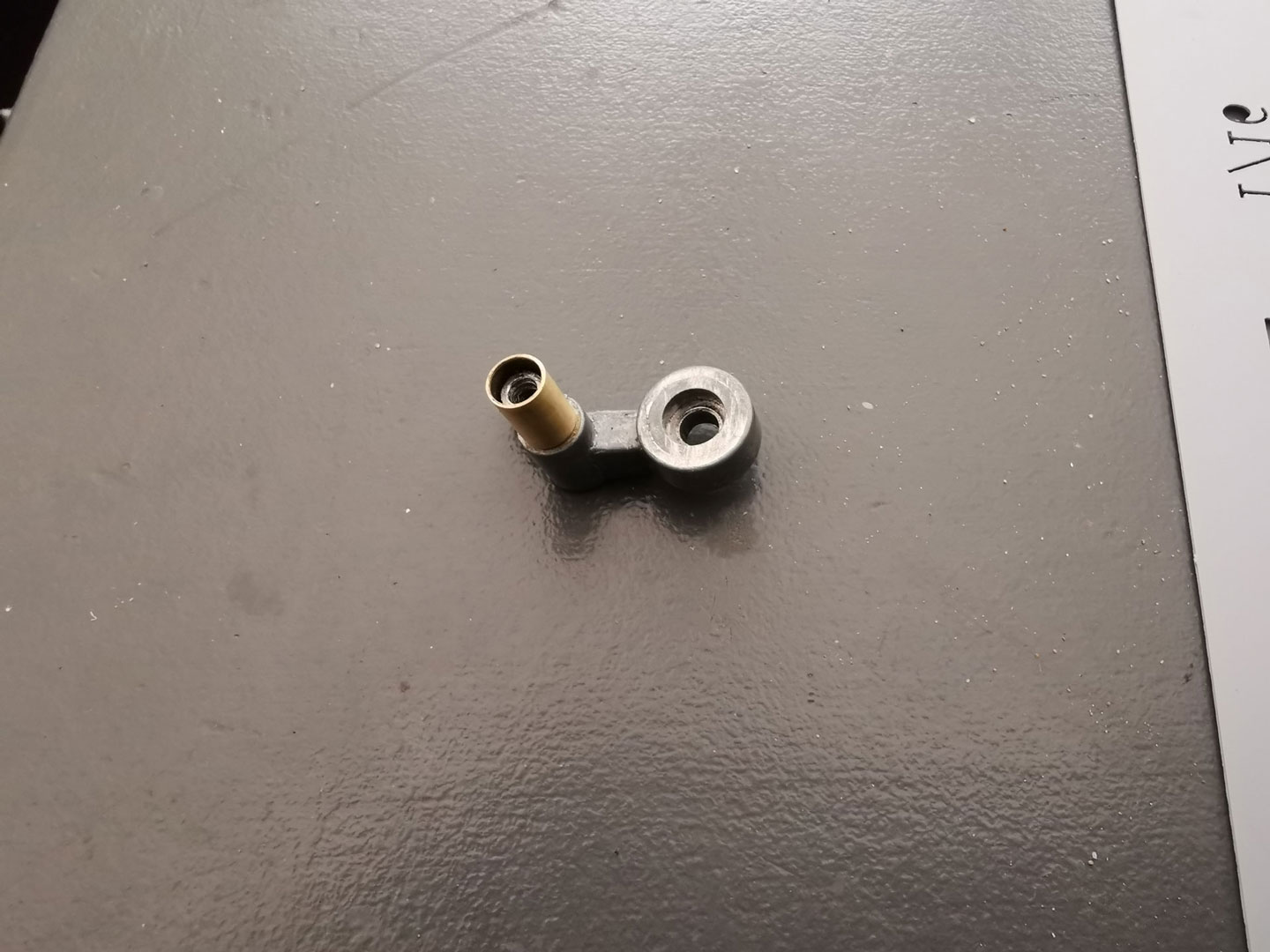

I can't focus on one task, while I had the suspension removed, I thought it was about the right time to fix them. I'm using the Mato wheels with the Heng Long metal suspension. HL suspension shaft is too short and is only supporting half of the lenght of the wheel assembly and diameter is too small which induces lot of wobble. To fix that, I redrilled all the wheels once glued together (6mm) and I reduced 6mm brass tubing to 5.9mm on the lathe and cut them 13mm long. I cut 16 of them and glued them on the HL suspension shafts. No more wobble and it will last longer than if it has been cast alloy (wheel) on cast alloy (suspension), cast alloy on brass is much better for durability and friction.
