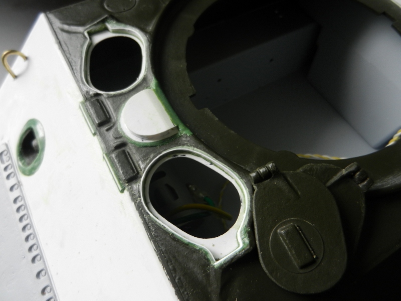

8O I can be answered, un 'can quickly, because I see that the hatches Mato (metal) are smaller? what's going to be problematic to fill around? not possible to reuse the original ones?
Jussek
Posts: 637
Joined: Wed Sep 07, 2011 7:59 am
Re: I'm not a Sherman guy but... Jussek's M4A3(76) 'Soul Rea
Post by Jussek »
hi mate
thanks for your inputs, It is a similar approach to the one I had in mind. The main problem is the molded hinge, it was damaged, but maybe i'm able to make it work.
unfortunately I did not drill the shaft for the dowel from outside the upper hull before cutting the hatch, and now the holes do not line up too well
At the moment I am testing with a 0.3mm wire, very malleable, and a magnet to keep the hatch closed, it does not open completely, but I think it will be enough to access the main switch
if it doesn't work out well, there is always plan B, Mato hatch and putty!
under the hatch I have placed a plasticard reinforcement taken from an old credit card, here you can see it before being trimmed with the dremel tool
the hatch in place, as you can see, a part of the hinge is missing, I will have to use milliput to repair that hole
while the glue dries, I have been making the antisplash covers for the gears
best regards!

indeed, less simple, not sure whether the milliput is strong enough? can you try to redo the missing part with 2/3 mm thick ABS, taken up from below and glued to express stability?
Jussek
Posts: 637
Post by Jussek »
hello sirs
indeed Jofaur, the milliput was not strong, I removed all the putty that I had put, and replaced it with another type, pattex, once set it remains like a rock
I left this space that can be seen in the photo on purpose, to be able to insert the hinge tab, which I have made with a 0.5mm thick aluminum strip
the 'hinge' with its flange
Once installed in its place and with the Pattex putty I have filled in the empty spaces, making sure that the hatch can be opened without problem
there is still some corner where to put pattex to finish filling all the empty space, once primed and painted I hope this rustic system is not too noticeable!
