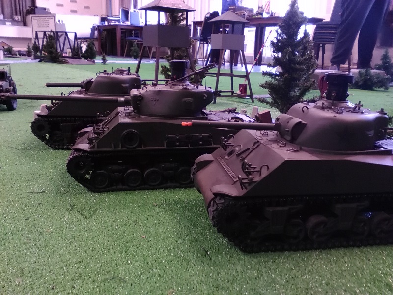

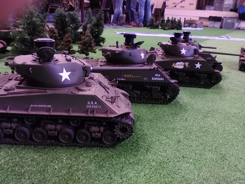

Tiger6
Posts: 1460
Re: I'm not a Sherman guy but...
Post by Tiger6 »
Some pictures from a club meeting a few years ago:
