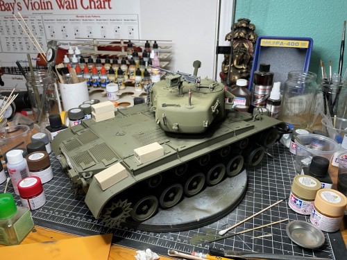

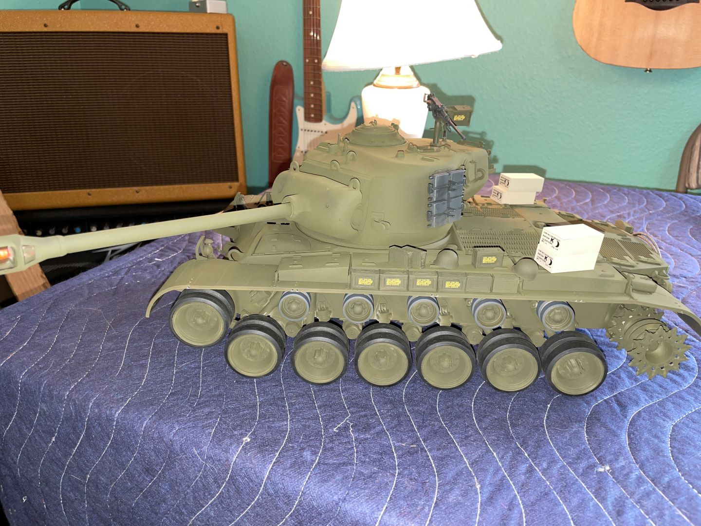

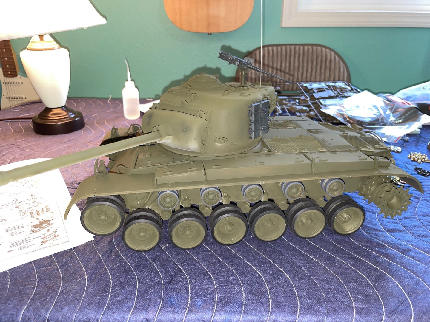

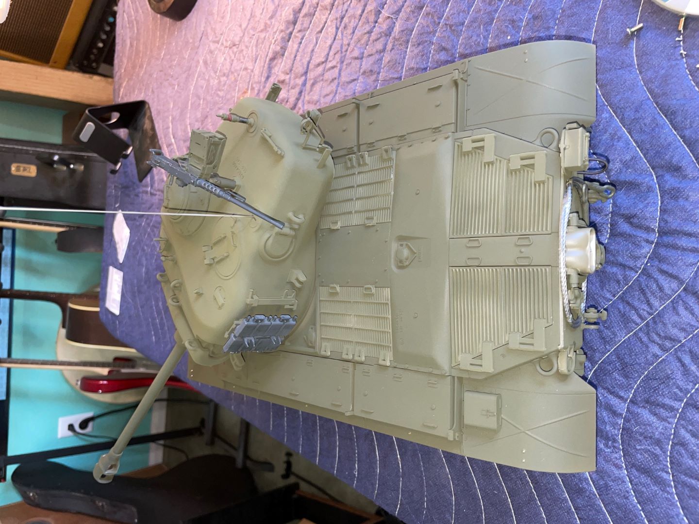

Another step in the painting process. Olive drab base coat is down, along with nato black around gun ports, spare tracks and the MA-Deuce. More detail to come.

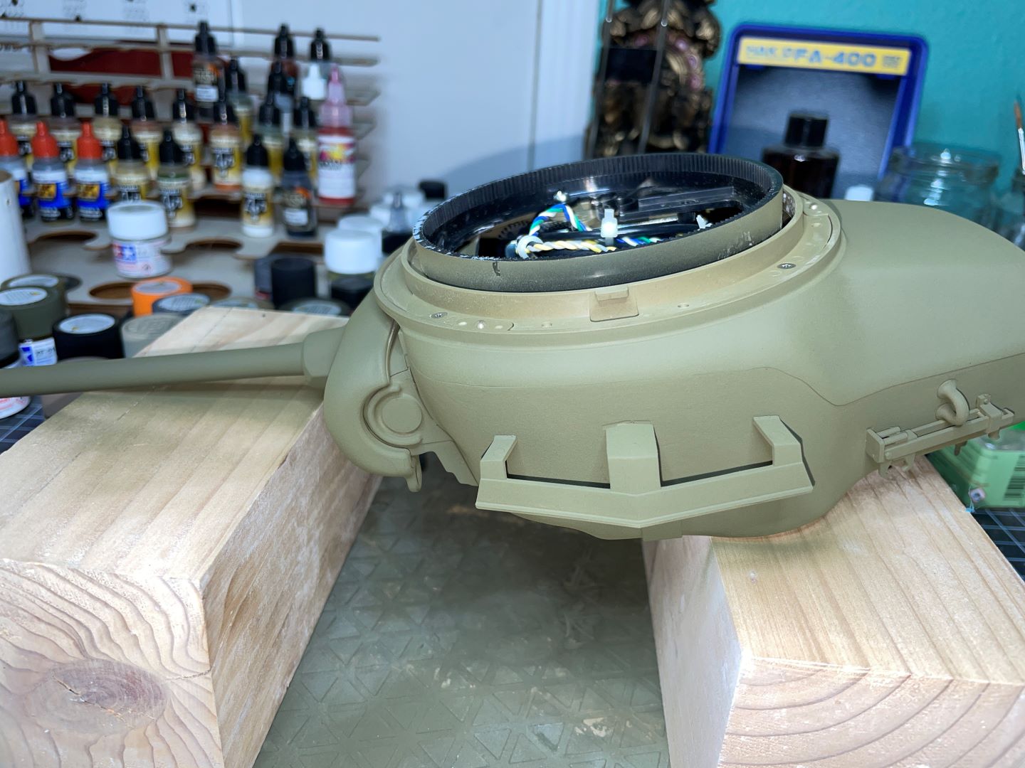

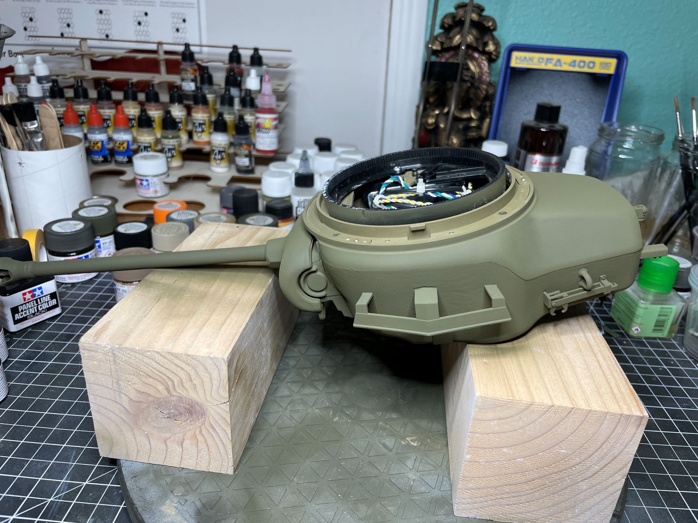

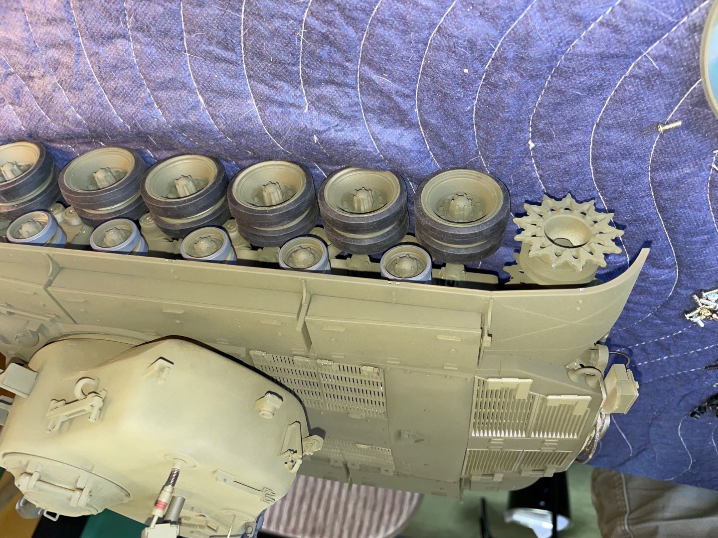

Hello comrades,

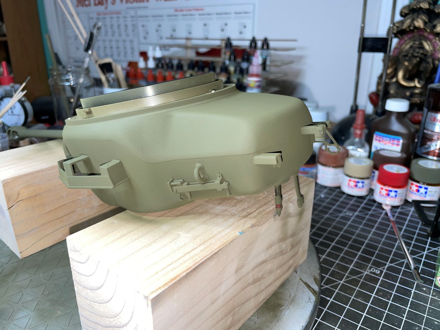

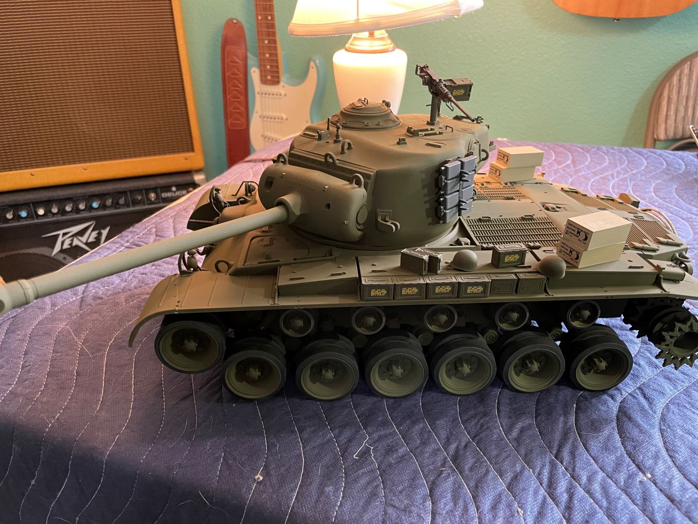

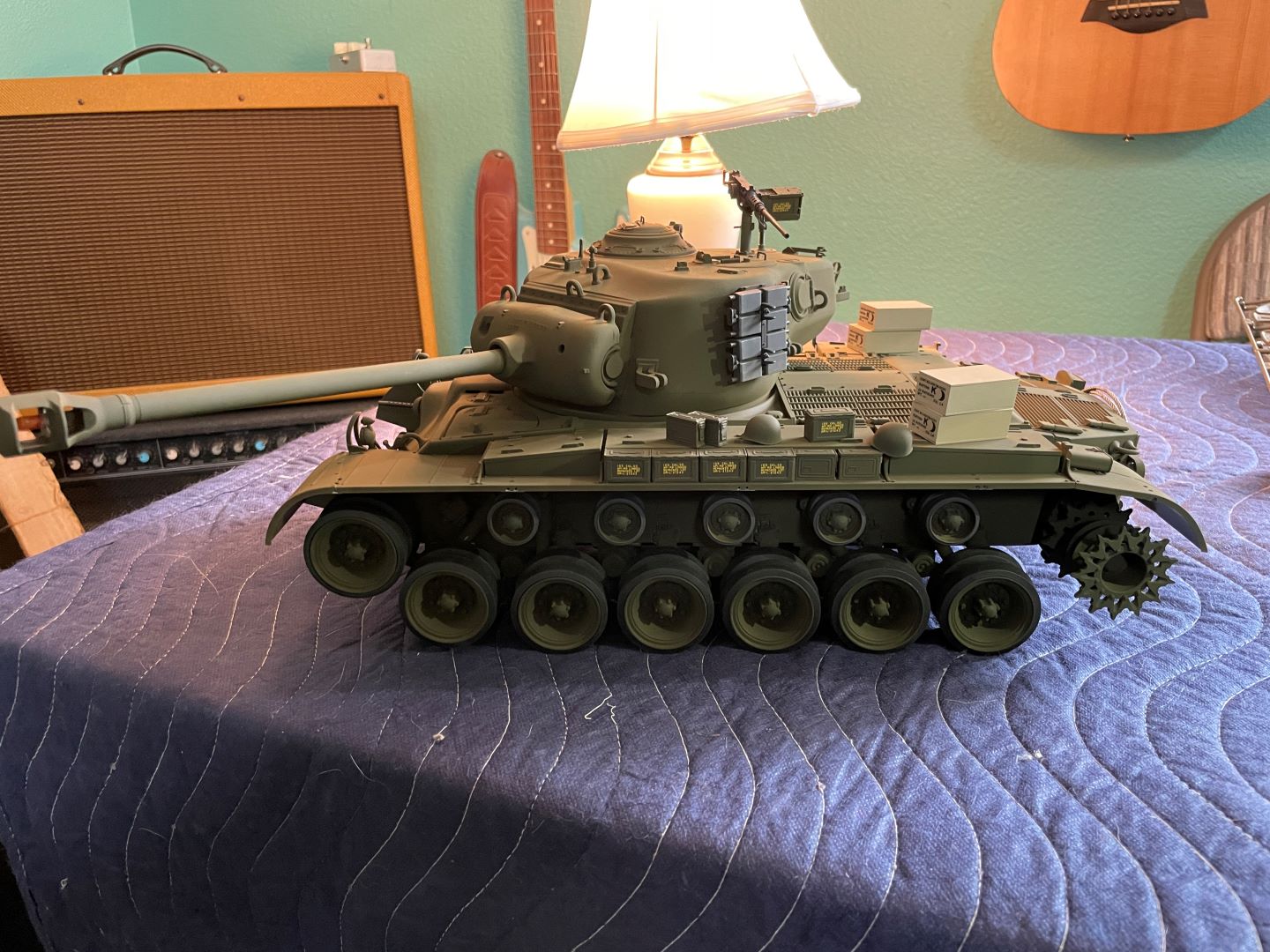

Needless to say, if you are looking closely at my pictures, I'm learning as I go. I've noticed that some of my fitment isn't what I would consider to be acceptable. I've also moved too quickly on prepping, sanding and parts cleanup, much too quickly. In short, there's some pretty shoddy workmanship here. One thing I believe I have discovered, is my amount of cement isn't near enough. I've built lots of models over the years, but this is the first where I have to assemble motors, gears, rubber wheels, screws and RC equipment after I have assembled the base model. I'm breaking and separating parts that have long since been glued. To get to the chase here, I'm thinking of sand off the base coat along the seem in the two main pieces to the turret, applying some Tamiya putty to smooth out the fitment and repainting. Not the entire turret, just along the fitment seem about 5-10mm either side. See the pictures below. Any thoughts on that? One other question, I would like a rather hard, durable clear coat to seal the paint. Any favorite products and or technique suggestion would be greatly appreciated.

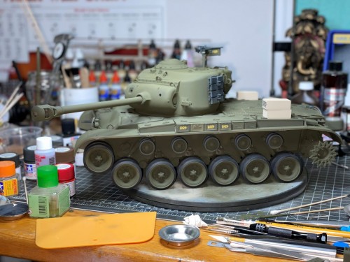

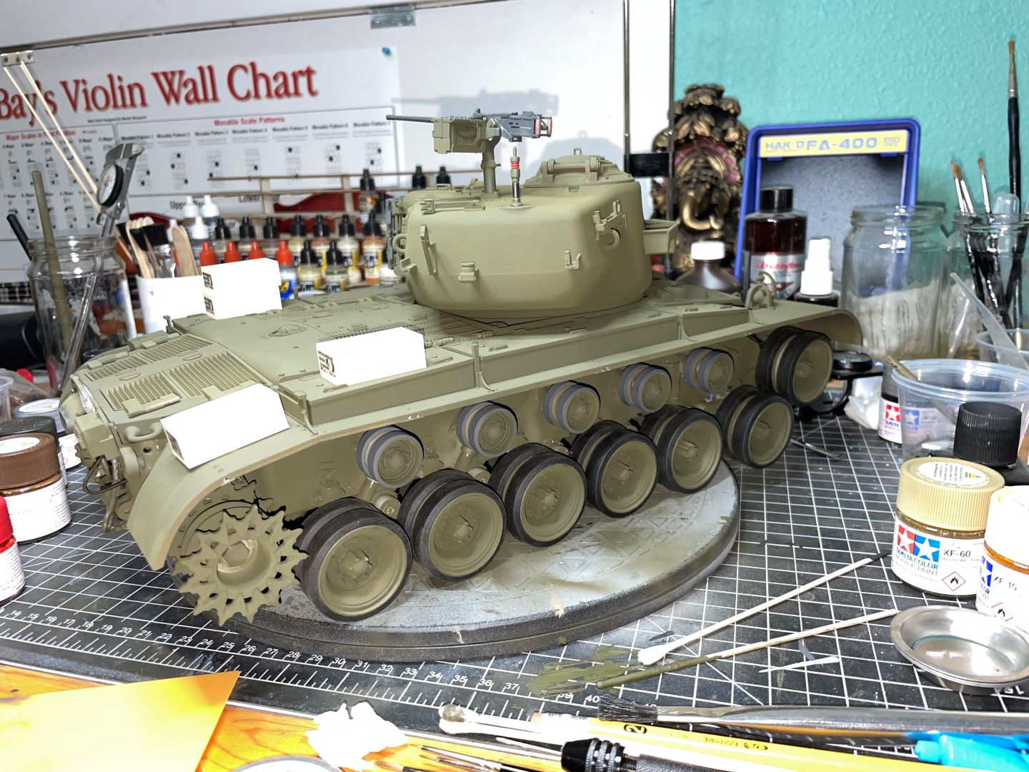

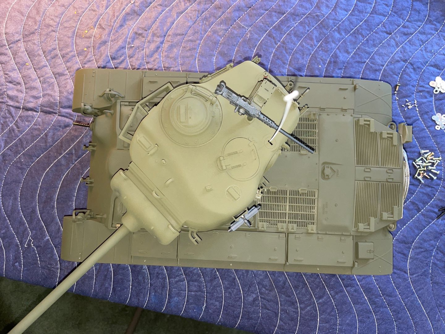

Another coat of base olive drab. Did some touchup to various spots. Put the decals on the ammo and the K-rations. Several spots I'm not happy with. First, the ceramic insulator on the short wave radio antenna, currently red, needs to be fixed. The actual color, at least according to John at East Coast Armory, should be a reddish Bakelite. As far as the clear coat goes, I have automotive clears that could be used. I have both urethane and lacquer clears and I am considering using the urethane on the Pershing.

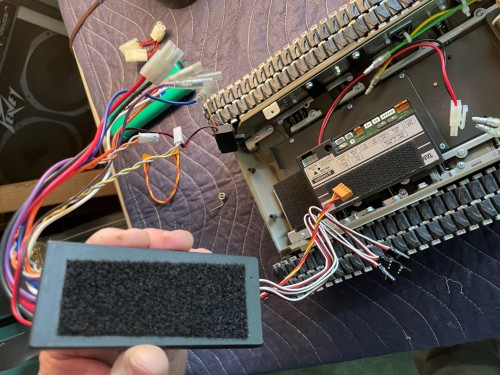

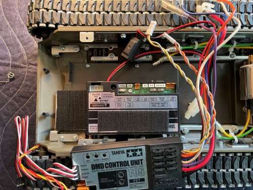

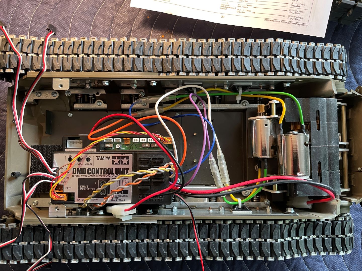

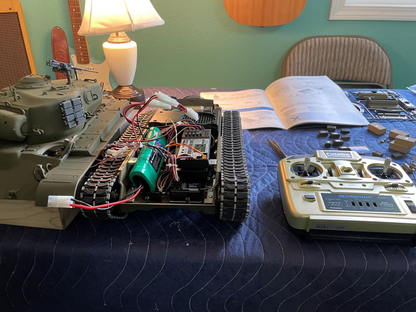

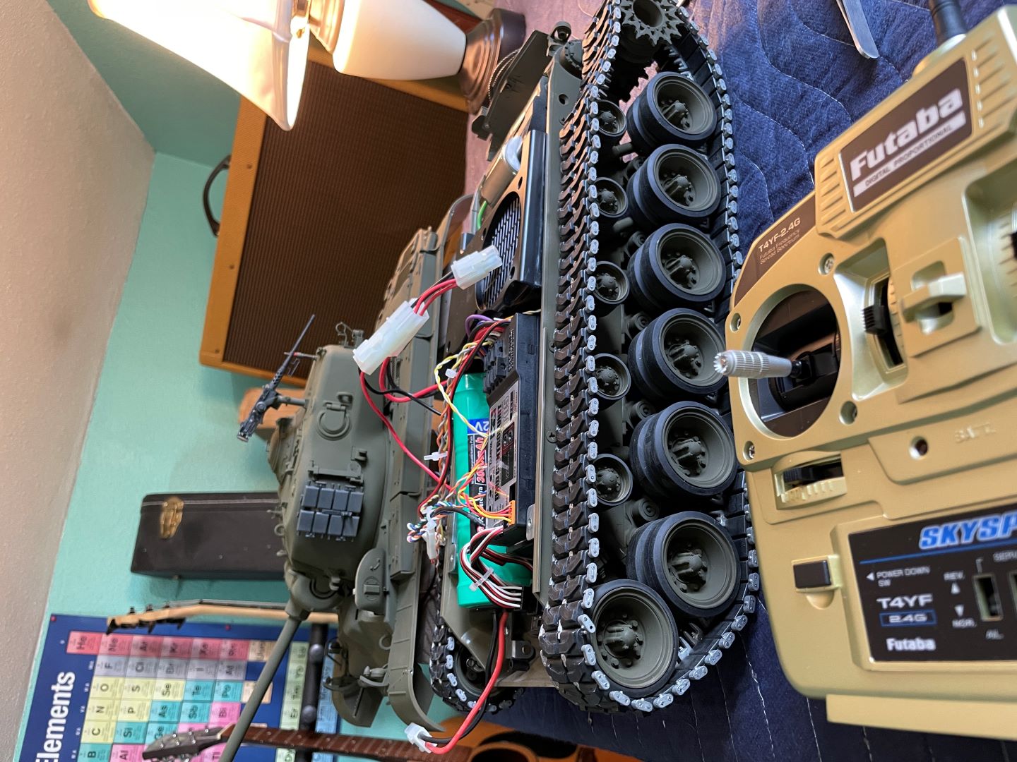

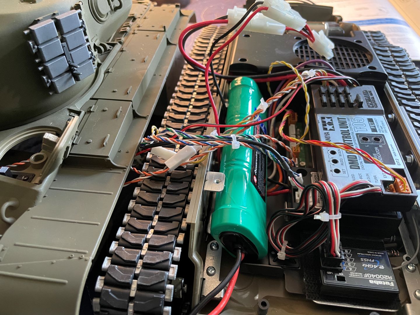

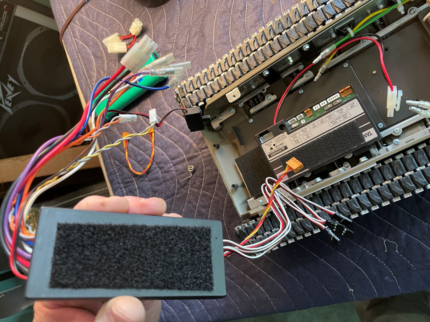

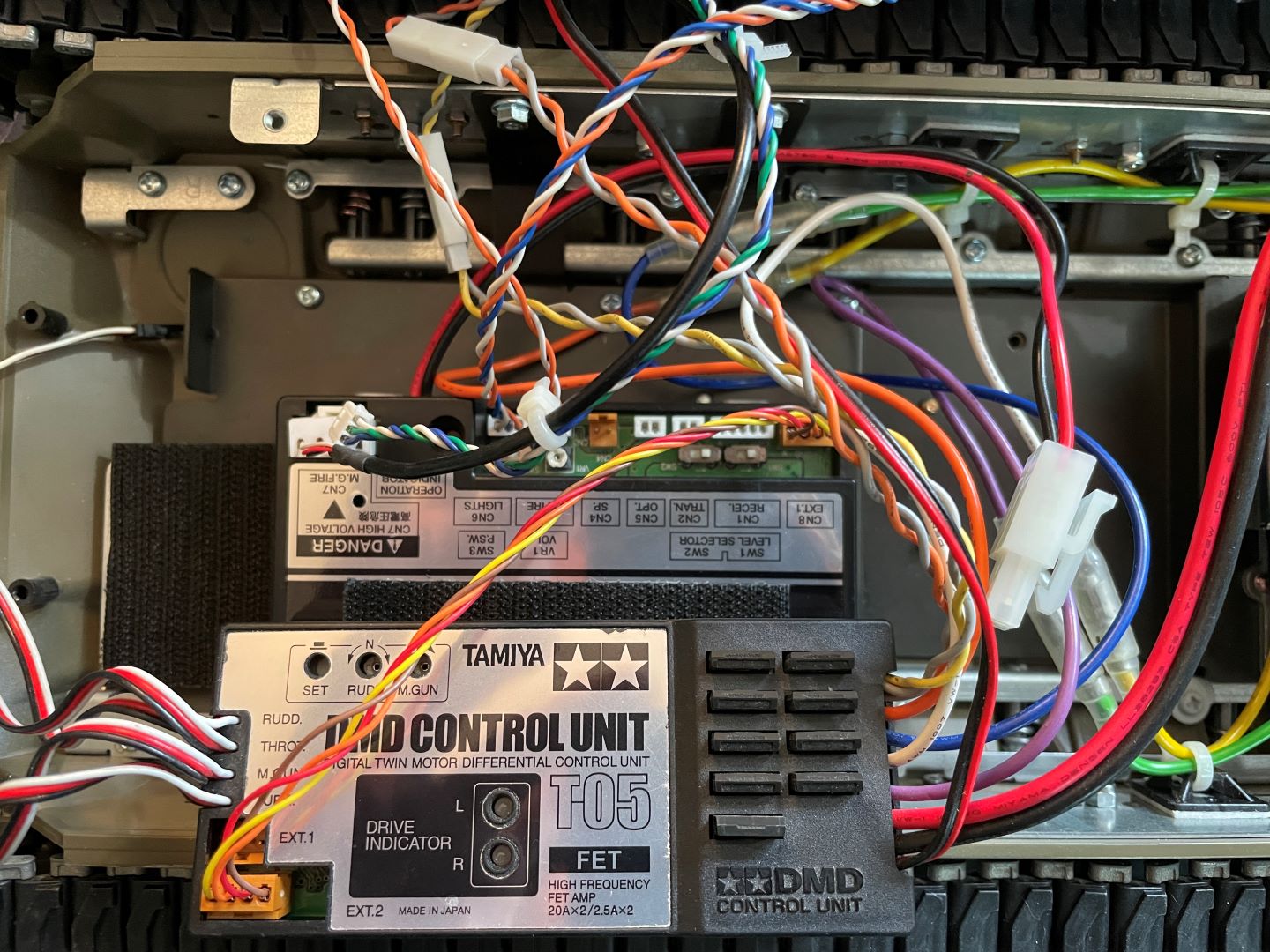

Started the electronics this past Saturday. Here are a few pics of the progress.

Actually, the base coat of OD may have helped you see the seams to which you refer. I find that a primer coat usually shows me all my horrible errors and sends me back with sanding tools. I have used Testor's Clear Coat for years, but it may only be available in the US. Other modelers have said that the lacquers yellow after a while, but I have not seen it. Clear flat Acrylics are available that are said not to yellow. Vallejo makes one, as do other brands. One thing: too many coats of clear flat start to create a glossy appearance.
There, now I've told you everything you knew already. :/

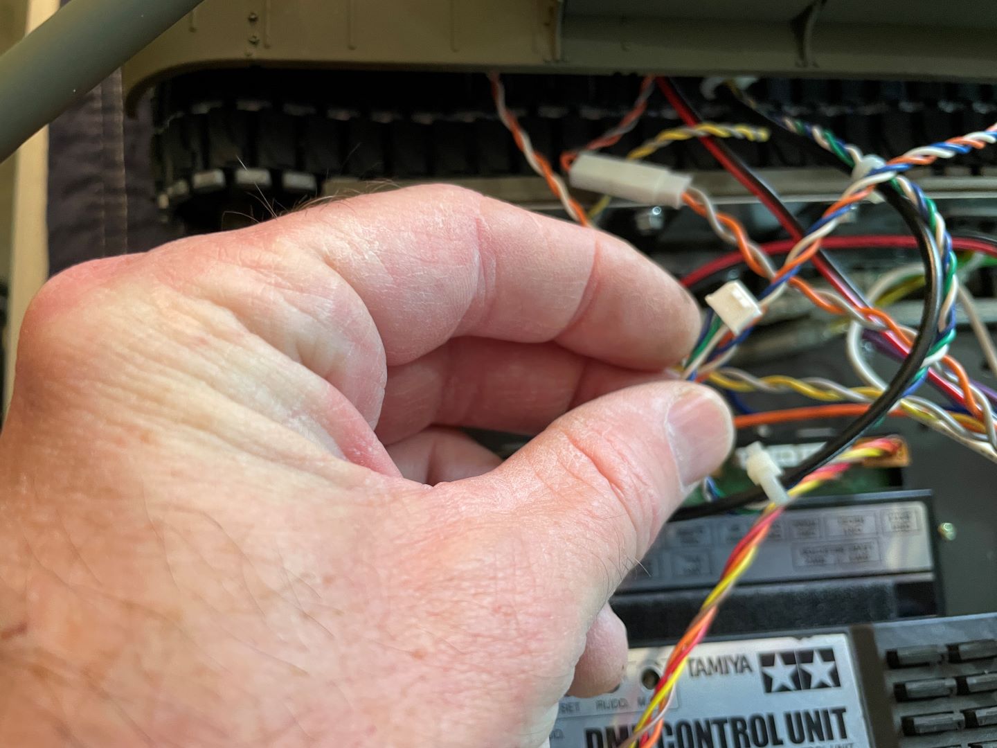

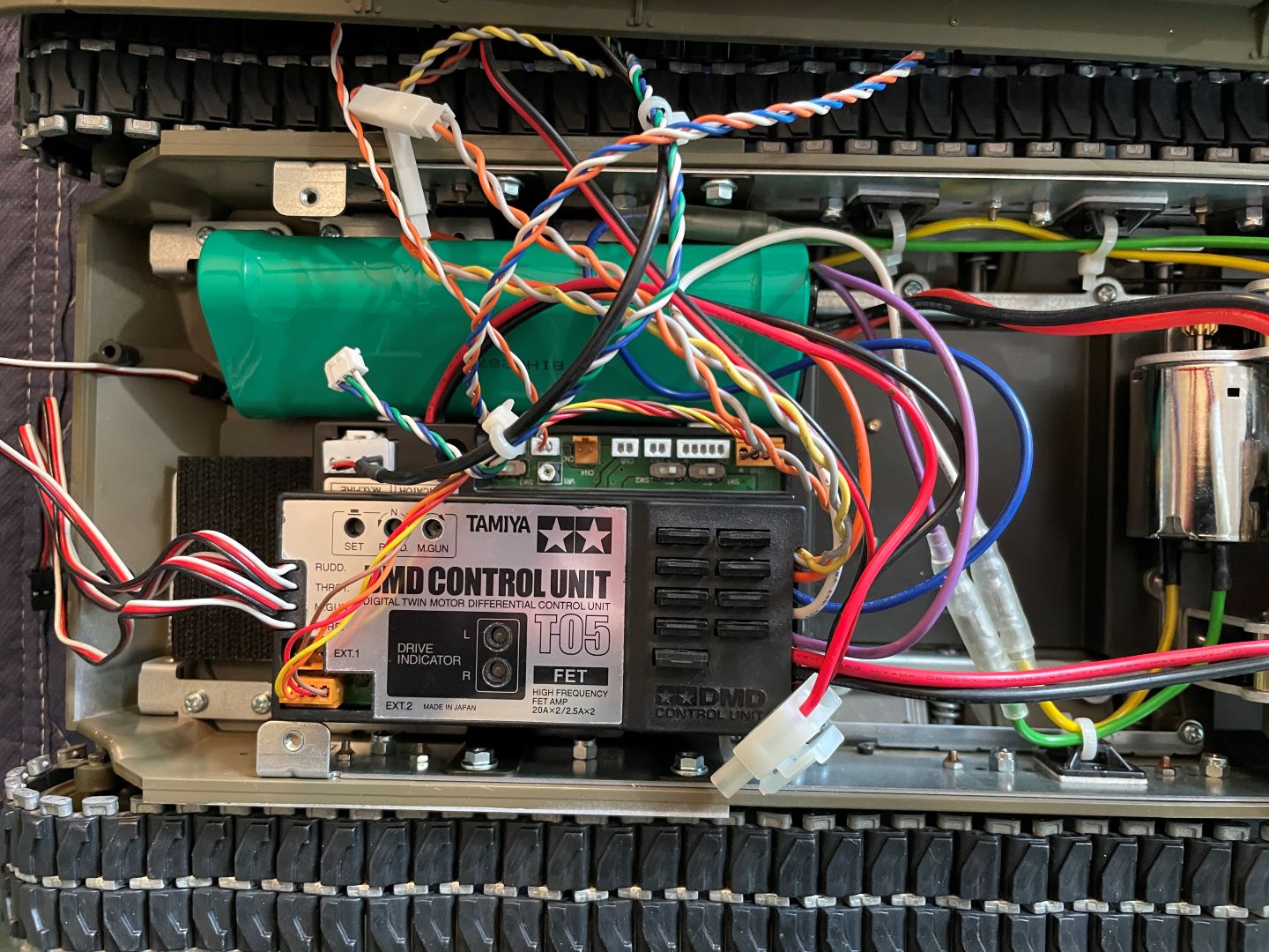

Post by sstudley »

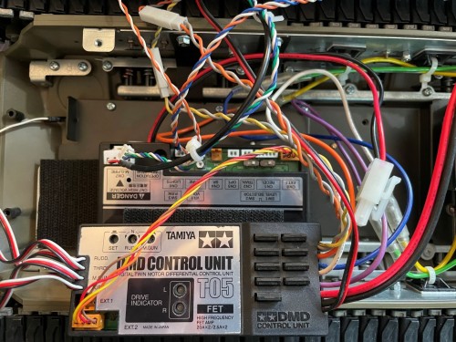

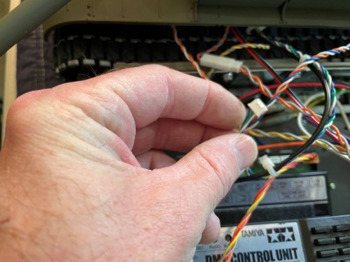

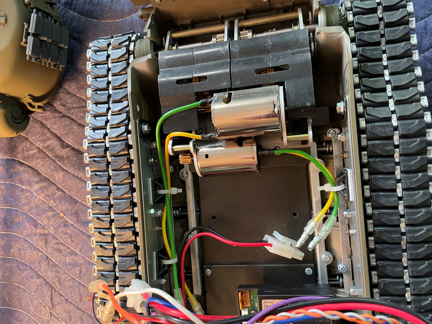

Hey folks, I'm having a hellava time getting the wires organized and laid down so I can close to the upper and lower hulls. I would love it if somebody in the forum has a special secret that will make this step happen for me. But I suspect there's no magic here. Gonna have to continue with the trial and error.
I finally got the speaker to sit flat against the lower hull. That was a feat in itself ;) I have another bug to fix, the gun elevation is stuck. I elevated up, wondering how it would handle hitting the upper limit. Well, I got my answer! I'm not taking that dogbone armature apart, it took me days to get in assembled the first time! I will post a few more pictures and a movie. If anybody has any suggestions for me, I'm all ears!
Thanks!
Steve
