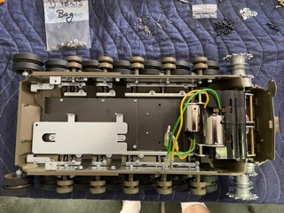

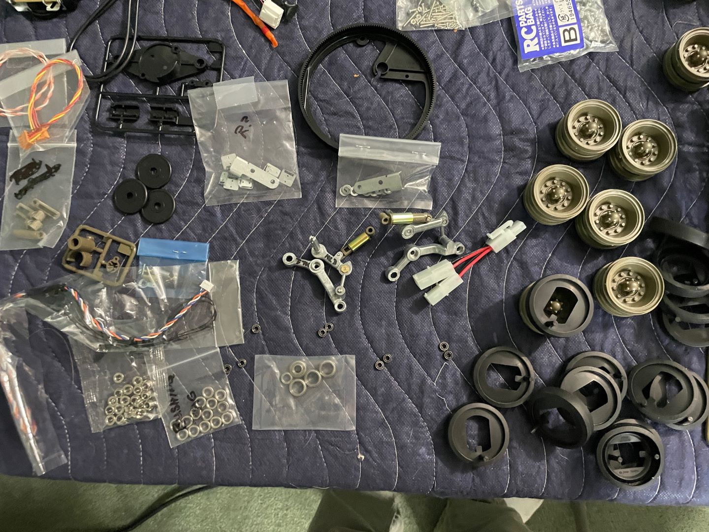

Hello comrades,

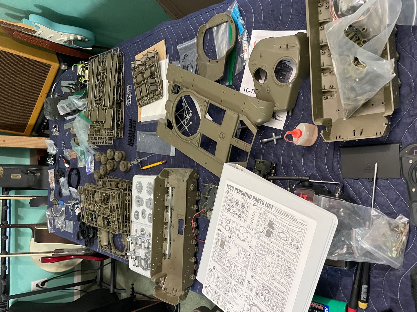

I'm starting a build that will be my first Tamiya, 1/16, RC build to date. I have "assembled" a couple Taigen tanks and performed a few minor upgrades, but this is my first build as it were. I just bought this partial kit on eBay. I had noticed it was missing the electronics, but as I discovered once I had won the auction and received the kit, it appears to be missing a few other items. I wouldn't have set the limit as high, and thus would not have won the auction, had I paid closer attention to the listing. But now the deed is done and I have started assembly of what I have. I've put out feelers for the missing items, an electronics package, and tracks. I think that is all that is missing.

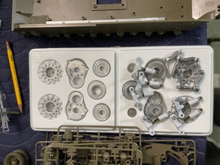

So today I was able to get the wheels assembled and attached along with the brackets that secure the wheels to the hull. I'm not painting things at this stage nor am I applying grease or locktite. Basically I'm doing a grand dry-fit with the exception of a few items I chose to go ahead and glue. I have been cleaning up parts as I go but haven't gone to the nats-ass on sanding just yet. I've made it through the first 17 pages of the assembly instructions. More to come...

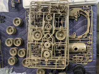

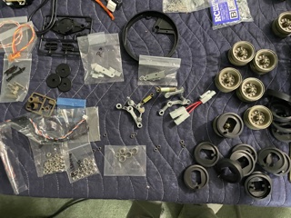

Laying everything out and trying to account for all parts.

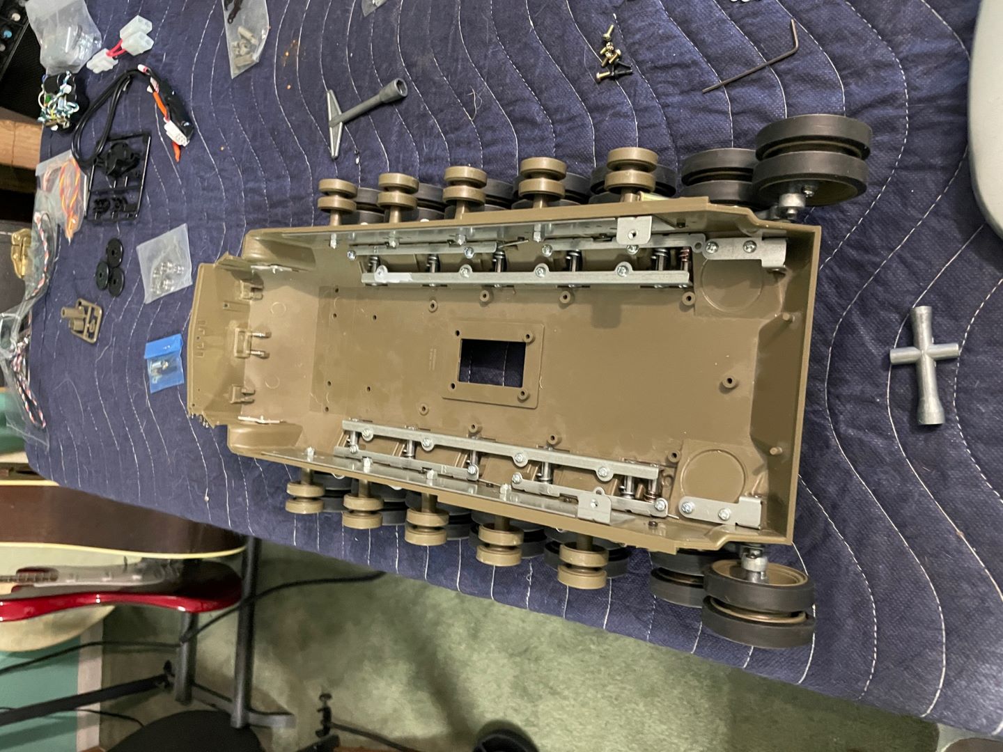

Post by sstudley »

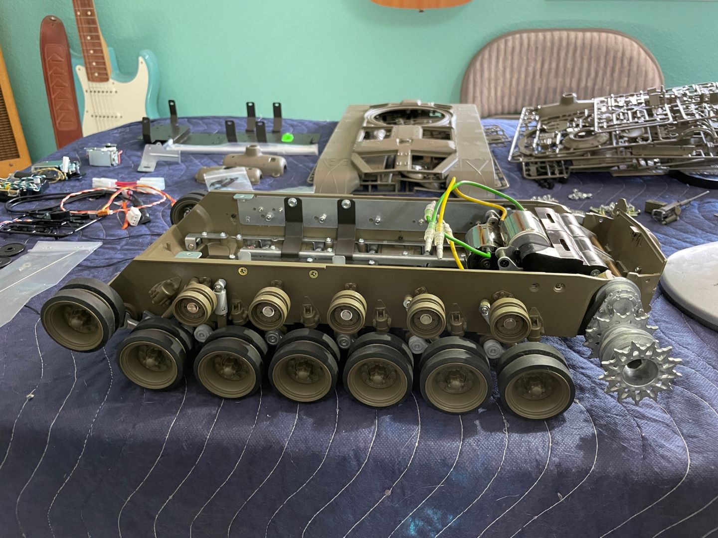

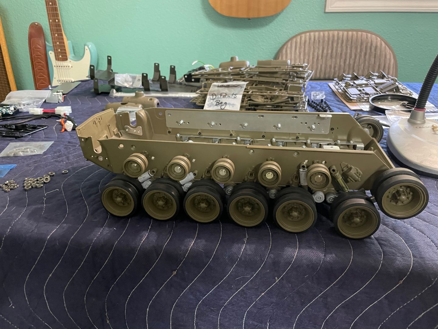

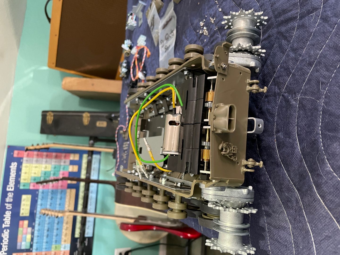

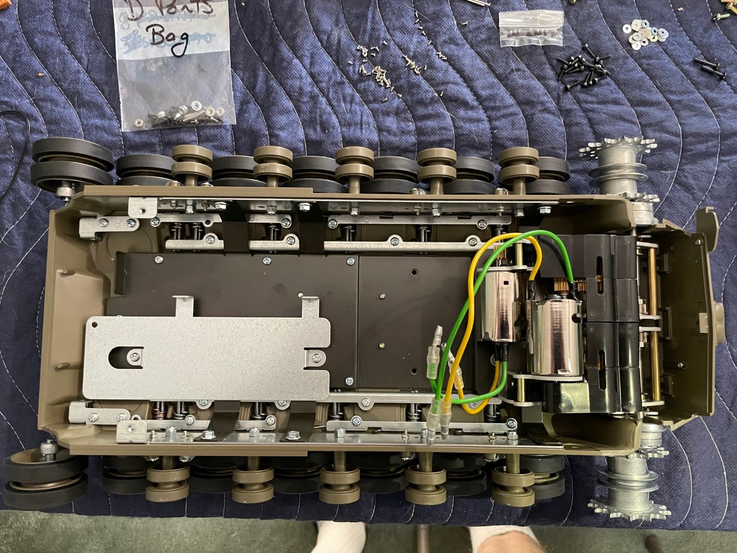

I finished up the lower hull, minus electronics. Everything went together pretty easily with the exception of the left side plate. I found that at step 19 the holes in the side plate, although properly aligned for road wheels, return wheels and shock absorbers, for both right and left sides, did not align with the inner deck holes for the left side only. I had to disassemble the road wheels, return wheels and shocks so that I could properly align the screw holes for the inner plate (left side only). I guess I should have noticed on my own. But I hadn't. Other than that little hiccup the lower hull assembly was a breeze.

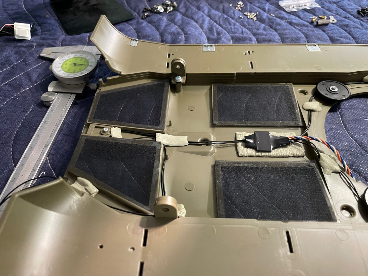

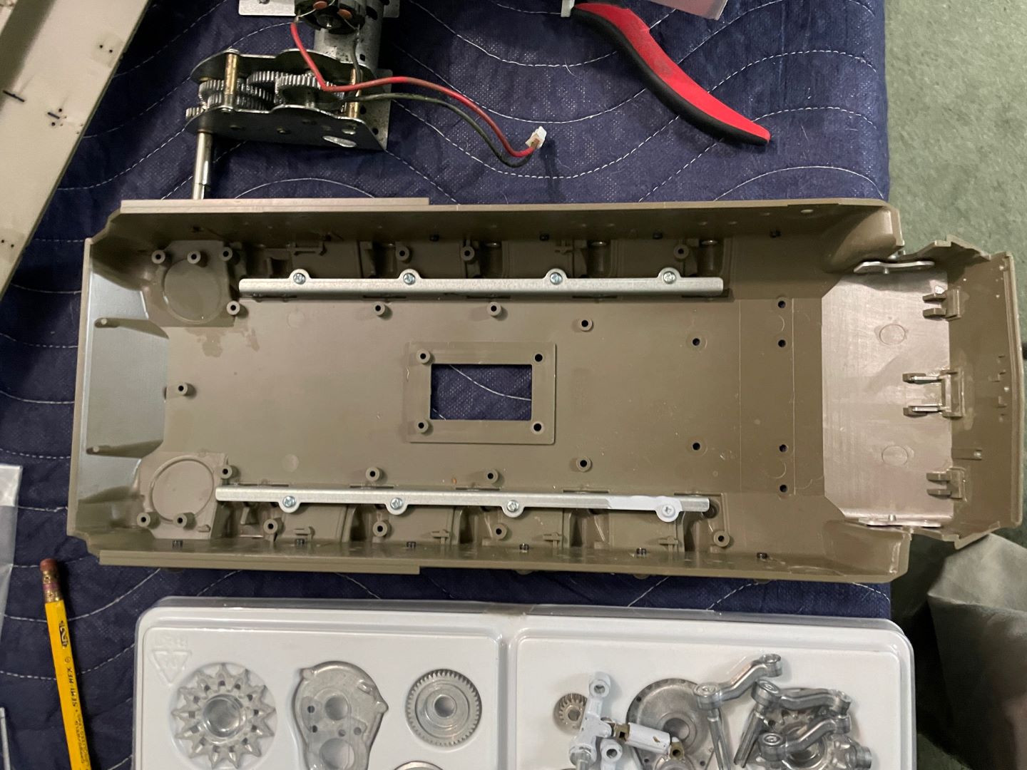

Here's some higher resolution pictures. More to come...

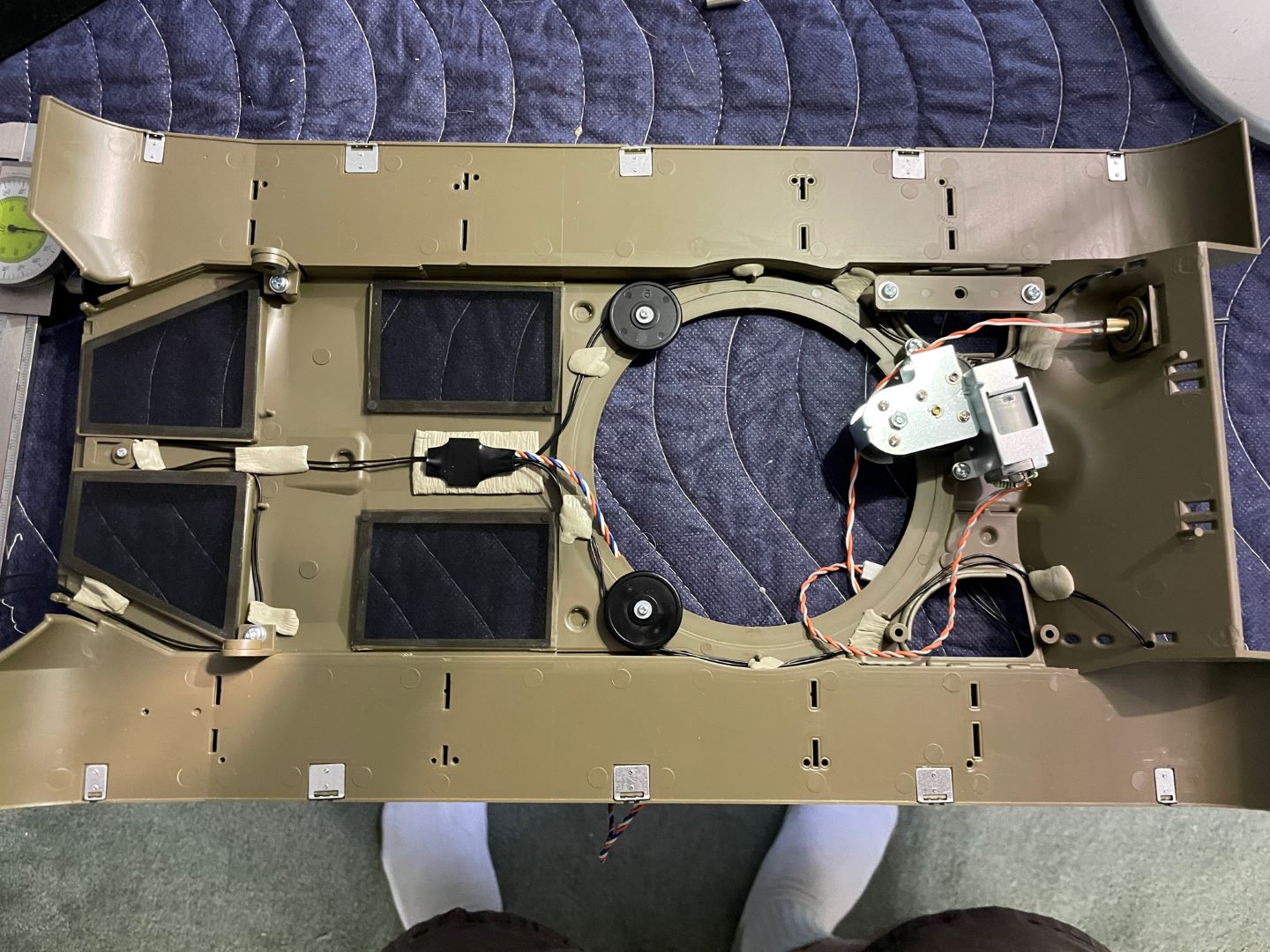

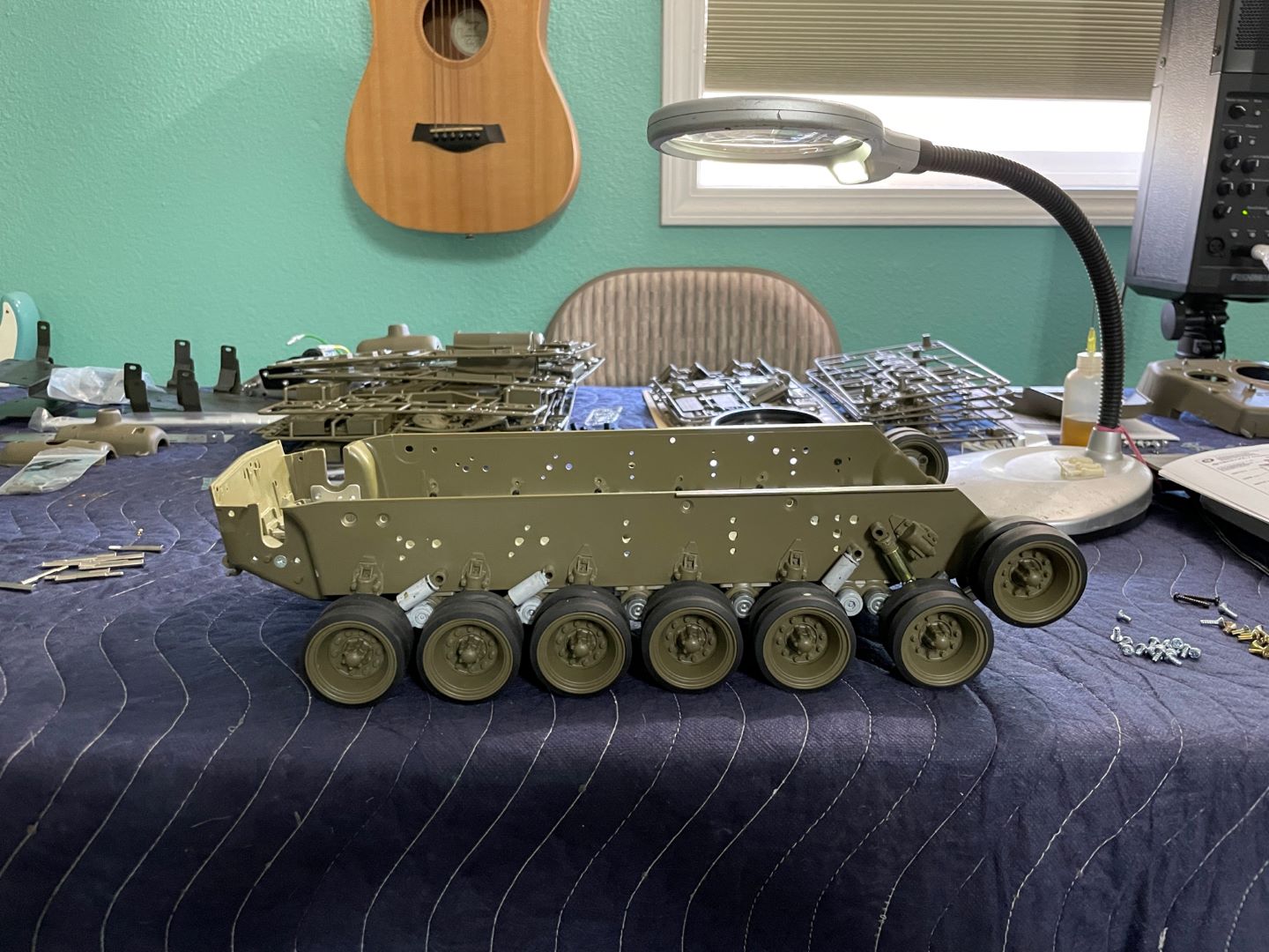

Post by sstudley »

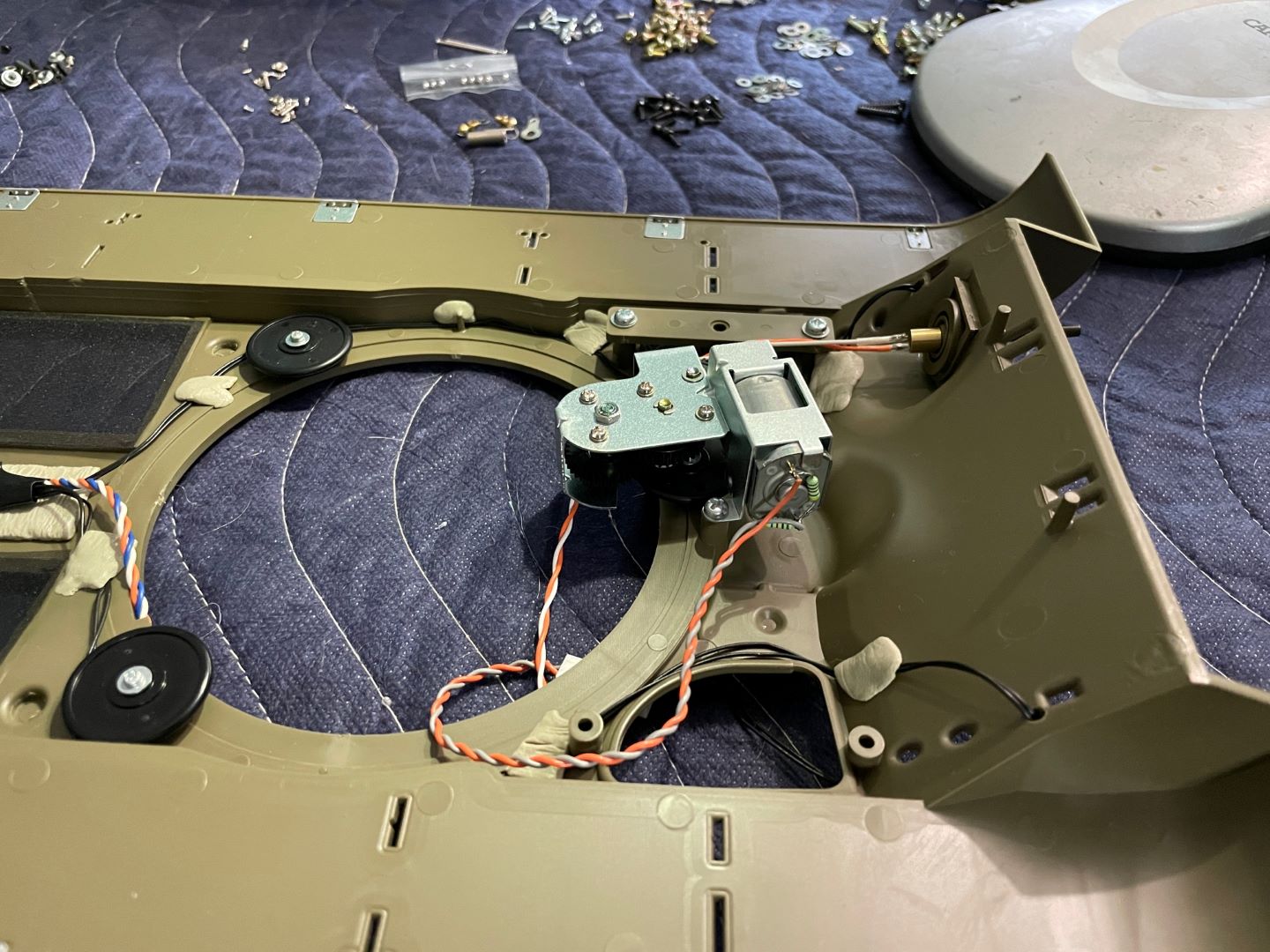

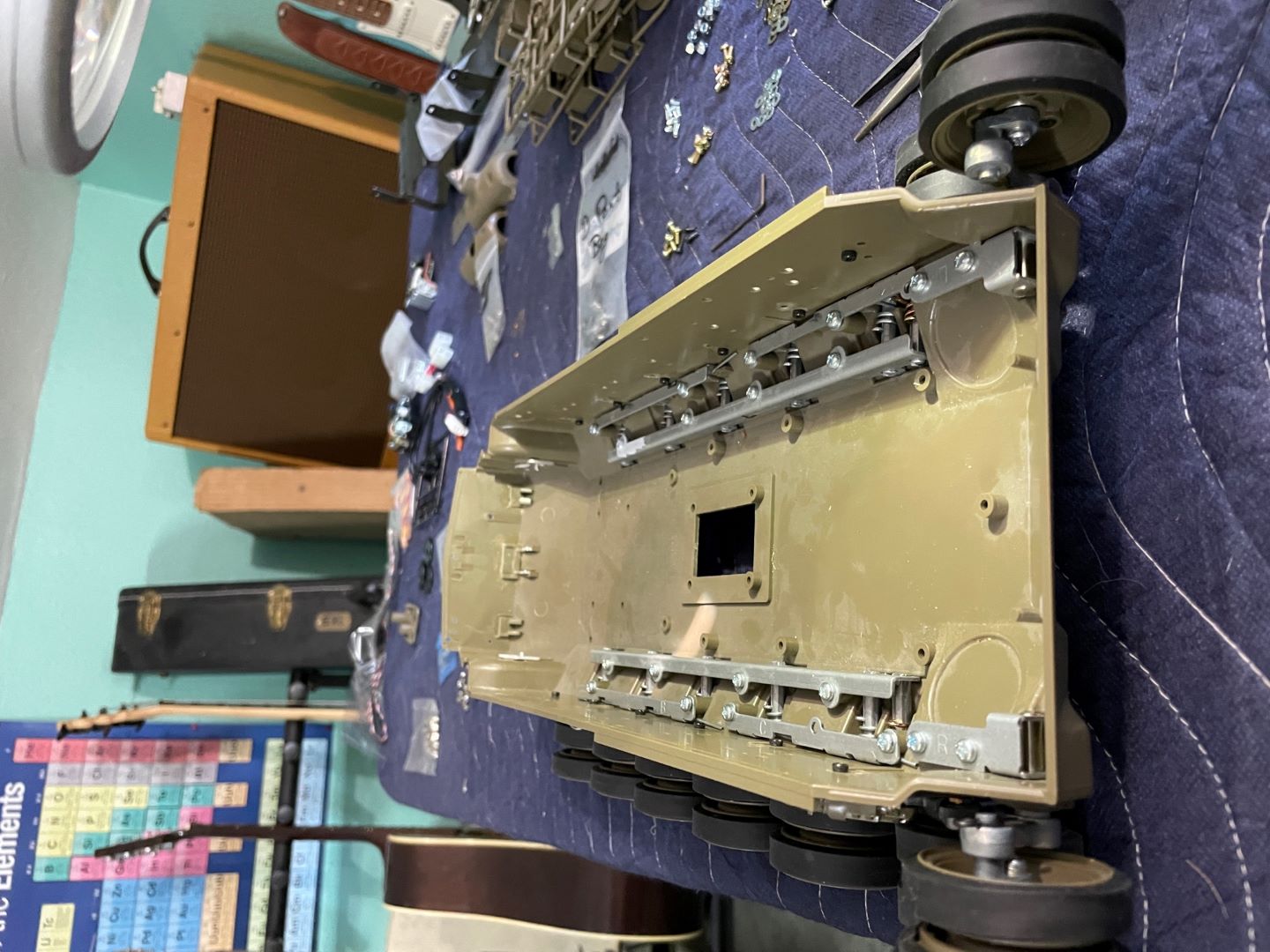

A few more...
