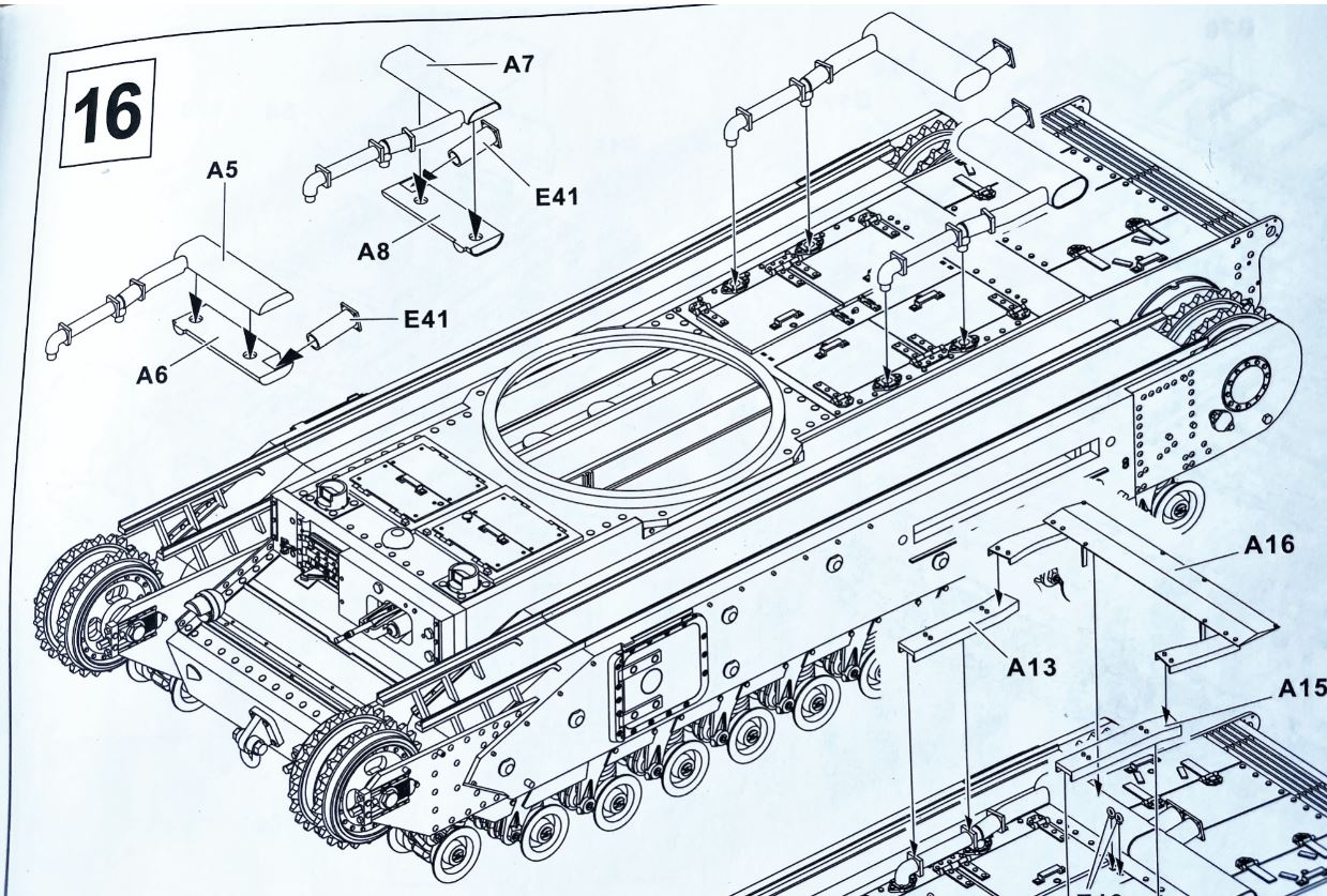

Man, what kind of mind designed this thing... Look at this. So complicated. The model is not very easy to build either. Lots of small and thin parts to position. This kit is for experienced modellers.

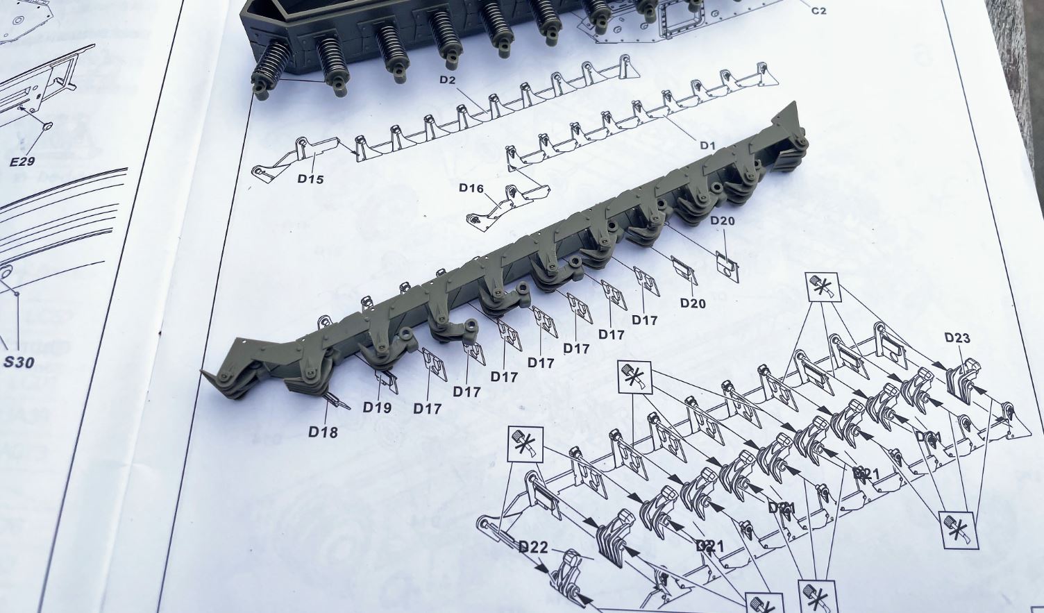

Look at this suspension. The AFV Club kit has working suspension and individual track links. But good luck to whoever want to make it RC. Its a complex vehicle and kit.

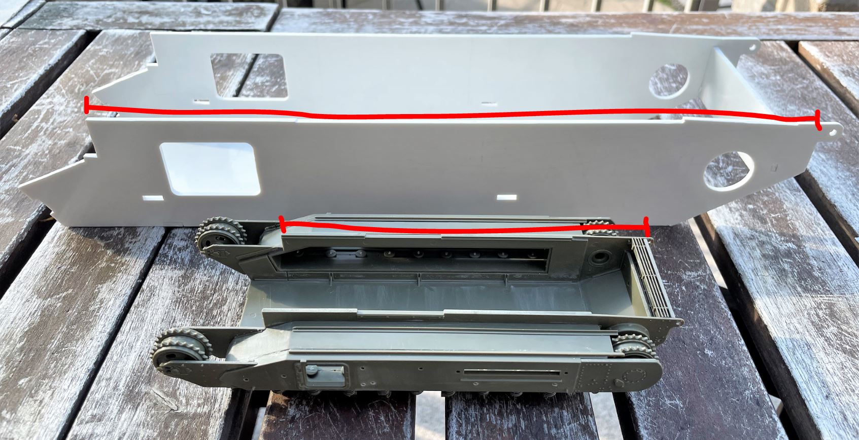

Starting the tub assembly with my 1/35 buddy that will always be at my side to check and double check everything.
RC 1/16 Churchill Mk III - Dieppe Raid 1942 - Build
Compared to the 1/35 kit, tub width is right on.
Length of the 1/16 tub is about 3 millimetres too long. Its not because of the extra armor thickness of the Mk VII because it is not included in the calculations. I also saw this extra 3mm on the sides too. Such difference is within acceptable level, no problem but it needs to be accounted for.

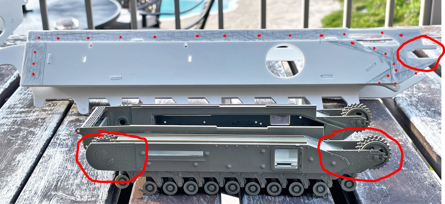

Still planning stage at this time.

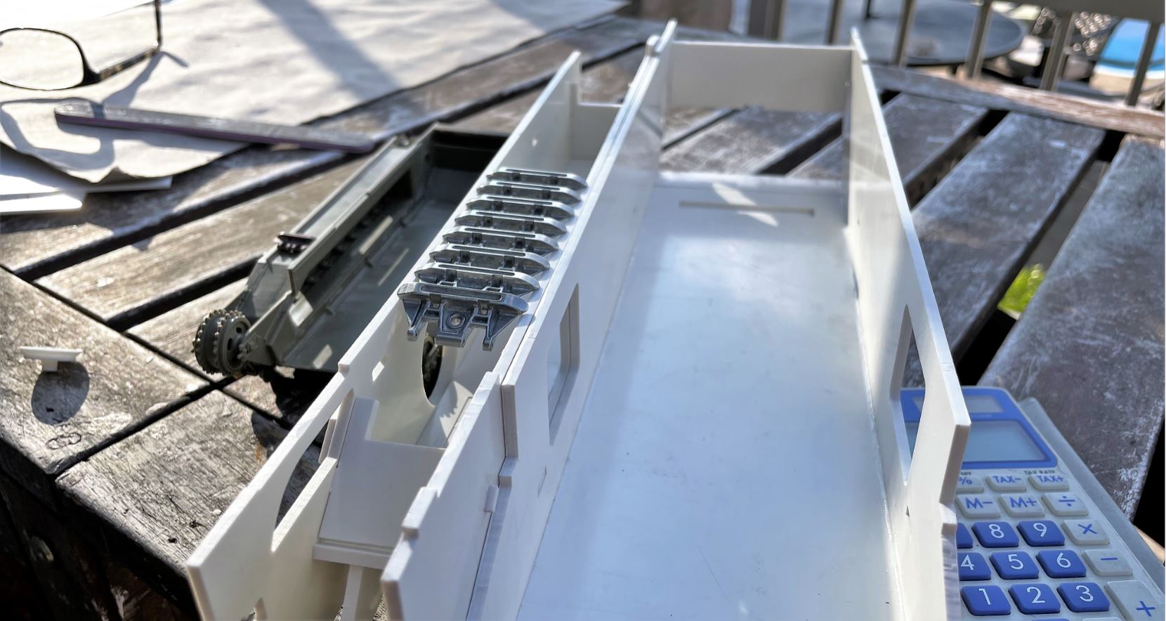

I have assembled the Ludwig right side (at the back) without having glued it. This is important because this is planning to identify the modifications required to retrograde the model to a Mk III. Need to find out now, not after anything is glued. I am finding there are much differences between a Mk III and a Mk VII. As my tank will not have any track cover as well, i have identified all the section that need removal (greyed out with red pins). New parts will be to be scratch built for the sprocket and idler extensions, in addition to some other details like the rectangular hatch. The parts are flat, not many angles so this will be easy using graph and the 1/35 kit as a model.

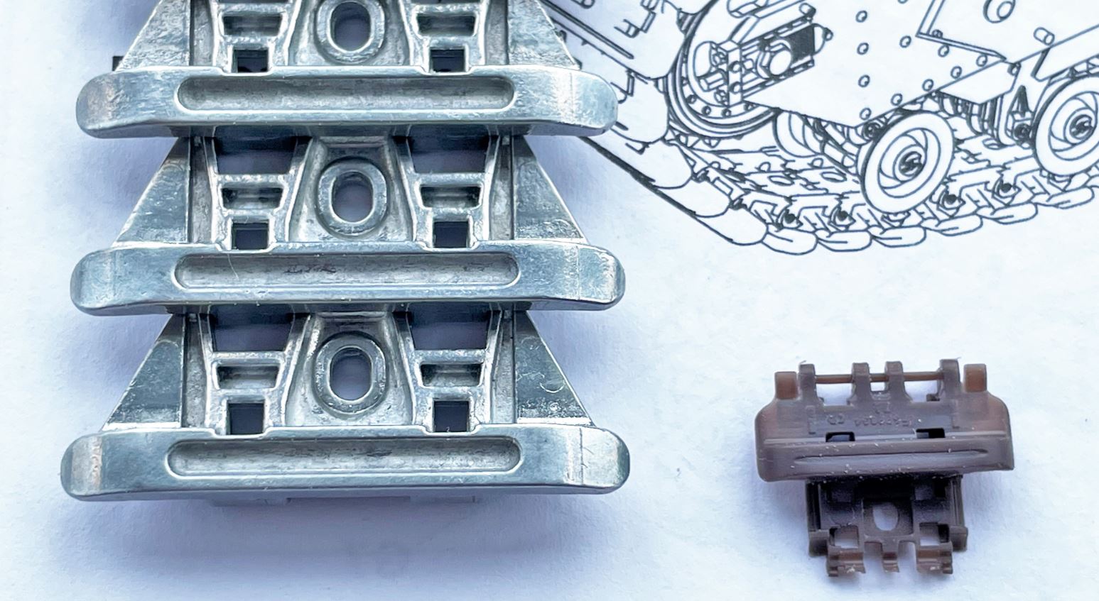

Another area of worries were the tracks. Despite the differences in the middle section between track types for Mk III and Mk VII, I am happy to see that the width is the same and perfect. By the way, the AFV Club plastic tracks are extremely painful to assemble. I was happy to stop after my first one. Whoever wants to complete the 1/35 Mk III should get some early Churchill metal tracks from Friulmodel or other brands. You'll need them to keep your sanity.

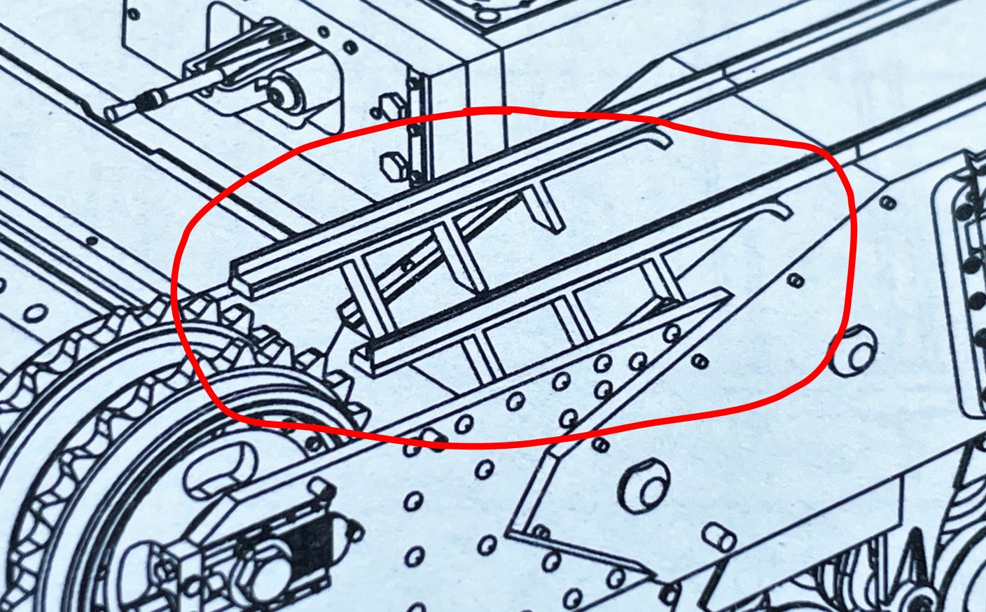

The Churchill does not have return rollers. It was another mystery as to what supports the track under the covers. I can see now that these are rails, metal against metal. I need to order some L shaped brass strips for this.
Notice the support extension to the front. What design...

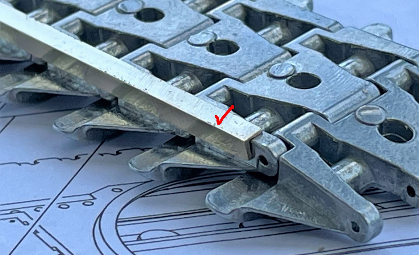

As the metal tracks are heavy, they need good support. I ordered my L shaped brass from Knupfer from Germany with tons of other brass stuff i needed. Small envelope usually make it fast. I do not have enough on inventory.

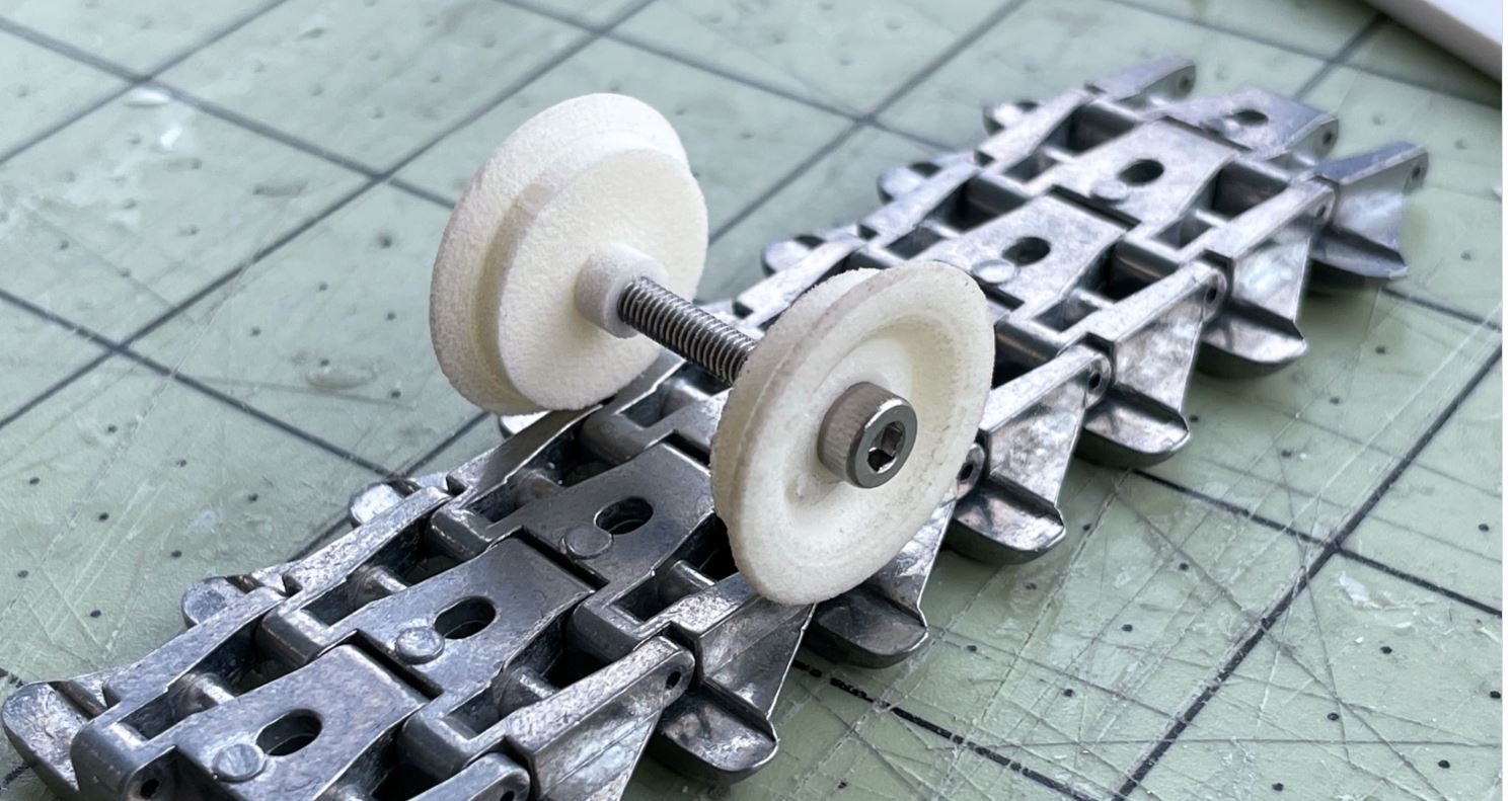

I verified that the Ludwig road wheels will work well with the DKLM tracks. I will have to adjust the space between the roadwheels on both side of each track accordingly because Ludwig designed his kit for the Sherman track and its probably not the same.

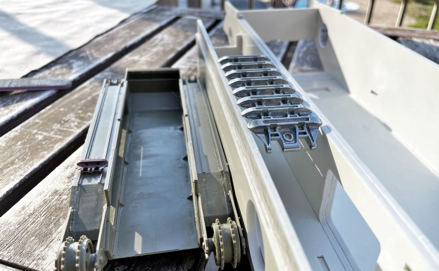

Checking the DKLM tracks on the unaltered Ludwig parts that has sides for track covers. We can see that the DKLM tracks do it fit inside the allocated space inside, meant for Sherman tracks. The elevated section on each sides for the track cover are way too thick. As I will be cutting these, there are no more issues. The width of the main section themselves without track cover are good. I might have to remove 0.5mm in width on the sides of the Ludwig parts as the parts are quite thick. Not sure yet, TBD after the parts are all cut.
With the tracks exposed like a WW1 Mk IV, this Churchill shall look good. It should be impressive to see the tracks rolling 360.

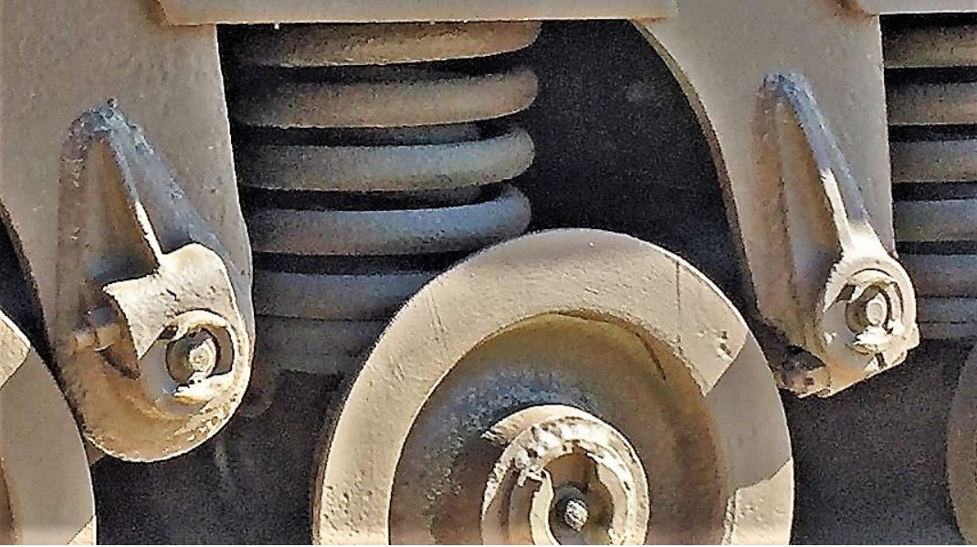

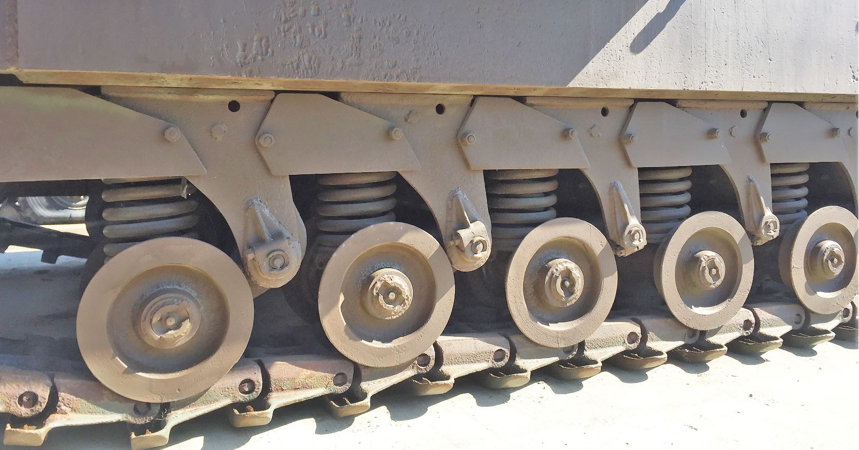

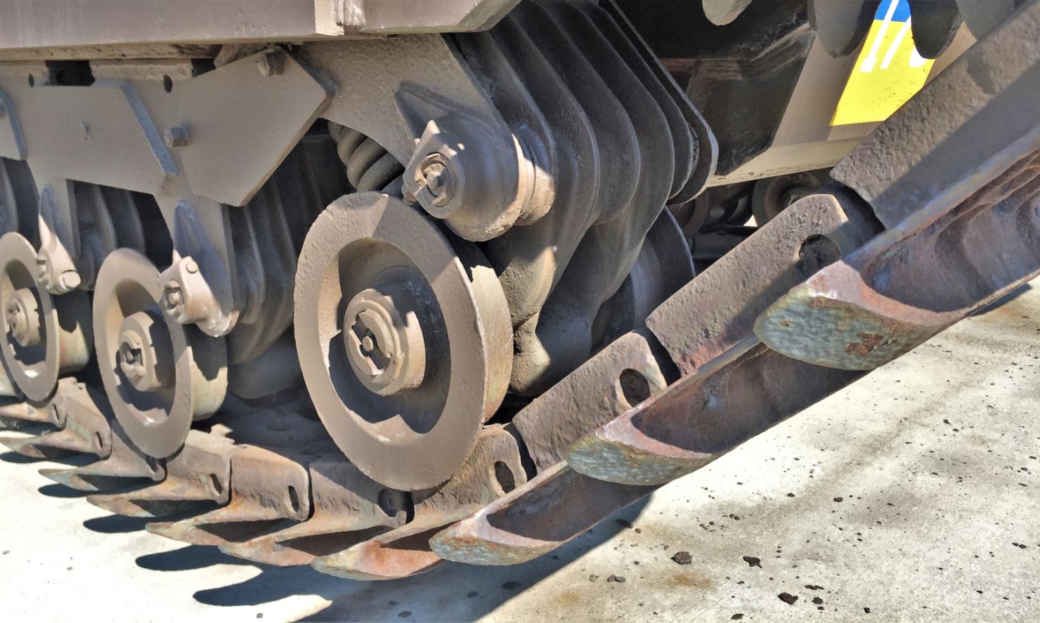

Although the Mk VII has a very different configuration than the Mk III, the suspension and roadwheels are the same. I was able to take quite a few good close ups. We can see details of the road wheels attachments points and the armor plates above them.

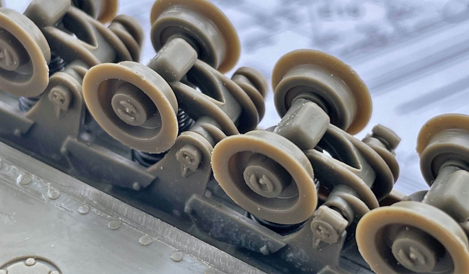

The AFV Club 1//35 has reproduce the suspension very well. However, there is no such details available for the Ludwig kit.

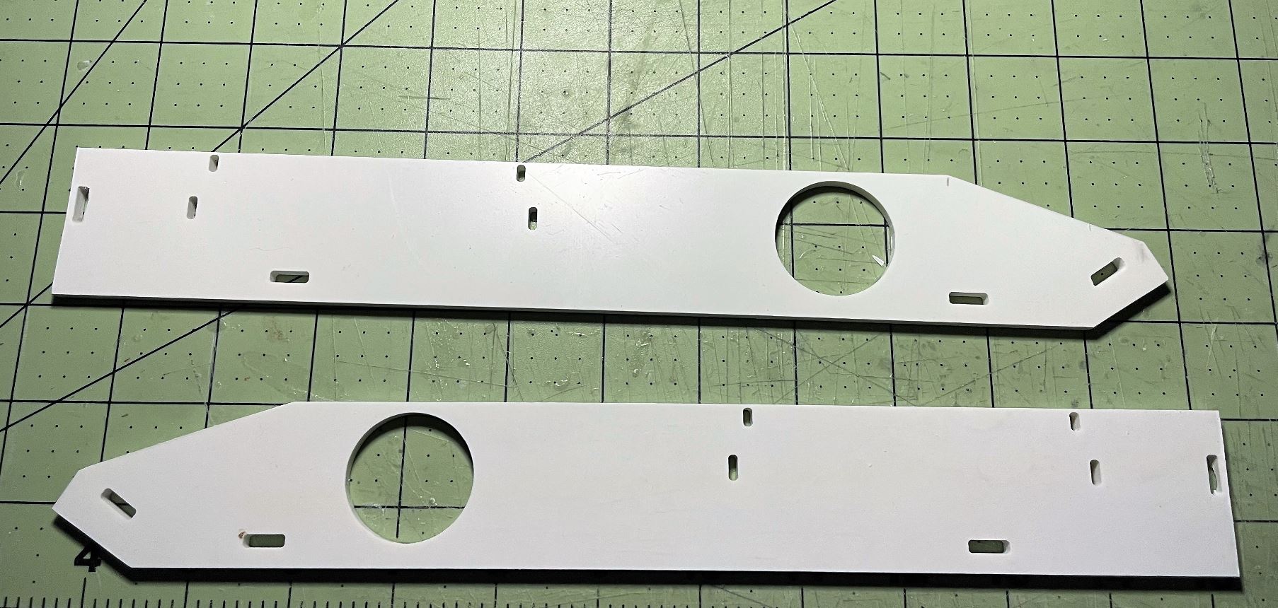

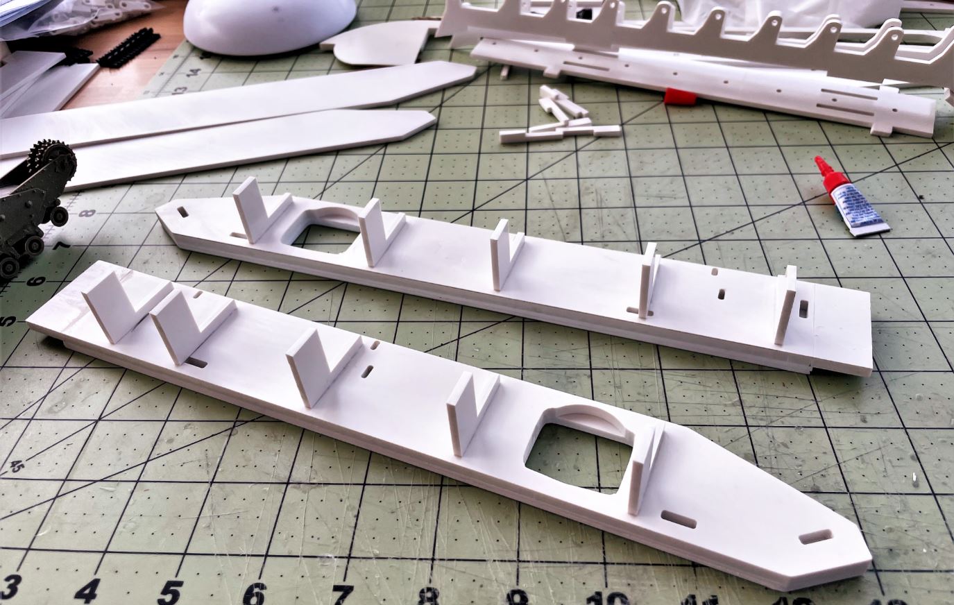

Starting the construction of the panniers. The Ludwig parts for the Mk VII will be salvaged and reused to provide thickness and solidity to the model. Be aware that the pre-drilled location holes for the panniers are wrong. If these were used, the Churchill would be too low on its road wheels by quite a few mm. I therefore recalculate width, length, height, etc of everything on this built according to specs.
The Ludwig pannier parts are cut to the shape of the MK III. I always dislike the location holes that will be difficult to mask later, and also the round escape hatch.

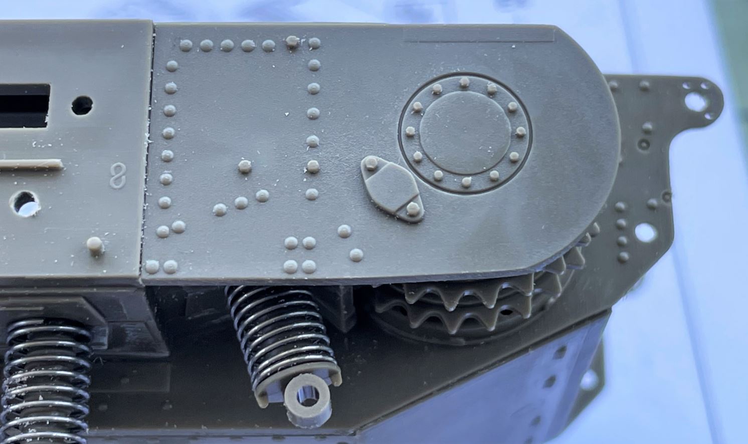

In order to properly represent the Mk III, i created a new flat armour overlay consisting of two 2mm plasticard plate on top of each other and glued to the Ludwig part. This allows for the right thickness of the attachment points at the rear of the pannier for the extension for the sprocket cover, replicating the layout of the Mk III. We will see the sprocket area later and you will understand.
The Ludwig part is 5mm thick so i had to recalculate the correct width of the panniers according to specs and i reused the braces for the inside of the panniers. From the start, i pick and choose the Ludwig parts i want to use.

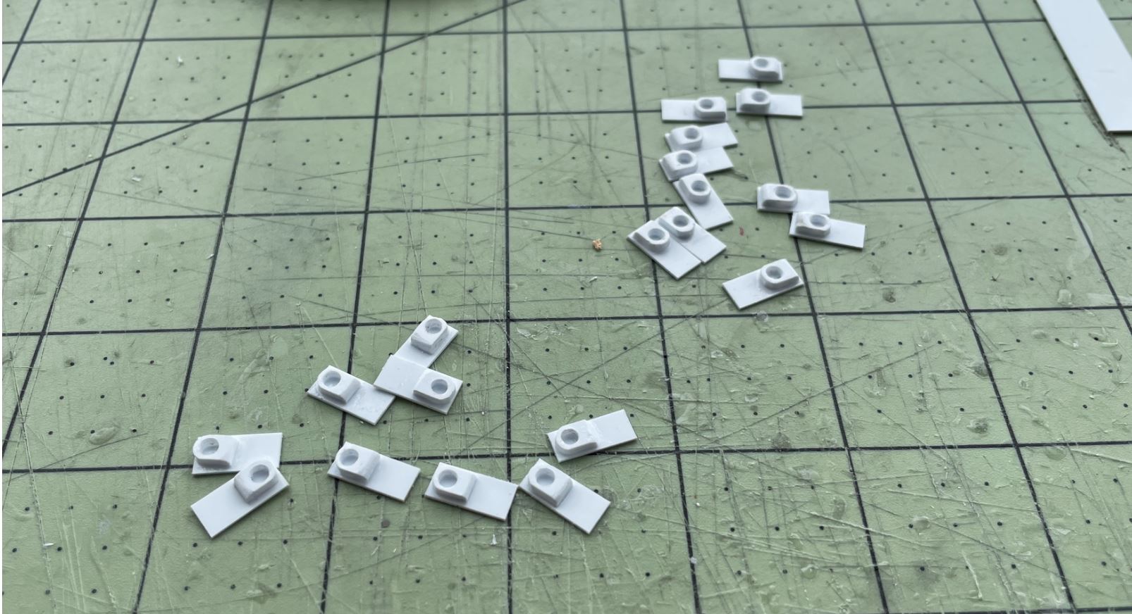

The suspension mount parts are complicated and installing these correctly is critical.
I pick and choose the parts i want to use, and modify as required.

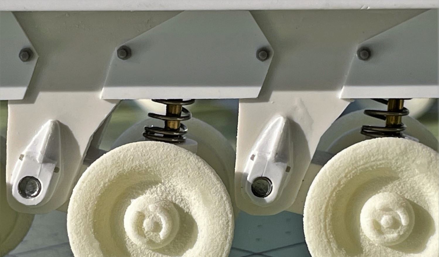

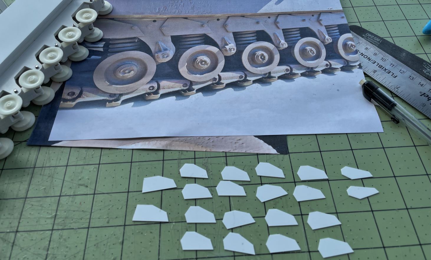

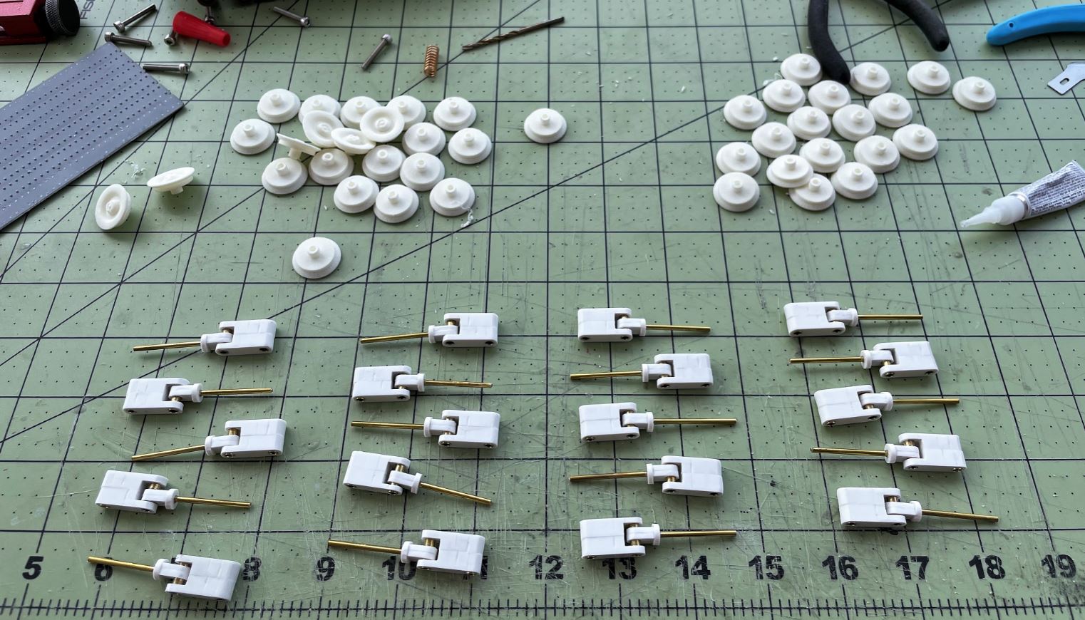

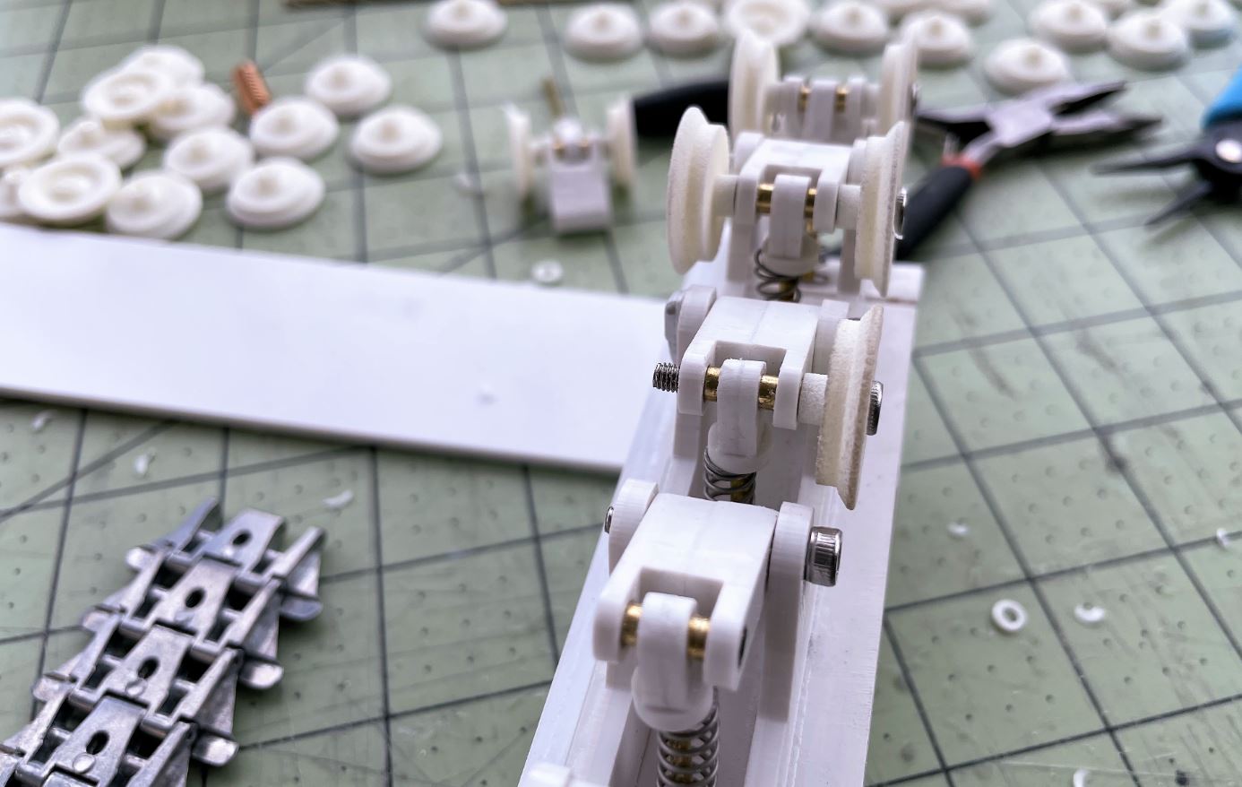

As the Churchill has 11 independent suspension arms and roadwheel sets on each side, an assembly chain with specific steps is created to speed up the process and ensure consistency.
These are the guides for the suspension springs.
The Ludwig parts allows for basis suspension arms to be created. I see no way of reproducing the complex shape of the Churchill arms. As these are mostly hidden under the panniers, there is limited benefits in going further than this.
Close up of the suspension arm and spring guide. I cut the provided springs according to my calculations, 10 rings each which should allow for a firm suspension. Until the tank is finished and testing happens, it is better to cut these longer than shorter... They can always be made shorter later if need be.
I was always worrying as to how i would create stops for the suspension. I was afraid this would be a loose suspension. Not sure if by design or else, but the suspension spring guide parts create a stopper at the right height when installed on the suspension arm. Bravo Ludwigs. The suspension is installed using M3x20mm hex bolts.
continuing on following post
Re: RC 1/16 Churchill Mk III - Dieppe Raid 1942 - Build
It is not easy to adjust this suspension, actually, there is no adjustment mechanism. There is one or two arms that were somewhat higher than others.
I found that just flipping the suspension arm around mostly corrects the issue by establishing a different dynamic. The best of the two sides is chosen for each suspension arm to ensure maximum alignment.

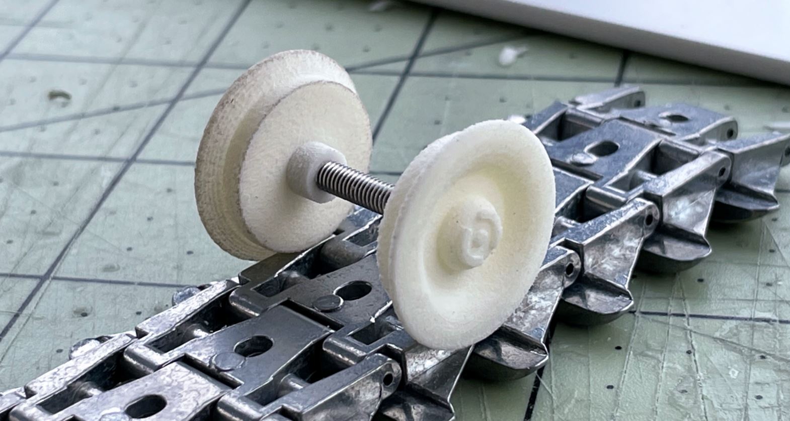

View of the mounted suspension arms. The M3 bolt head is put on the inside roadwheel and will not show.
In order to install the road wheel, i drilled a hole for an M3 bolt on them. The hole goes all the way for the interior road wheel and i removed the hub that is not required because this is where the bolt head will reside.

Again using M3x20mm for the road wheels axles. The bolt is firmly screws. The M3 bolt will turn freely inside the metal tube that was put in inside each
suspension arm.
Testing showing a view of the Interior roadwheel and how they connect to the tracks. The engineers and designers of the Churchill tank must have had background in locomotive and train design.
Exterior road wheel view. It is important that the bolt head does not show on the exterior. Ludwig propose using screws that show externally, a big no way for me that i will show screw heads on every roadwheel...
Installing the road wheels. It is important to avoid any wobble.
These is always small imperfections that can be corrected by reinserting the axle correctly.

But it is not over, the exterior need to have its attachment points detailed. Instead of having the screw tip simply coming out of the suspension mount, i can make them go inside a proper attachment point as shown in reference pictures i took in Calgary and also shown on the 1/35 kit. Take note that there are two variations, as shown below and assigned to specific road wheels mount.
View at an angle of the attachment point.
A prototype is created and tested.
Then a small assembly chain is created for the two variations.

Then the small armor plates above each road wheel are created.

View of the model as it stands today. I am not in a rush to attach the panniers to the central chassis. It is actually quite easier to build each pannier individually and attach the panniers to the chassis as the last steps.
Next step, the side doors, sprockets, idlers and adjusters with their mounts.
