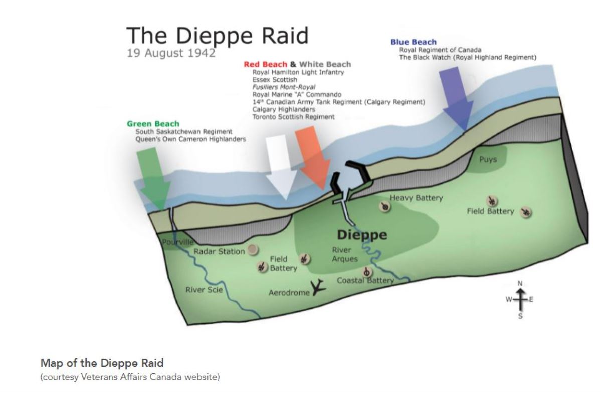

The Dieppe raid is actually a landing on 4 beaches around the Dieppe port city area. Meant as a diversion to excite the Germans so that they would give a break to the Russians, the raid objectives were limited in scope and much of the burden was shared between the Canadian Army and the British navy and air force. Its execution was terrible and is viewed as a model of what not to do on a landing;
- No element of surprise. The Germans knew something was coming and reinforced the garrison just before the raid.
- No heavy bombing preparation or support by any air force before and during the raid, just light fighter planes... Sir Harris preferred to bomb German civilians than supporting troops.
- No Navy battleship or heavy cruiser bombing preparation or support during the raid, just destroyers with small calibre guns
- Lack of reconnaissance
- Bad planning
- Lack of experience

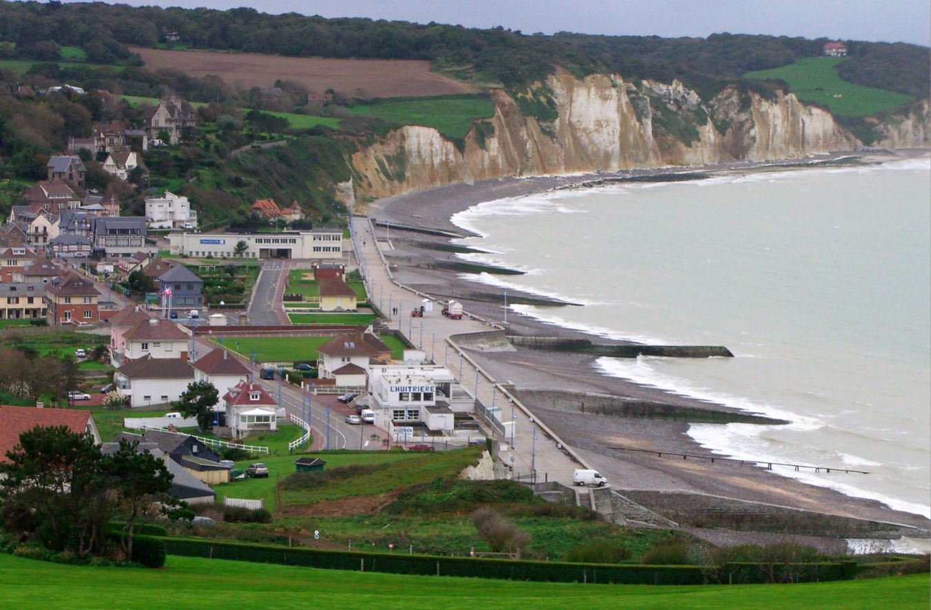

I had a chance to visit DIeppe in 2011 with my father on a 2 week roadtrip of European WW1 and WW2 sites in France and Belgium. Not sure if it was because of the weather but i really felt that the Dieppe area is a difficult, dark and very sad place. Why would someone decide to make a raid there... there is a port but it is big enough for small fishing boats, nothing strategic.

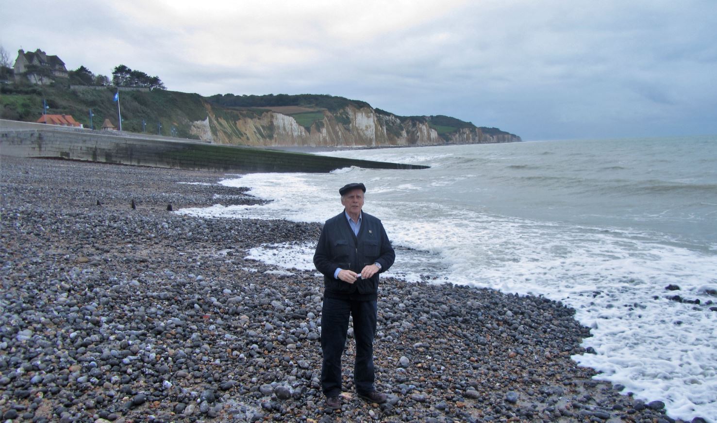

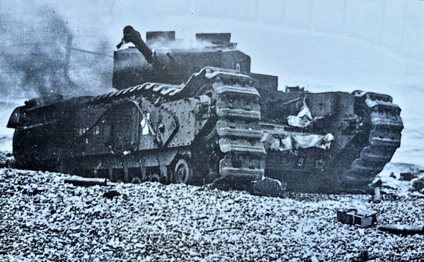

The shingle beach we heard of. It is far from the nice sand beaches of Normandy. The Dieppe beach is made of round rocks of different sizes. It is difficult even to walk on it.

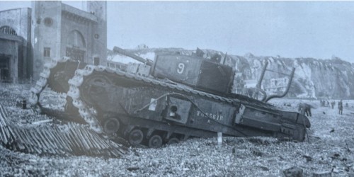

A close up. It is not true that the shingle stopped all Churchill tanks from advancing to the sea wall. It is clear that such rocks can get in between tracks, road wheel and sprockets, and cause a break up of the track. However, out of the 29 Churchill tank that landed in front of Dieppe itself, 2 sank in the sea because they were too far when they left the barge, 12 were bogged down on the beach, either by the shingles or else, and 15 made it to the promenade.

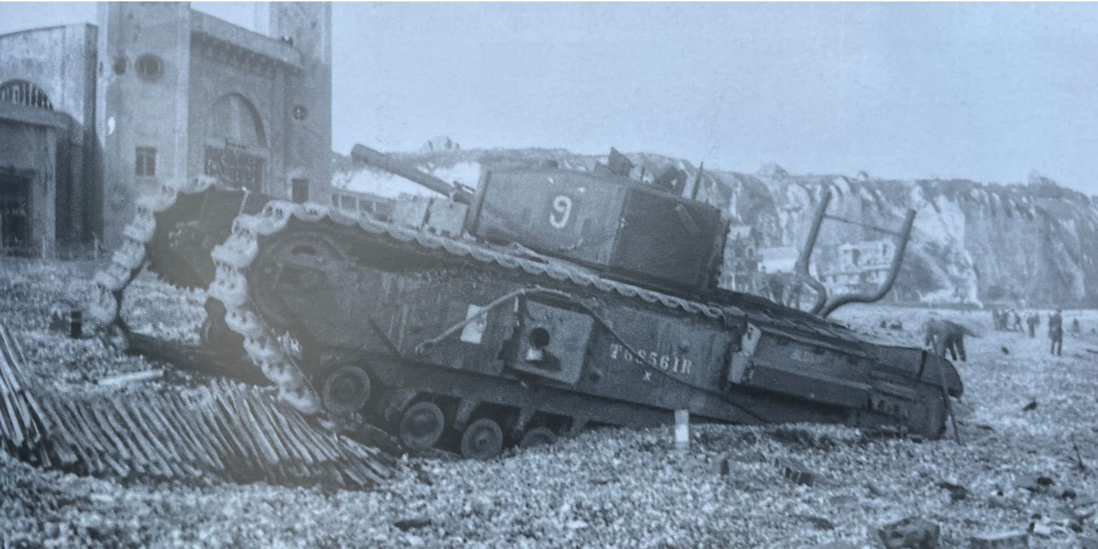

When we see a line up of Churchill tanks like this on a Dieppe beach, parallel to the Germans, it is because these are actually operational tanks that made it to the promenade, did fight the whole time, and then came back to the beach later to provide cover for the troops that could re-embark.
Many of the Churchill tanks that made it to the promenade had their tracks damaged by German light anti-tank guns and were immobilised. No tanks armor were actually penetrated by German guns, a good news for the crews. They fought until their ammunition were exhausted. The complexity was to escape the immobilized tanks because the side hatches were sealed watertight for the raid.
From what i could see, all Churchill tanks did not have track guards on top. This is definitely something of interest that need to be reproduced, with nice tracks. This is unique to the Churchill in early years.

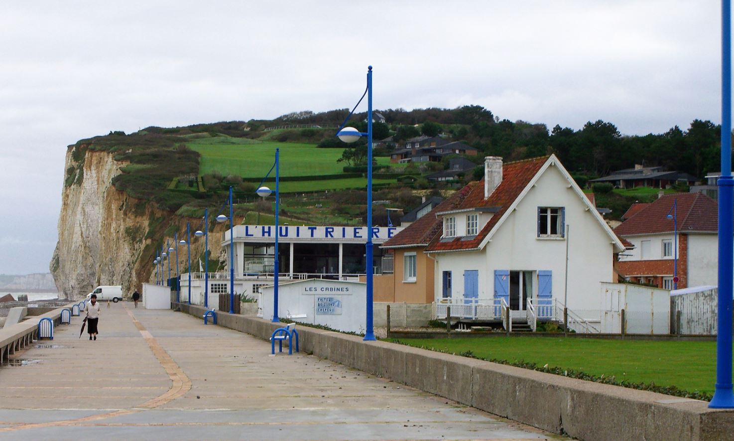

The sea wall of Pourville. It was likely very similar back then. See the high ground in the back. This area is more open and easier to access.
It is easy to see that this hill is where German machine gunners, snipers and observers for artillery and mortars were entrenched. It would have required support from heavy bombers or battleship to clear up the place. It did not happen.
There is a commanding view of Green beach and the whole valley from that hill. The infantry below was able to advance inland but they were on the wrong side of a river and could not reach their objectives. The advancing infantry below suffered terrible casualties during their advance and retreat.

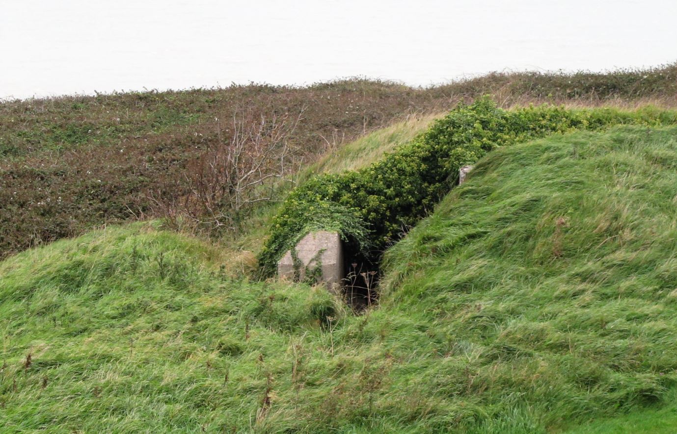

Remains of German fortifications on the hill over green beach.

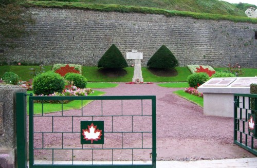

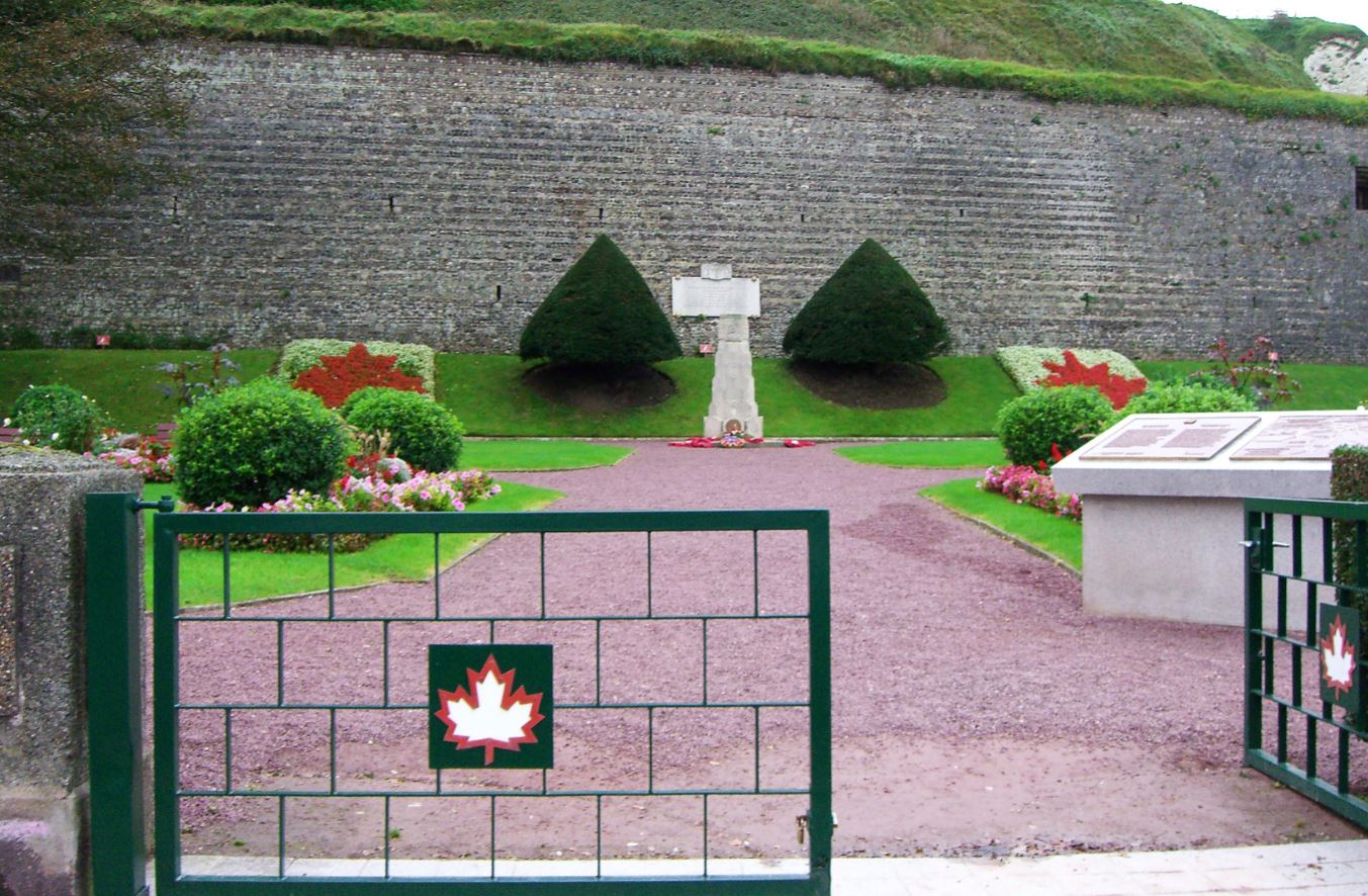

The Canadian war cemetery and memorial nearby.

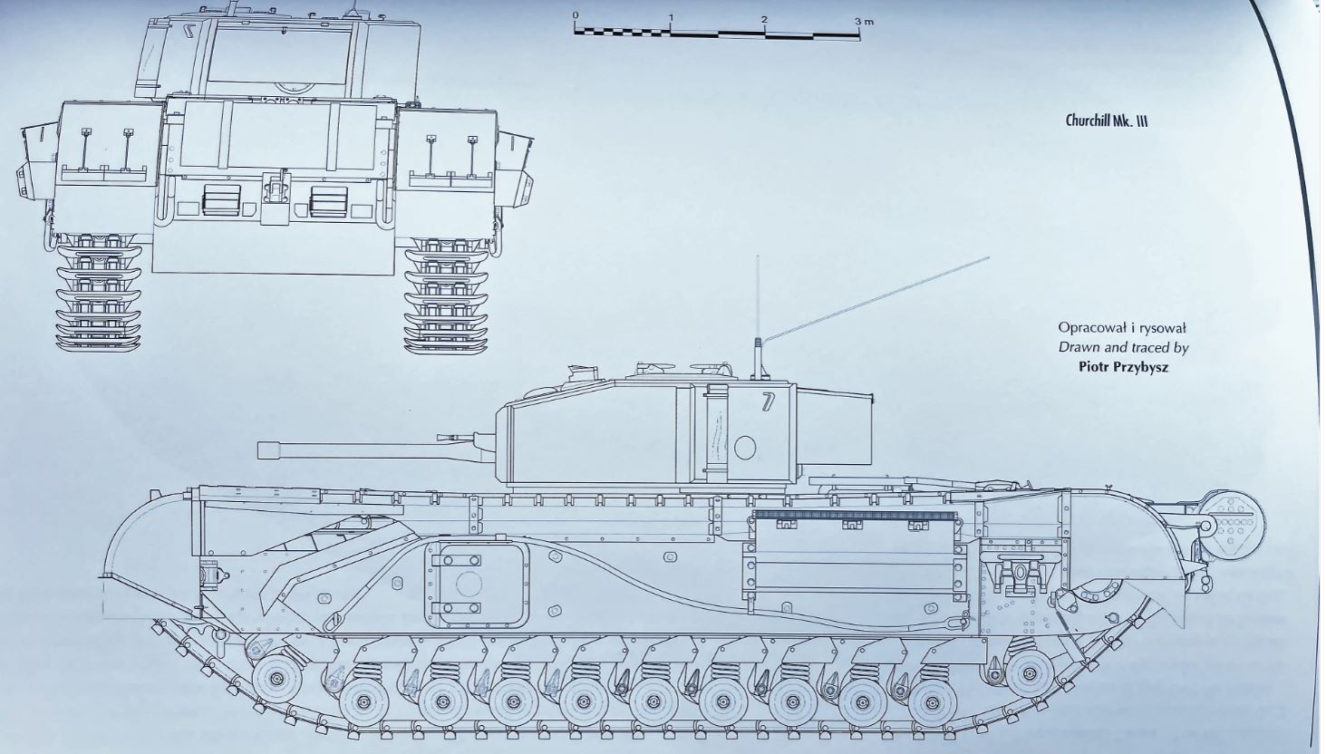

Some of the documentation for the build. The GunPower book has good graghics. The french book on the DIeppe raid is the story of the Calgary tank regiment, with a detailed summary of what happened to each tank and landing craft involved. The other book is specific to the Churchill Mk VII and of limited use for this build.

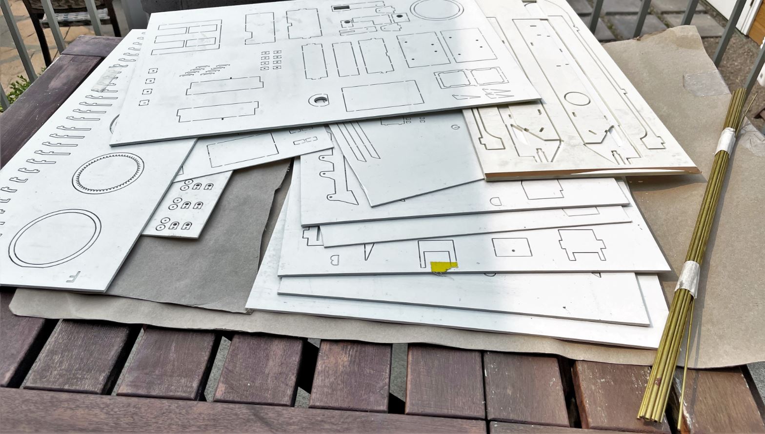

This is the Ludwigs Churchill Mk VII plasticard basic kit, purchased years ago before DKLM produced their 3D printed Mk VII. As i have no wish to scratch build a Mk VII that is available as a better kit, i have therefore decided to convert the Ludwigs kit into a Mk III, requiring some important changes.

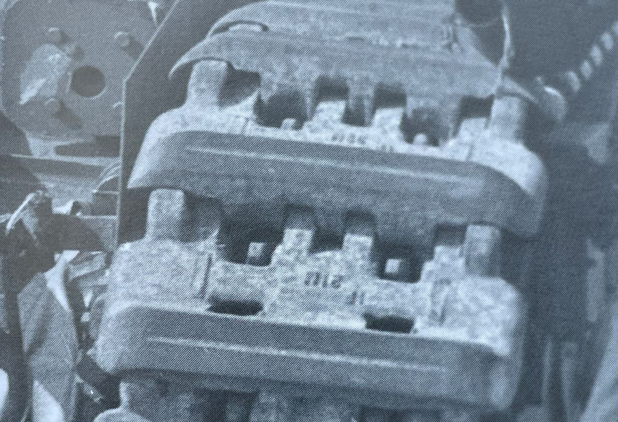

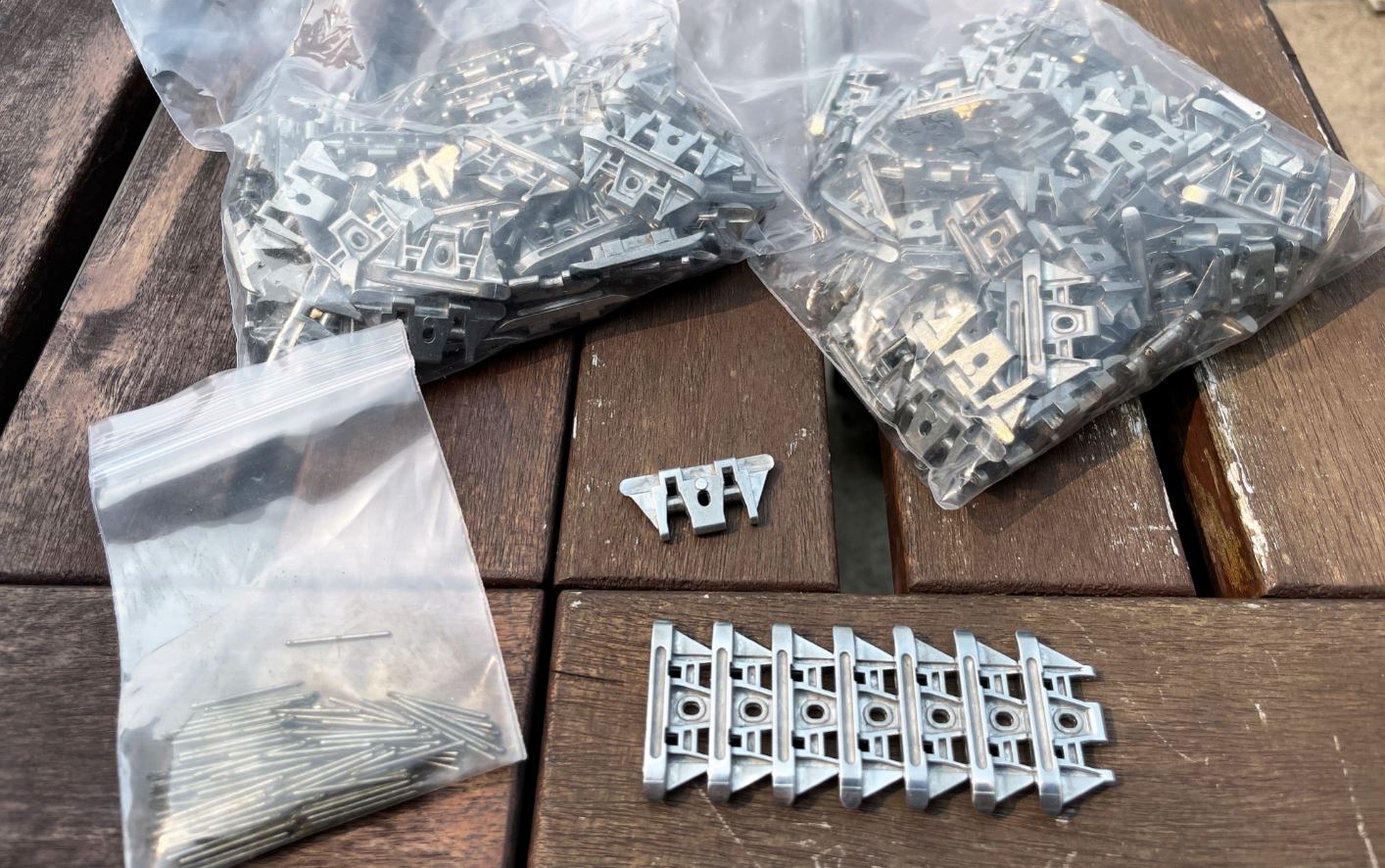

First task was to find good tracks. The Ludwigs kit is proposing the use of Sherman tracks, which is very different. The Mk III is also using an earlier track than the Mk VII.

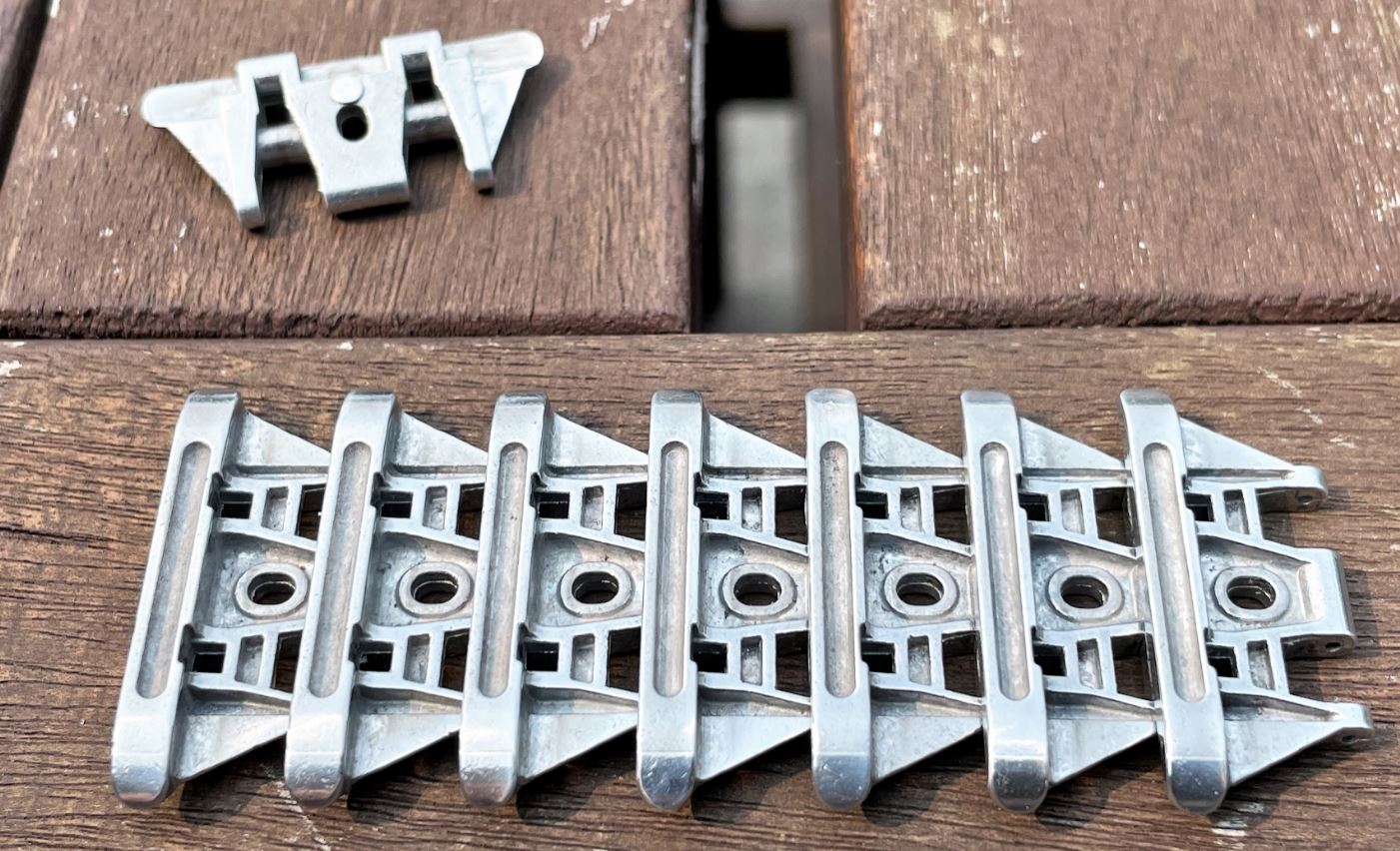

No way around it. I contacted DKLM and they offered me a set of nice metal Mk VII tracks, they are rare as these are usually 3D printed. There is nothing better so this will do, not perfect but close enough.
As the tracks will be fully exposed all around the tank, these metal tracks will surely look good. It's better than Sherman tracks for sure.

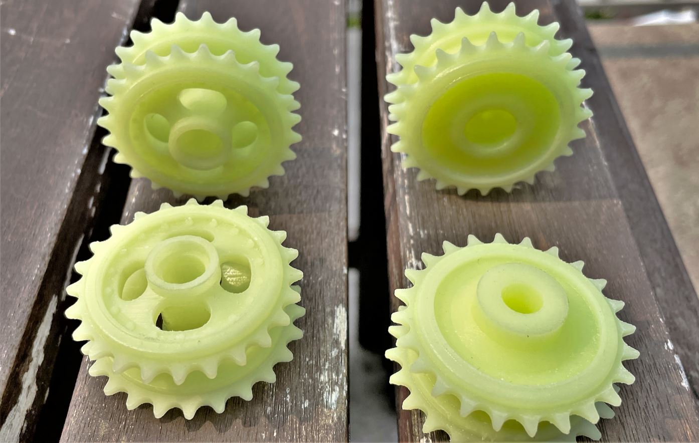

Coming with the tracks are DKLM 3D printed sprockets and idlers. Metal ones were not available.

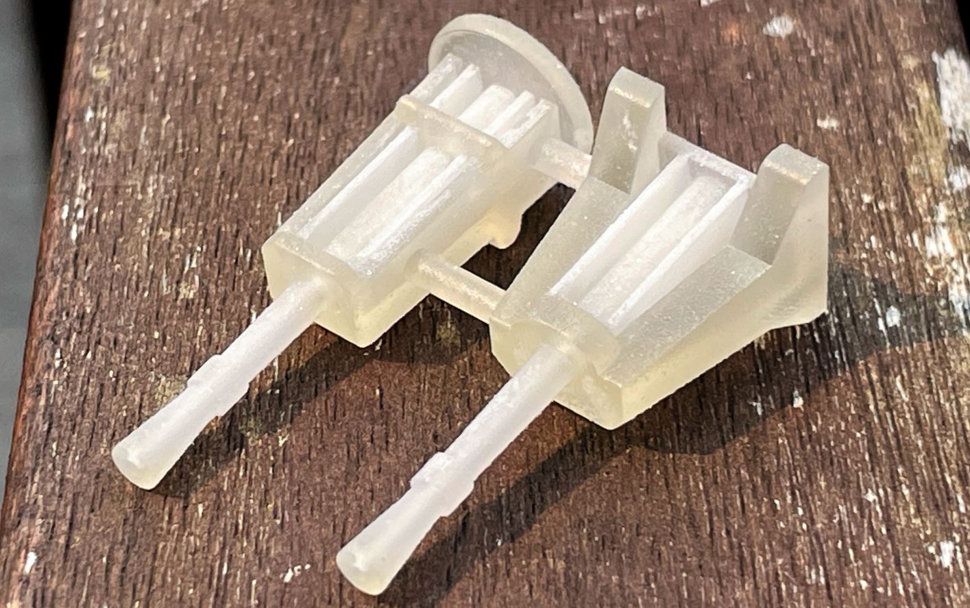

Shapeways Besa machine guns. Not sure if usable as I need mine to be functional with LEDs and mouvement.

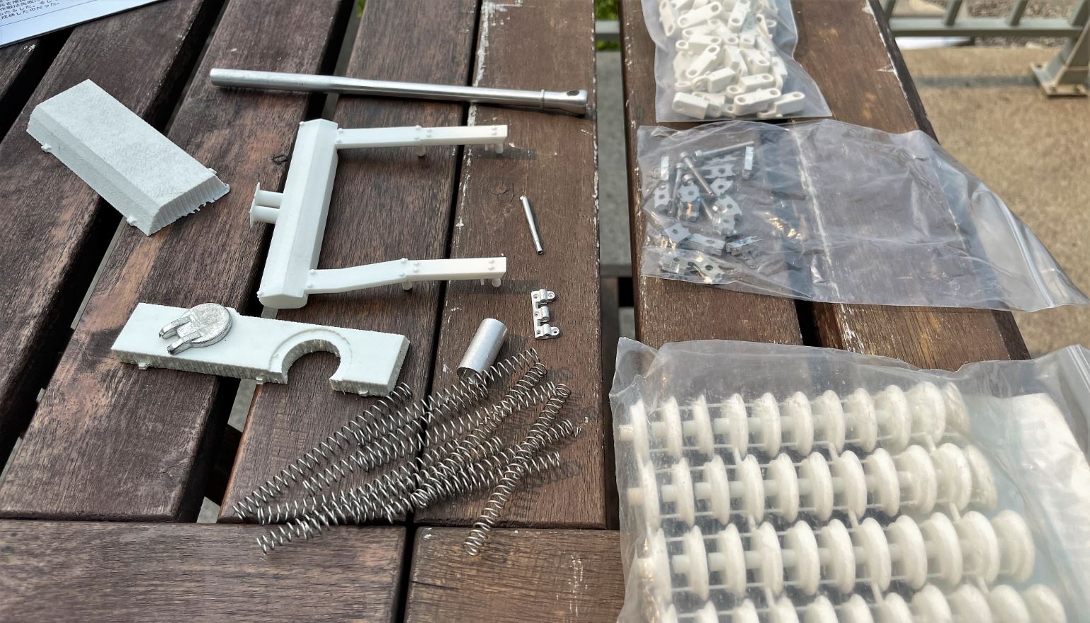

Some of the Ludwigs optional items, including the 3D printed road wheels, suspension parts and exhaust. The gun barrel will need modification to represent the QF 6 pounder of the Mk III. Other items won't be of use.

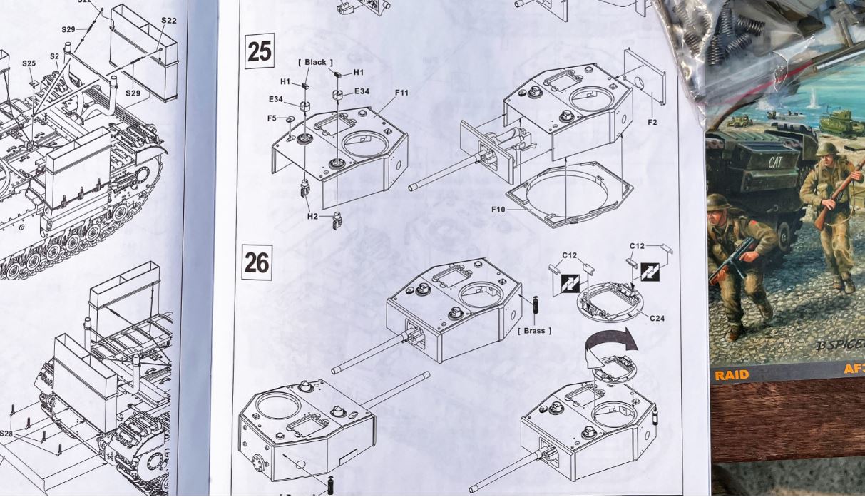

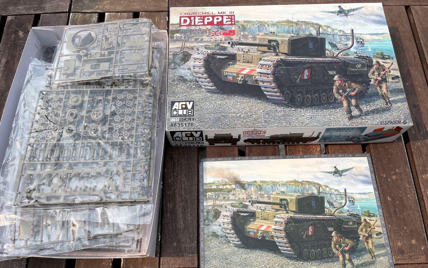

The 1/35 AFV Club model of the Churchill Mk III at Dieppe is a very important source of information for the build. Very detailed and has working suspension.
Very nice kit, and it contains a nice picture for framing.

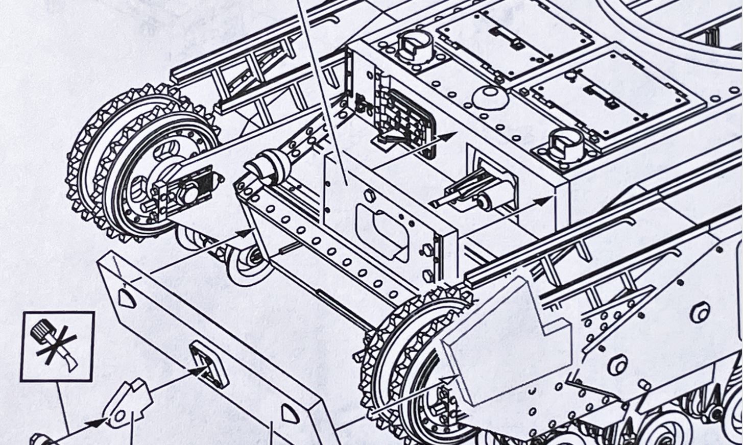

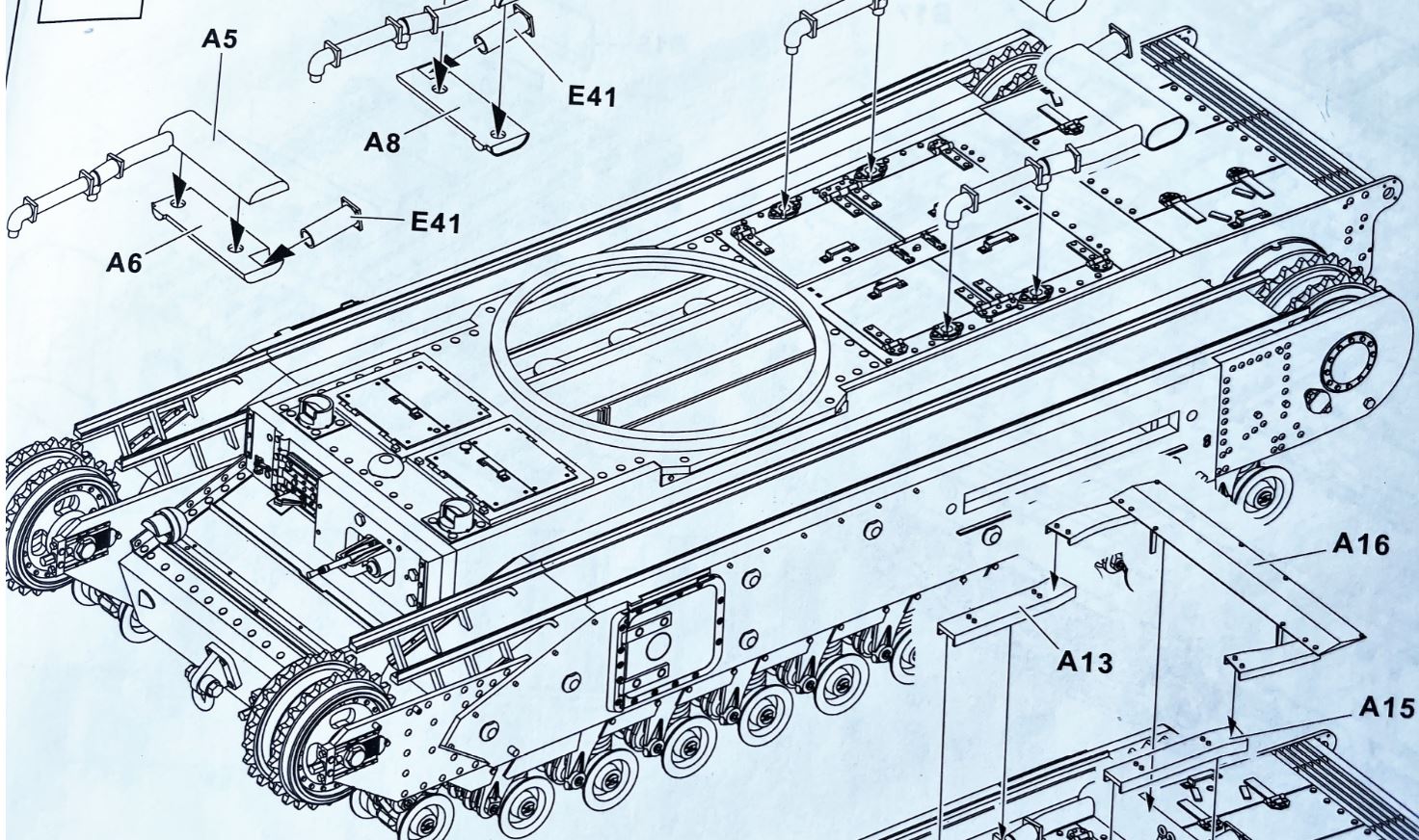

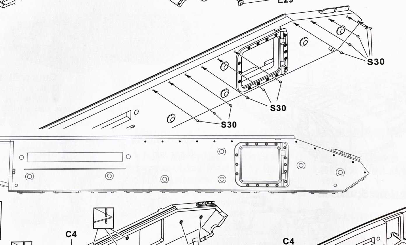

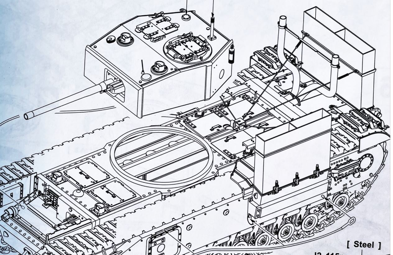

The kit parts and instructions provide valuable information for the build, such as the complicated suspension above and under.

Some of the modifications required. In any cases, a Ludwigs kit is like scratch building so it is not really added work.
The Mk III welded turret will need to be studied and reproduced. Pretty strait armoured plates, should be relatively easy to do.
The frontal area, driver hatch and machinegun mount on Mk III are different that other versions, so is the thickness of the armor.
Side doors are rectangular, not round. Easy mods.

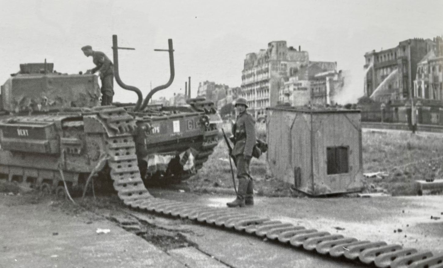

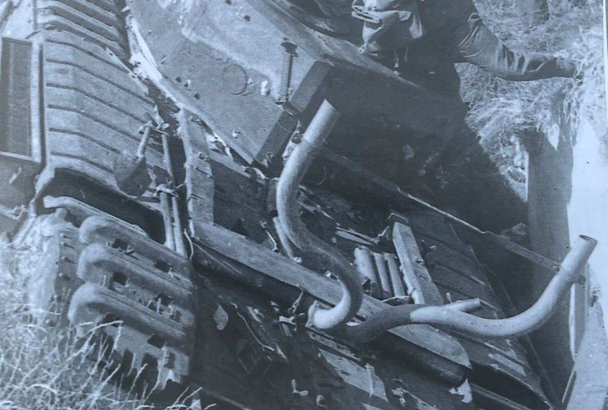

For sure, the Y pipes for the deep wading equipment is required as they are a trademark of the Dieppe Churchill tanks. Notice that this specific tank has a partial track cover aligned with the air intakes.

The shapeways machine guns have a small tube down the length of the piece. It can be made to work but an optic cable around 1mm thick will be required. I will let you know the exact thickness of optic fibre when I have sorted the ones I have for Cromwell.
