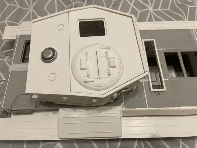

Just a little more, as before there’s been more filling than building, but here we are

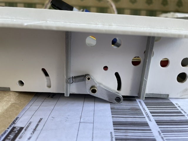

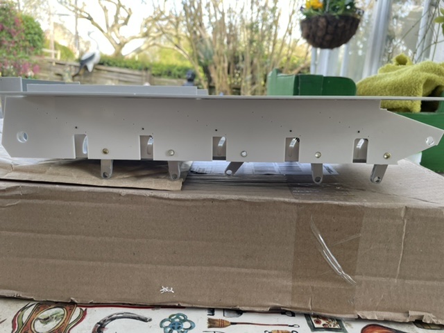

It’s taken quite sometime but using a combination of brass tubes and carbon fibre rods the suspension is finally installed and hull sides are on

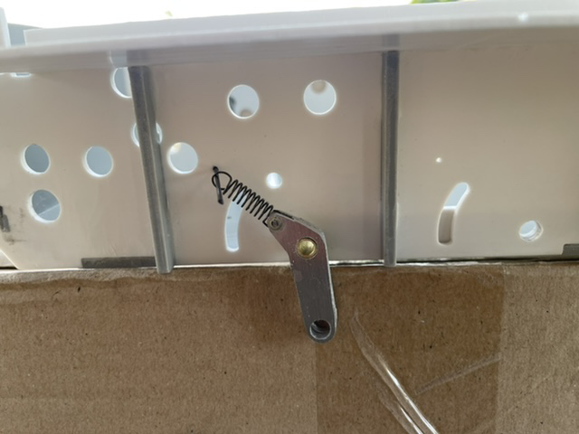

So I’m back on this project. Finally. I have added all the rivets though it’s not gone completely well. Looks like an apprentice did it. But I’m at a loss and can’t get my head around how to put the wheels on

Doesn't look like there is any space between the hull and the suspension arm to suggest a using a nut on the backside of the arm. I would personally look at maybe a shouldered screw that is directly threaded onto the suspension arm. That hole in the arm looks really big like an M4. What does the bore of the wheel look like?
