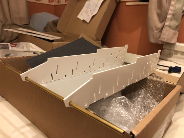

My final effort for today was to start the Cromwell.
Still have no idea where to start so I started here

Whether you start with hull, upper hull, or turret doesn't matter all that much. :)
With the lower hull- where you've begun- with hindsight, I would have paid much more attention to getting the best arrangement for the swingarms I could manage, in my build. Just give it a good bit of thought. It's easier to test, and configure, the swing-arm arrangement, if you haven't bonded the side plates together first. In Christian's Pdf., that's not entirely clear. I'll look forward to seeing how you progress. :thumbup: Bon chance!

I’m unsure on wether to use the tiger suspension or the system I have but hull wise that’s pretty much how it will stay until suspension is in place

:) Were those grey printed-looking parts supplied by Christian? If so, he's made some revisions to the 'basis kit'.

No it’s just grey plasticard

Exhibitedbrute wrote:No it’s just grey plasticard
Should save on the grey primer, then :D I can see one improvement on the kit I bought, however: the holes for the track tensioner and idlers are already in place.
For my project, I had to make a template, and use it to drill them myself. :problem:

My idlers and tensioners should come in the new year so I guess we will see how good an improvement it is, best I can tell though the come with a pre-cut piece to help get them in the best place during installation as well as having the holes pre drilled
