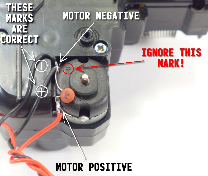

OK. From every place I have seen. The polarity should be as follows.
Mind you I don't have any airsoft left in my tanks and have not looked at one in years? So I could be wrong....

Thank you but my BB is the white as in photo 2 of your first answer.
I had already noticed that it was necessary to weld the black wire in front of the + sign engraved on the engine.
