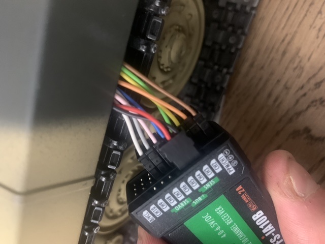

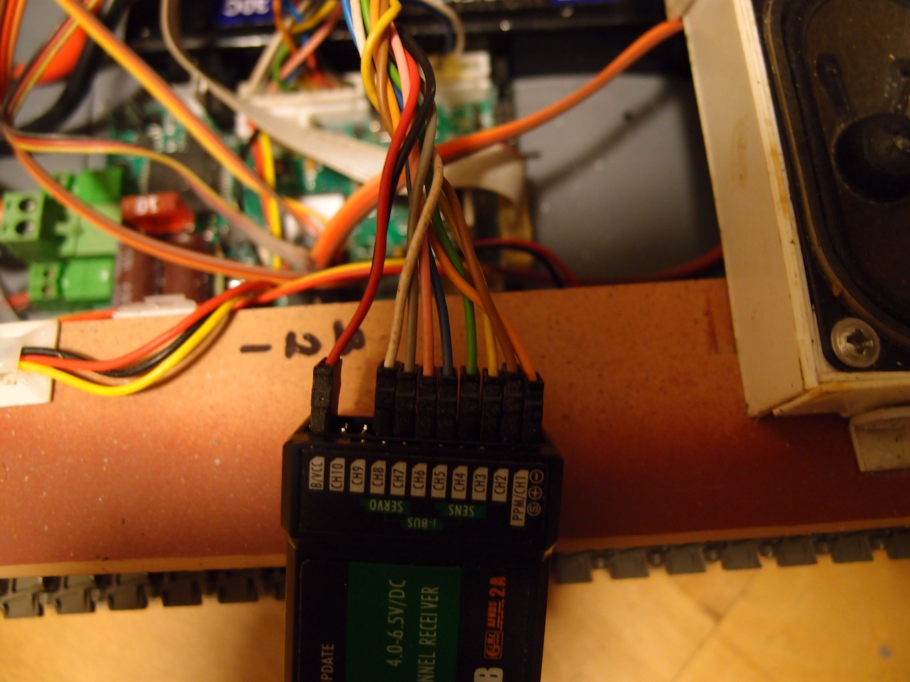

Receiver
- 8B28D839-74A4-4528-B4CB-12DABB8C4B44.jpeg (72.75 KiB) Viewed 2439 times

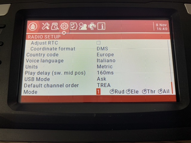

Re: Help connecting elmod pro on torro tank...
Radio
Really.. im sorry... is not cause i domt want to follow you... im trying... but its hard to understand
- 7BDC1E6B-FA20-416F-AE0E-B8442AFF0FDE.jpeg (76.23 KiB) Viewed 2438 times
